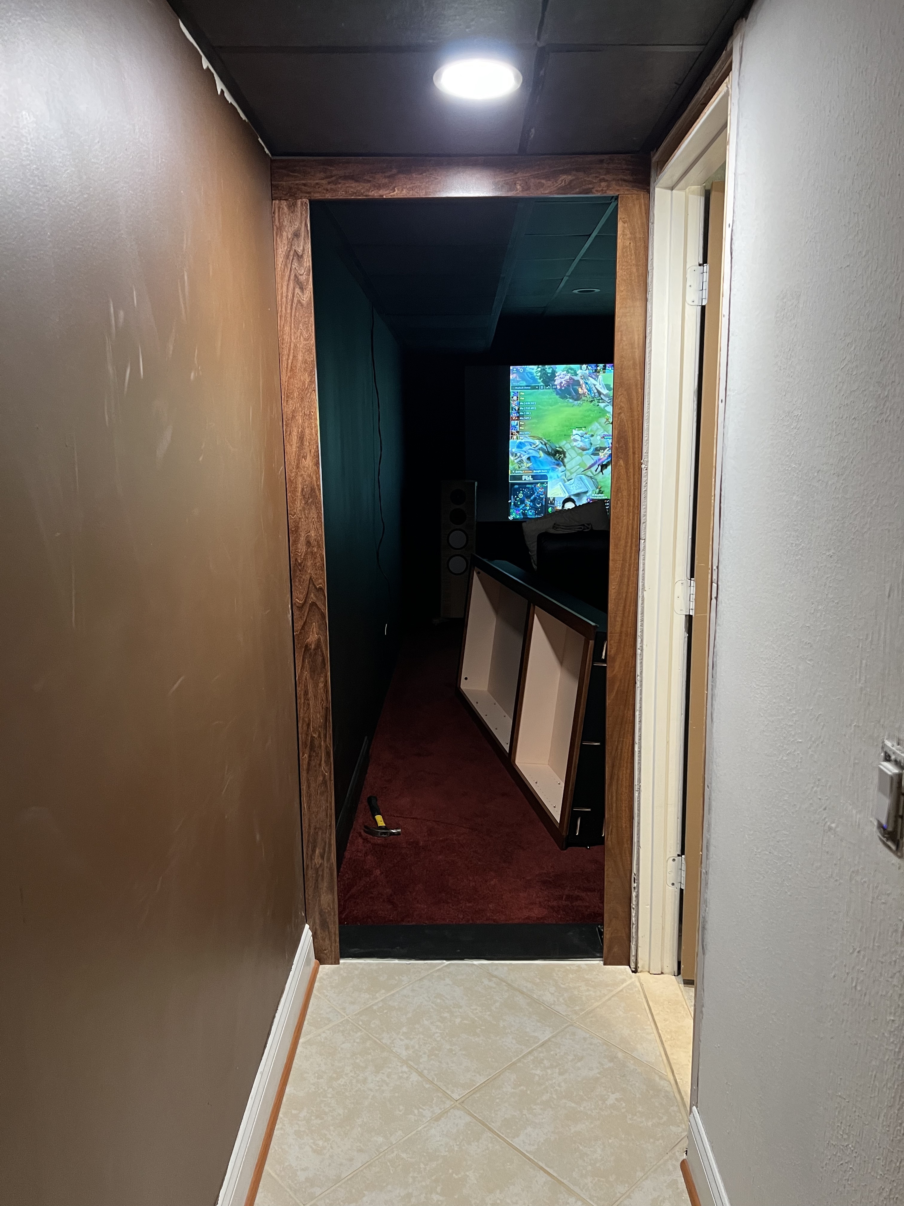

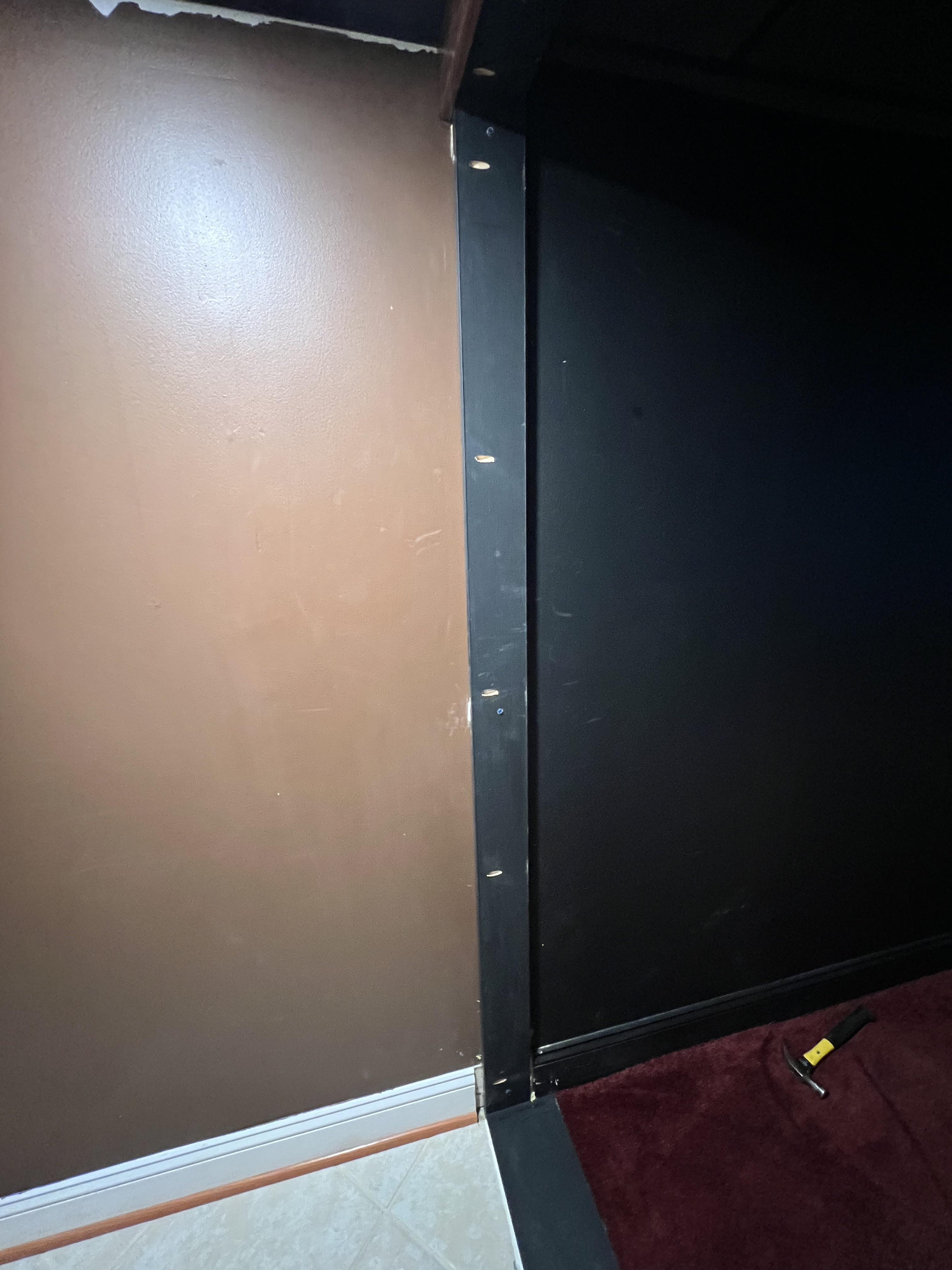

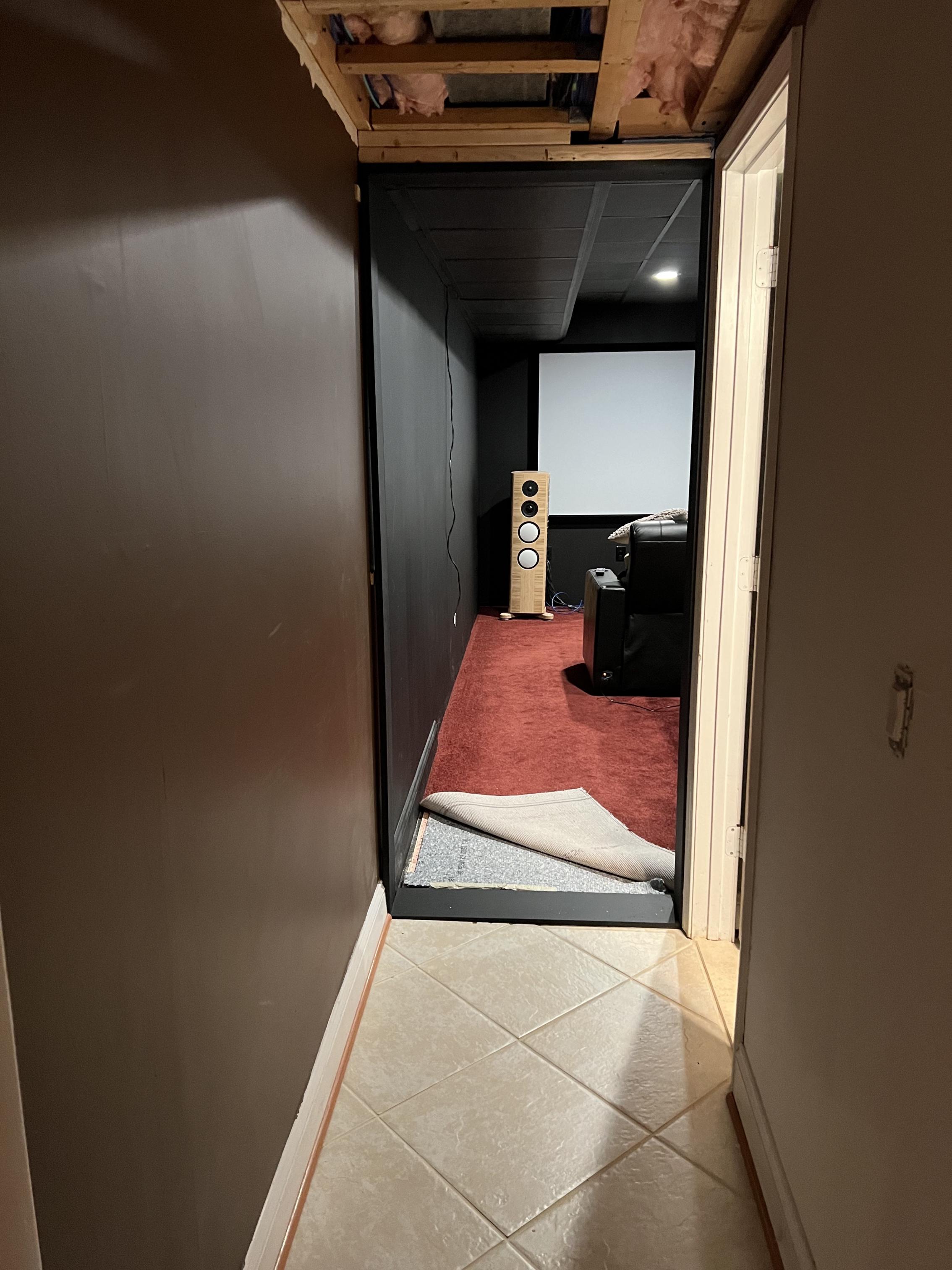

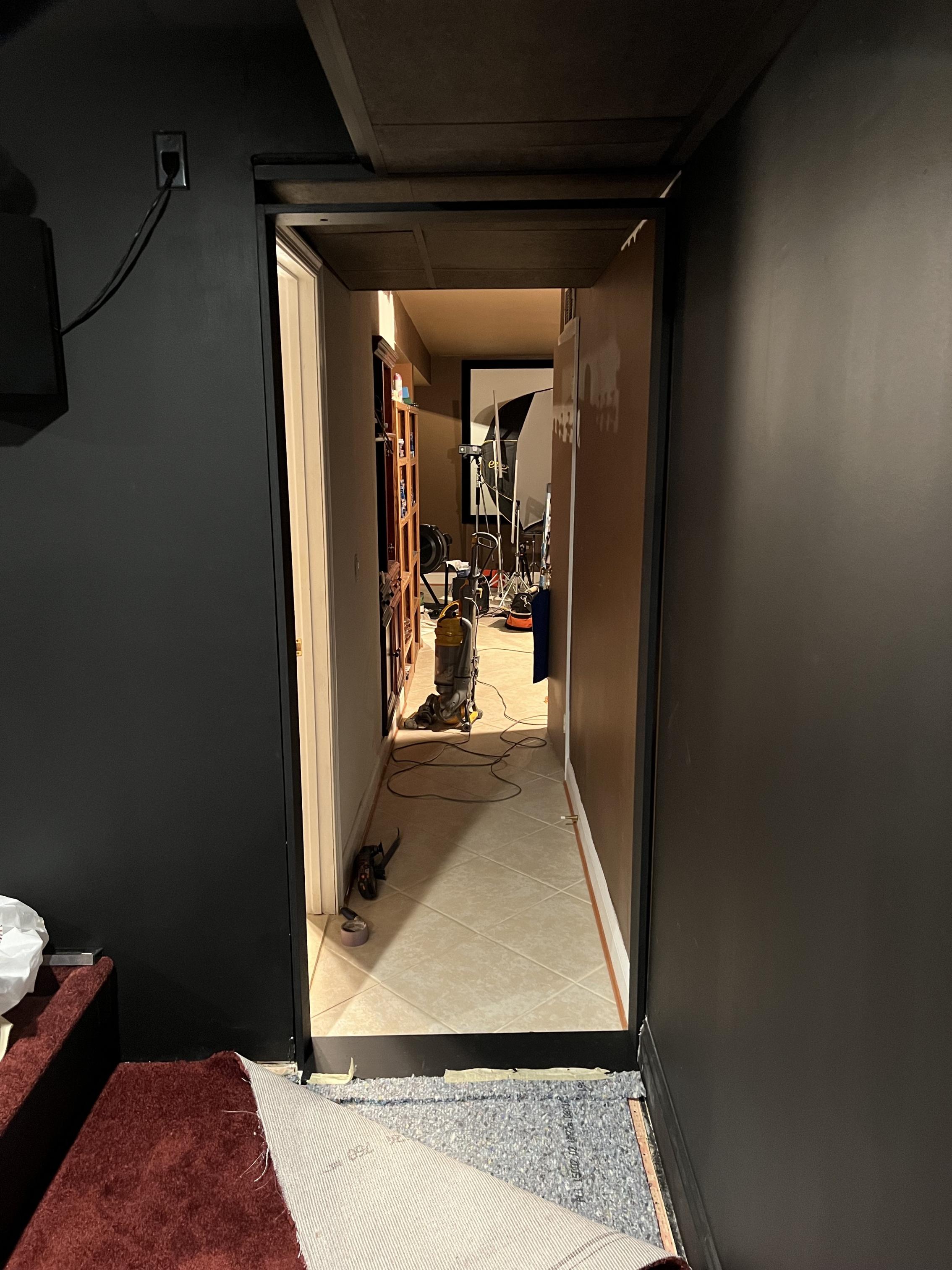

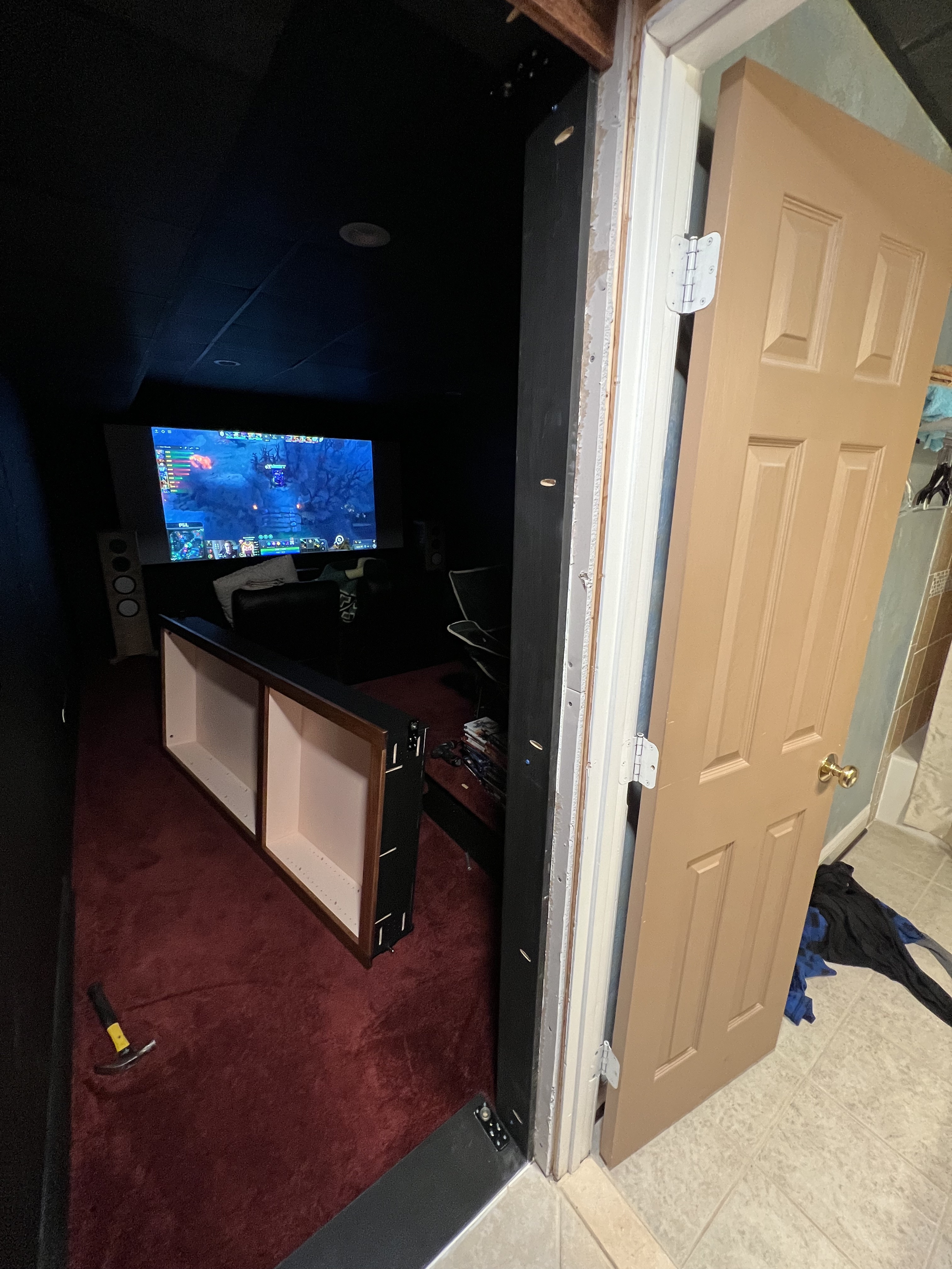

      Following the instructions, I first started with sanding, priming, and painting the door frame. Photos I forgot to take are what it looked like when I started. I had to remove a transition piece of tile and then cut the floor trim on the left to get the frame in. I used the same primer I have used for painting the cabinets and rolled that on. I used the Sherwin Williams black which is the same as what I painted the walls with.

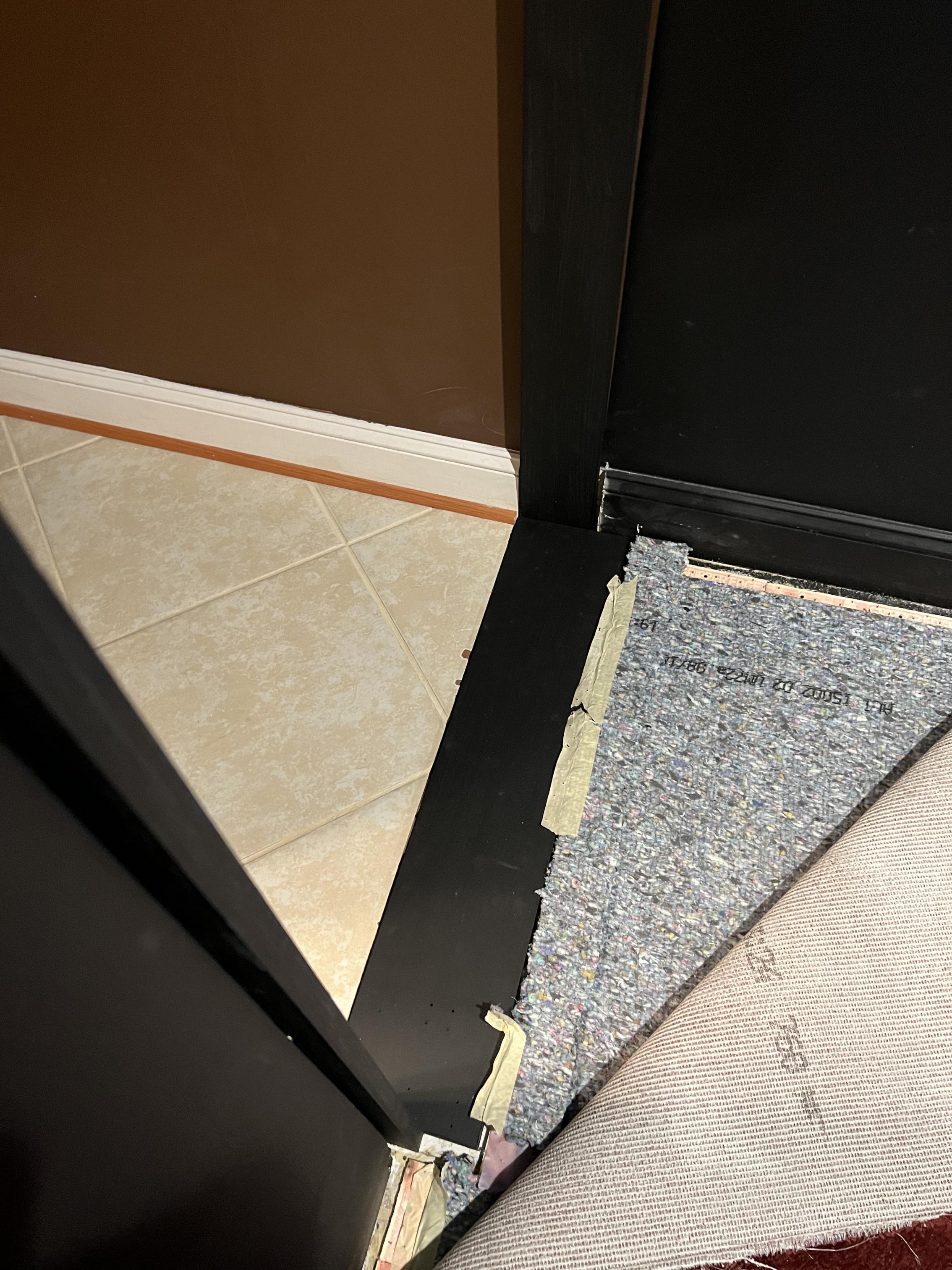

      What I did learn is how un-level the basement floor is! The left bottom side is 1/4" higher than the right and I had to shim the right side to get it square. I did think about sanding down the concrete, but the amount of dust and mess that would have made prevented that. It did cross my mind though.
      Note the ceiling above in the hallway, I had to add some new blocking above the frame, and that had some pockets installed to screw it in tight to the framing in the ceiling. I will get a new light mounted in the hall as well. That way the movies can be viewed without having to pull out a flashlight!

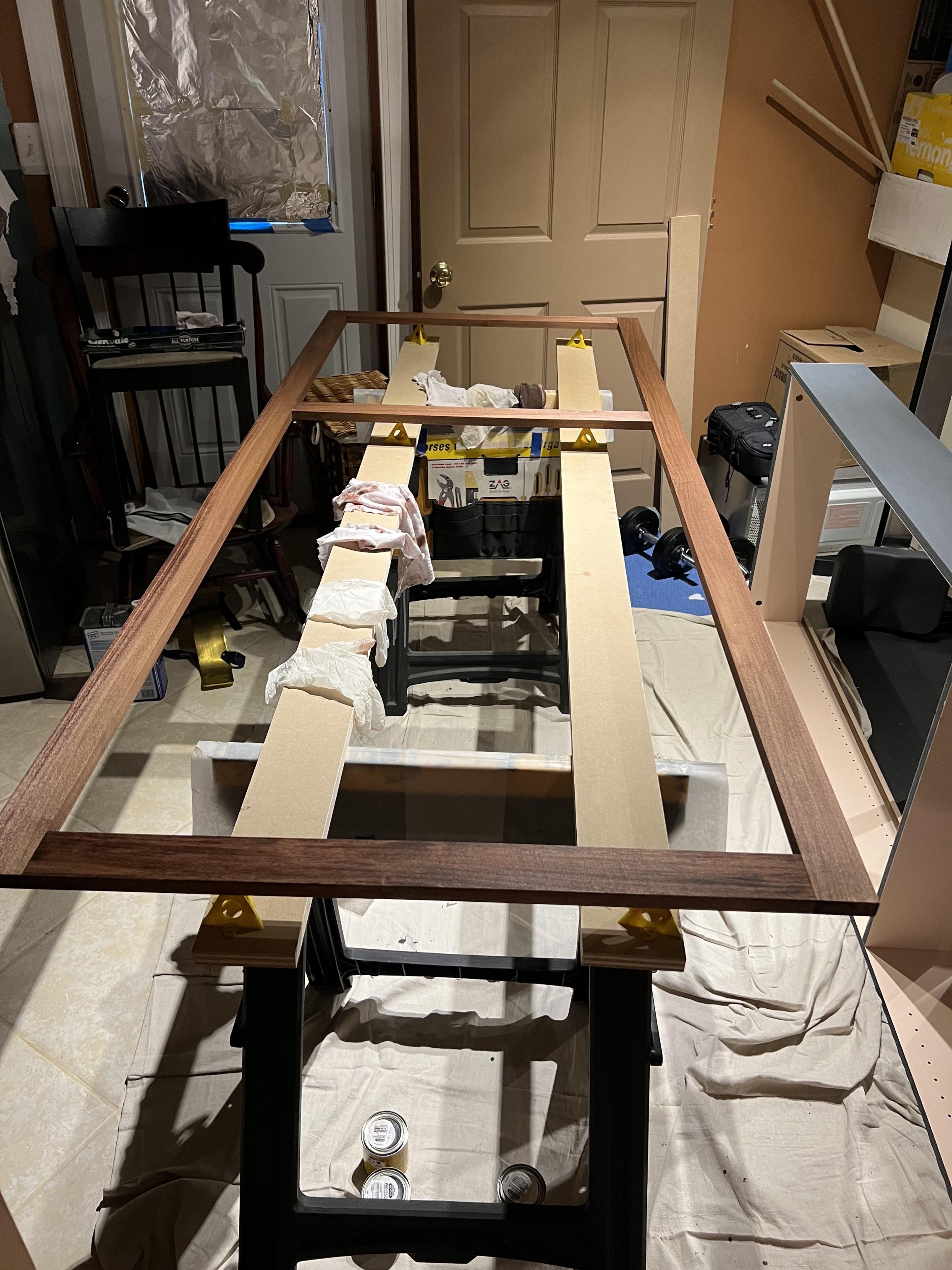

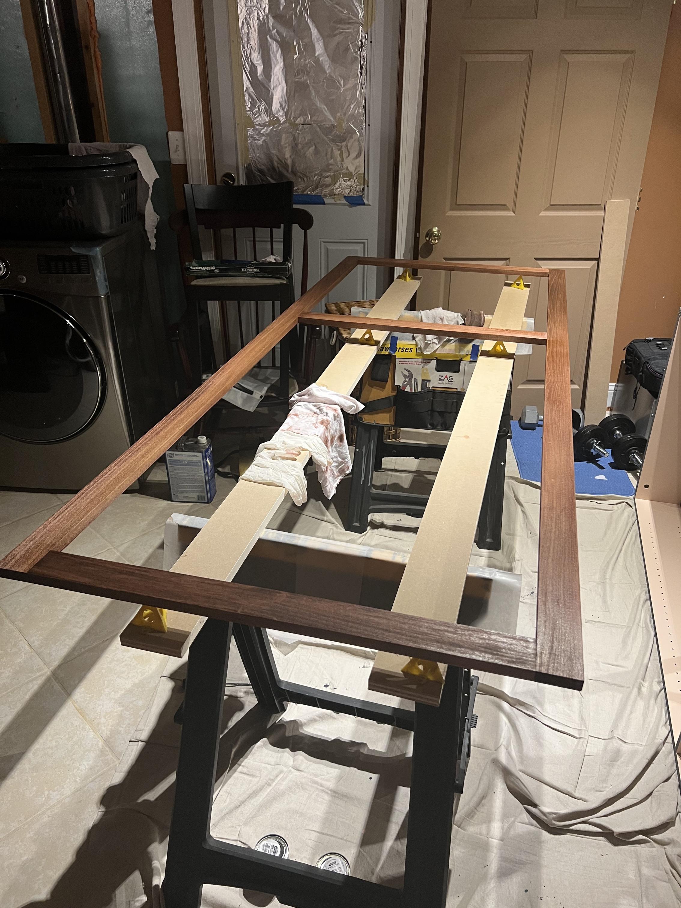

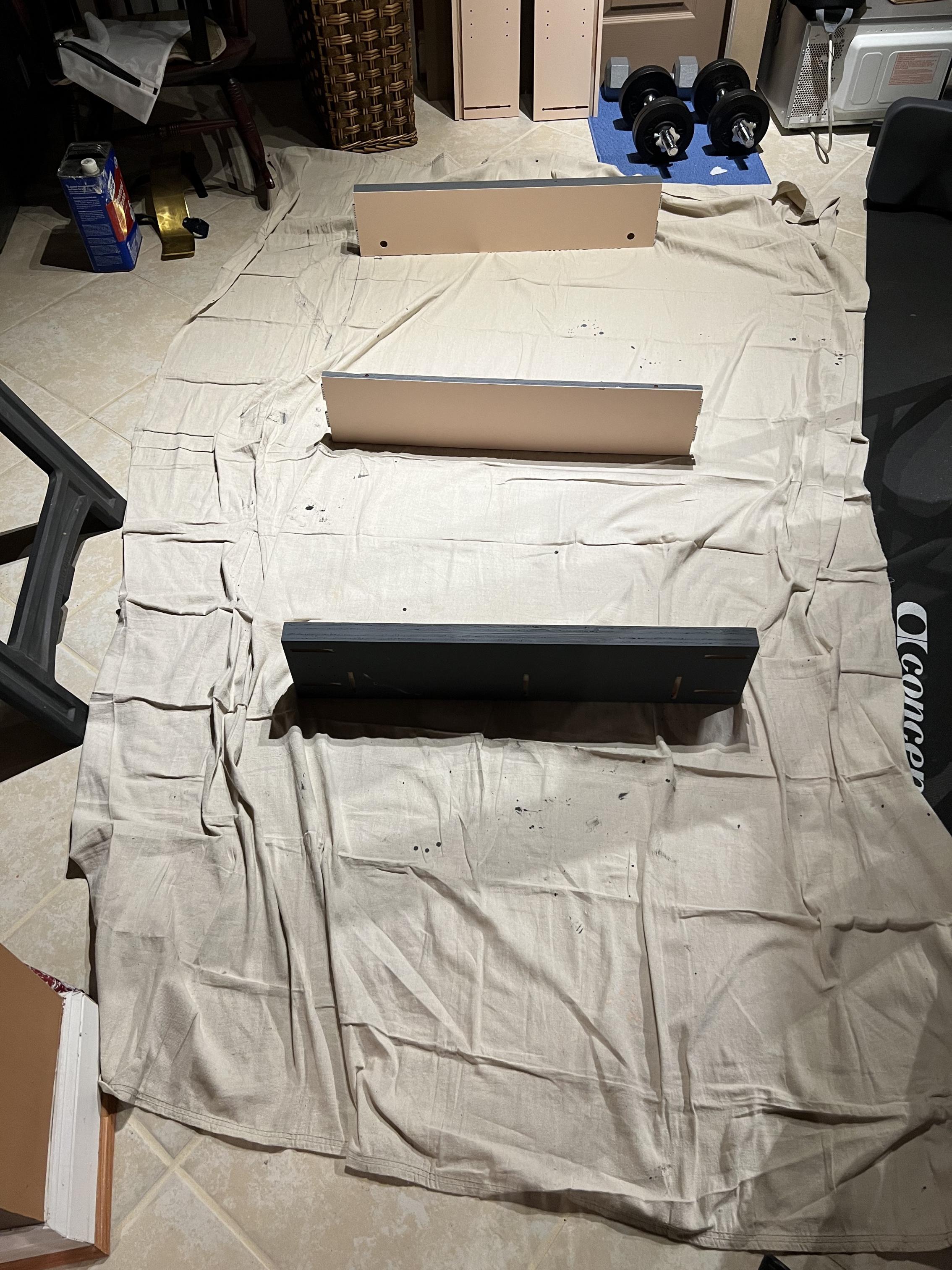

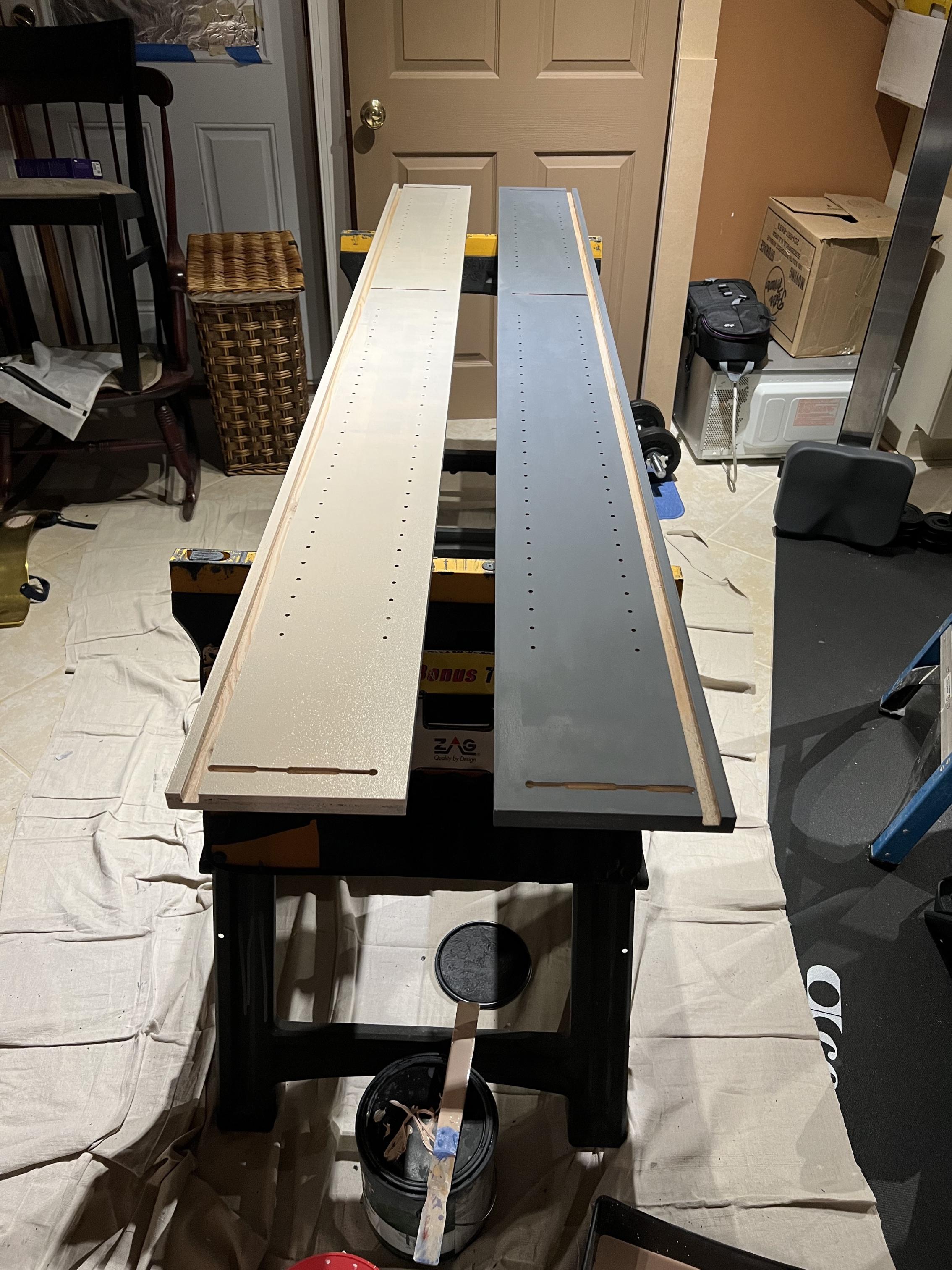

        After the frame went in I had to travel for a a week. Once I got back I started sanding and painting the cabinet. I used the same primer again and I chose to use the extra Sherwin Williams peach I had left from painting a bedroom.

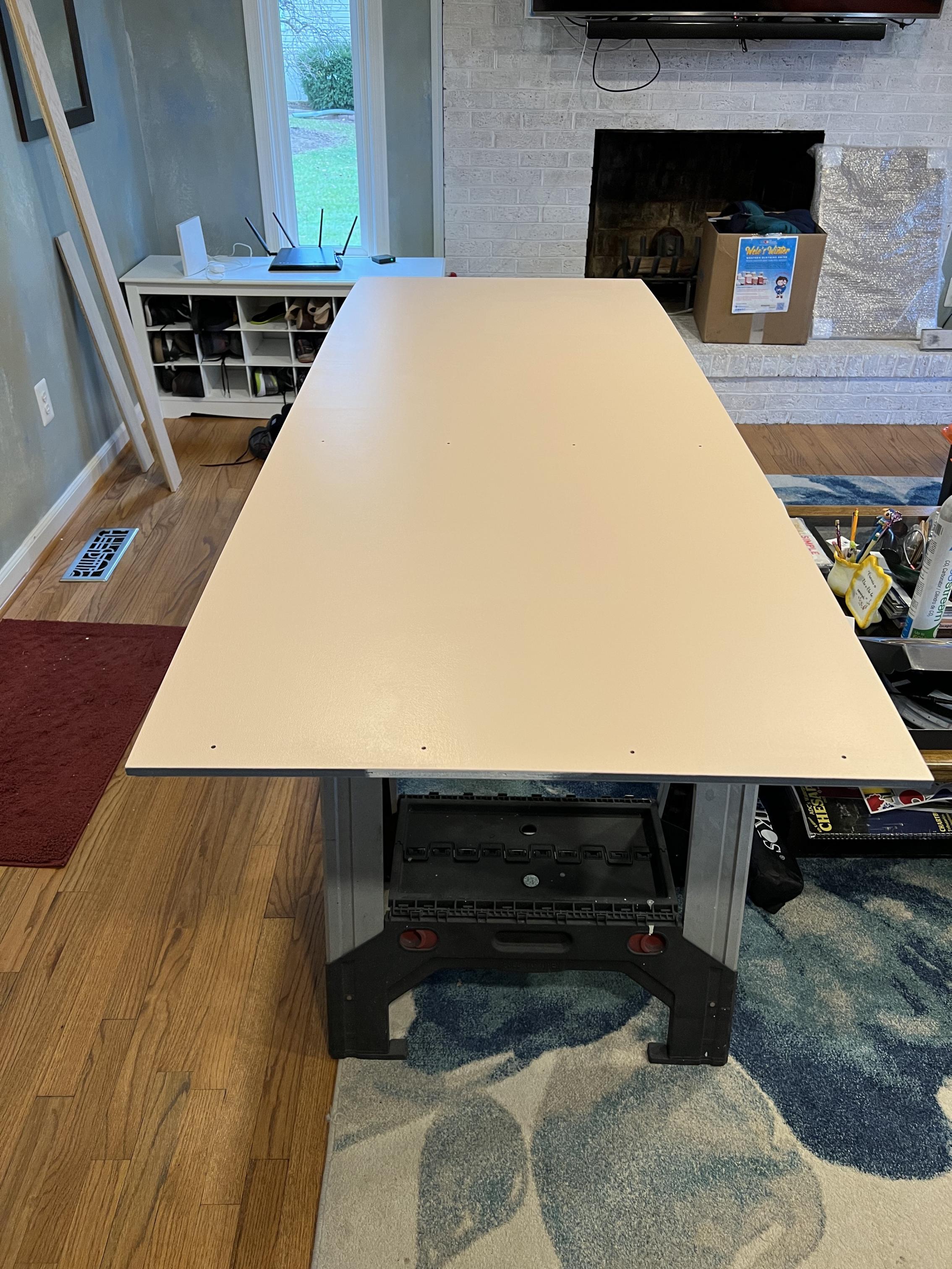

        With the pieces being rather big I used the basement and the living room to paint. On top of the painting I decided to seal and stain the front trim piece to the cabinet. I really liked how it turned out too!
        I put 1 coat of sealer and stain on. Then I put 3 coats of clear coat on and sanded with 1000 grit paper. It's silky smooth and I'm very happy with how this turned out! Next up was getting the cabinet assembled. That was a challenging process because I could have used some help to hold pieces. Oh well, lets keep that in mind for the next time I do this.

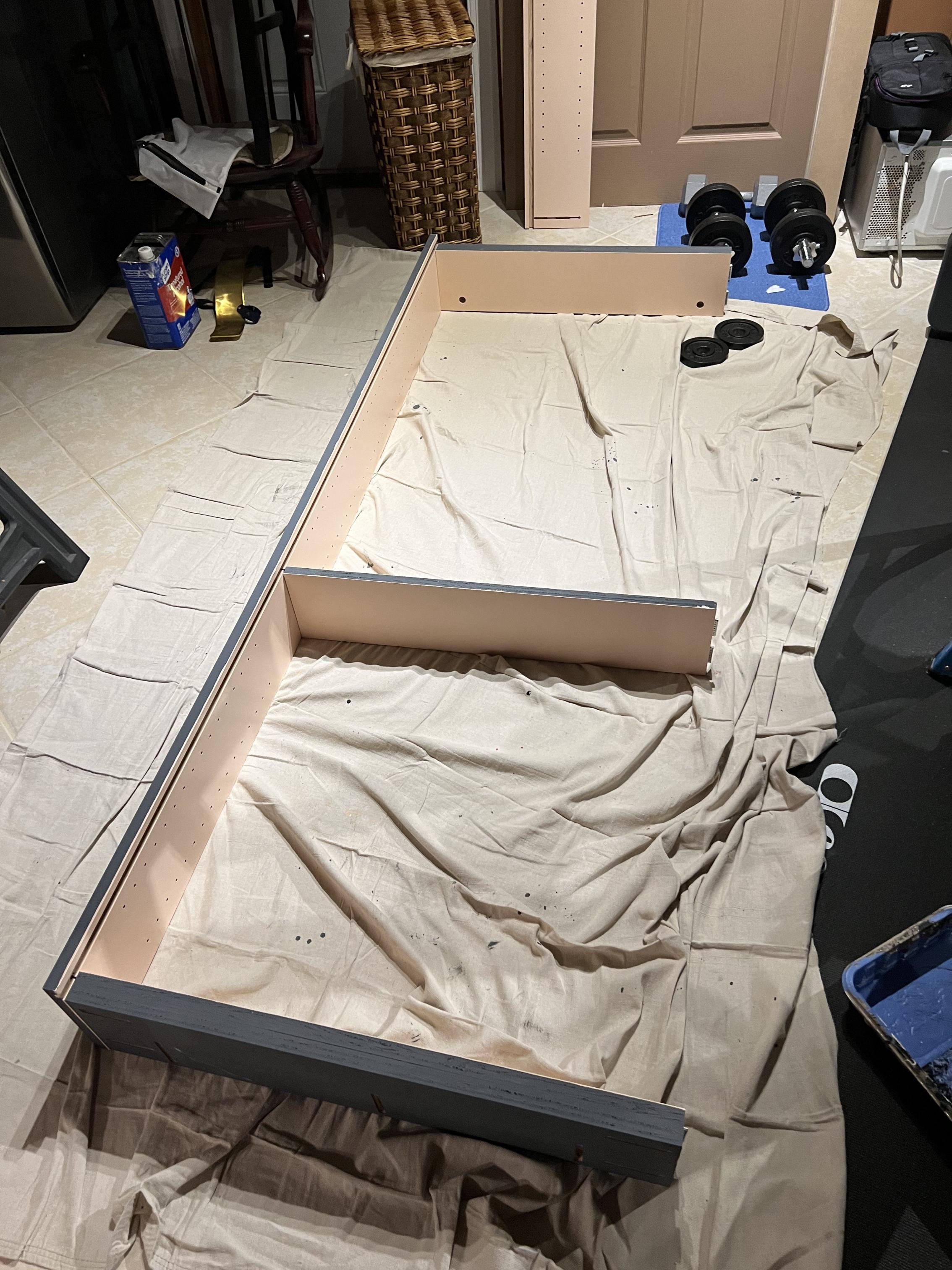

                The assembly started like any assembly would start, get the pieces lined up to start making the case.

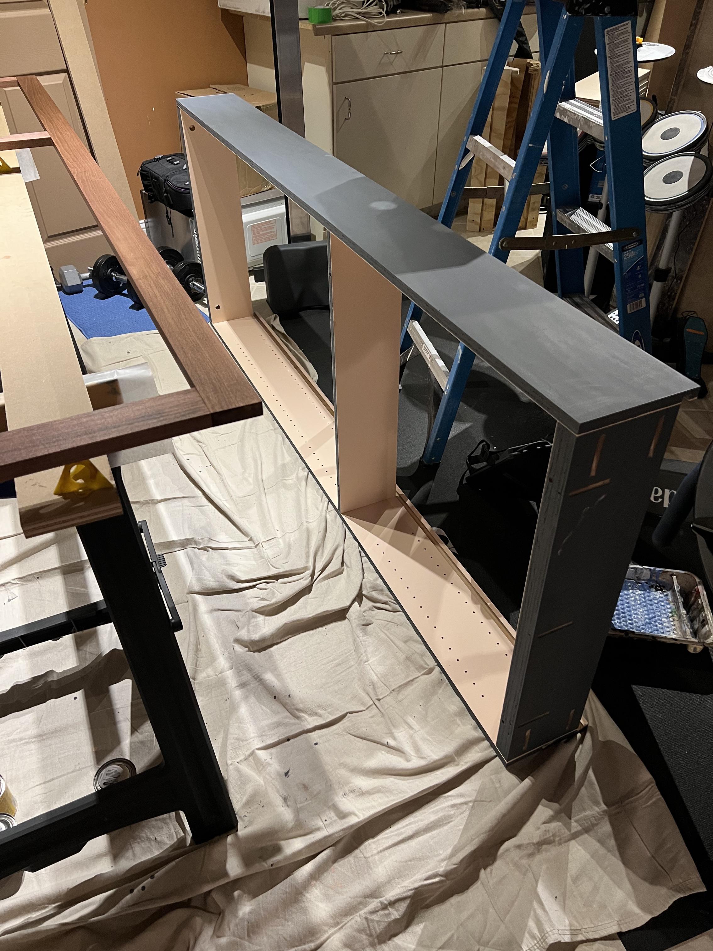

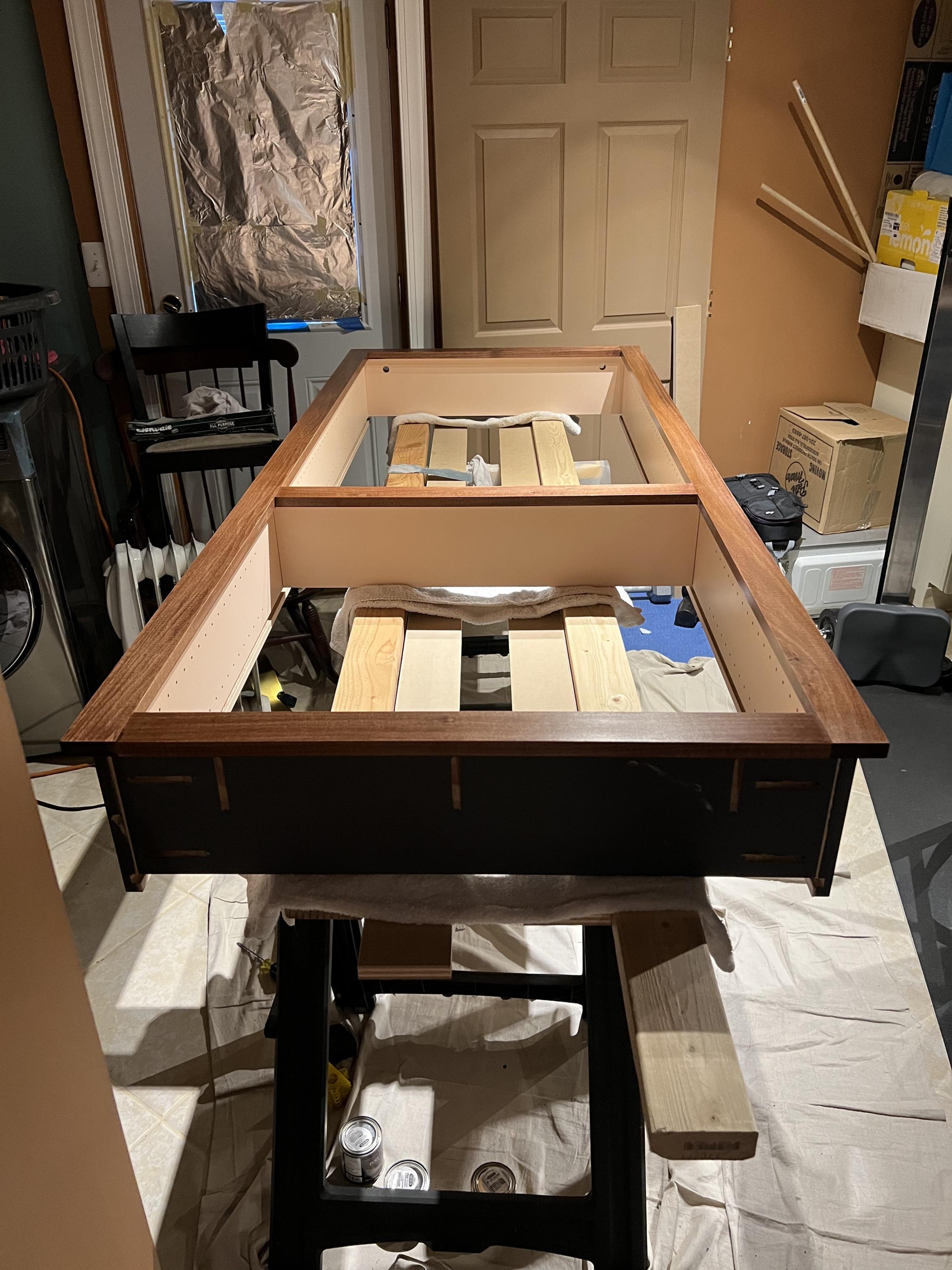

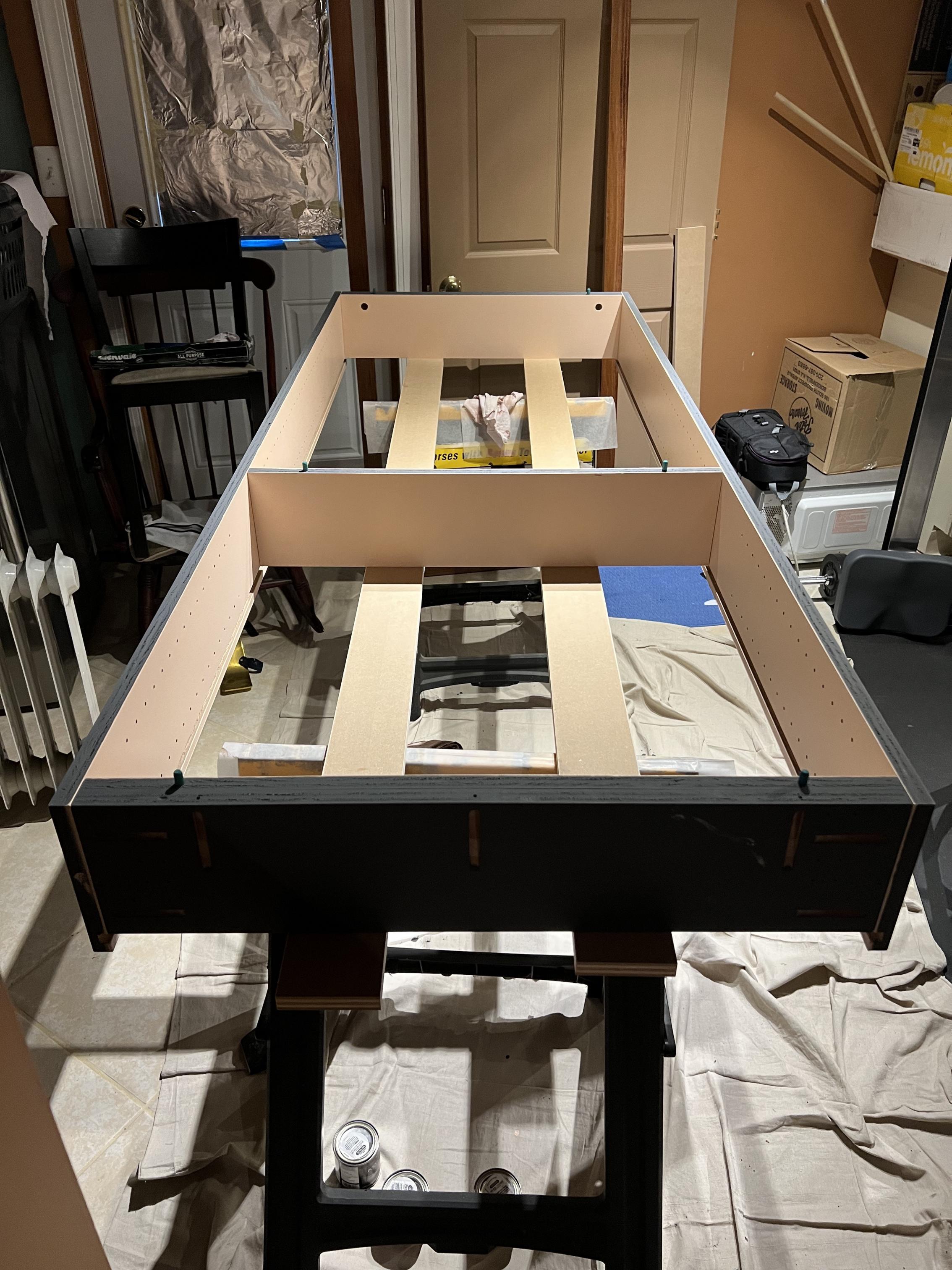

                Lined up the top and bottom along with the middle shelf. The top and bottom are double thickness. The wood is mdf on the top and bottom with plywood in between. After these three pieces were in the general area the sides are up next.
                Notice the slot on the top of the side, there is a slot that the three pieces needed to slide down into. I was able to use my strength to get the left side one.
                Clearly forgot to take a photo of installing the other side, but that happened and while it was laying on the side the clear coat was getting applied to the front trim piece. The cabinet went together nicely though, I wonder why they went with the metal inserts vs pockets and biscuits?
                One the clear coat was applied and sanded with 1000 grit paper the small little wooden pegs were glued into the case. Next up is gluing the trim piece on.

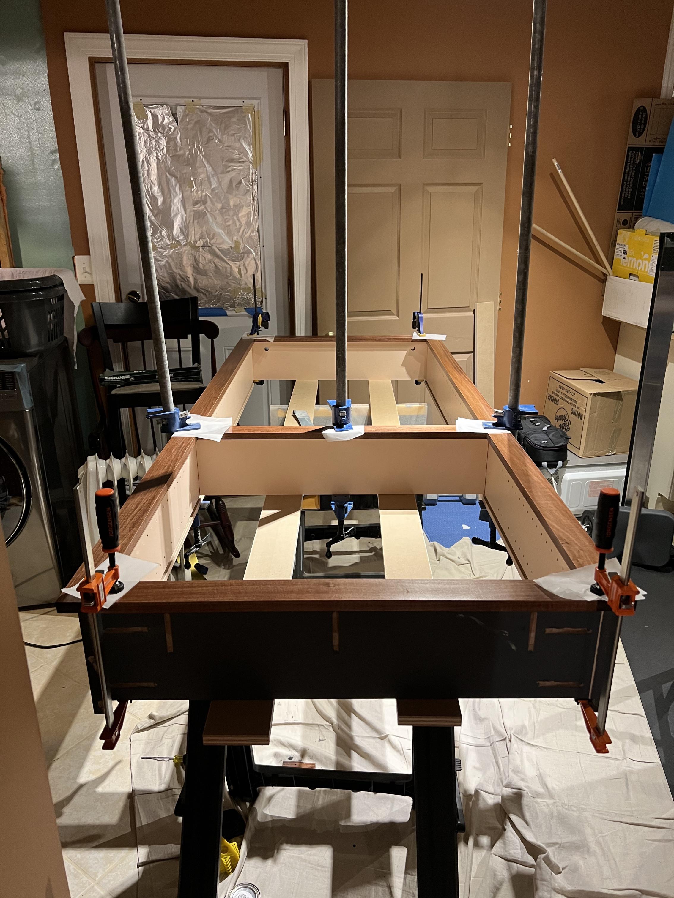

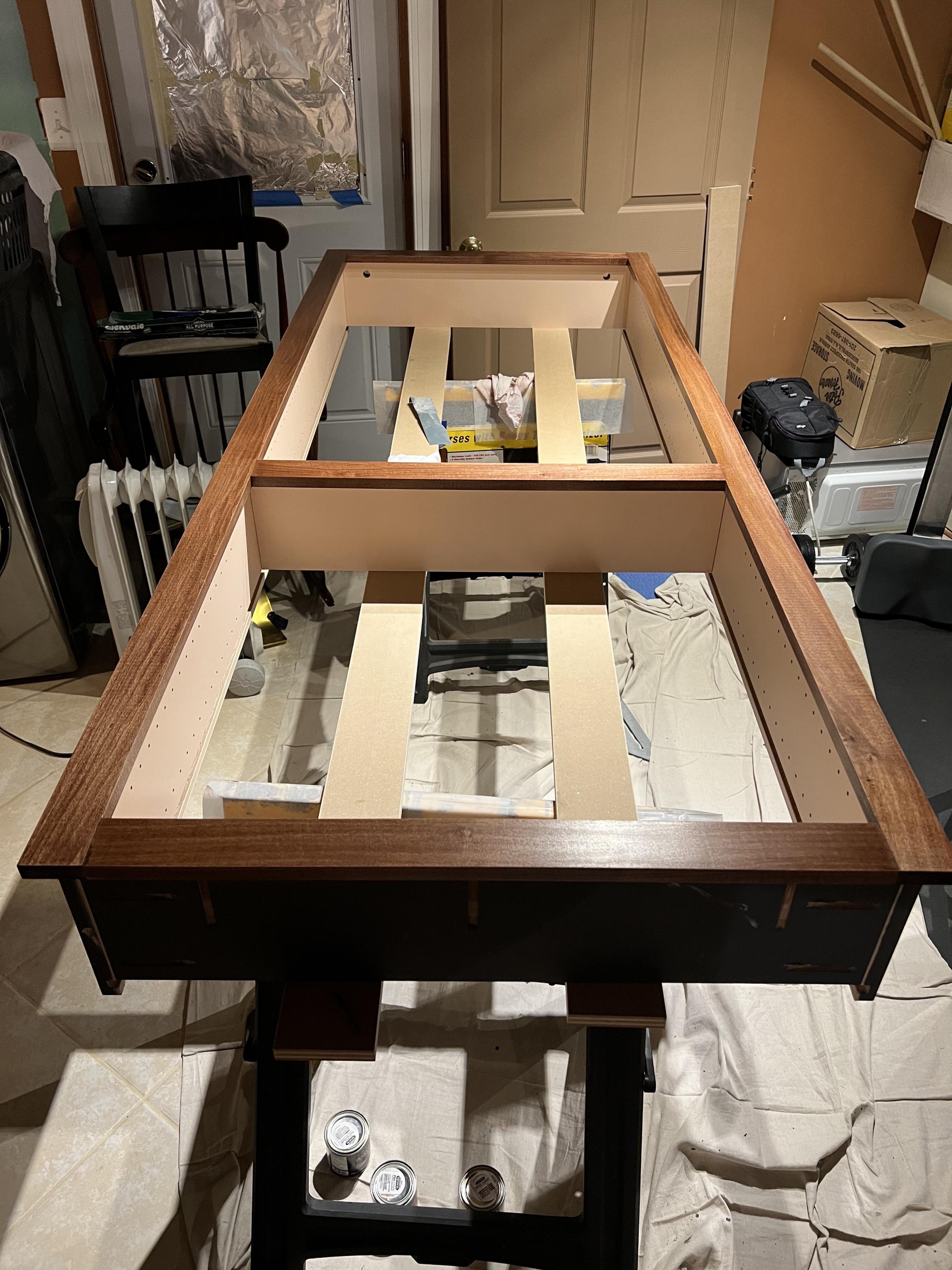

                  The instructions called for putting wood glue around the top of the cabinet and then applying the trim piece. Everything did line up perfectly when the two pieces were mated.

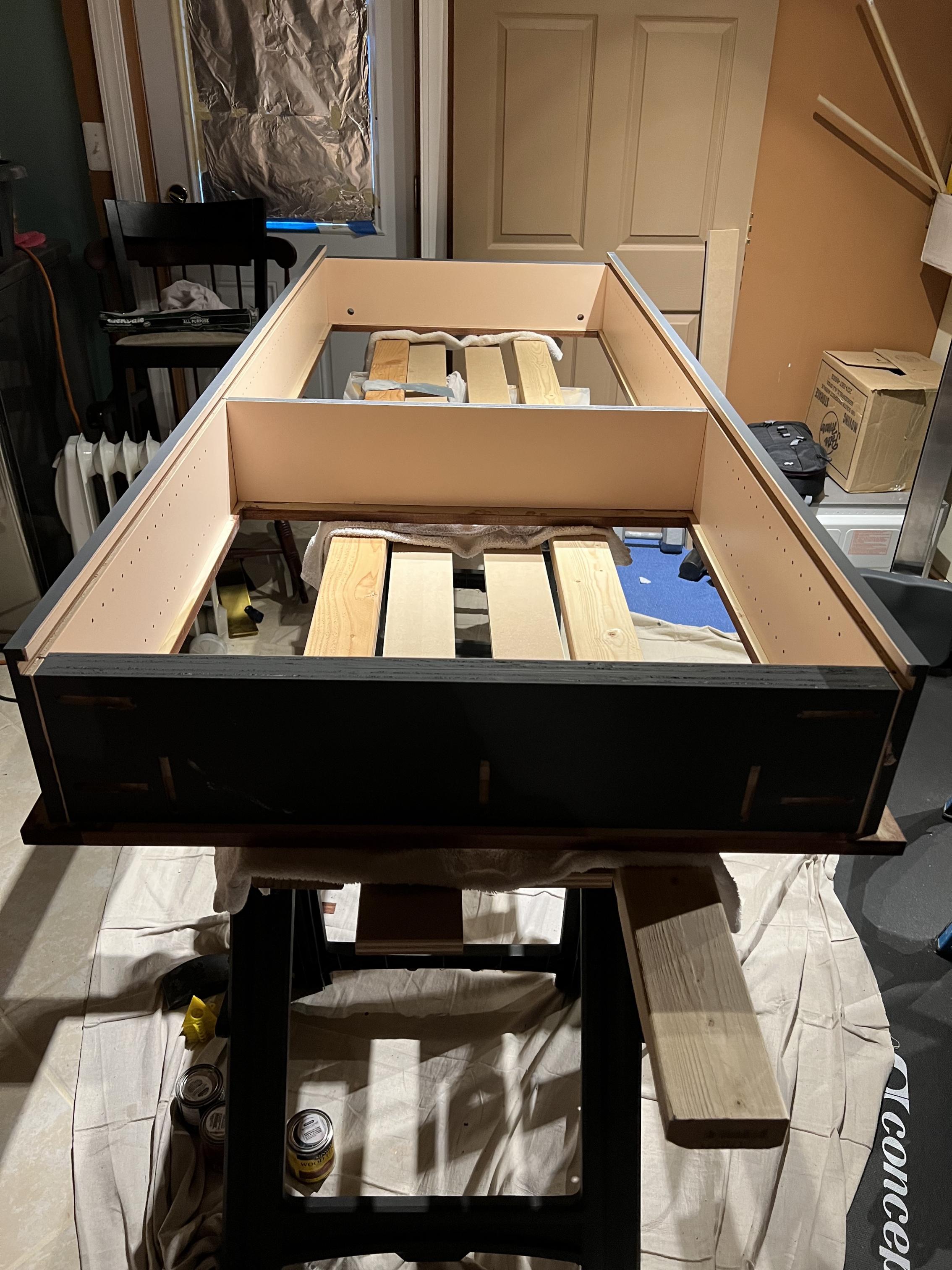

                  At this point it's the trim is glued and clamps should be applied. I don't have enough of one size of clamps so I used everything in the inventory that would work for the cabient.
                  The clamps were left on for 24 hours and then removed. I put wax paper under the clamps because I didn't want anything to stick or ruin the clear coat.
                  Clamps removed now that it has been 24 hours and I also inserted 2 2x4's because I wasn't sure if the other pieces I was using would hold up from the weight. The next step required flipping this thing over. Unfortunately no one was at the house that day to help. I was able to lift the cabinet off and then gently get it back on the stand by myself. It would have been much easier to do with a second set of hands.
                  At this point I had to wait for my son to get home from school to hold the cabinet so I could slide the back board into the cabinet. Once he got home I was able to insert the back.

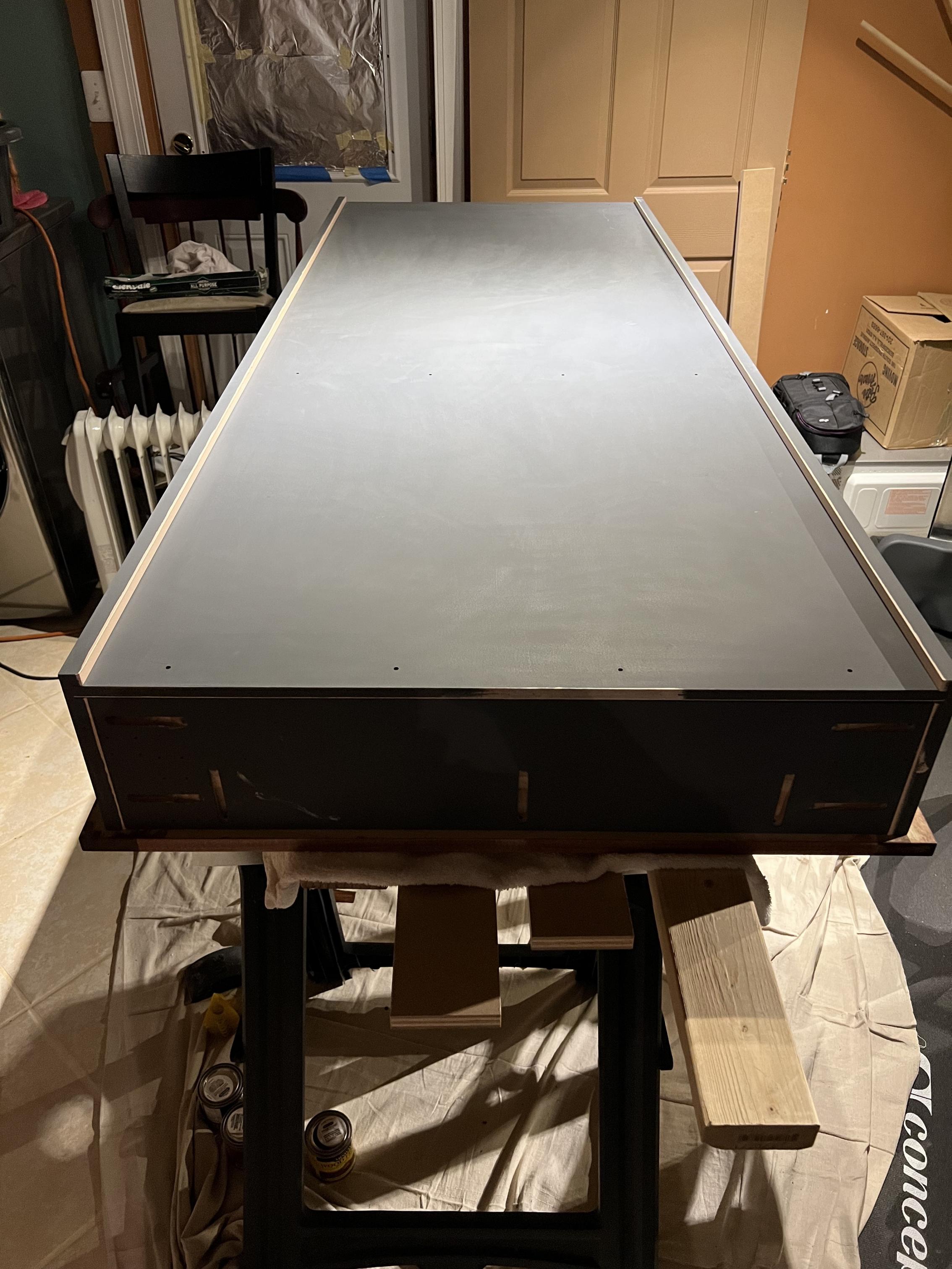

                  Next up was painting the outside black using the same paint as the theater walls with a soft sponge roller.

                    I was in a bit of a rush to get the outside of the cabinet painted black during the week. My biggest wish was that the weather was warmer to have sprayed the paint on instead of rolling. I guess if this still bothers me that bad I can do that in the spring when it warms up enough to paint.
                    The cabinet outside paining is completed and the hinges are mounted to the top and bottom of the cabinet.

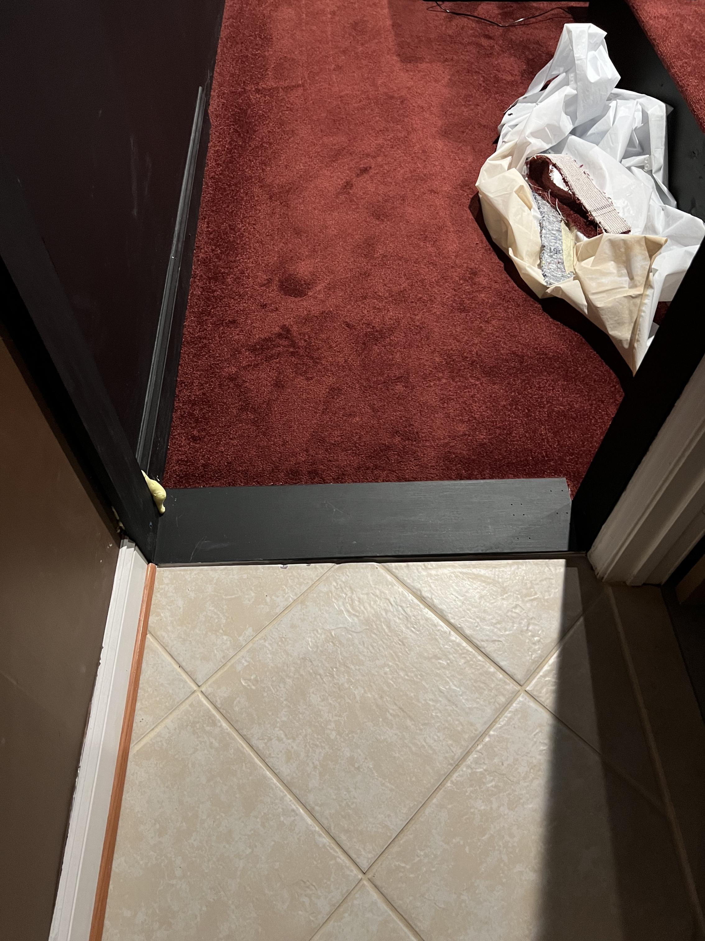

                    Foam to cut from sealing the door frame, and the carpet stretched back down nice and tight against the door jam. The door frame may look a little un-level, but that is the floor of the basement, that door frame is square which is critical for the door to open and close properly.
ID:	927380 Another view from inside the theater of the carpet put back together. Notice a little white caulk on the left side of the frame? I need to paint that black still. Yes I did remember to use paintable silicon! I learned that lesson many years ago 😂.

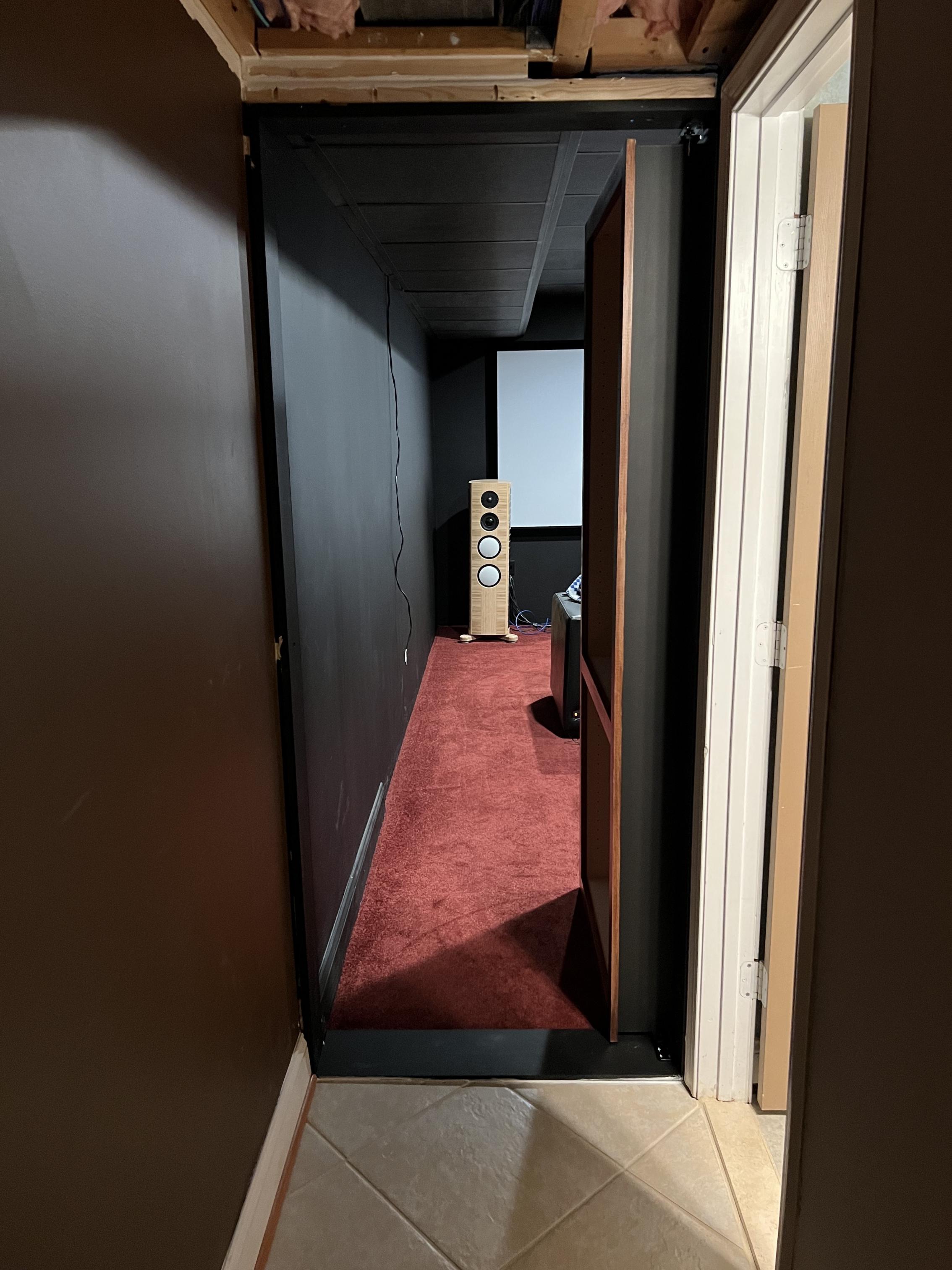

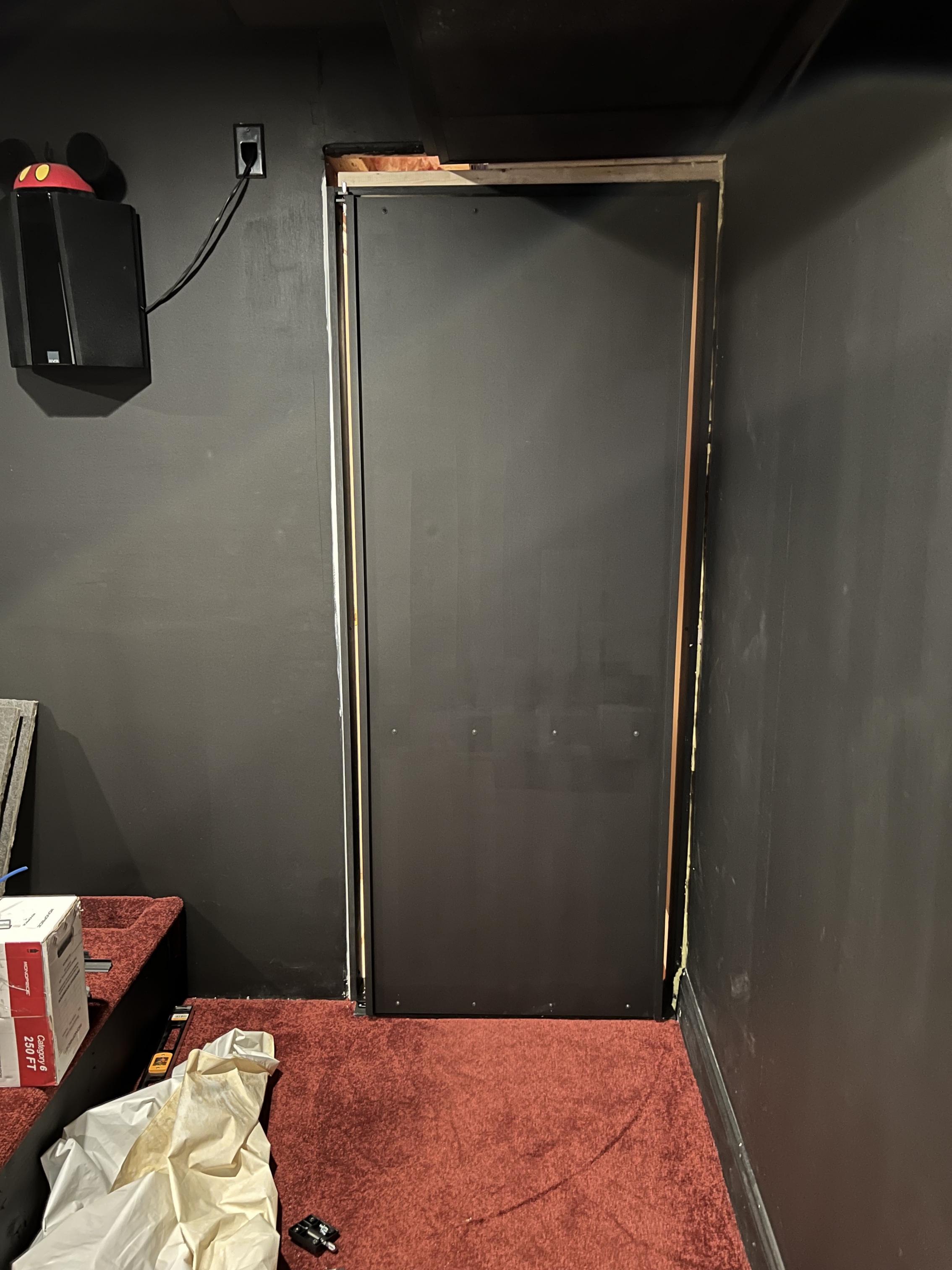

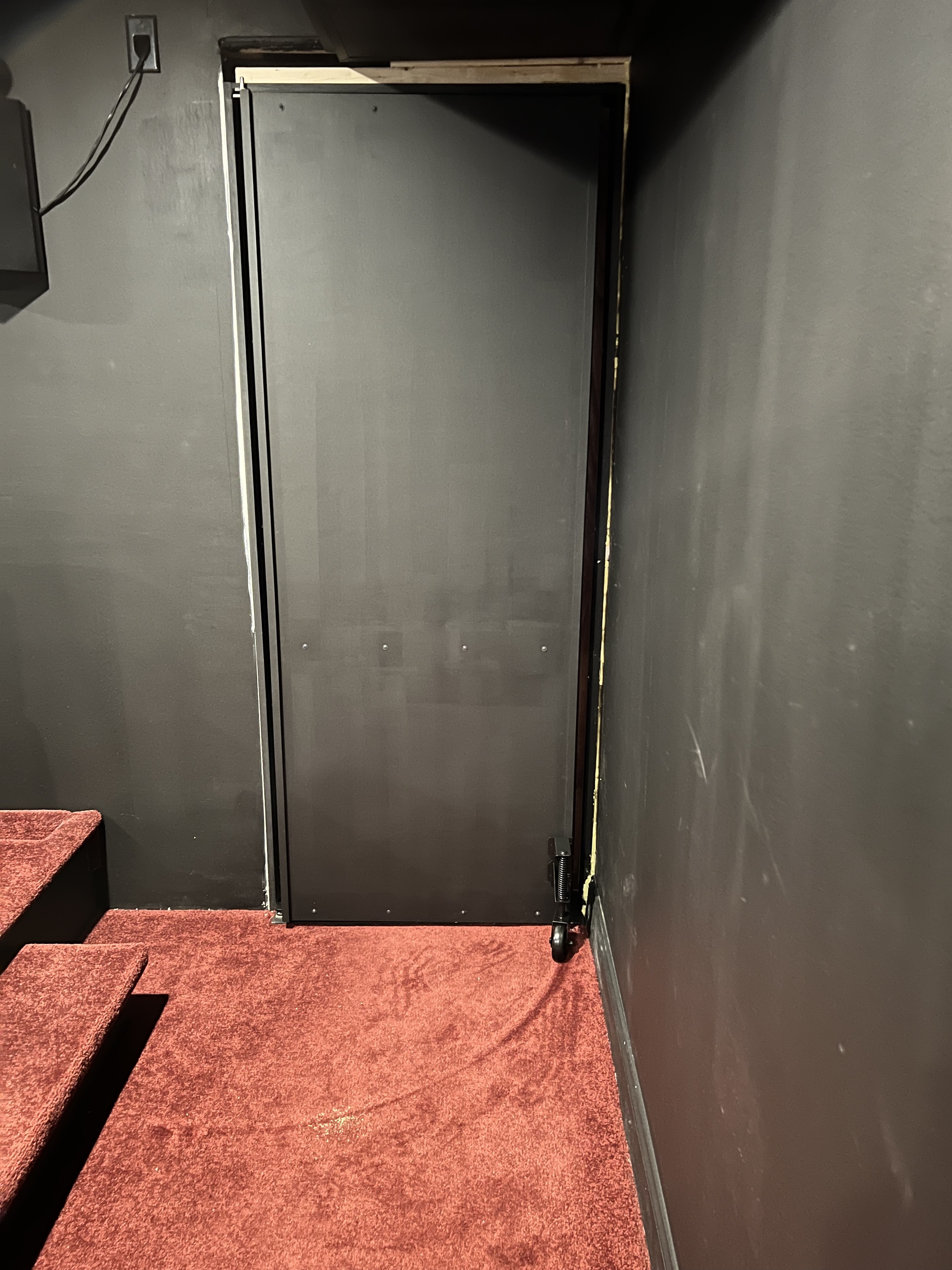

                      The moment I have been finally waiting for to get the door mounted!
                      The door mounted or hung smoothly for the most part. I had to take it inside the theater and then seat it on the hinges. Getting the trip on the outside is going to be interesting. The trim that is sent in the kit is to large for the space left to work with the door mounted. My plan is to get some wood similar or the same if I can find it like the outer piece and install that instead. I can use the same stain and clear coat to make it look nice. I will need to rip the trim on the door to the right for the trim on the right side of the bookcase.
                      Inside the theater the door doesn't look to bad! Still need to paint the caulk on the left there and clean up the dust mat from when I was removing the tile strip. The light leaking through the top will be addressed when I get the top trim piece installed and the ceiling put back together. I'm thinking to cut a piece of wood and paint it black. I'm looking forward to being able to get the mic out and test the room with a door now. I will be able to finally get the rest of the room treatments figured out and cross that off the list.
                      This is what it looks like with the door open. If I need to move in a new chair the door easily pops out. Things to complete next are:

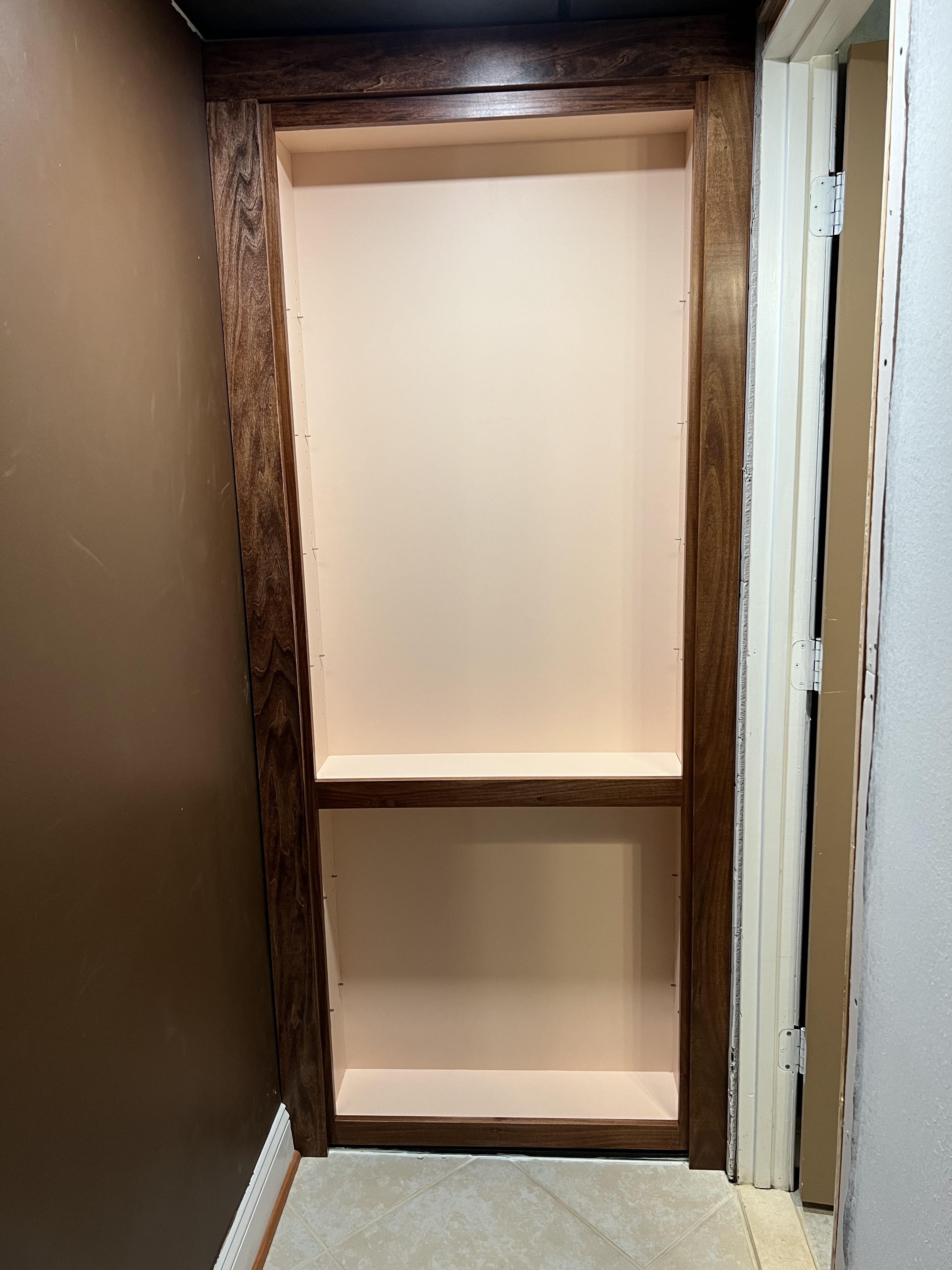

                              This project is about to reach completion. The door is mounted, and the trim on the front installed!. Tasks left are touch up painting, trim on the bathroom door (to the right of the hidden door), getting the door to close easier with the support thing mounted on the bottom left of the door (the side that opens), and installing the ceiling tiles in the short hallway.
                              I was debating how to attach the trim to the frame not wanting to use brad nails. Then it occurred to me one evening somewhere around the world that I should use pockets. This was a good call, with the trim installed the opening is just under 30". With pockets I can easily take the trim on and off for getting new furniture into the theater room.
                              Click image for larger version  Name:	pockets-right.jpg Views:	0 Size:	2.38 MB ID:	930862 Click image for larger version  Name:	pockets-left.jpg Views:	0 Size:	2.17 MB ID:	930863
                              The trim attached
                              Click image for larger version  Name:	trimInstalled.jpg Views:	0 Size:	2.84 MB ID:	930861
                              This is how it looks with the door closed
                              Click image for larger version  Name:	doorClosed.jpg Views:	0 Size:	2.95 MB ID:	930859

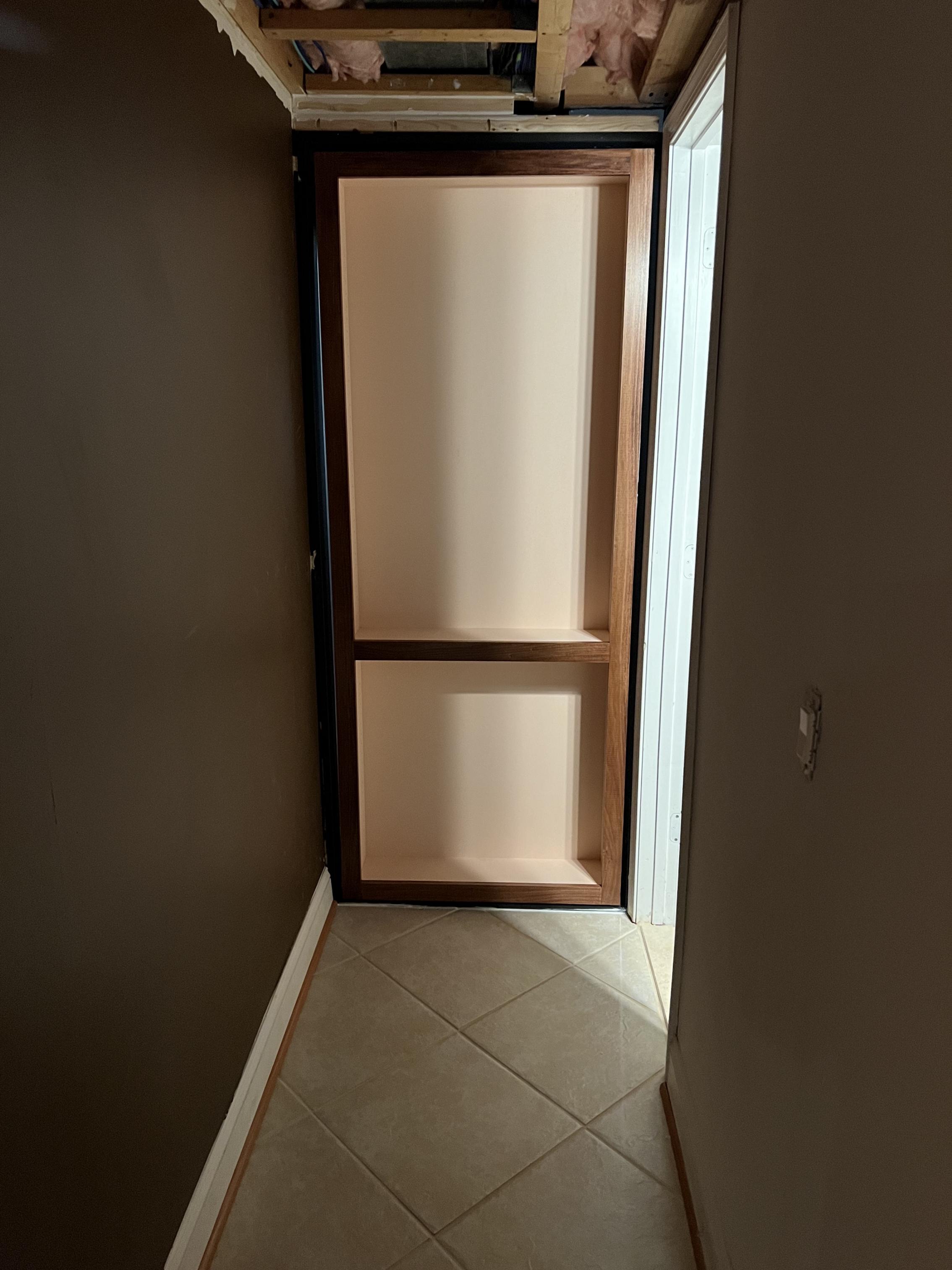

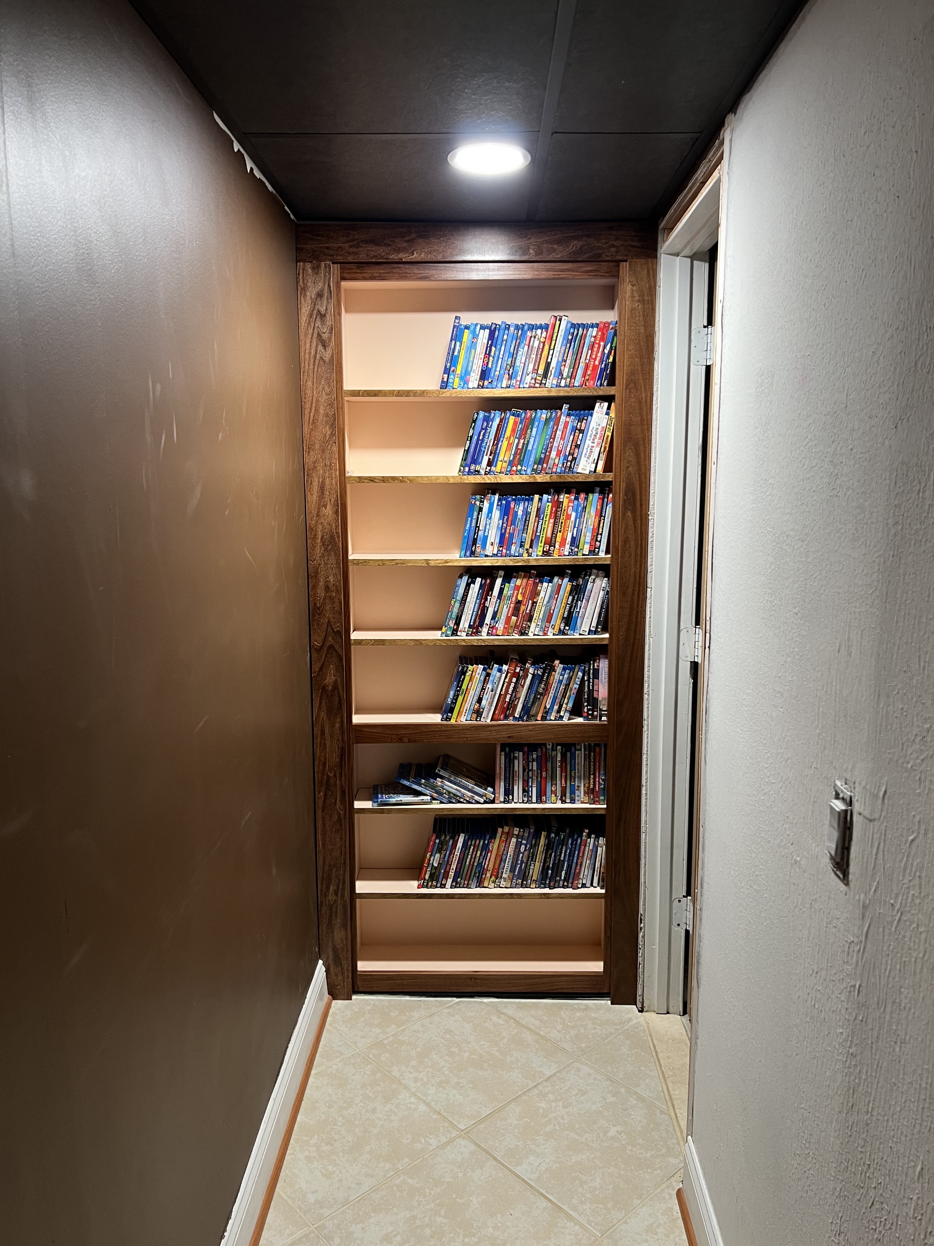

                                Long over due for an update. I'm finally in town for 2 weeks now with no travel. One of the big delays with completing the door install was the uneven floor of the room! The pin that goes into the side of the door did not work well to the point the door could not be closed unless you put some wood under the pin to compress the pin when the door was closed into the jamb. I spent time looking at solutions that would work and ended up settling on this gate wheel attachment. It did the trick perfectly, the door opens and closes beautifully. I have to get the little things done now, touch up paint, paint some wood black to install on the top of the door jamb, and install new trip on the door adjacent to the theater door.
                                The door closed from the outside of the room. Great for storing lots of discs that I enjoy watching with the family and friends that stop over. Trim on the door adjacent shall be a summer project. I should also consider re-painting the hall now and texture the wall. I've come to like textured walls in the basement.

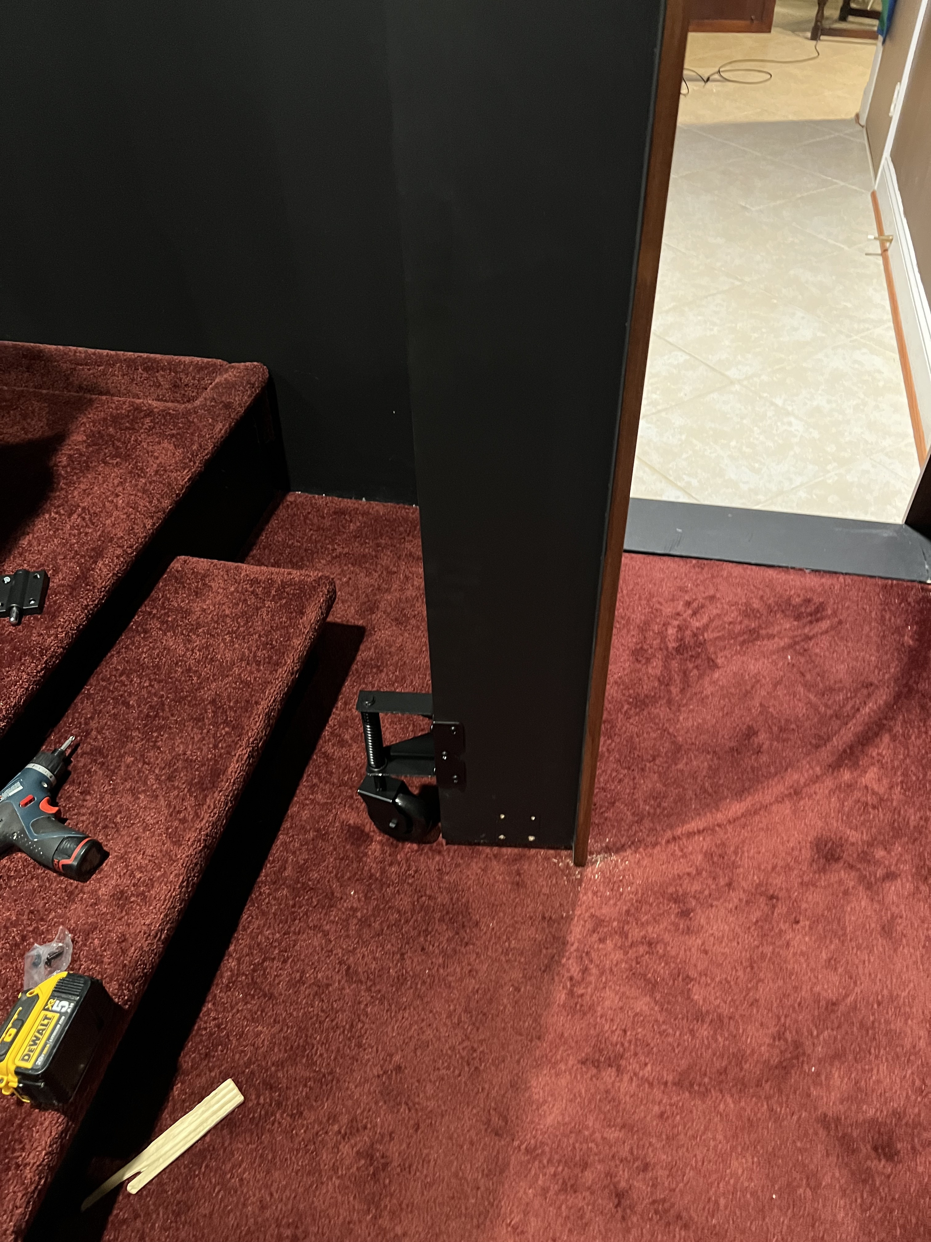

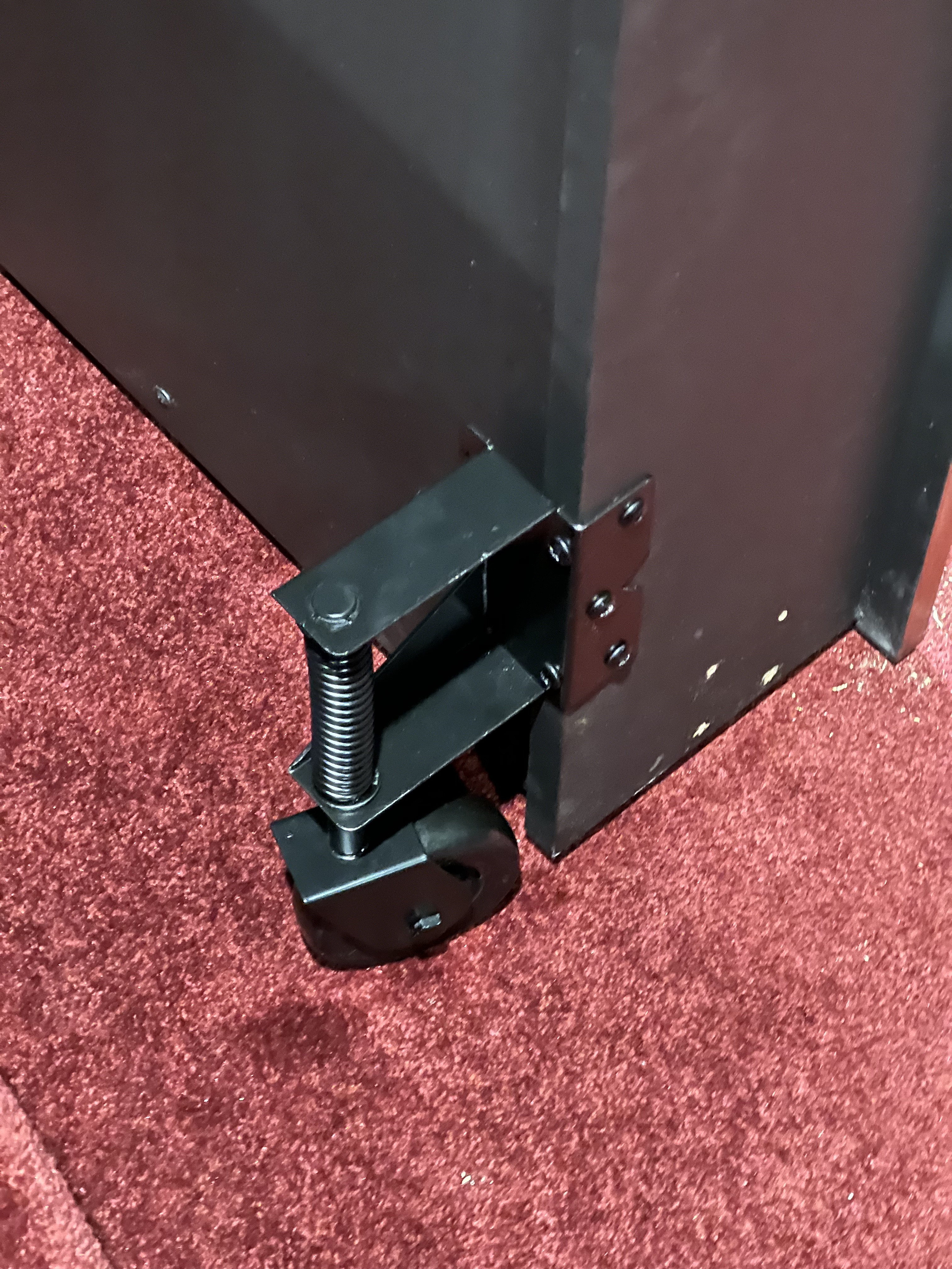

                                The door opens an closes nicely with the wheel installed. I pre-drilled the holes and then used the driver to secure the screws. Touch up paint is required where the pin assembly was attached. I realized after taking the photo I forgot to vacuum first... The floor was cleaned after the photo shoot!
                                A close up of the wheel, there is a spring to account for weight on the shelf...
                                The door closed from inside the room. Notice above the door I need to install a trim piece and paint that black to match the interior wall color. The white caulk line could use some black paint too. The right side of the door jamb may end up with a trim piece there panted black too.
                                Now that the door can easily be opened and closed I need to finish up a few final tasks. The next project I would like to pursue is some wall treatments from the room. I'm still deciding on what parts I want to DIY vs purchase...
