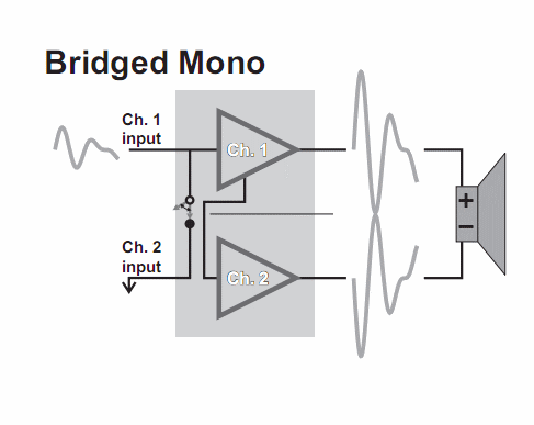

                    Hi, I am new to this but I am learning. What do you mean by bridging?
                    • stuofsci02
                      • 1241
                      Bridging it where you take two channels of an amplifier and tie them together (bridge them) to drive a single load. In essense this doubles the output voltage. Assuming the amp has enough current capacity it is said that this can mean 4 times the power output. In most cases this is not accurate however. If the amp was stable into an 8 ohm and 4 ohm load non-bridged it really should only be used on a 8 ohm load bridged.
                        So how would I do that with the CA5300? Any place that you can refer me to - like with pictures?
                        • stuofsci02
                          • 1241
                          I would doubt that you can do it with the 5300. The manufacturer has to design the two bridging channels to be backwards from each other and then usually will have a bridge switch. This is often done on stereo amps so that you can run them in Mono. I have not seen it done on a Multichannel amp before.
                              Actually, it can be done with most amps that are not already bridged internally. All you have to do is provide an inverted signal to one channel and a non-inverted one to the other. In the old days, there were adapters available to do this but, today, it is most easily done with balanced input amps by switching the internal wiring in an XLR cable.
                              I cannot recall specifics but, somehow, I think this does exist.
                                When a stereo amplifier is bridged, each channel is driven out of phase to the other, so that one amplifies the non-inverted or positive half of the input signal and the other channel amplifies the inverted or negative half of the signal. The speakers are connected to each channel's positive output terminal. The negative output terminals are NOT attached to anything. In order for an amplifier to be bridged, it must either come with that feature built in, or an adapter can be used, which will feed the non-inverted/inverted signals into the appropriate amplifier inputs.

                                    I just talked to Classe tech support. I am told this amp is NOT bridgeable. My only option is to bi-amp the speakers. Thougght I would pass it along.
                                        Agreed, but modification is necessary (or external device).
                                          The modification is in the external device, a cable.
                                                    Point of clarification...the whole waveform is amplified on the normal and inverted channels (basically mirror image output), not just the positive half and negative half, yes?
                                                      Bridged power is easy to figure based on the amp's non-bridged ratings.
                                                      Say the amp is rated 100wpc @ 8 ohms, 150wpc @ 4 ohms, and 200wpc @ 2 ohms.
                                                      Bridged, this amp would be 200W @ 16 ohms, 300W @ 8 ohms, and 400W @ 4 ohms. Since the example amp is not rated for 1 ohm stereo operation, bridged operation at 2 ohms would not be recommended.
