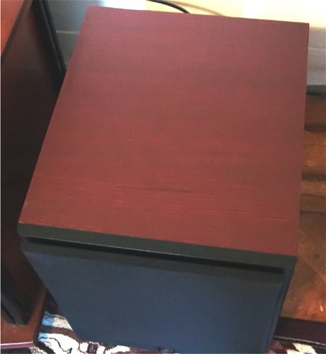

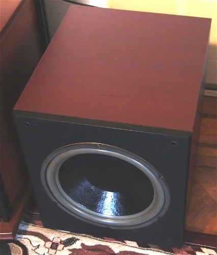

                        Originally posted by bcharlsen
                        I have a Klipsch rpw10 and the sub bottoms out from time to time...i didn't know if i could buy a replacement sub and still use the same box and amp on it.
                        I suggest the Parts Express SUB-120 12" powered sub @ $160.00. I use one for HT/secondary 2-channel music. My only complaint is a loud thump when it is plugged in, but that is something you normally do only once. I covered mine in Parts Express dark cherry vinyl wood-grained veneer to match my main speakers and equipment rack, and it came out pretty good.
