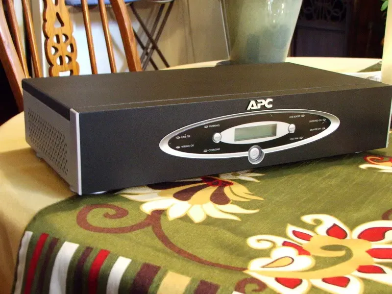

                                                            I finished the 'make-over' for now. I did not paint the plastic endcaps yet.
                                                            Not sure if I will, I'll see how it looks when I get hooked up and in the rack.
                                                            Last edited by theSven; 24 June 2023, 18:28 Saturday. Reason: Update image location

                                                                          That looks really nice. I think the silver ends look nice - I'd leave it like that, myself. Not that all black would look at all bad.
                                                                          John unk:
                                                                          • Thirsty93
                                                                            • Jan 2009
                                                                            • 58
                                                                            Thanks for the tip, Glen.
                                                                            Click image for larger version  Name:	DSCF3357.webp Views:	0 Size:	59.0 KB ID:	942525
                                                                            Dang,I am really impressed with your skills son...Looks AWSOME!! :T

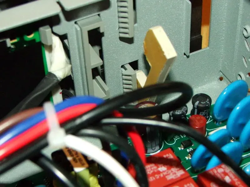

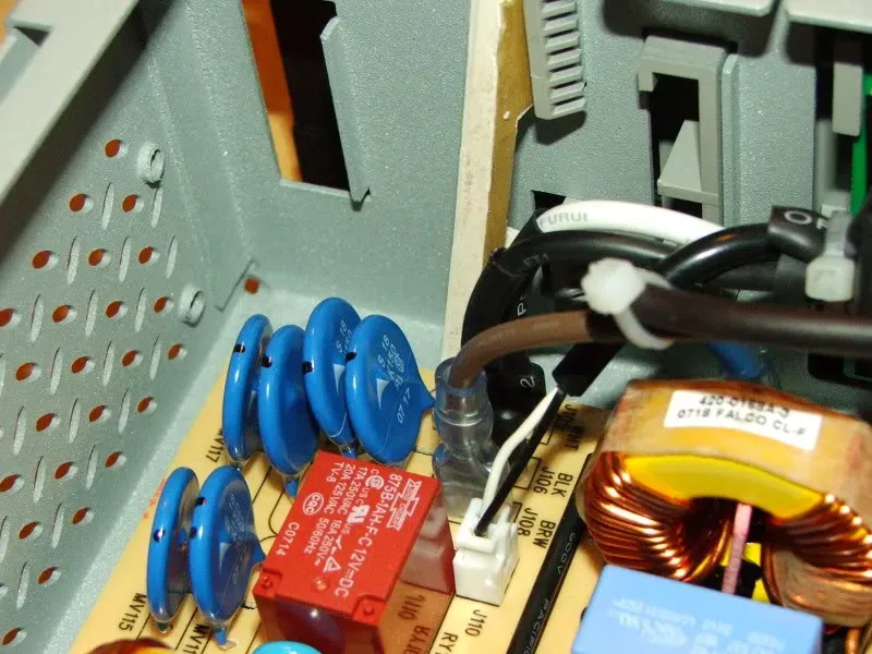

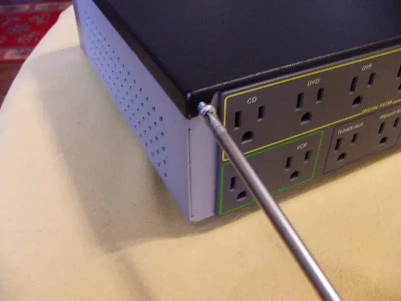

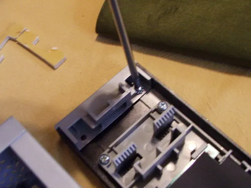

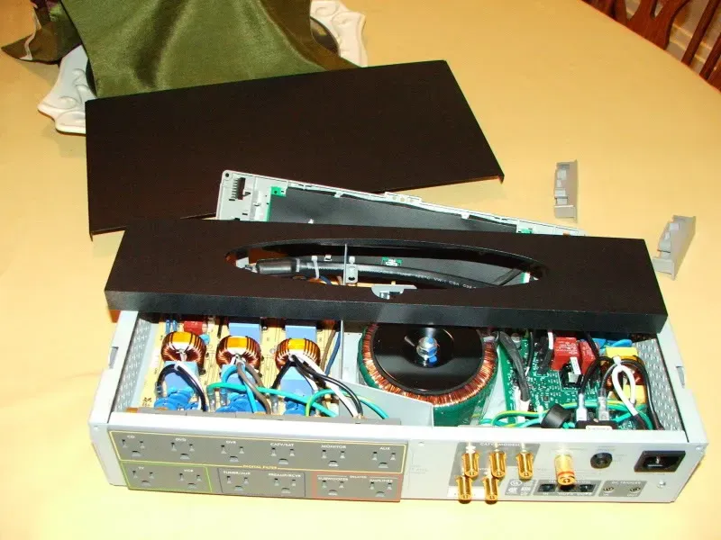

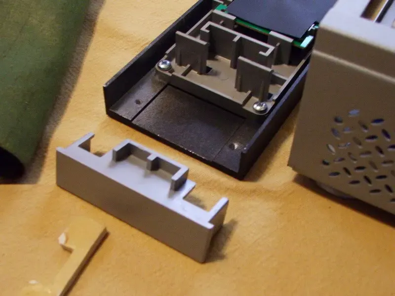

                                                                              How To:
                                                                              I’ve had a few requests, so here is an abbreviated process for performing the make-over.
                                                                              Remove the three screws on the back that secure the top cover, and slide it straight back towards you.

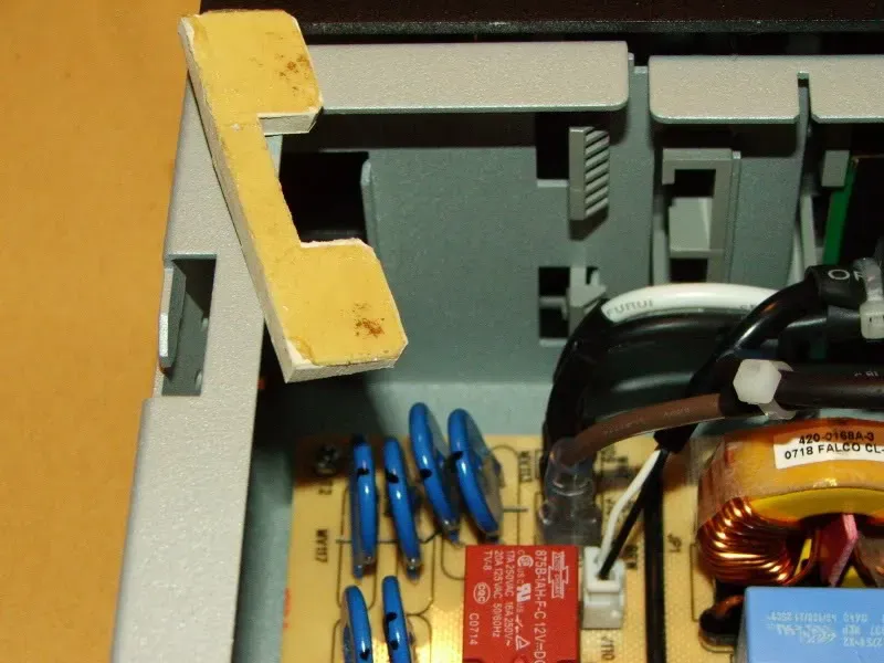

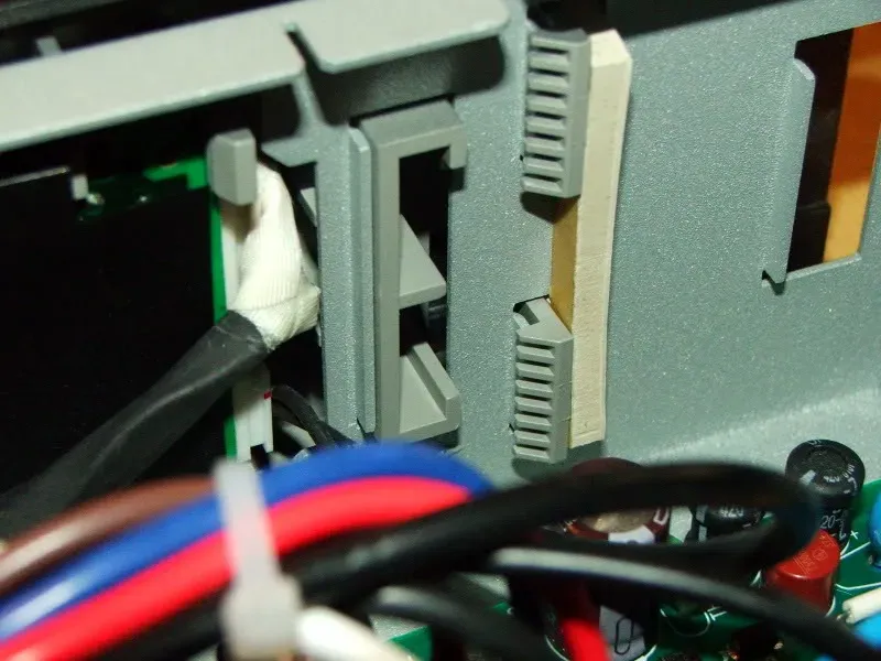

                                                                              With the top cover off, you can see the clips that are on the face plate which secure it to the chassis. There are rubber pads that act as stops which prevent the clips from coming loose.
                                                                              They have adhesive on one side, you need gently pull these away form the clips.

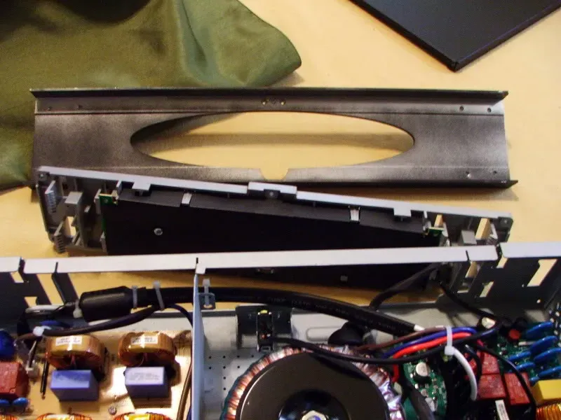

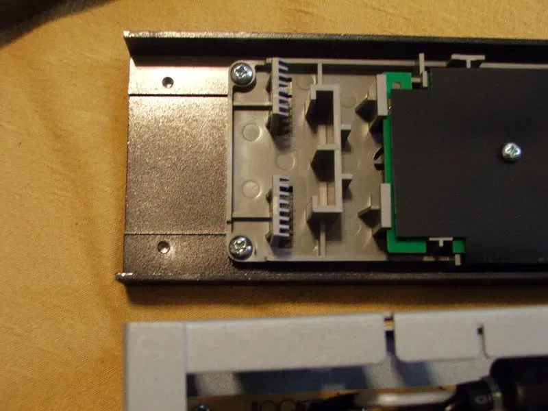

                                                                              I found it easiest to un-hook one side at a time. The clips are fairly stiff, and it takes some pressure to bend them back. You need to do the top & bottom clips at the same time. Once you have one side off, it helps to put a little pressure on the side of the face-plate to help when disengaging the clips on the opposite side.
                                                                              Remove the two screws on each of the plastic end-caps.
                                                                              You can see the clips on the face-plate here, too.

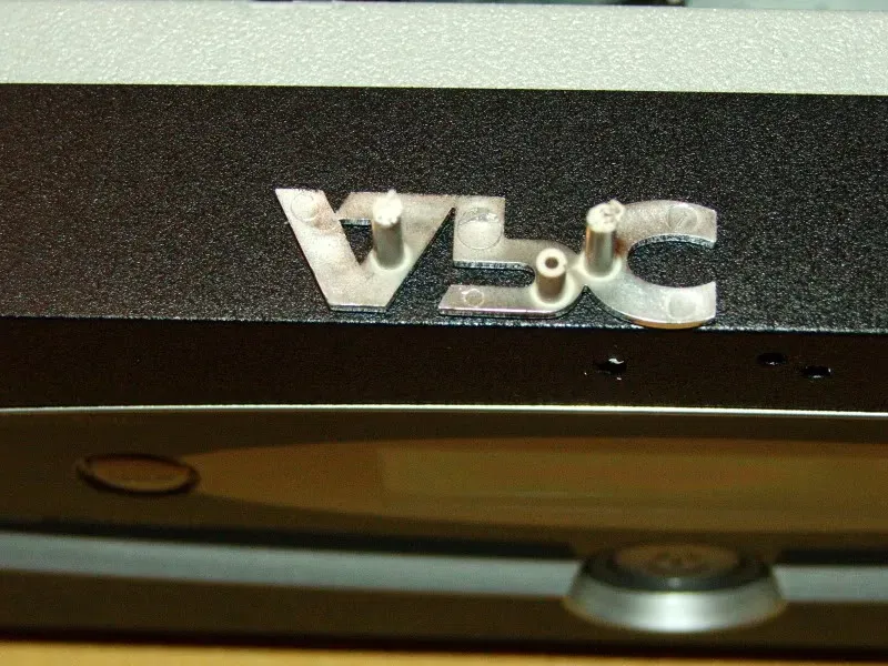

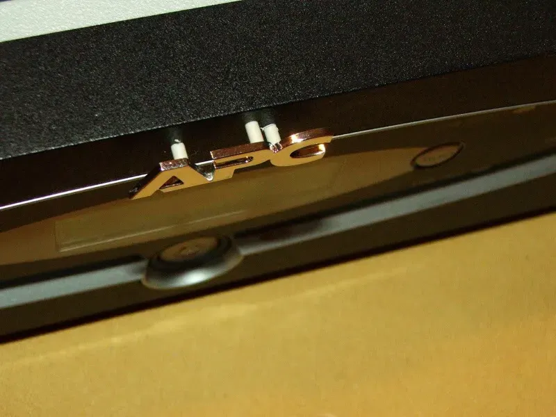

                                                                              Now remove the five screws that hold the front panel display to the face-plate. There are two on each end and one at the top-center. Do not remove the smaller screws at the center section that hold the black thin metal shielding.
                                                                              There is the chrome plated plastic APC insignia on the face that needs to come off too. It has three posts that go all the way through the face-plate. They melt the ends at the factory to keep it attached; I just used a screwdriver to break away the melted bitts and was able to then carefully pull it out.
                                                                              Reassembly is the reverse of this process.
                                                                              (I have always wanted to say that, after years reading Haynes auto repair manuals) :roll:
                                                                              OK, any questions?
                                                                              Last edited by theSven; 24 June 2023, 18:33 Saturday. Reason: Update image location

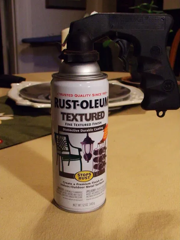

                                                                                      Well, AFA I'm concerned it sure looks better, but the more I see it, the more I think I'll paint the end-caps black, too. Regardless, I am absolutely sure it will sound better now that it’s black, even though I have yet to hook it up in my system.
                                                                                      BTW, this is the paint I chose:
