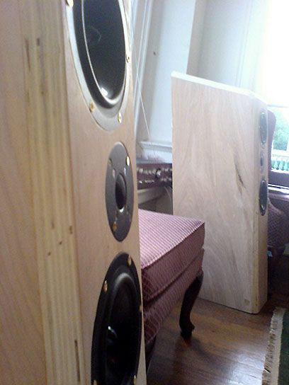

    Oh yeah: y Gear is a cheap Denon CD player, Natalie Portmans, and a Turtle Beach Soundcard (I think I will need to upgrade that soon).
