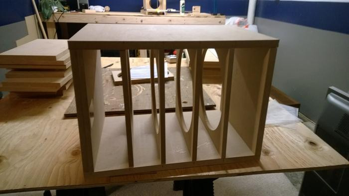

    For the sub, I went with a fairly over-braced enclosure. No reason in particular, just that I had the wood and I was curious. Net enclosure size is about 1.1ft^3 with the physical about 1.4ft^3. Baffle is 1 1/4in. I went with a down firing because I curious....wanted tall and skinny. Additionally, this sub currently lives behind the couch, so it is more flexible than a front load. Here is a picture of a dry fit.

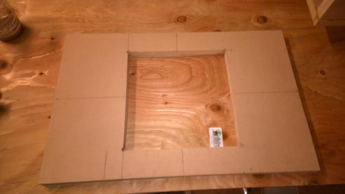

    For the amp, I cut an 8in by 8in square. Drilled holes in each corner just big enough for the jig saw blade. Then used the jig saw to run from corner to corner. picture below.

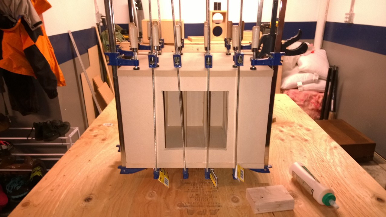

    First gluing....I need more clamps

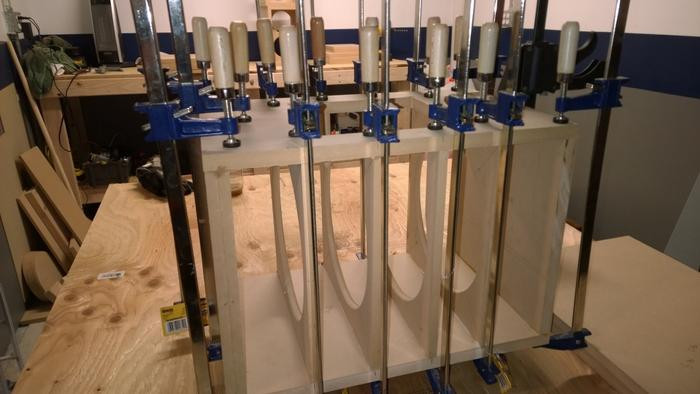

    I did for get to take a picture, but I did have to cut the braces a little bit to allow the amp to fit into the hole. Before gluing on the side that houses the plate amp, I measured width and cut two of the braces.

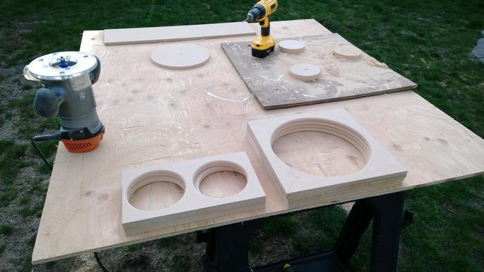

    The rest is history...sanding, flush trim and driver cutout and recess. Will show finished pictures later.
