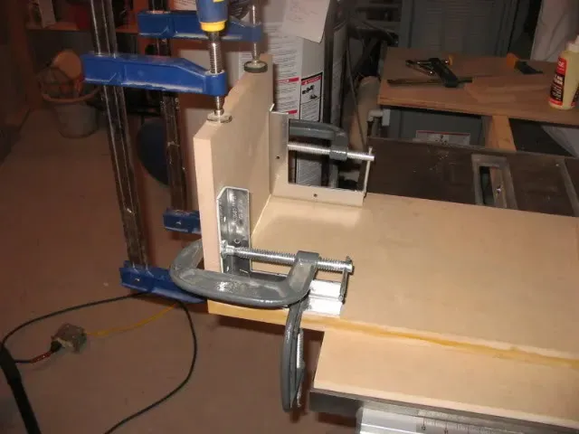

              When assembling, jig and dry-fit like crazy before applying glue. plan where your clamps are going to go, how many to use etc. When the glue is down, the pressure is on.
              I like to jig whenever I can - set up a glue so the peice can't shift. (as invariably happens when clamping a glue joint) In this pic you can see 90 degree jigs I
              -clamp to the upright
              -position the piece on the flat board
              -clamp to the flat board
              - remove clamps from the upright. After putting glue down I'll place the piece down and clamp it to the jigs.
              Also not pictured (I'd removed them) I clamp 2 boards to either side of the flat board, so the upright cannot shift side to side.

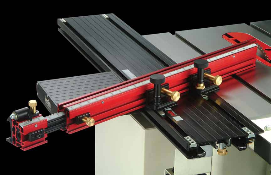

                                                      The one thing that has really helped me is to plan the cuts so that all of the cuts of a given size are done at once. The problem is that I find it almost impossible to set the fence to exactly the same measurement again if I have to go back and reset the fence.
                                                      So if the speakers are to be say 9" wide then I cut all of the 9" wide pieces (tops, bottoms, sides, baffles - whatever) that should be 9" wide. This way I do not have to readjust the fence on the table saw and all the 9" wide pieces are well - the same width.
                                                      For me the next important item is the biscuit joiner. This tool allows very accurate alignment of the various pieces. When clamped, the box almost squares itself. It is important to dry assemble the box first to make sure everything fits. If one uses the outside as the reference edge then and inaccuracies due to stock thickness are eliminated. Bill Schneider has posted some very good photo's (above) of biscuits being used. His biscuit table is a excellent idea. I use a biscuit joiner without a table and get great results.
                                                      In order to get square cuts from sheet goods I use the Jessem sliding table attachment.
                                                      Discover JessEm, a leading manufacturer of premium woodworking tools, precision router tables, router lifts, router fences, layout tools, and innovative joinery systems. Designed and manufactured with exceptional quality and accuracy, including an expanding collection of Made-in-Canada products trusted by woodworkers.
Name:	Sliding Table 2.jpg
                                                      One has to remove the left side table wing on your saw. At first I was apprehensive about not having the wing but the convenience of the sliding table far outweighs not having the wing.
                                                                        Click image for larger version  Name:	DAC-1001.webp Views:	0 Size:	21.5 KB ID:	947996
                                                                        I read this and decided to give it a try. My boxes are coming out straighter and seem much easier in the long run, though it does obviously take a little longer... but when doesn't quality?
