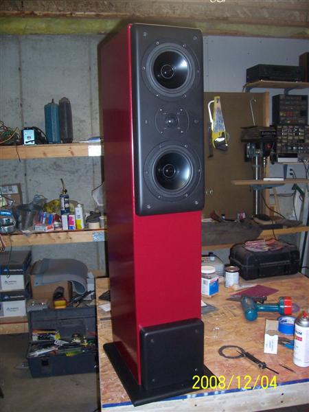

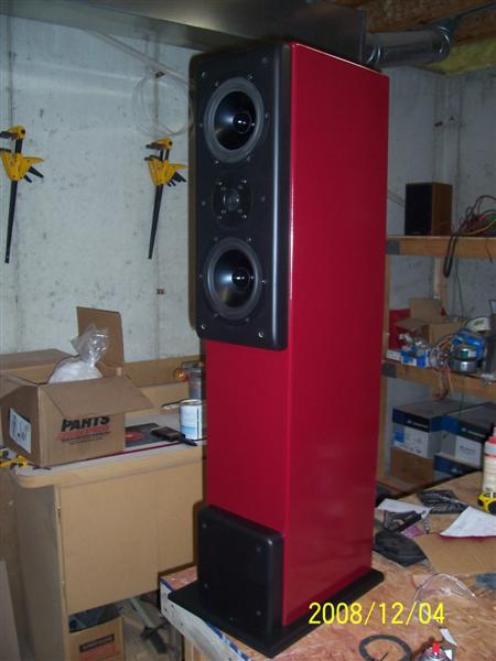

        • getdadams
          Try paint. It's a pain but the results can be cool.
Name:	100_3535 (Medium).JPG
Name:	100_3536 (Medium).JPG
          Last edited by theSven; 08 July 2023, 19:17 Saturday. Reason: Update image location
