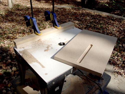

        In the meantime, I personally have gone cheap and small - one of David's requirements. I have an old Sears metal router table with the awful grooved aluminum top - now covered with a smooth 1/8" thick piece of MDF and drilled to accept my Bosch router.
        Note the expensive :W fence employed for making brace dadoes for a ZMV5...
        I expect that these can be picked up very cheap in the used market, and with a little creativity, can be made very functional.
        The only thing that I can't do right now is use very large diameter bits because of the small 1-1/2" through-hole. If I enlarge the existing through-hole, I'll lose table support for smaller pieces. That's where having different inserts of the Rocklers, etc. would help.
