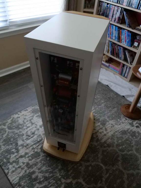

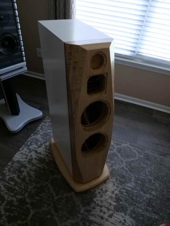

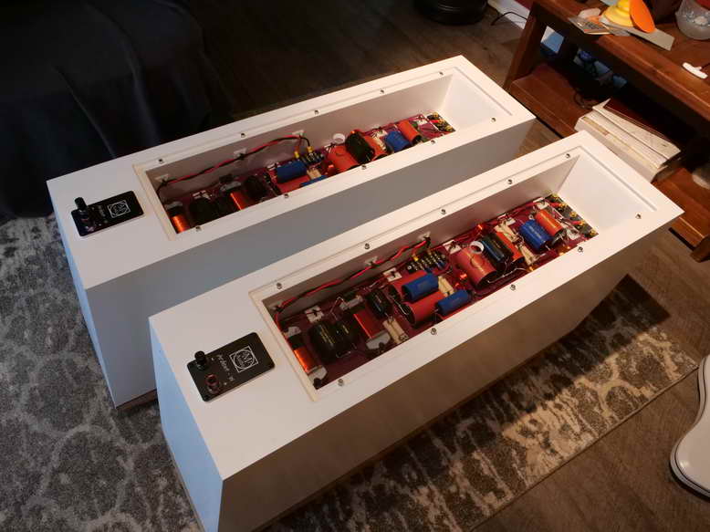

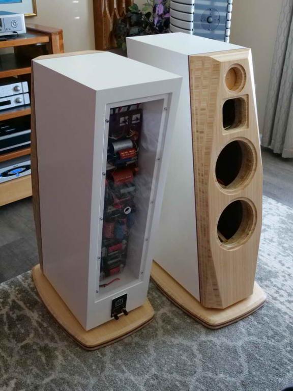

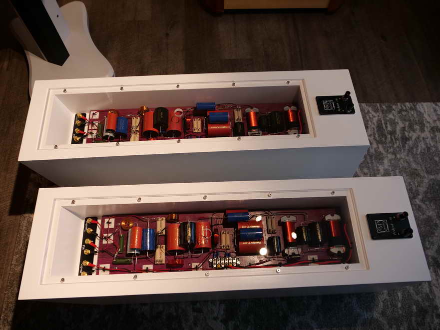

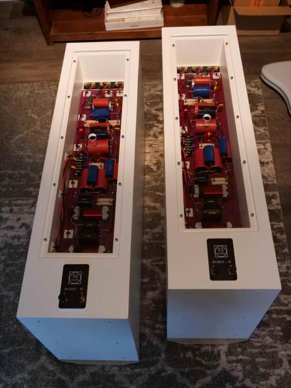

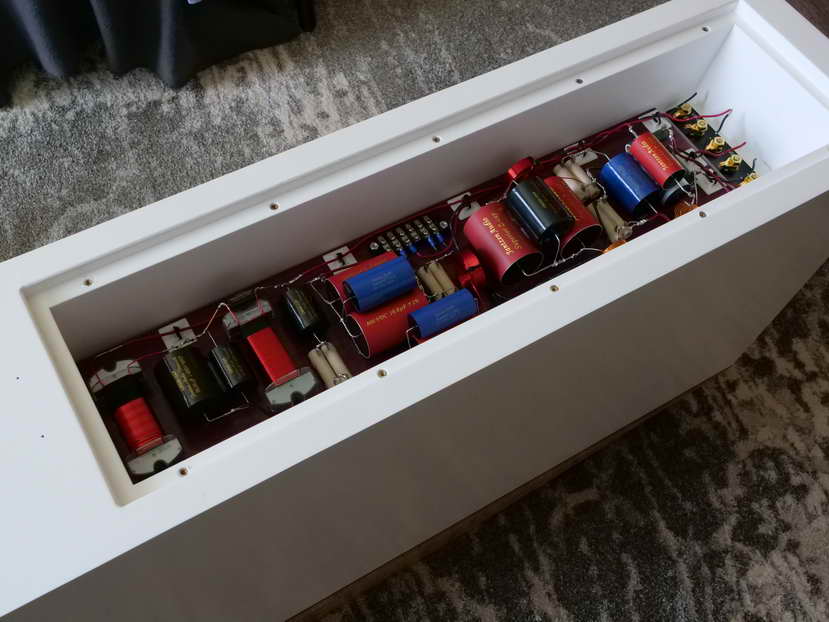

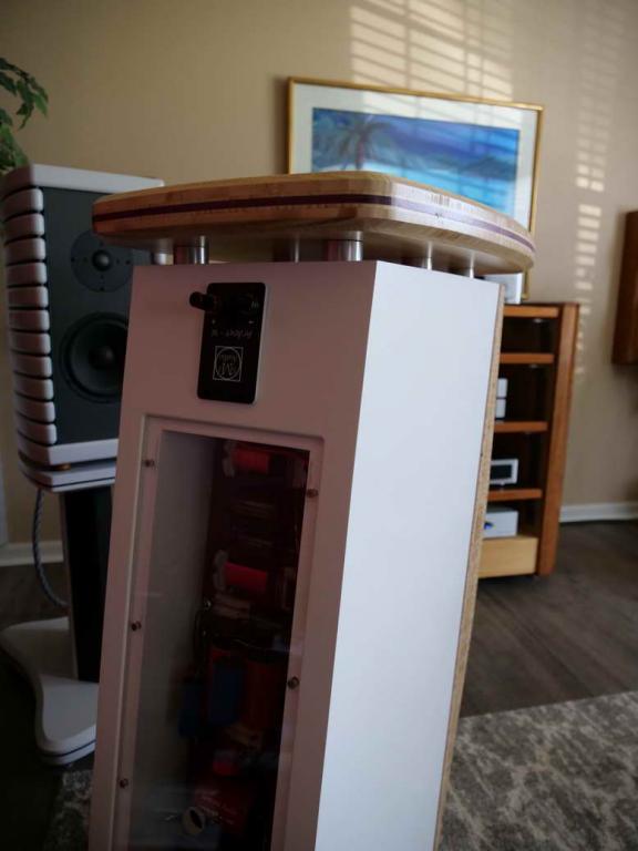

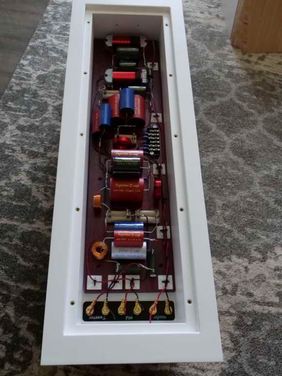

Well we may as well finish it up. Here are the bases going on.
[ATTACH=CONFIG]31399[/ATTACH]
[ATTACH=CONFIG]31400[/ATTACH]
[ATTACH=CONFIG]31401[/ATTACH]
[ATTACH=CONFIG]31402[/ATTACH]
[ATTACH=CONFIG]31403[/ATTACH]
Will need to see if we can get some better pictures as a follow up.
Are you gonna install the speakers and take them for a test drive? These are stunning Steve, I'm tempted to drive down to hear them if you are gonna install the speakers :-) before Danny picks them up.Painter in training- Bottom
Steve, these turned out even better than I pictured. I imagine they're even better in real life, I can't wait!!!
Yeah, I'm pretty sure his rates are gonna skyrocket when he adds these pictures to his website. But he'll have to in order to keep demand manageable!
Unfortunately I have the remaining parts sitting in Vegas. I suppose I could bring them with me and we could have a little weekend get-together!- Danny- Bottom

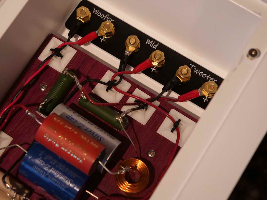

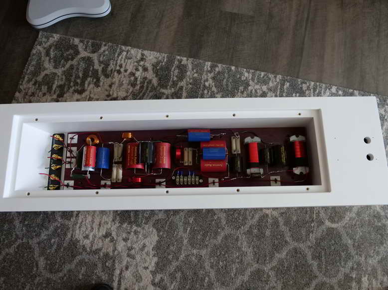

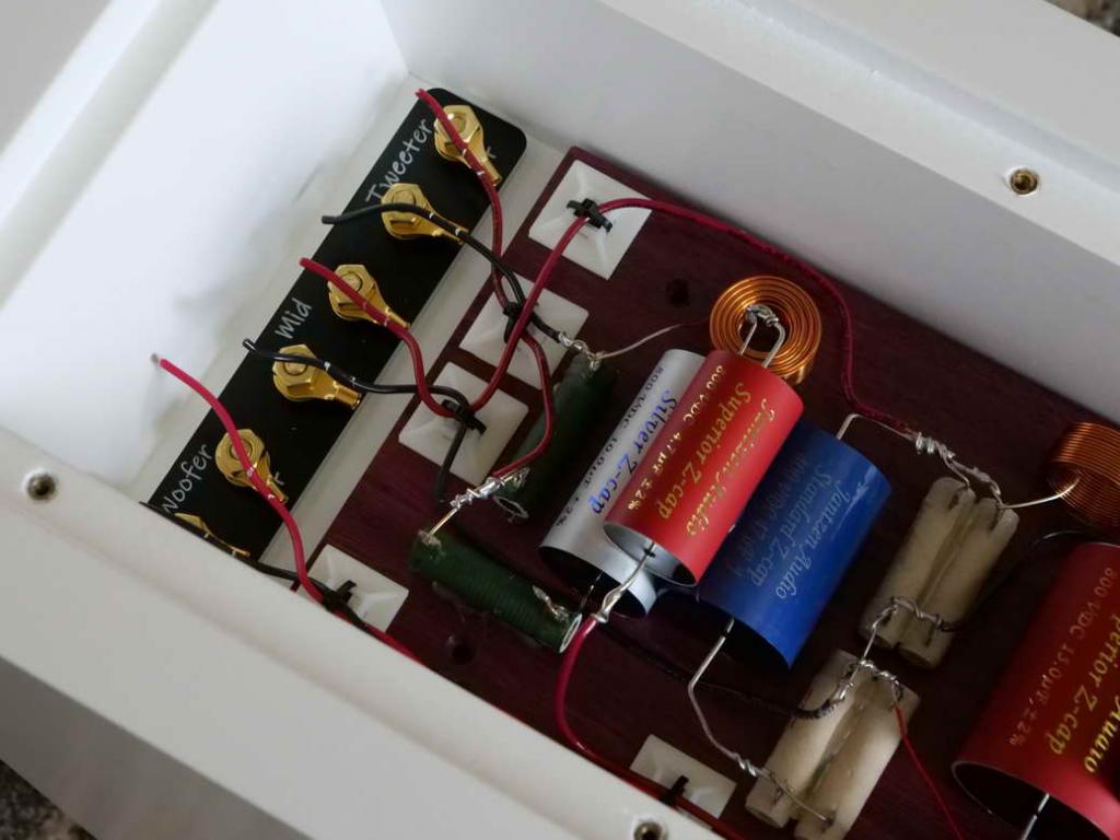

Hey Steve, could you please confirm the below?
Red/Green = Positive
Black/White = Negative/Ground- Danny- Bottom

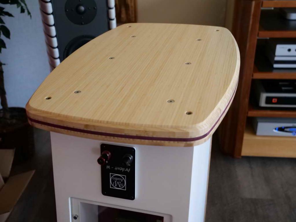

Possible issue, I put one of them together today and I'm getting nothing out of the tweeter. Tried both tweeters, same problem. Will put the other one together tomorrow hopefully so I can see if it impacts both of them. Hopefully just a loose connection somewhere.
Also snapped off two bolt heads, so my day hasn't been great.
- Danny- Bottom
That's not good.Possible issue, I put one of them together today and I'm getting nothing out of the tweeter. Tried both tweeters, same problem. Will put the other one together tomorrow hopefully so I can see if it impacts both of them.
What bolts did you snap?- Bottom
One installing the mid, one installing the tweeter. I had my drill on the lowest setting and it still took them off.- Danny- Bottom
Yeah, I try to stay away from drills/drivers for small screws, they have way more torque than my hands and what those screws can handle.
I sent you an email ....- Bottom
- Bottom
- Bottom
As a suggestion, you could actually drill and tap holes in the bamboo that will hold screws rather well.- Bottom
I've found that pre-drilling in bamboo is a definite must, with the pilot hole truly needing to be the size of the body/central core. Also, good quality screws are also a must. I've lost a number of basic BlackOx screws from both Madisound and PE. When I look at them, the grain structure looks sintered. The good news is that I've been able to unscrew the the body with pliers and try again (vise grips help a lot).Welcome to Rivendell, Mr. Anderson.- Bottom
- Bottom
No inserts just thread the bamboo. It's hard enough that you can tap it and use a bolt. Now is as good as an inserts if your going to remove and reinstall the bolts, no.- Bottom
Only fuuls like me use inserts in Bamboo... mostly!
