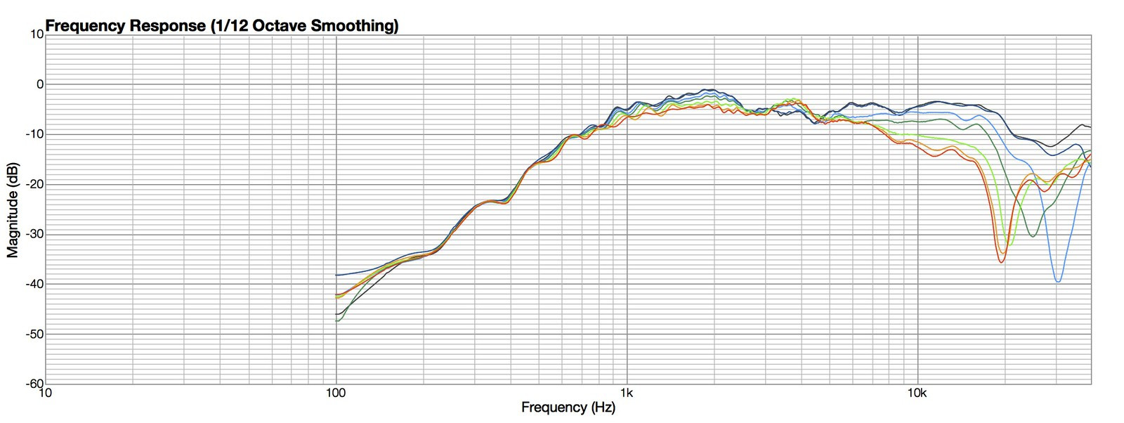

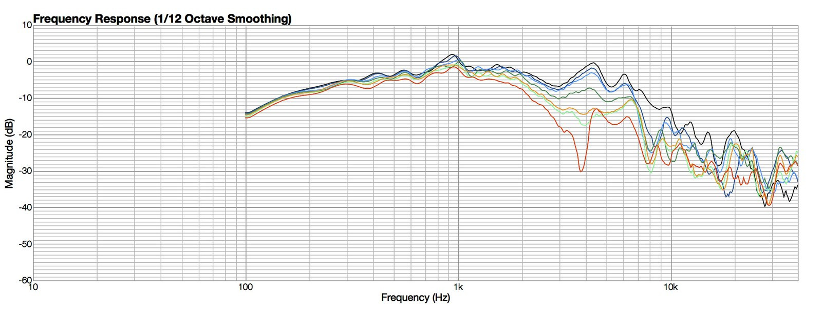

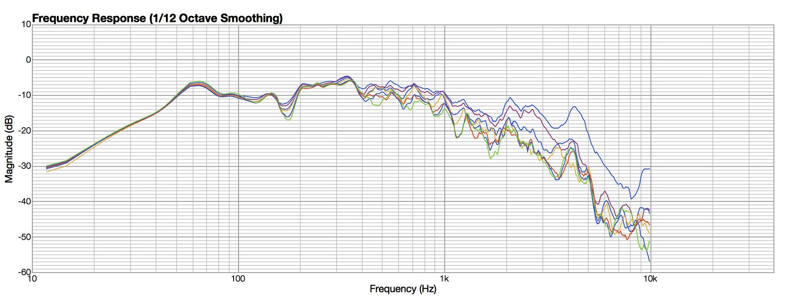

        On the flip side of things, as part of the development "exercise" (as in practice and repetition of a technique) I put the original Isiris cabinets through a 00 - 60 degree measurement set, partly for practice, and partly to follow up on my earlier "what ifs" for adding the mid bass module to the existing design, as proposed in VituixCAD earlier in this thread.
        I did some polar measurements previously in the development of the original design, but didn't have a tool at that time with which I could conveniently use that data in the design process.

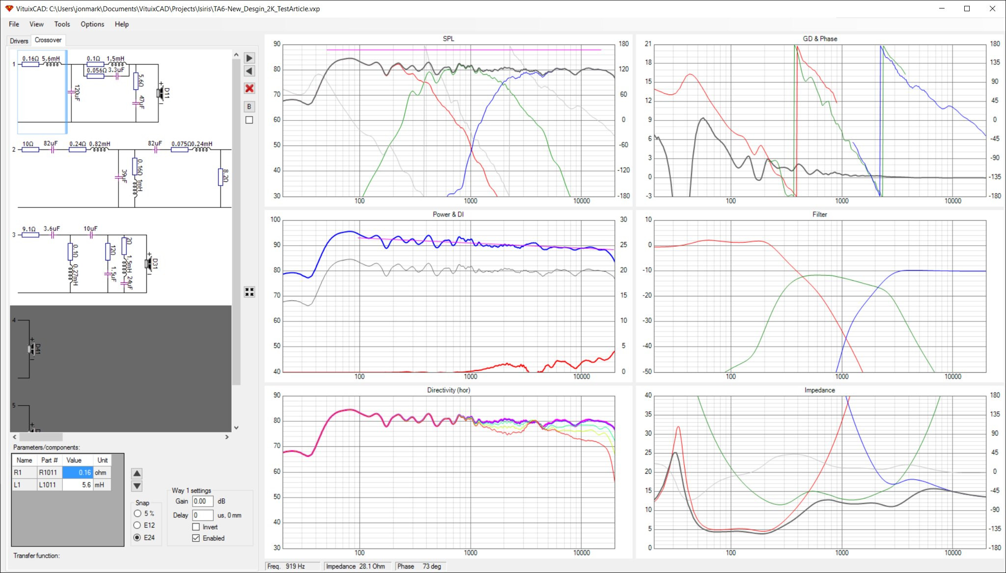

        The original design used crossover frequencies of 350Hz and 2500Hz; I might tweak that to 2400Hz in this implementation, the main potential update is moving to an LR6 instead of nominally LR3 transfer function. I have better point of acoustic origin data now, too, so that should help.
        So, I'm going to repeat the design process, based on these measurements and my initial assessments in VituixCAD just for the three way configuration, but looking at building off that for the four way setup. I don't know for certain if I'll actually build it, or see how much I can accelerate the construction of the mid bass module- I have enough LBL, and think I have enough tooling grade BB ply in storage to cover this, but I've got to check. And get up to speed on Fusion 360- I've promised myself I would NOT take the easy way out and do this in Shark, as I want to work on developing the collaboration aspect.
        And as an experiment, as I've modeled the AS190 already in VituixCAD, in a basic sense, now I plan to add the enclosure baffle step model, for a specific enclosure, and compare that to the driver measured in that enclosure; as the AS190 is claimed to be very linear between 100Hz and 1kHz, this should be an interesting test case. in the completed system it would have a crossover no nigher than about 450 Hz, so I expect fairly good agreement between the two. I'm going to be trying an odd driver mounting setup for the drivers (more on that later) but as for the combined diameters I shouldn't have any beaming issues until about 900Hz, I don't expect problems with that. (famous last words, right?)

          This post may only be of historical interest to a very few people- if that- but having measured things all over again, and generated scaled minimum phase polar data and sorted stuff out nicely, I've also gone back to the original Isiris designed in VituixCAD and worked up an updated release, after looking at a lot of details.
          Mostly it's based on insights from using the software and being able to see so many things all at once- that, and tweaking crossover points (tweeter from 2400 to 2000), doing some things to the transition band behavior to lessen the workload on the drivers (conjugate networks that are half way to being elliptic networks, and an octave beyond the crossover point crank up the attenuation) and more attention paid to attenuating the woofer break up and controlling the slope. you know, a lot of anal retentive OCD stuff that often doesn't get paid much attention due to cost- even at the DIY level, much less the commercial...
          And I've also checked it to be sure I can scale up the midrange and tweeter level 5 dB with minor modifications for the Osiris Jr. Build. That way it will match up with paralleled AS190 Accutons on each side, after they've had BSC applied.

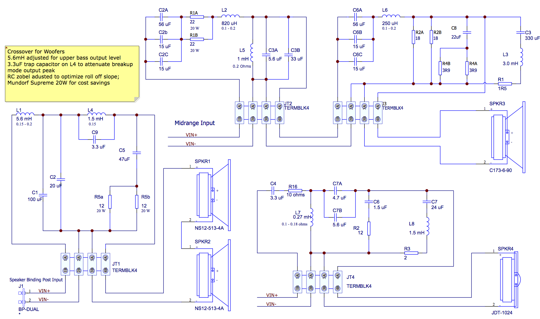

              More parts ordered, and a more "proper" working schematic is drawn up...
              oops, need some additions, but it's getting close- no time now...
              Updated.
              Again. 5/19/2016

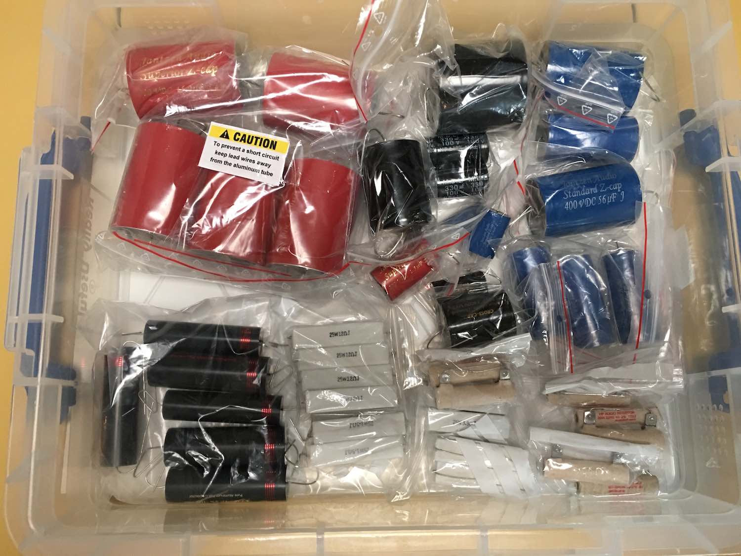

                  HiFi Collective in UK delivers the goods...
                  These arrived today- ordered two days ago.
                  They have a wide selection, good inventory, good prices, deliver fast- what's not to like? They're getting business now that Madisound and PE used to get... because they're more competitive on every front- stock more Mundorf parts than Madisound, better prices than Madisound, stock more Jantzen parts than Parts Express, and better prices than Parts Express- and they deliver often in just one day, at a very competitive rate.
                  Hard to beat, in my opinion- thanks to all the guys that got me to start looking at European vendors more closely.

                        For the big cap order, the shipping was about 20 pounds sterling, or about $30. Two days England to CA. For the cap order just before that, much lighter weight, it was 15 pounds sterling, and I got that one in one day. One day. I have no idea how, but it seems FedEx is determined to make their international priority courier service a fairly attractive proposition. It's cheaper than two day shipping in the US from my favorite vendors.
                          • 571
                          #147
                          Hey Jon...I see you are using an electrolytic cap in the mid trap circuit. What's your thoughts on using them in circuits outside the passband or in impedance flattening circuits for tweeter, mid or woofer resonances.
                          • meb46

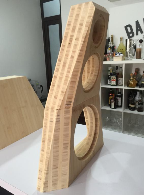

                            Christmas definitely came early this year... finally the full suite of drivers for the big boys...
                            Scan Speak D2908
                            Accuton C168
                            Accuton AS250
                            AES TD15S x2
                            Now I just need some progress on the CNC Routing and I can then crack out some glue... maybe this week?
                                    Pretty much the only places I use them are impedance conjugate networks for midrange or mid bass driver Fb; usually in the situation that there is a crossover ahead of it and we aren't really seeing much signal level anyway, and the network is just to trim that level to where I want it- I'm not one of those guys who only pays attention to the top level SPL magnitude, but also to what the drivers are doing 20-30 dB down, as I find that influences the sound. Linkwitz didn't fix the issues with the W22 resonance properly (in my mind) until a few years ago, and found that that did a nice job of clearing up part of the presence range response in the Orion's.
                                    In this case, I'm modifying an impedance conjugate network by lowering the resistance to also modify the roll off rate and reduce the level the driver is driven at, for the tweeter and the midrange. Sort of like cheating and increasing the order of the crossover network once past the initial transition band, but not spending more money on crossover components. I think that's particularly desirable for the tweeter.
                                    With unlimited money and unlimited space, (think the old Avalon Osiris) you could do all that with film caps, but then the results is huge, and hugely expensive (note the crossover box behind them in the pictures in the Tesseract thread). I think this is reasonable...
                                        Thanks for sharing your thoughts on electrolytic cap usage. I would like to avoid them but as you say size and cost becomes an issue. I'm also using impedance conjugate networks to increase the roll off at the low end in my Duelund network. It does require quite a demand on the drivers and if I can accelerate the roll off after 20db or so I think that will lower driver excursion demand.
                                          Yeah, when I've done Duelunds I've always found the driver response needs a lot of massaging to get the desired acoustic transfer function, whatever value of aleph you've chosen... I'm thinking about a couple of projects that might use that approach again, and being very careful about driver selection as a result, in order to lessen the issues getting things in line... Motus woofers, mid woofer, and still debating the tweeter...

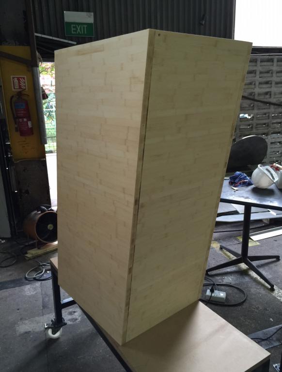

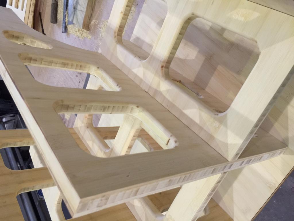

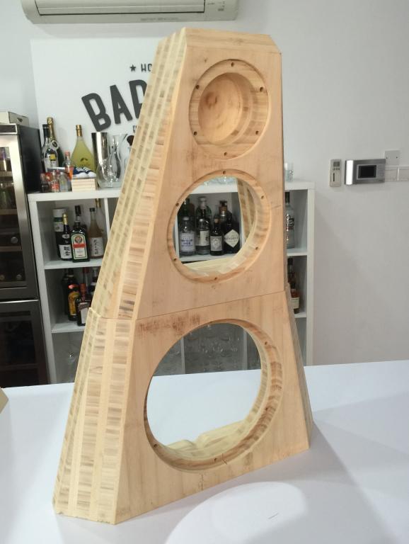

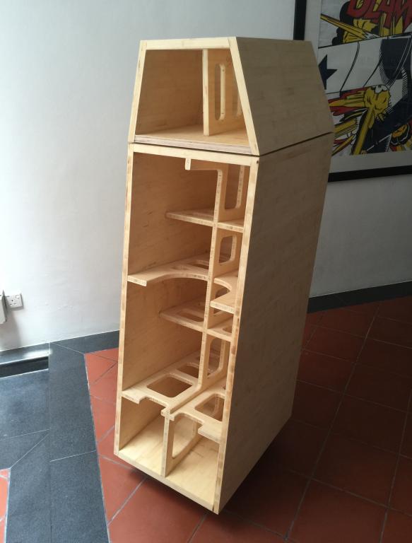

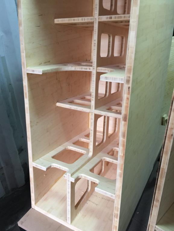

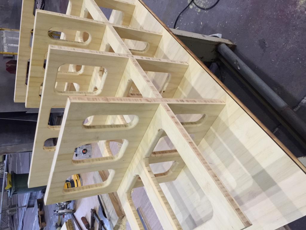

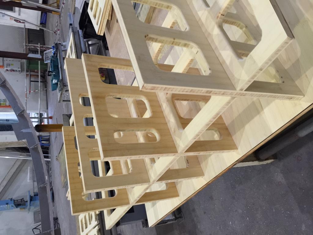

                                            Dust dust dust...

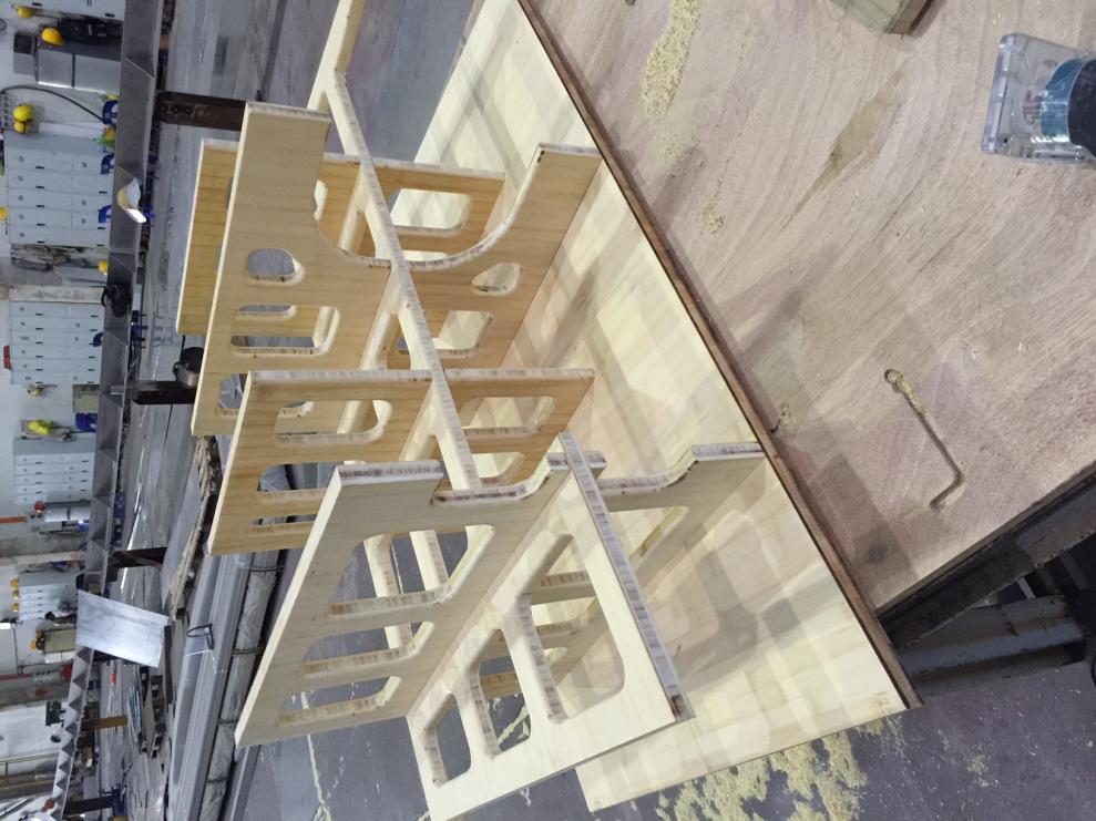

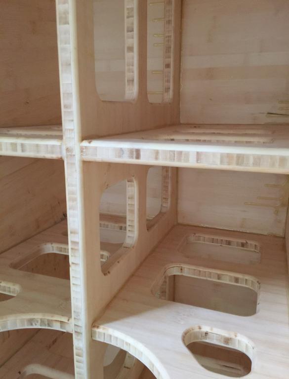

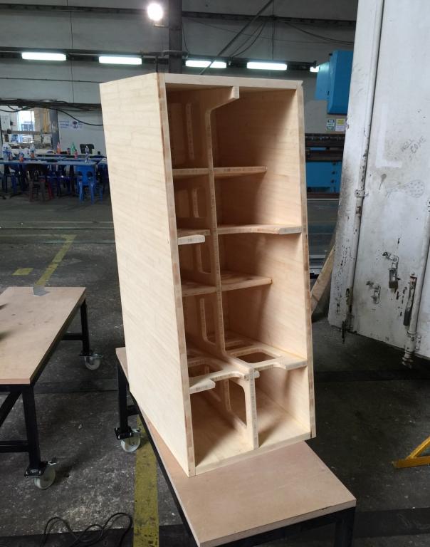

                                            Finally some progress... well some Bamboo dust anyway...
                                            All of my CNC routed internal parts and sides have been completed, and I can now start the test build up process of the main cabinets. Currently I am just working through the clean up of the parts, the internal brace chamfering, and checking dimensions. As per usual, the CNC accuracy is awesome! Bamboo is proving to be relatively easy to work with, and aside from the occasional burn mark from machine tool blade sharpness, I am really liking it. A couple of things thus far that are coming to reality...
                                            1 - The size of these things is already starting to make me a little nervous. Its mainly the width, at 500mm they are BIG.
                                            2 - The associated weight of the overall structure has made me nervous on the glue front. I am therefore switching to using epoxy glue through-out for additional strength and also incorporating the use of biscuits in most of the side panel joints.
                                            3 - They are going to be heavy... just as well I have a fork lift and 20T overhead cranes to move them throughout the build process.
                                            A few photos to show progress...
                                            • meb46
                                              • Jul 2010
                                              • 398
                                              #157
                                              Apologies for the orientation of these photos... will need to correct!
                                              More photos coming this weekend after I make some additional progress. Also hoping to have some of my bench saw cut panels complete and that will start to give a better feel for overall height and side profile.
                                              Better get some epoxy ordered!

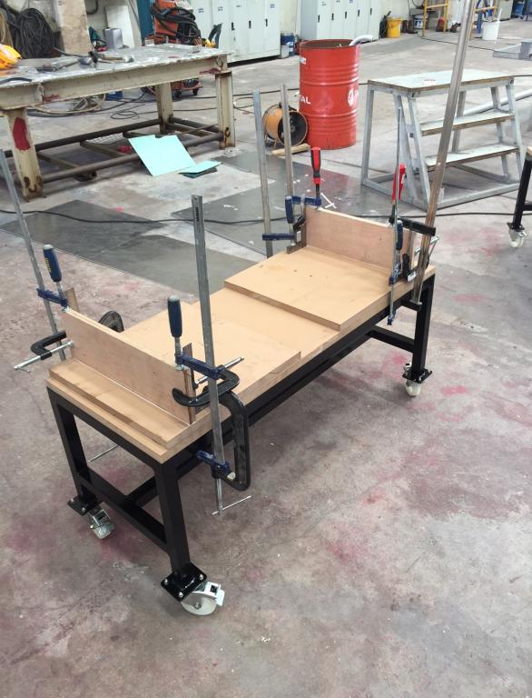

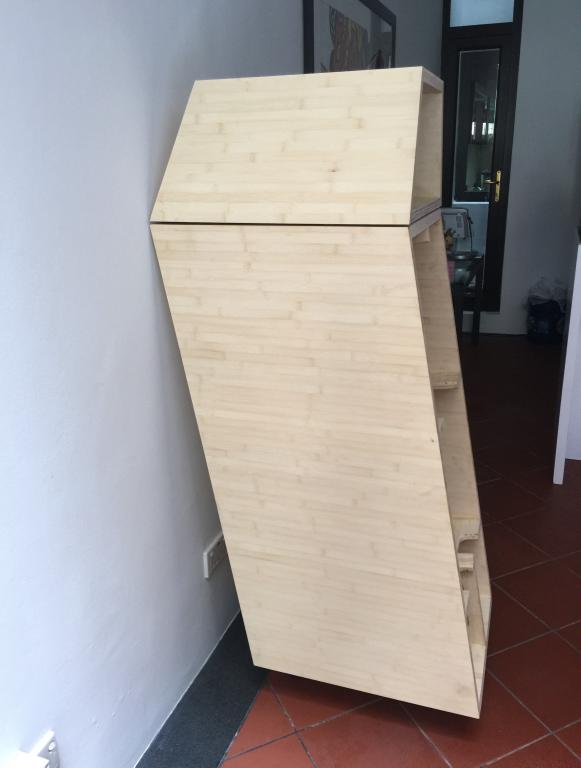

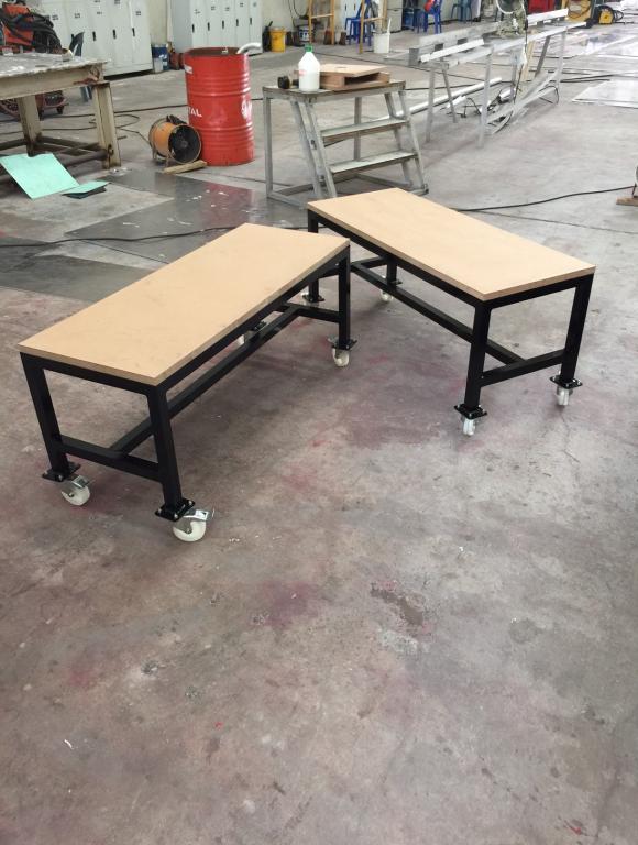

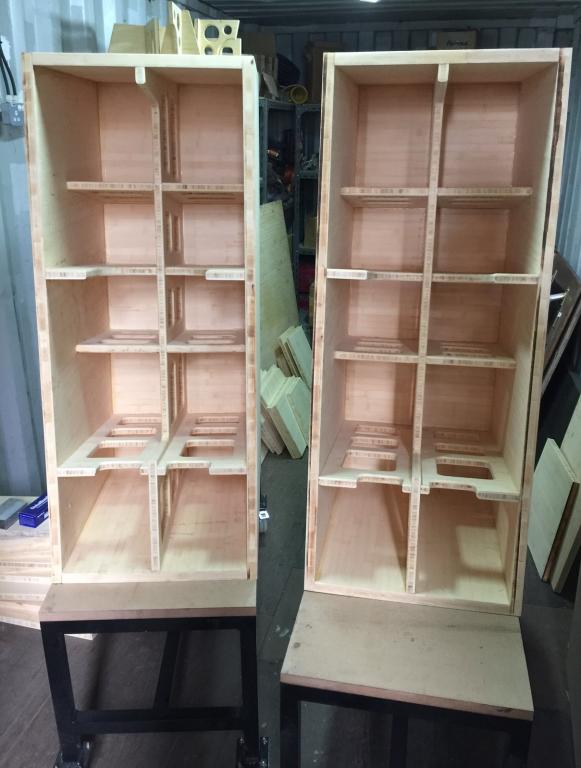

                                                                  Todays fun was the completion of mobile cradles for the sub cabinets. I figured these are going to weight an impossible weight, so I have two sets of cradles. One to house them lying flat on their back, and the second standing.

                                                                  Secondly, I wanted to have really accurate reference jigs to build the internal bracing structure... so I have knocked up to jigs to glue the Mid/Tweeter and Bass internal bracing. The glue and clamps have made an appearance, and should be all ready for my first set of epoxying on Monday next week...
Name:	Cradle + Assembly Jig.jpg
                                                                    • 2129
                                                                    #168
                                                                    Holy crap Mike that's a shop and half ...... love the new carts.
                                                                    CNC is easy if you have someone up to speed with their machine and is used to doing the type of work your asking of them. Other wise it can be a learning experience shall we say.
                                                                    That's a heck of a deal on the bamboo, as in cheap to what it is here. How is it for void issues?

                                                                            #172
                                                                            Progress on Subwoofer Cabinets
                                                                            Made some great progress in the last couple of days on the Subwoofer Cabinets...
                                                                            First Cabinet fully assembled excluding the front Baffle...
                                                                            Rear look of first cabinet...
                                                                            Internal Bracing and Two cabinets complete...
                                                                            Next steps are to line these cabinets with Bitumen and then Felt... Ordered these today!
                                                                            All outer panels use biscuit joints... Purchased a new Biscuit Jointer and its officially my new best friend. Makes alignment and assembly of the panels very easy!

                                                                                            Cabinets are making good progress and the first couple of Baffles arrived today...
Name:	Woofer Mid Tweeter Baffles 2.jpg
ID:	861986 Click image for larger version
Name:	Sub and Woofer Cabinets.jpg
Name:	Sub and Woofer Cabinets 2.jpg
ID:	861984 Click image for larger version
Name:	Woofer Mid Tweeter Baffles.jpg
                                                                                            The Baffles need a bit of a tidy up and cant be attached to the cabinets until they are lined with Bitumen and Felt... next weekends chore!
                                                                                            Test Fitting of Drivers will also happen next weekend to determine if any modifications need to be made... hoping all is spot on! Fingers crossed!
