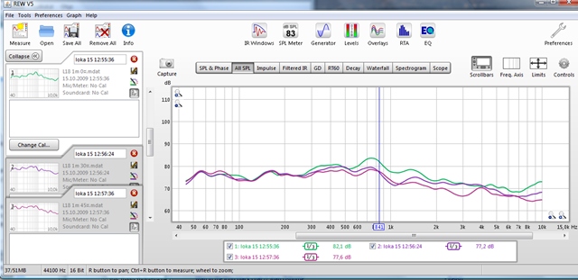

                  And just for curiosity I digged for my in-home measurements of the Zaph L18, 0¤ 30¤ and 45¤ distance 1m. The curves for 2m would be different. Non-calibrated laptop used for this. Sorry, I haven't made a similar for the ER18DXT. And the laptop has been changed since too.
