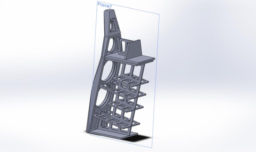

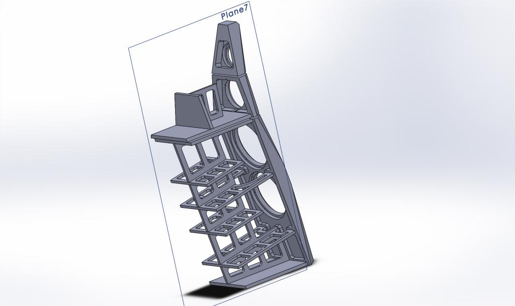

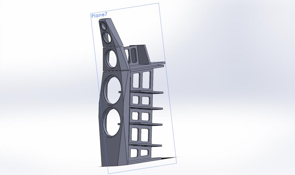

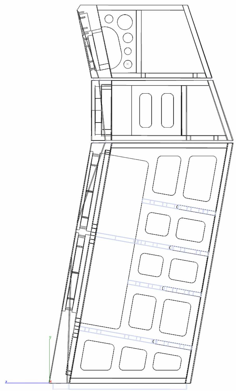

        Amended internal Brace... Remember to note, this is a big subwoofer cabinet... 300L, so dimensions can be deceiving...
Name:	Internal Bracing 2.jpg
ID:	861758Click image for larger version
Name:	Internal Bracing 3.jpg
ID:	861759Click image for larger version
Name:	Internal Bracing.jpg

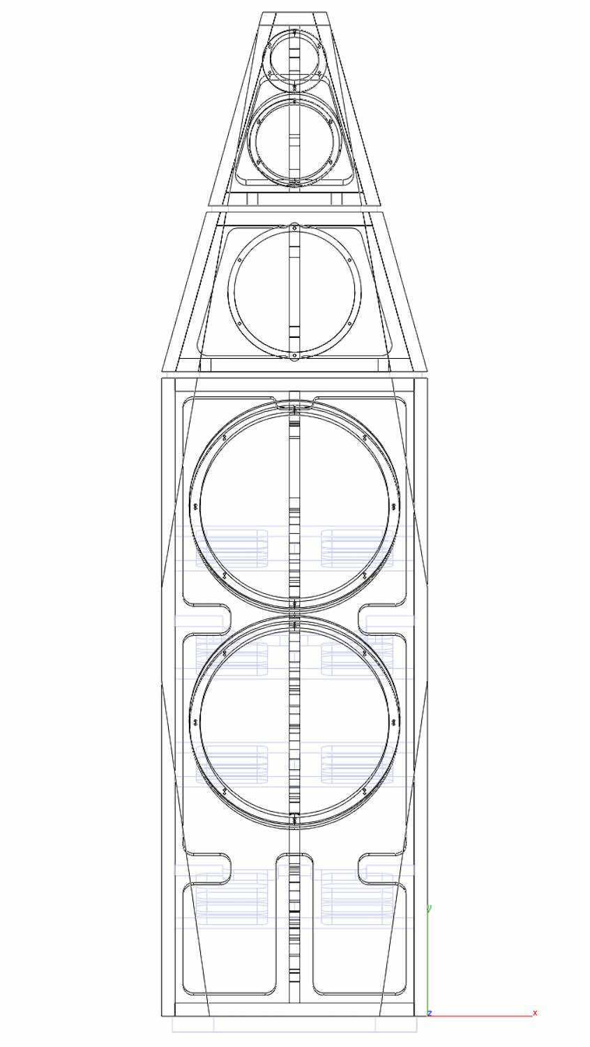

        • meb46
          • Jul 2010
          • 398
          #94
          Final update for the night... Bass and Top Mid/Tweeter Cabinets have ample room for crossovers...
          Bass Cabinet is around 20 - 25L still to be confirmed
          Mid Cabinet is supposed to be 5 - 8L but maybe oversized at the moment - will calculate actual volumes tomorrow

          • cochinada
            • May 2014
            • 661
            #95
            Seems much better now! :T
            What is the width of each side or the middle between holes?
            About the horizontal brace that touches the baffle between the two big woofers I think I wouldn't hollow it before it gets to the vertical one, if I make myself clear. I would leave only the two holes closer to the rear on each side
            Joaquim
            DIY 4 way speakers.
            DIY subwoofers.
            Zaph ZD3C.

              Due to the symmetry, the vertical braces do not need any holes.

                Interesting remark. Anyways I maybe mistaken but I think that internal volume is also at premium here so the holes will allow a little boost I guess.

                      Mike, looking great if I was being picky I would also remove the curvy holes closest the the front baffle in the 2 larger Horizontal braces that come in contact with the front baffle in the base section. This would strengthen those key elements and should still give good breath-ability to the woofs. If needed for volume ignore but it should save some CNC time too. Other then my pickiness think you did a great revamp on your original. :T:T

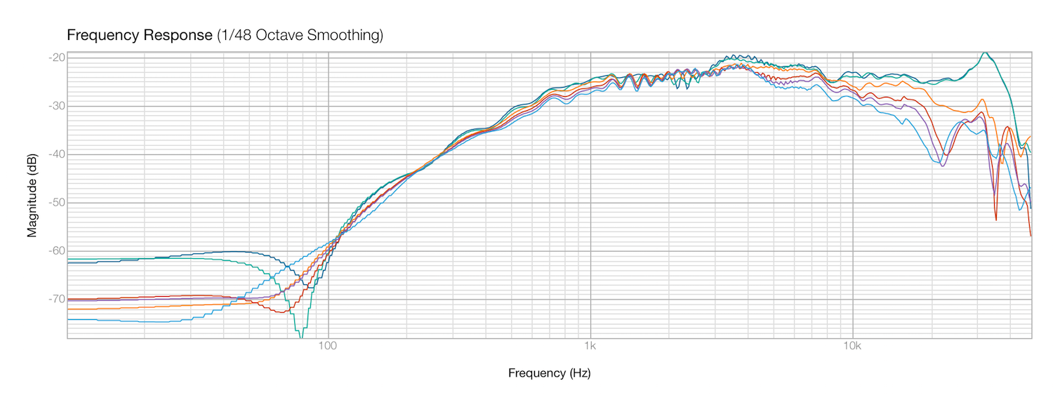

                                  • 16109
                                  #106
                                  Originally posted by Face
                                  For closer C-C distance, there's always these: https://www.madisoundspeakerstore.co...-tweeter-each/
                                  The response plots on VoiceCoil didn't exactly charm me for those models, but then I'm seeing what seem to be some common issues with their tweeter measurements- but I haven't gone through enough issues and measurements to really comment in any definitive kind of way. And the distortion measurements aren't done the way I would like to see them... and often aren't legible. Disappointing. But you're certainly right about the CTC distance, and I've played with the soft dome versions of these, too, but oddly never done a full blown system, just a relatively undocumented one off for a friend.
                                  Speaking of documenting stuff, here is one of the pair of 7140's I just received, measured with the Tascam/Fuzzmeasure setup, doing a polar response sweep. I wouldn't say I see any real surprises compared to the measurements I did of meb46's on the same baffle; but for his new build, we'll need to have test baffles that match the actual front panel, as we did before.

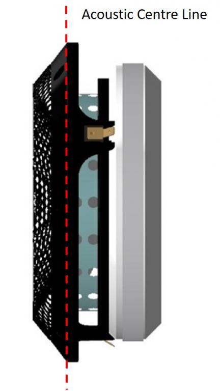

                                        • meb46
                                          • Jul 2010
                                          • 398
                                          #110
                                          This should explain what I mean... This is well forward of the traditional C173, and from what I understand, one of the key design parameters on this driver.
Name:	C168 Acoustic Centre.jpg
                                          • meb46
                                            • Jul 2010
                                            • 398
                                            #111
                                            Sorry... I should have called that the Acoustic Plane... but you can imagine the centre of the driver, on that plane is the Acoustic Centre.

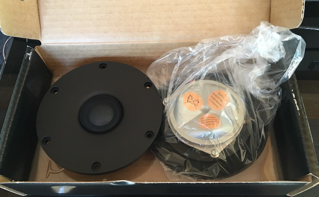

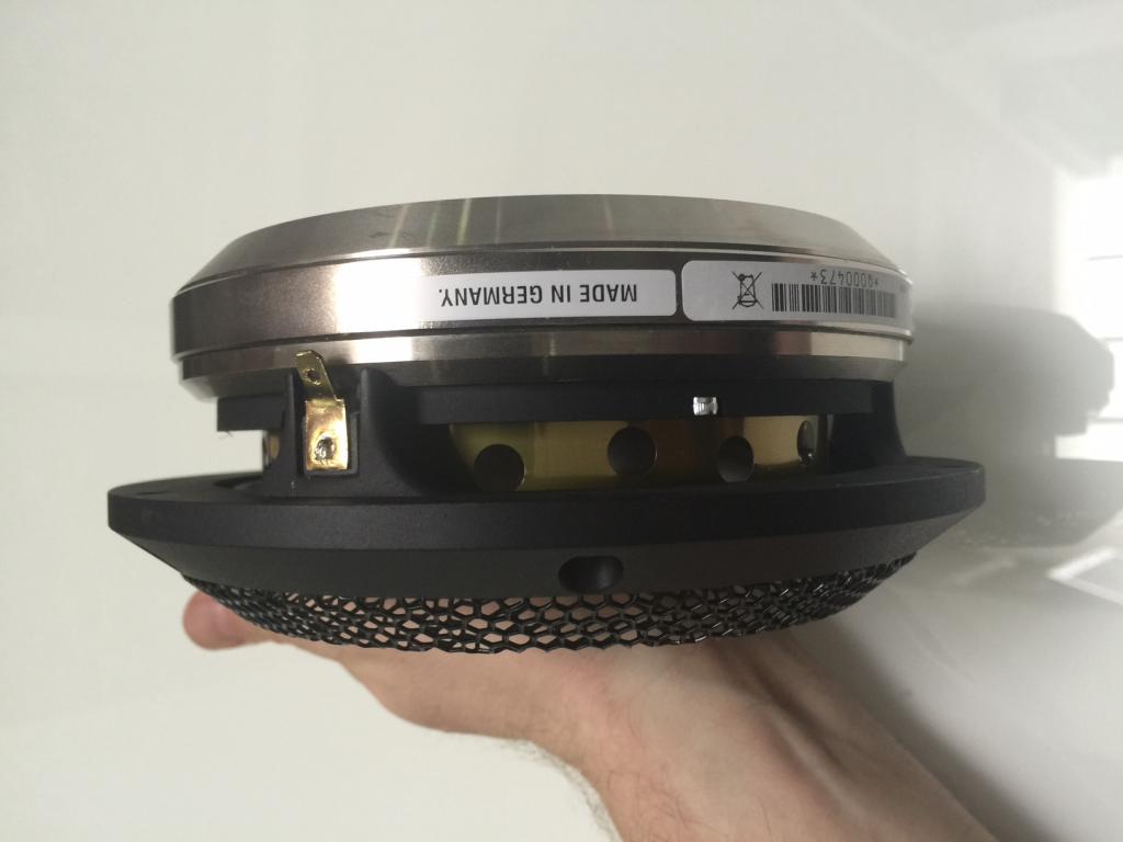

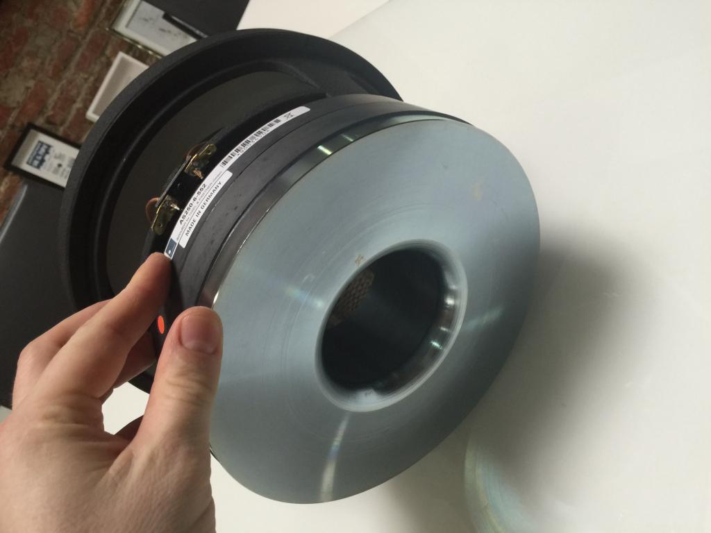

                                                        • meb46
                                                          • Jul 2010
                                                          • 398
                                                          #118

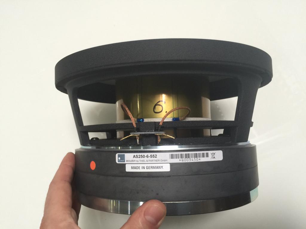

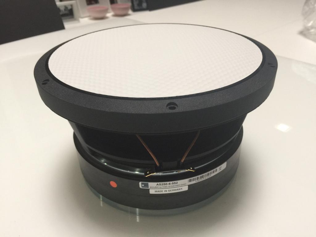

                                                          Right... so finally some time at home to look at these new drivers...
                                                          AS250 follows...
ID:	861769Click image for larger version
ID:	861770Click image for larger version
ID:	861768Click image for larger version
                                                          • meb46
                                                            • Jul 2010
                                                            • 398

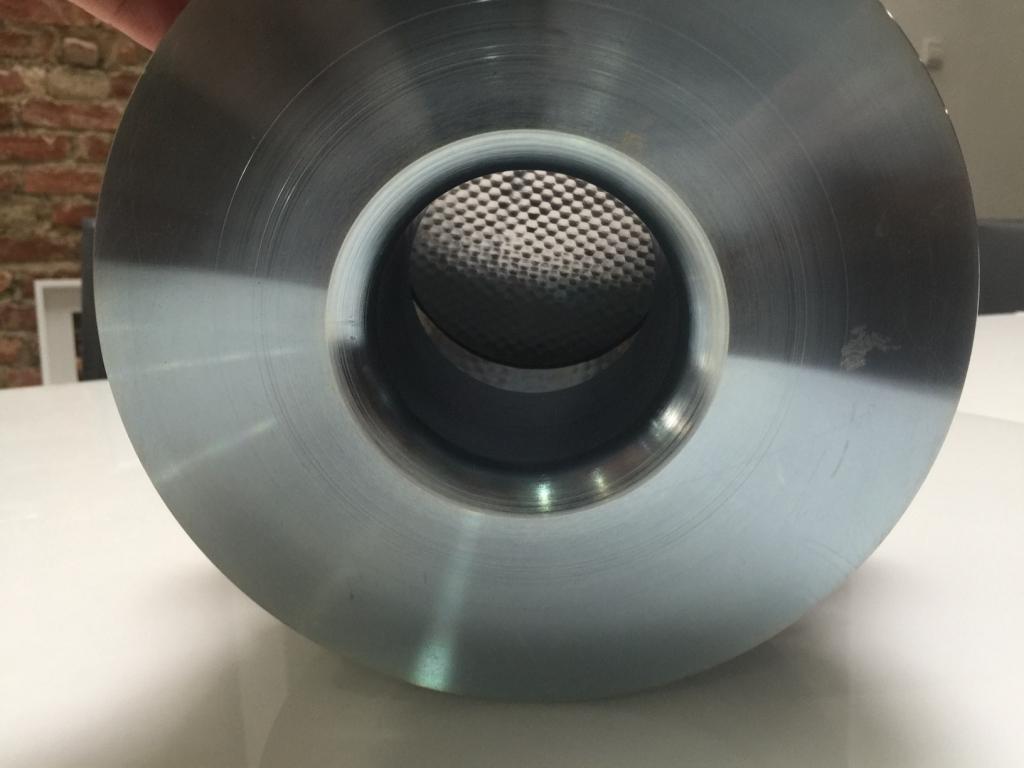

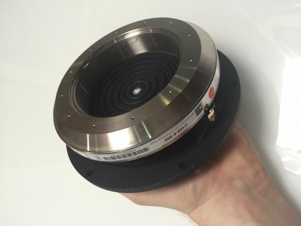

                                                            #119
                                                            C168 as follows...
ID:	861772Click image for larger version
                                                            • cochinada
                                                              • May 2014
                                                              • 661
                                                              #120
                                                              These As250 if they were perforated could make a nice pair of disk breaks. :B

                                                                  • meb46
                                                                    • Jul 2010
                                                                    • 398
                                                                    #123

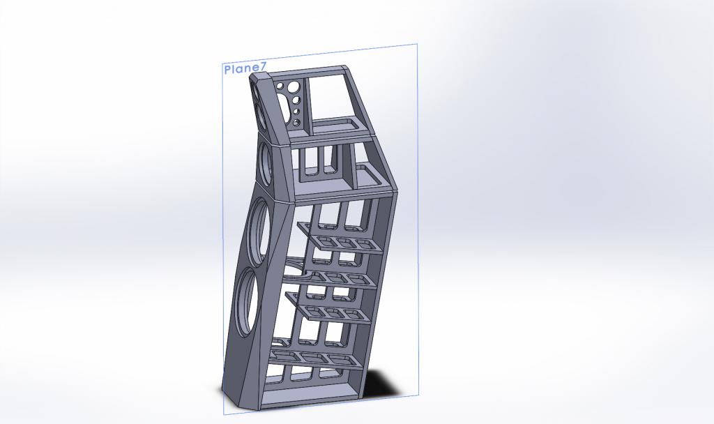

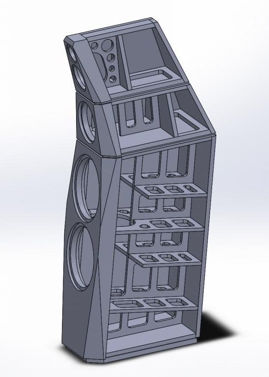

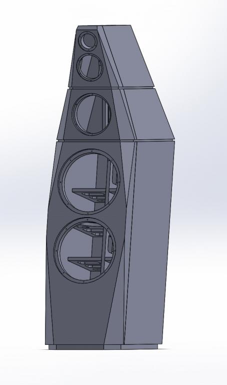

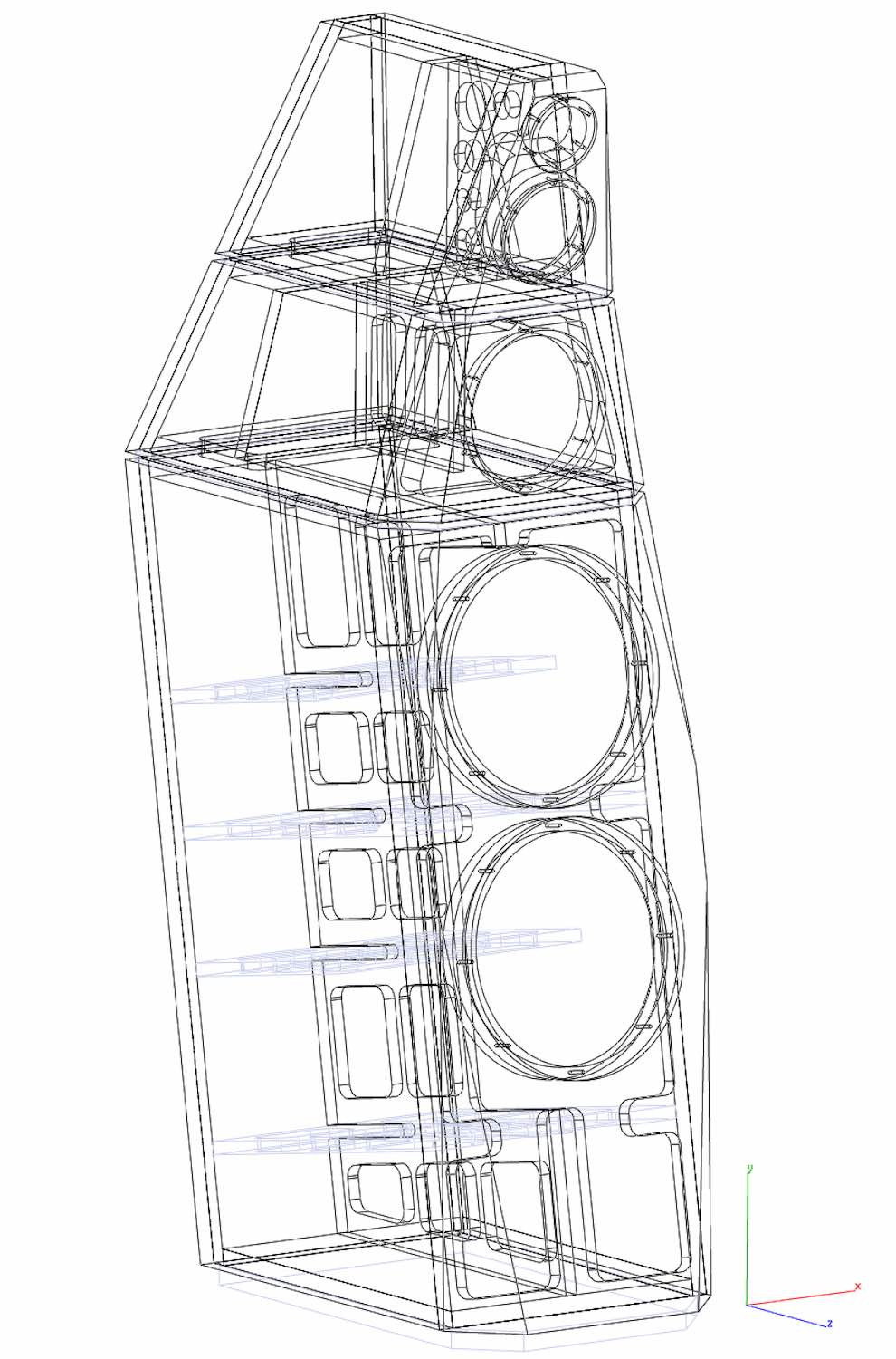

                                                                    Final design nearing completion. After calculating the volume, I managed to bulk up some of the baffles as per various recommendations. I may add further bracing to the side panels once I see the finished machined articles...
Name:	Cabinet Build.jpg
ID:	861782Click image for larger version
Name:	Cabinet Build - Cutaway.jpg
                                                                    Talking to the machinist today to discuss making the Top and Mid Cabinet Baffle samples for testing. I have decided to do the easy 2D CNC Routing myself and then "outsource" the more complicated 3D CNC Routed Baffles...
                                                                      #124
                                                                      I like, awesomely mean looking, well braced and you should not feel a movement of that cab. If you find the 3D CNCing of the baffle very expensive check a local cabinet maker with a large panel saw. We used a guy with a 14" blade and it made short order of those facets. You would construct the baffles and CNC a jig to hold the completed baffle at the angle, see bottom of this page.
                                                                      Last edited by theSven; 21 February 2023, 19:11 Tuesday. Reason: Updated URL for htguide
                                                                        #125
                                                                        +1- that is the way I would highly recommend, too, IF you can find a craftsman with the necessary size panel saw like Darrell and Ben did.

                                                                          The IGES files load fine (BTW, my FX Shark will import the SketchUp models, too)
                                                                          The design looks good, and it wouldn't be at all hard to generate TS production documentation from this and breaking out the piece parts.

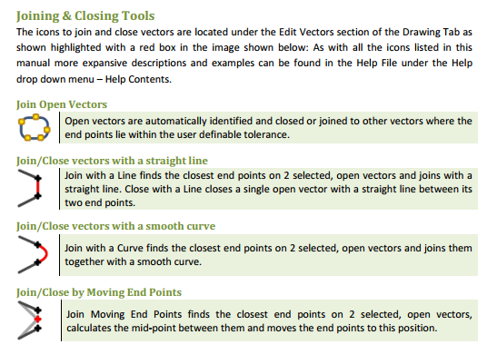

                                                                              I have been trying to get my head around the software I have for my CNC Machine (V-Carve and the proprietary Control software). Becoming increasingly frustrated with V-Carves import ability of DXF/DWG Quality.
                                                                                • 16109
                                                                                #129
                                                                                Well, I hope you're making progress, but the Vcarve issue sounds potentially serious- hopefully not a show stopper in the end.
                                                                                  • 698
                                                                                  #130
                                                                                  meb46, what type of issues you see with Vcarve? I used a flow from Rhino3D to Vcarve and in end it worked quite ok. It was a bit trial error on what export setting to use in Rhino and in Vcarve I still needed to rejoin some closed curves that were joined in Rhino but somehow got broken in the process. But other than that it was workable for my Minerva version.
                                                                                  • meb46
                                                                                    • Jul 2010
                                                                                    • 398
                                                                                    #131
                                                                                    Ergo - Exactly that... in the import of a DXF or DWG into V-Carve, some of the vectors break, and need reconnection. You then need to instruct it to correct based on straight lines or curves etc. This I found still has errors. My main concern, post this correction process, it is no longer accurate to the DXF/DWG measurements. Its not bad, but somewhat makes a mockery of the accuracy its been designed to. I would be interested to know if a Mastercam generation of route paths and G-Code has any similar issues?
                                                                                      • 698
                                                                                      #132
                                                                                      I've found that it turns out ok if I use the 'Join Open Vectors' with a 0.01mm tolerancs and if the original CAD had points perfectly aligned then no change to them happens. You can verify that also by showing the nodes before and after.
                                                                                      I do agree their UI is a bit misleading with this tolerance selection etc. Maybe it has to do with handling metric/imperial systems or some such where rounding errors can come into play.
                                                                                        [ATTACH=CONFIG]25773[/ATTACH]
                                                                                        Looks like very good info- thanks for sharing, Ergo

                                                                                          Those Accuton drivers certainly do look the part, they are very well made. It will be interesting to see if those deviations from the technical norm for loudspeakers and basket/motor design actually perform as well as they look!
                                                                                            • 16109
                                                                                            #135
                                                                                            Indeed, that is the $64 question- the factory specs look good, but what happens out here in the real world? I've got a knock down cabinet I could put together to test one of the AS190's, but I need to spend some time on the CAD setup and come up with a new mid bass enclosure design. Shark FX 9 is running well, but I should dig in to Fusio 360, and start building some chops on that...
                                                                                            We're up in the South Tahoe area where we're staying, the hotel wifi is nonexistent at this cabin at the end of the string, but my iPhone on Verizon has one bar, and I'm using it as a personal hot spot for my iPad Pro... Here's hoping when I push "Post Quick Reply"! :W
