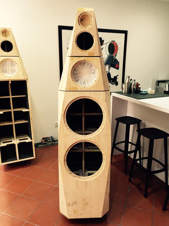

        #183

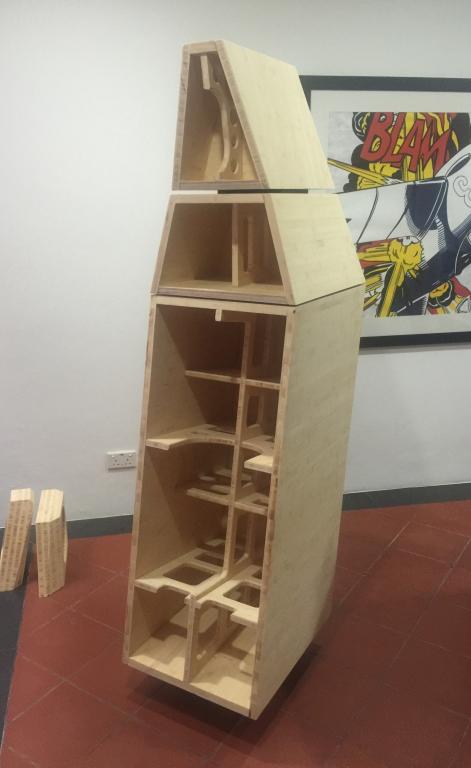

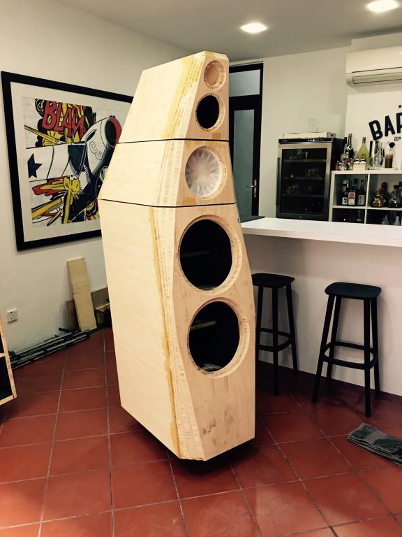

        Joaquim - The cabinets are split into three different sections, a) Subwoofer b) Bass and c) Mid/Tweeter. The Subwoofer Cabinet Baffle is the one that is missing, and in terms of the actual cabinets, the Mid/Tweeter Cabinet is not shown. There is chambers in behind both the Bass and the Mid/Tweeter Cabinets which is room for the Subwoofer Plate Amplifier and Crossover respectively. The Subwoofer Amplifier is not in the back of the Subwoofer Cabinet as it consumes too much volume, whilst I have un-used room in the Bass Cabinet. Works out pretty well, and leaves the void in the Mid/Tweeter Cabinet for the crossover... assuming it doesn't get too out of control large
        The Subwoofer Amplifiers were ordered yesterday from Hypex... DS8.0 which gives the two 15" Acoustic Elegance Woofers 800W. Will start with this and work out if they need more power later. At the moment, the plan is to then power the Bass/Mid/Tweeter with a NAD M22.
        • meb46
          • Jul 2010
          • 398
          #184
          This might make a little more sense than my previous ramblings...

            #185
            Ok, thanks, now it's clear. :T
            I know this is a huge speaker and so the scale can be a little misleading but are you confident you will be able to fit the whole crossover in that apparently very small space? Have you already did some modeling of it as well, I mean using the real components and see if fits?
            BTW, I probably missed this info already but are the subwoofers active?

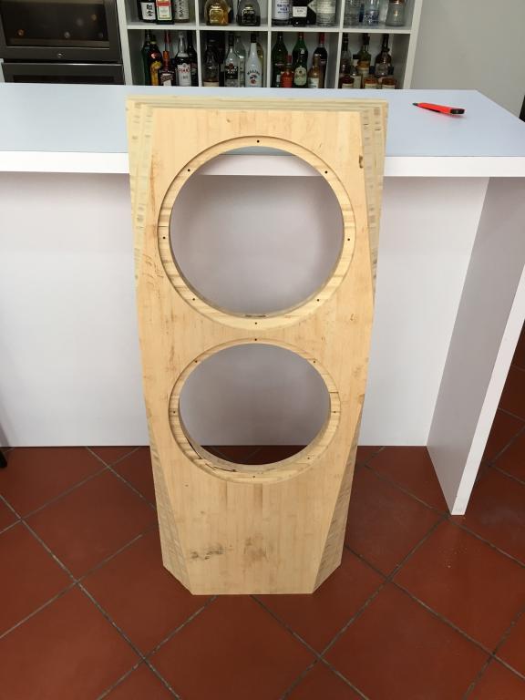

                    Cabinets are making good progress and the first couple of Baffles arrived today...
                    [ATTACH=CONFIG]26009[/ATTACH] [ATTACH=CONFIG]26008[/ATTACH]
                    [ATTACH=CONFIG]26007[/ATTACH] [ATTACH=CONFIG]26010[/ATTACH]
                    The Baffles need a bit of a tidy up and cant be attached to the cabinets until they are lined with Bitumen and Felt... next weekends chore!
                    Test Fitting of Drivers will also happen next weekend to determine if any modifications need to be made... hoping all is spot on! Fingers crossed!
                    Nice work on the front baffle pieces, Mike! It's good to see things this far along now. The scale of things is deceiving, though, because looking at this one would likely not realize that's a 6-1/2" to 7" midrange driver there! Or that the bottom driver rebate and hole is for a 10" woofer!

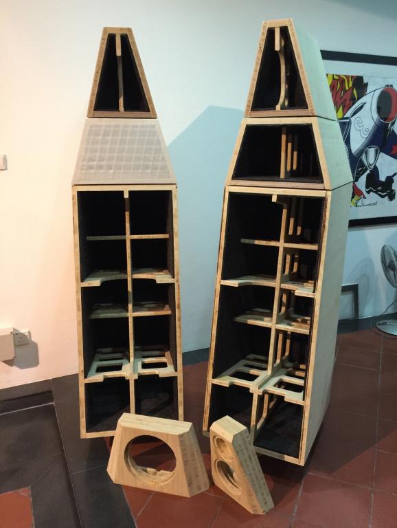

                          #192

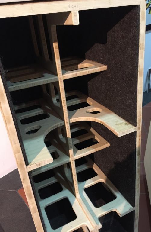

                          Yep - everything on the cabinets are now epoxied in-place. I am using Bitumen Sheets stuck to the inside walls of the cabinet, and then a 1/4" layer of heavy Felt. I like using the Bitumen Sheet and find it adds great mass to the walls - not that these a flimsy or lacking mass, but I am working towards the ultimate cabinet, so no short cuts or short comings

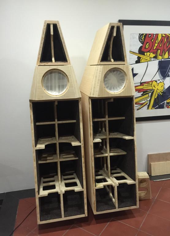

                                #195

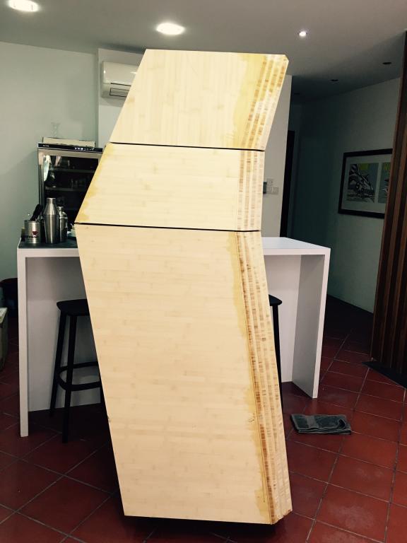

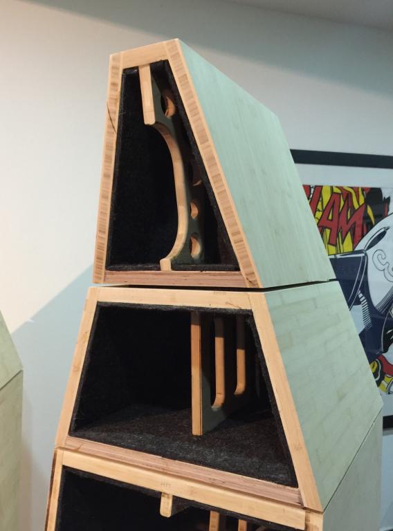

                                A few solid developments in the last week or so...

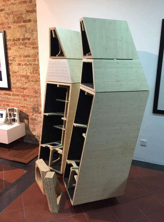

                                Bitumen and Felt have arrived and I have nearly completed lining of all cabinets. Each cabinet has STP 3.2mm Bitumen, then a layer of 6mm Wool Felt. I used Contact Adhesive on the Bitumen as you cant trust the adhesive backing it comes with. The Contact Adhesive I used actually reacts with the Bitumen and then sort of fuses it to the Bamboo... end result is a really great adhesion.
                                All cabinets are essentially complete, but require a few small changes as follows:
                                1 - Bass Cabinet needs the recess for the DS8.0 Amplifiers. I now have a template for this and just waiting on the correct router bit to arrive to cut these out.
                                2 - Mid/Tweeter Cabinets require mounting holes for the input terminals. Yes, the input terminals are in the top cabinet, but that's where the crossover is going to reside and I don't want to run cables up the inside of the cabinets to feed it.
                                3 - Mid/Tweeter and Bass Cabinet need the routing and drilling of speaker line cables. I am using a Via-blue SC-2 Silver Cable for all drivers, and will just run these through the inner panels and seal with SikaFlex.
                                4 - Bass Cabinet also needs small apertures put in the top to run post-crossover lines down from the top Cabinet.
                                All in all, really good progress, especially given I am now balancing time with a three week old daughter...
                                You will note in the images below, I have had to use Ply for the base of the Mid/Tweeter/Bass Modules. Not ideal, but ran out of 25mm Bamboo. I'm not to concerned about it given the short spans between Bamboo reinforces, braces, Sides and Baffle. However... the void question now comes up again. Bamboo - Great, Ply - Rubbish! There are a couple of small voids in the Bamboo, and as I find them I fill with Epoxy.
ID:	862028 Click image for larger version
ID:	862029 Click image for larger version
ID:	862030 Click image for larger version
                                Slight mix up on the Baffle completion, so I am now waiting till the end of this week to hopefully have them all... then its mount them with threaded inserts, add some felt and epoxy them together. (Jon - I have your test Baffle ready to ship, will email you later on this).
                                Next comes finishing, and this is where I have some questions for the forum...
                                I have purchased a Fuji Mini-Mite 3 HVLP System to finish these with. On the MIC #1 Project, I used a basic Wagner HVLP System which actually gave very good results. I used a Water Based Pre-Catalyzed Lacquer from ML Campbell called Agualente. It was excellent! Unfortunately, I am now back in Singapore and simply cannot get access to good Lacquer or even paint types. The high humidity is a factor, and I am starting to get a little nervous on my options. The purchase of the Mini Mite 3 is anticipation to "raising standards" on the finish, but I am going to stick with the Matte White finish... its just a question of what sort of paint...
                                Questions...
                                1 - What's peoples experience using a spray on Acrylic Enamel?
                                2 - Does Enamel end up being hard enough to polish/buff?
                                3 - Can anyone recommend an International Brand Paint that I could consider? Please omit the typical American Brands... as whilst brilliant... I just cant get them in Singapore. Unless, someone knows a distributor that will ship internationally?
                                Any help on the finish side of things would be greatly appreciated!

                                    I agree, automotive finish should work as long as you lay down a good foundation. A base coat of epoxy might be a good idea to ensure you have everything sealed off.
                                    I'm sure they do have car shops and repairs in Singapore, they should be able to help you with paint.
                                    One brand is Glasurit (German).
                                    The downside is that it's some nasty stuff - so take care and ensure good ventilation!

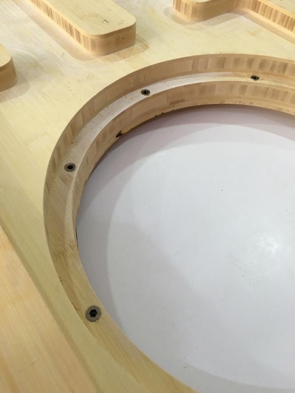

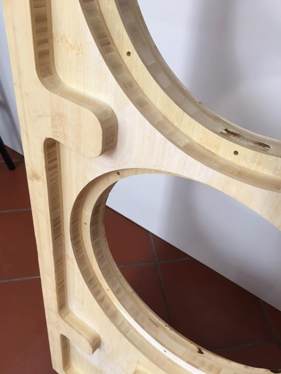

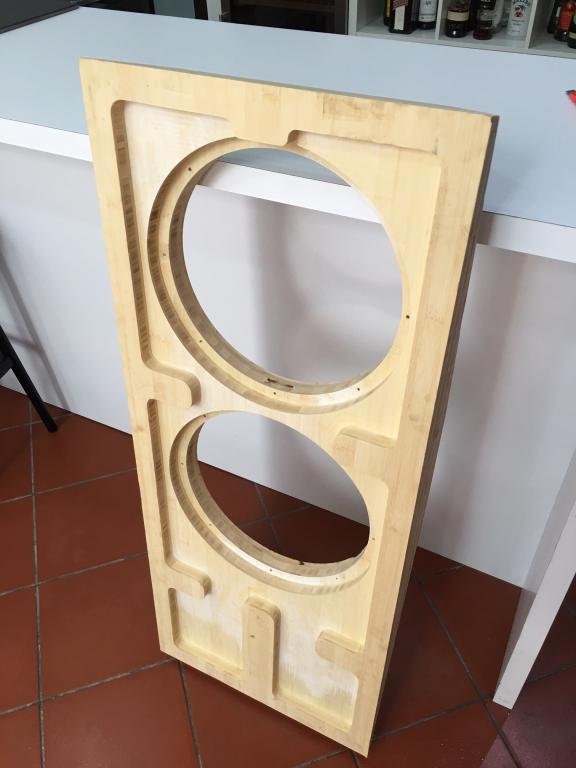

                                                  #204
                                                  Subwoofer Baffle
                                                  Given Jon's awesome progress on the Kurosawa Project, I have been spurred on to get things moving on mine. Just as I had that thought, my Machinist announced he has one of the Subwoofer Baffles ready for collection... So Public Holiday and all today in Singapore, it was time to get things happening again...
ID:	862173 Click image for larger version

                                                    #205
                                                    Subwoofer Baffle

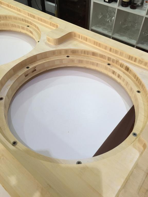

                                                    With Inserts secured in the back of the Baffle, it was time to mount them to the first Subwoofer cabinet...
Name:	FullSizeRender (005).jpg

                                                      Just a couple of questions: what kind of inserts have you used? How are those boxes laid up together? Do you have any kind of fit so they don't slide or are you gonna fix or screw them together?
                                                      I'm curious because I had some problems with my project, mostly because the fit did not came out as planned and I had to sort this rattle between the cabinets.

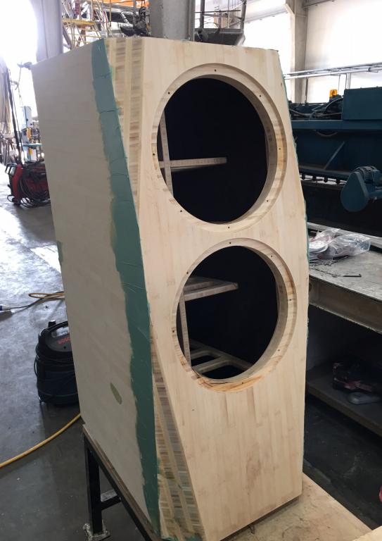

                                                            And then there was two...

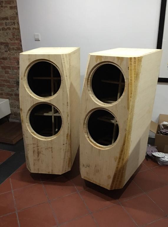

                                                            Finally a pair of Subwoofer cabinets...
Name:	Then there were two.jpg
                                                            Baffles epoxied on and hardening as I type...
                                                            Sanding on the top two enclosures are underway, hoping to get some sealer on them this coming weekend all going well... more updates then!
                                                            Loving the new Mirka Deros 6" Sander, a serious upgrade from my previous Dewalt... Not sure if Jon is having the same success unfortunately!

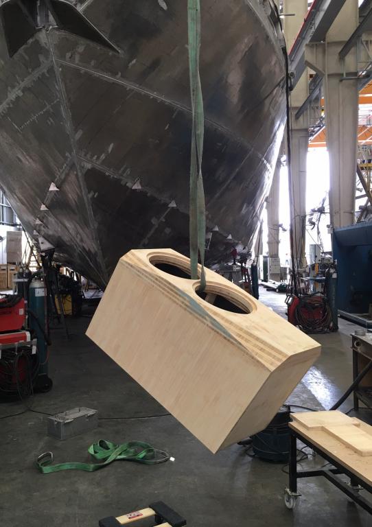

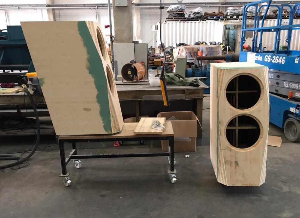

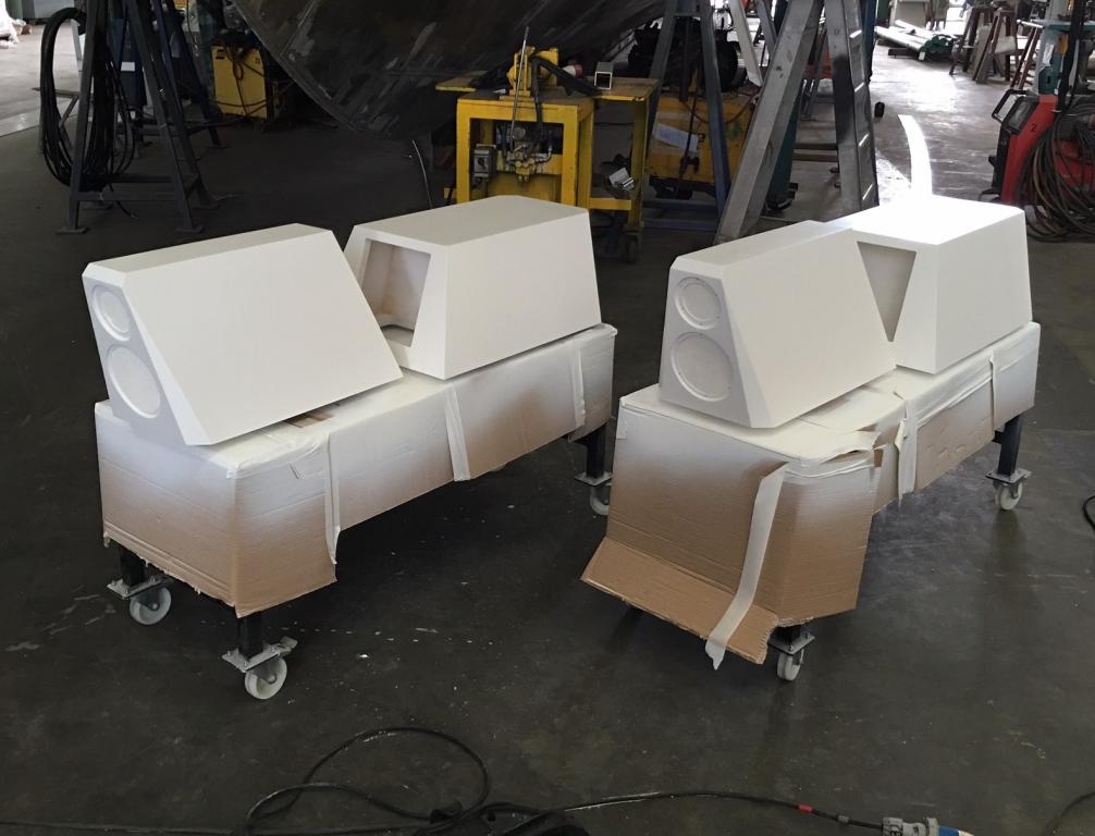

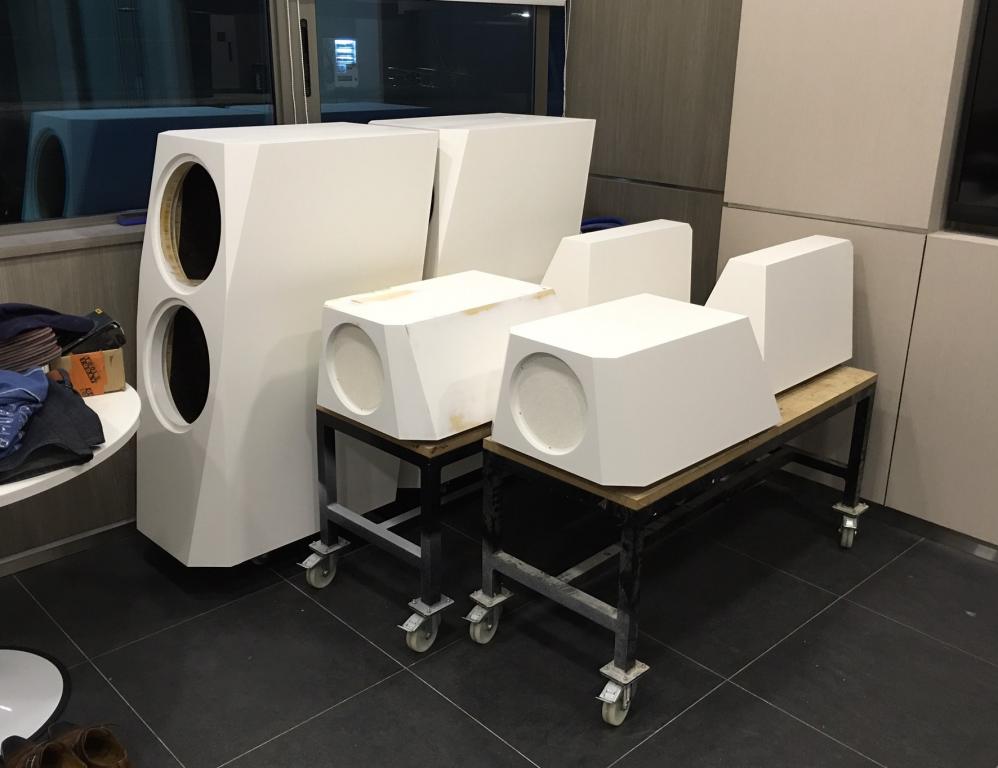

                                                                Marathon Weekend
                                                                Finally a dedicated weekend to progress...
                                                                Subwoofer Cabinets Sanded, Filled, Sanded Filled, Sanded Filled... now pending final sand and prep for sealer coat.
Name:	Sub Woofer Prep.jpg
ID:	862314 Click image for larger version
Name:	Subwoofer Prep 2.jpg
                                                                Only way to lift the Subwoofer Cabinets... 10T Overhead Crane
Name:	Overhead Crane.jpg
                                                                First Sealer Coats on the Mid and Upper Cabinets. Definitely highlighted some deformities in the cabinet prep. One Mid Cabinet will need to go back for some serious "flattening". Overall, happy with the progress, and still to apply another 5+ coats of sealer to get things properly sealed and flat.
Name:	Upper Cabinets.jpg
                                                                Travelling for work for the next couple of weeks, so progress once again goes into hiatus... dam it!
                                                                One observation for cabinets this size... the standard paint cup for the Fuji HVLP Sprayer lasts hardly a single coat across the Mid and Upper Cabinets... which equates to a very small portion of the large cabinets. Time to purchase the larger Aluminum Cup me thinks! And a whole lot more Paint/Thinner!!

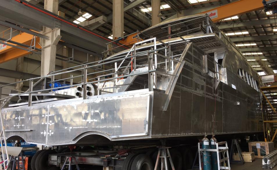

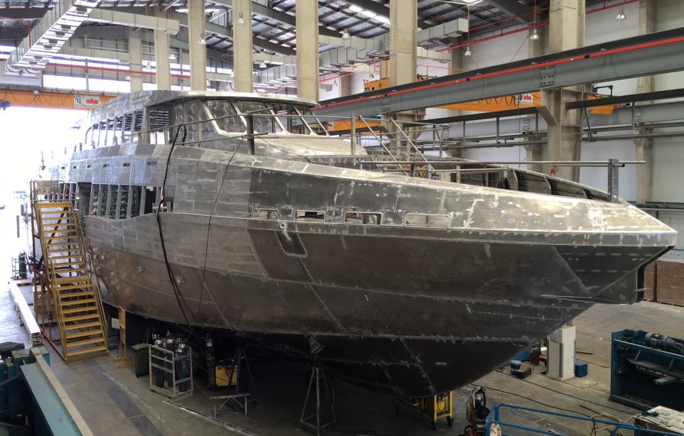

                                                                          #216
                                                                          Small "Day Cruiser"...
                                                                          Just a small vessel under construction... 40m Cruiser for tripping around one of the Pacific Island Reefs!
                                                                            • 16109
                                                                            #217
                                                                            That will be an exceptionally large hole in the water to throw money into!
                                                                              • 698
                                                                              #218
                                                                              Nice progress!
                                                                              Looking for what is a relatively expensive DIY speaker build next to something like this makes both the speaker and the budget for it appear very small...
                                                                              • scottvalentin
                                                                                • May 2015
                                                                                • 175
                                                                                #219
                                                                                I think you need speakers for the ship next.
                                                                                  #220
                                                                                  I'm seeing enough space to renovate or even scratch build an Imperial Lambda shuttle...

                                                                                    #221
                                                                                    Progress... albeit slow!
                                                                                    More progress hopefully happening this coming weekend... Cabinets all still need minor filling and then sealing. Aiming to have everything "leveled" and final sealer coats on by the end of the weekend!
                                                                                            [ATTACH=CONFIG]26516[/ATTACH]
                                                                                            Nice progress, Michael! :T
