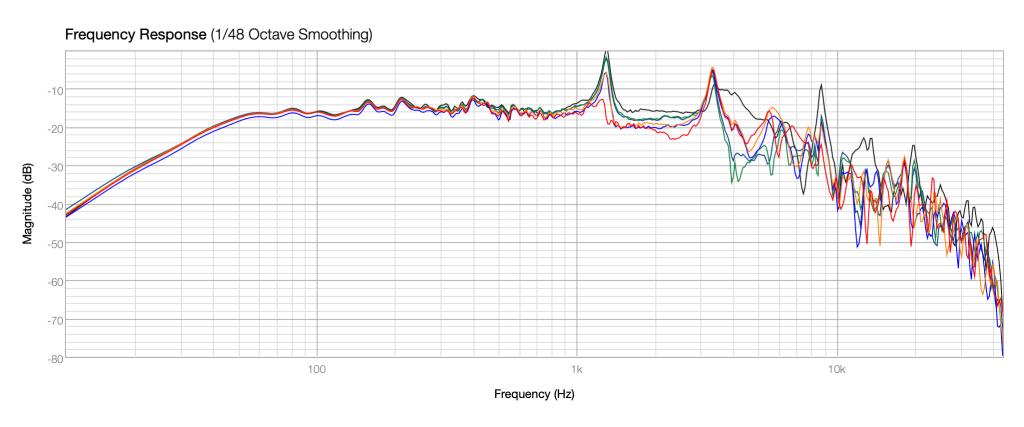

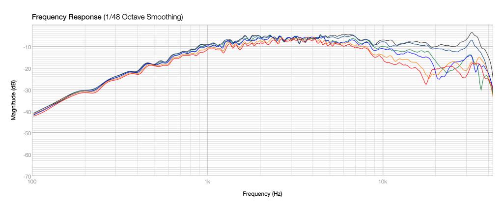

                                                  A lot of measurements were done yesterday afternoon, including far-field and far-field polar, and quasi near field with distortion.
                                                  For reference to the basic driver characteristics, here are quasi-near field measurements:
                                                  Scanspeak 7140 Be tweeters (purchased for the Kurosawa project; chosen by MB for his Osiris project)

                                                    Scanspeak 7140 -
Name:	SS7140 Polar 0-50 deg-2.jpg
                                                    I think some of the behavior on axis is due to diffraction and edge effects from the cabinet, based on polar measurements done for the Kurosawa project, for which these tweeters were purchased.
                                                    Accuton C168-6-990
Name:	C168-6-990 Polar 2.jpg
                                                    These measurements are pretty consistent with those previously made in a more conventional test cabinet.
                                                    Accuton AS250
                                                    Updated measurements
Name:	AS250-8-552 Polar 0-50 deg.jpg

                                                      Modeling the AS250-8-552 for enclosures.
                                                      Some enclosure modeling may be helpful for those considering the AS25-8-552 for different tasks- whether as a mid bass driver or a "full range" woofer.
                                                      Now, as a mid bass driver, like MB is using it, things are pretty simple- go sealed, and a net enclosure volume of ~28L will put you in the ball park for a maximally flat alignment with an Fb of about 50Hz.

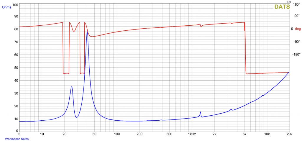

                                                      But what if you want to extract the "maximum" full range woofer performance from this single 10" driver (MSRP about $1500 these days).
                                                      Well, things look a bit different, and a fairly optimal configuration is in a 70L enclosure with 2x RSS265PR with a single disk weight (275G MMS)
Name:	AS250 PR 70L 2x RSS265PR SPL.jpg
Name:	AS250 PR 70L 2x RSS265PR Excursion.jpg
Name:	AS250 PR 70L Impedance.jpg
                                                      This is not a tiny enclosure for a nominally 10" woofer, but with an Fb below 30Hz, an an output capability of about 105 dB down to that cutoff, you are getting some reasonable output- an lord only knows you won't see AS250's at every local regional DIY meet!

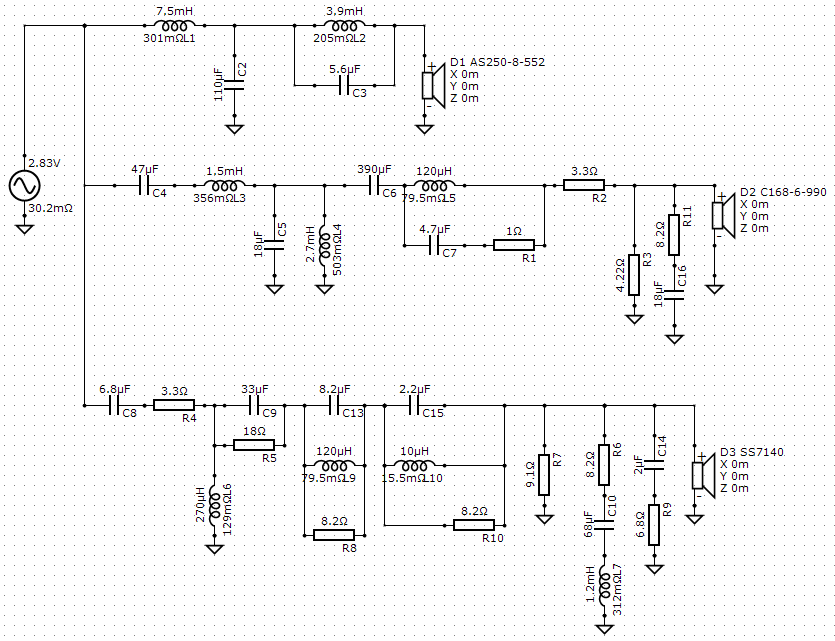

                                                        For fun, I setup VituixCAD 2 on my LG Gram 17, so I could work on the island in the kitchen great room, and after reconfiguring some things from my normal 4K setup, I found that worked pretty well- the LG Gram has a very nice display as PC laptops go- my standard of comparison being the Dell XPS15 I have as a dedicated controller for the Audio Precision analyzer.
                                                        For the obvious reasons, this bears some similarity to the recent Isiris crossover update, though note that driver impedances are all different, as are component values.
Name:	Osiris LR3 TA3 XO-schema-1.png

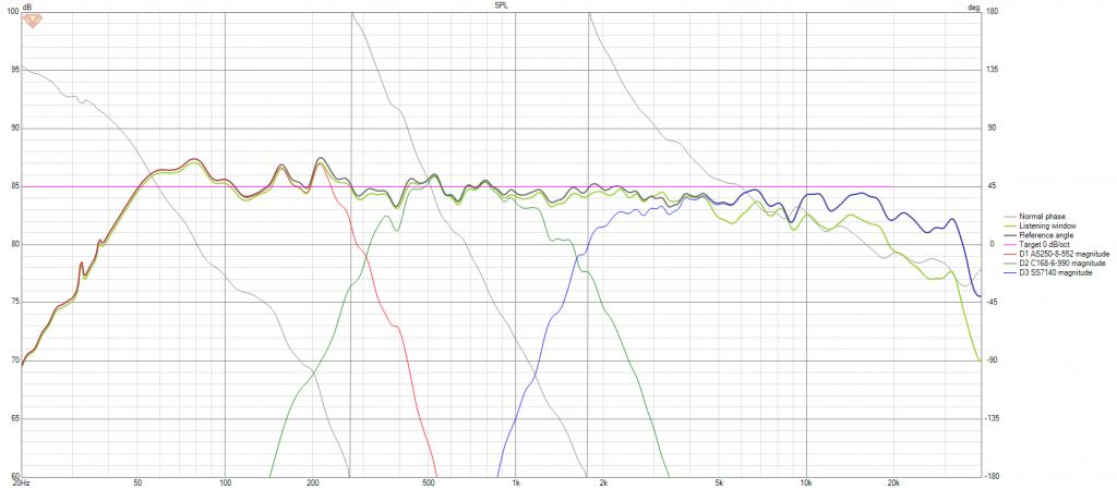

                                                        The target for this design pass was a flat profile at relatively "near" far field. A voiced version will be prepared soon.
Name:	Osiris LR3 TA3 SPL.jpg
                                                        This is the calculated SPL response with midrange phase inverted, showing fairly good nulls from phase cancellation. It is can be a balancing act between deepness of phase nulls and overall flatness of response. That latter takes precedence, to a degree.
Name:	Osiris LR3 TA3 SPL-InvertMid.jpg

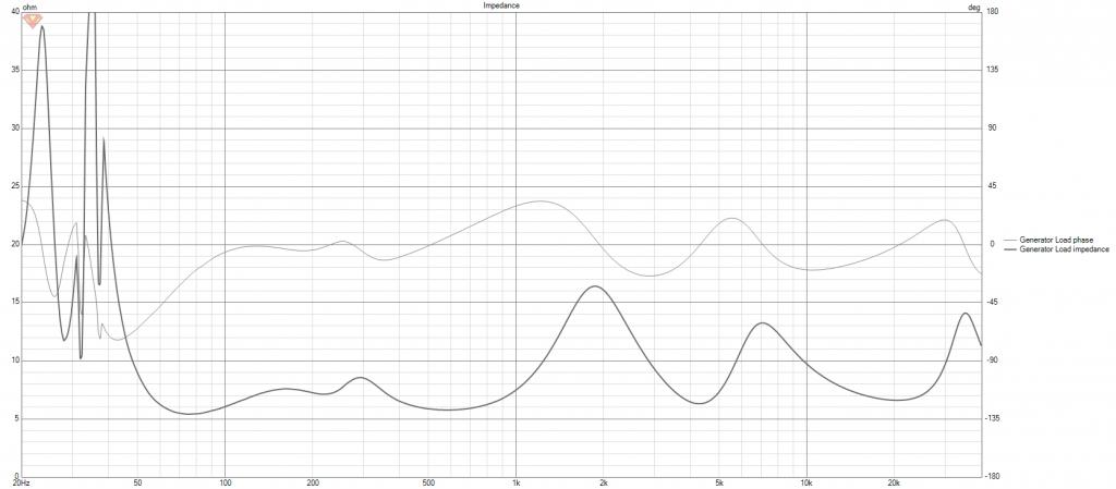

                                                          Impedance
                                                          The minimum impedance is no lower than about 5.4 ohms, and is usually at 6 ohms or above. LCR shunt networks could reduce the impedance peaks, but with any reasonably low output impedance amplifier that seems like an unnecessary embellishment. the impedance peak in the 34 kHz area is for the upper breakup mode suppression.
Name:	Osiris LR3 TA3 Impedance.jpg

                                                            Voiced crossover network
                                                            As promised, a "voiced" version of the crossover network...
Name:	Osiris LR3-V-TA3 XO-schema-1.png
                                                            Blink and you might miss the changes...
