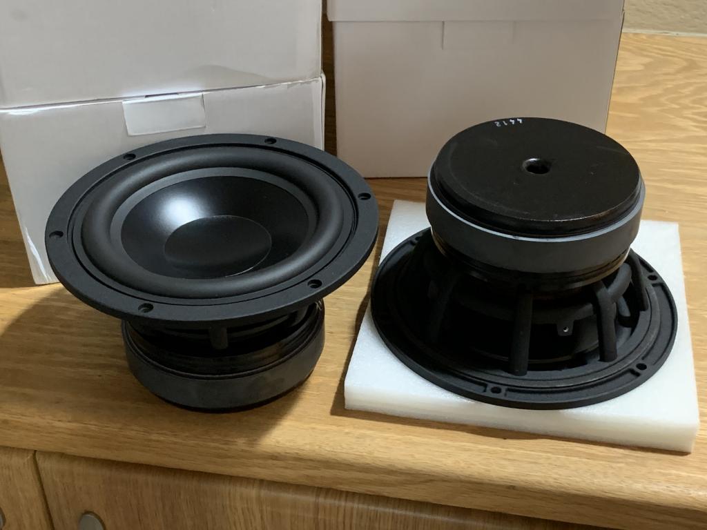

                          In fact, coming across a double pair of the very early Anarchy woofers in my storage facility triggered what might be likened to a flashback - and a clear intuition that now might be the time where all the pieces come together... as another recent post suggests, revisiting the legacy to go back to the future...
                          A double pair of recent production Anarchy's are here- they seem identical to the original ones, except for signage on the driver.

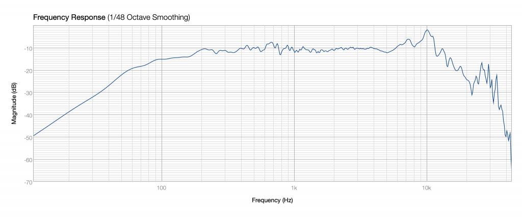

                          Polar plots for the DA25...
Name:	DA25TX00-08 Windowed Polar Graph.jpg

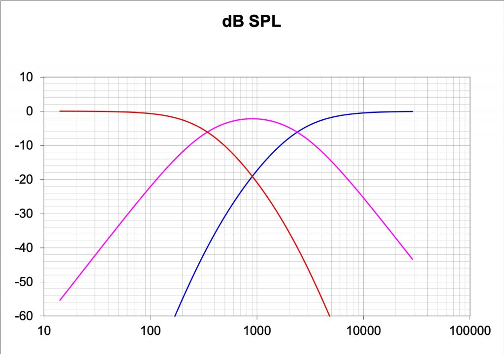

                          A concept crossover for the planned driver impedance has already been formulated... based on the Duelund concept, with a center frequency of 900Hz, and an aleph of about 3...
Name:	Ardent HTD Target Filter Function.jpg
                          Intriguing characteristics of the Duelund concepts are that the drivers are always in the same relative phase with each other, and there is only one phase rotation, and low group delay.
                          The target is reducing driver costs to 1/3 to 1/4 of the original configurations. It is not clear yet what cost reductions may be possible with careful selection of components for the filters.
                          The cabinet design for now will be a modified version of the first generation cabinet, built with maple ply, bamboo ply, and BB ply. With that I cannot bring costs down- but Steve may be able to make the effort less burdensome for other builders.
                          Once a functional proof of concept study has validated the full blown construction effort, a new thread will be started... and a New Adventure.

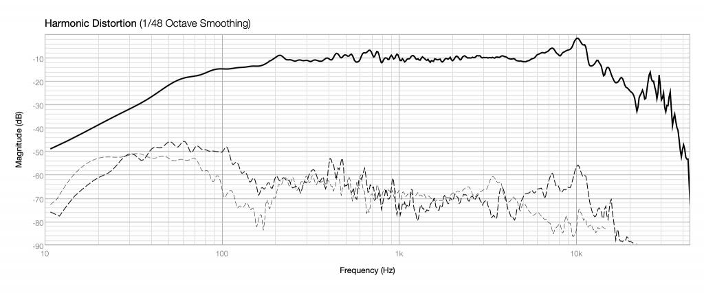

                            And here, a Satori + DA25 experimental system...
Name:	Ref Voiced Notched Disto.jpg
                            Highlighting aspects of this tweeter's capabilities

                                  I have measured many tweeters over the last 15 years, and quite a few at a wide range of price points in the last six months, but the only dome application I can think of where this wouldn't be my first choice to consider, is where unusual high sensitivity might be needed, such as an MTM with 6ND430- then BlieSMa is the one to consider carefully.
                                  Look at the distortion plot of the Satori two way above. Clearly the tweeter outclasses the woofer... though they were matched up carefully, as regards crossover, with expensive components for both. Crossover point is 1800Hz.
                                  But listen to it yourself- I have had messages from other's trying it out who are similarly impressed.

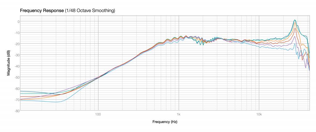

                                                                    Candidate for bang for the credit winner.
                                                                    The "Dark Horse" candidate was interesting... most interesting.
                                                                    Fundamentals show no insurmountable issues...
Name:	FW135H 0 Deg Nominal.jpg
                                                                    Distortion at nominal drive has HD2 and HD3 tracking rather closely - and HD3 staying low in the critical areas.
Name:	F135H Distortion2.jpg
                                                                    Polar behavior is limited by the size of the diaphragm, but is quite satisfactory for the desired frequency range and levels...
Name:	FW135H 0-40 Polar2.jpg

                                                                    A reminder of the midrange target characteristic...
Name:	ARDENT HTD TARGET.jpg
