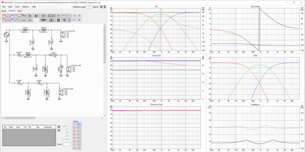

                          A concept crossover for the planned driver impedance has already been formulated... based on the Duelund concept, with a center frequency of 900Hz, and an aleph of about 3...
Name:	Ardent HTD Target Filter Function.jpg
                          Intriguing characteristics of the Duelund concepts are that the drivers are always in the same relative phase with each other, and there is only one phase rotation, and low group delay.
                          The target is reducing driver costs to 1/3 to 1/4 of the original configurations. It is not clear yet what cost reductions may be possible with careful selection of components for the filters.
                          The cabinet design for now will be a modified version of the first generation cabinet, built with maple ply, bamboo ply, and BB ply. With that I cannot bring costs down- but Steve may be able to make the effort less burdensome for other builders.
                          Once a functional proof of concept study has validated the full blown construction effort, a new thread will be started... and a New Adventure.

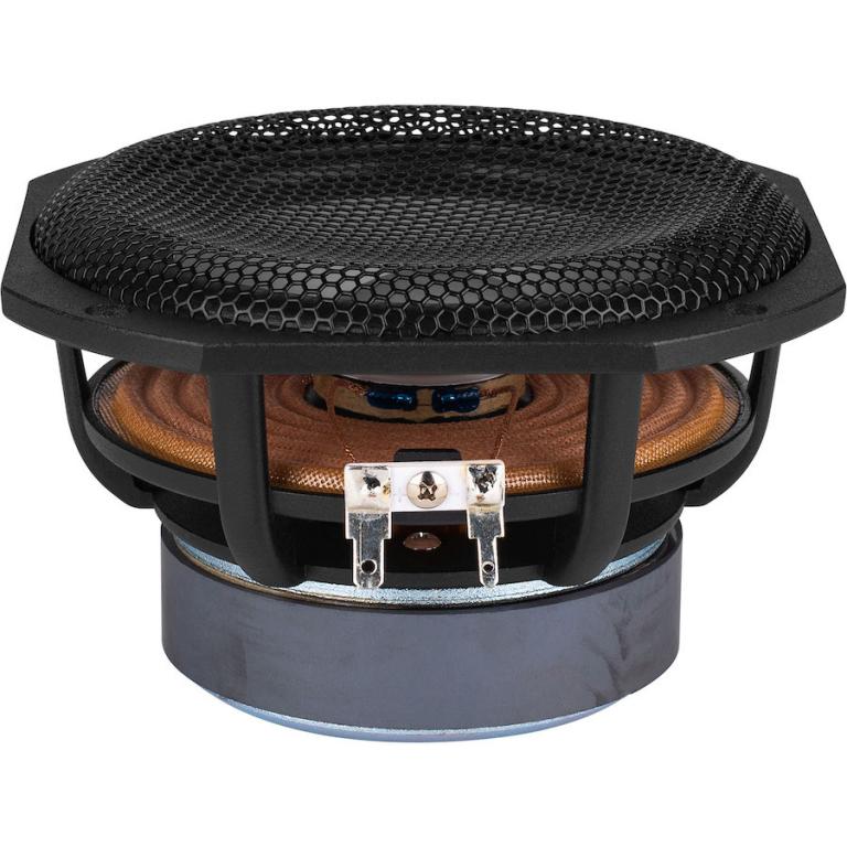

                                                                    Candidate for bang for the credit winner.
                                                                    The "Dark Horse" candidate was interesting... most interesting.
                                                                    Fundamentals show no insurmountable issues...

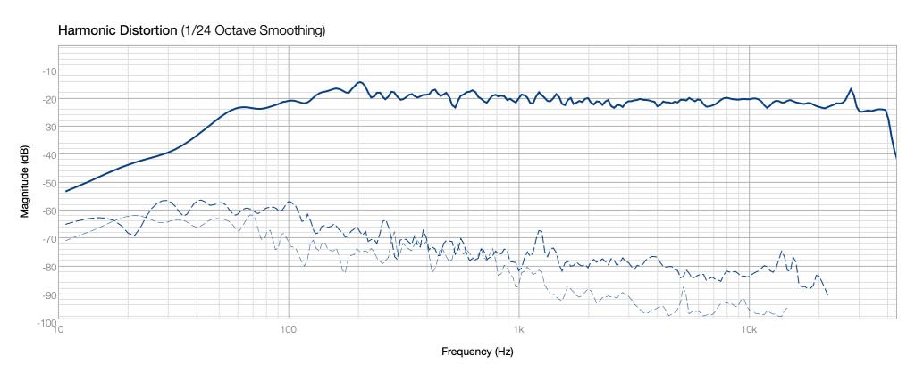

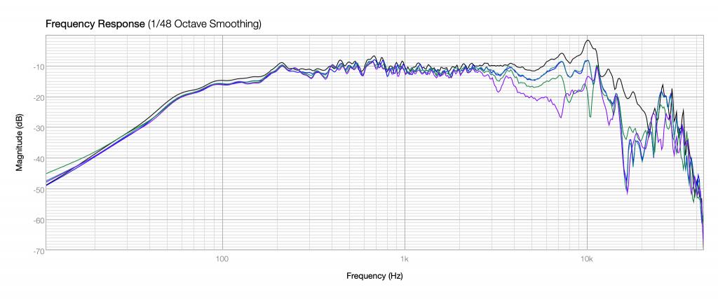

Name:	FW135H 0 Deg Nominal.jpg
                                                                    Distortion at nominal drive has HD2 and HD3 tracking rather closely - and HD3 staying low in the critical areas.
Name:	F135H Distortion2.jpg
                                                                    Polar behavior is limited by the size of the diaphragm, but is quite satisfactory for the desired frequency range and levels...
Name:	FW135H 0-40 Polar2.jpg
                                                                    All for $35...

                                                                    One might say that it "looks" the part, with the protective grille- one which I verified before considering mounting and measuring that it is quite dead, better than many Accuton grilles.
