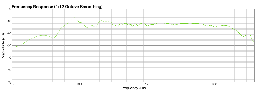

                In answer to your question, Taco, I'd say the "weak" point of this system is the ER18RNX- they're just got so much sweap area and though they were selected for very clean bass and midrange distortion, the Accuton mid and SS tweeter are a tough act to follow. This speaker system was aimed at the 105 dB peak range, and I think the mids have no problems with that- with the Duelund acoustic function, even if a speaker is pushed to 106-108 at 100 Hz, the mids should be OK- higher up, it's a breeze for them. The measured distortion data for the drivers alone confirms this, even when I pushed them somewhat. Obvoiusly, there are benefits to the bigger drivers for larger rooms and if you really think it needful to live at higher SPLs.
                Afterall, there's a reason the Isis exists as well as the Indra. Frankly, I think this mid has enough headroom that I could imagine doing a dual 22W SS setup with it on the bottom end. I'm sure Avalon had similar reasoning in developing the Avalon Time, which uses a larger dual woofer setup than the Indra. Then we could lower that distortion floor significantly in the lower end- but of course, at a price. Now, if you guys could take up a collection so that I could retire and work on these full time, just think of all the interesting designs I could crank out- I might even be able to keep up with Paul W! Well, almost!
                It all certainly provides me with motivation for the Modula Xtreme build, though I'm still pondering the final tweeter choice- more testing and evaulations to do there. If I can fix the 10 kHz mouth/throat resonance, I'll probably go with the Millenium Excel- otherwise it's the "proven solution" with the D2608/9130.
                And yeah, I do have a pair of 22W sitting around- but they're still earmarked for the Nascent/Aducator build. Got new baffles started for the Nascents, unfortunately, also have two weeks of business travel coming up!

                          Well, here I think I'm bass constrained. And I am hitting the transfer function targets pretty well- actually, crossing over to 7's this low is probably not the norm. But look at the distortion curve for the system at 90 dB out (for one speaker). I mean, I get where you're coming from- I wouldn't try to use a single Tangband 1337s as a midrange in this system! And in spite of some earlier thoughts, I don't think I'd do a "Budget" version with the RS100. OTOH, I think the Vifa NE149W would manage OK.
                          One way to get a handle on this is to use Linkwitz's SPL Excel sheet, though it's setup to compare dipoles and monopoles, and lord only knows Xmax is not the ideal design limit, but it gives a starter sanity check.
                          Considering the C79, distortion plots, particularly HD3 are a reasonable guide- here's the C79 at 96 dB output:
                          As you push it harder, the corner frequency where HD3 starts rising (as you go lower) moves up, but you can see here that at 96 dB and 300 Hz, things still look pretty nice compared with a LOT of parts out there.
                          Now, looking at that in light of our transfer function curve, 96 dB at 300 Hz from the midrange correlates with a nominal flatband output of 102 dB considering the mibass output also- and this from just one speaker, and at pretty low distortion levels. Since I'm using these in a room about 12 X 18 ft, a pair will play at volumes that are probably unhealthy for my ears without being really stressed. That's one of the things one sometimes has to be careful of with really low distortion drivers- you don't realize how loud you may be listening. The first system I built that was really stealthy about that was my X1 SLAM Klones, but it was something of a quantum leap for me in three ways, and between keeping the range for the Eton 7's limited to 150 Hz on the bottom, and using the Focal TC120d tweeters just from 2250 up, they would do things like Michael Hedges at ludicrous volumes, sounding pristine clear, until you realized you were getting some interference from the ringing in your ears.
                          Now, I don't think you'd quite get to that turf combining the C79 with a pair of SS 22W, but I think that might be a pretty optimal combination for the Ardent Center channel.
                          Now, the Modula Xtreme with the big Accuton mids and a pair of 26W on each side, that I think will match the old SLAMs for SPL with low distortion, and with lower coloration.

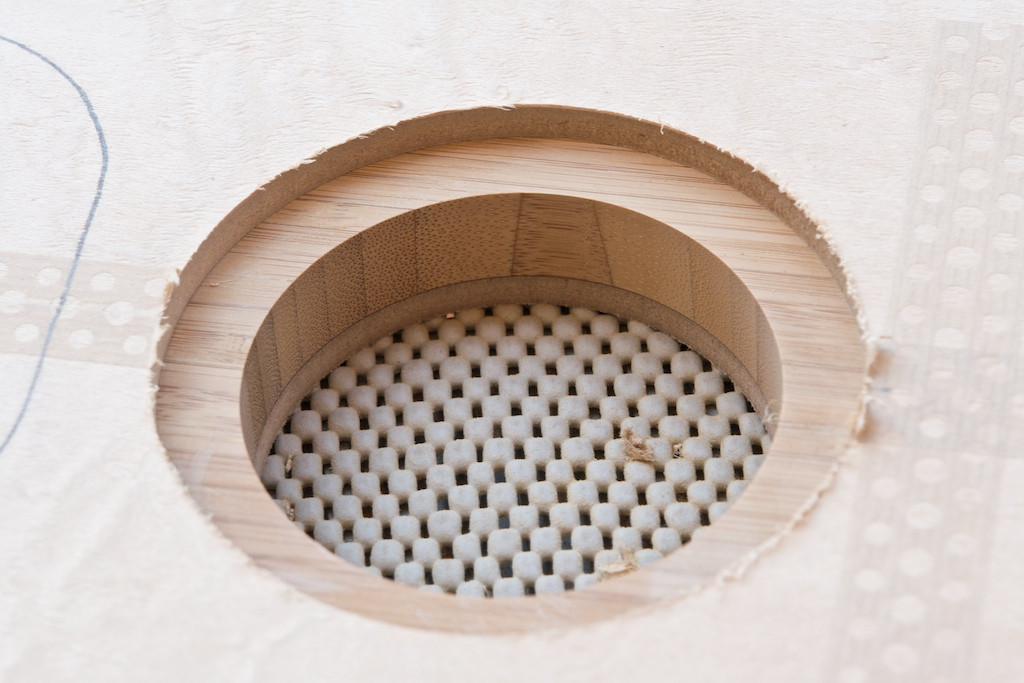

                                                        Been following this project closely but only just joined up to the forum. Really outstanding work! Looks like a great design 8)
                                                        The LBL core for the outer front panel has an interesting texture, as seen here in the prepared tweeter opening; it is quite hard and dense, not hard to see why Jim Salk and some others are doing enclosure work with it; but it seems to machine nicely, at least with sharp tools.
                                                        Click image for larger version  Name:	Ardent-TweeterHoleLBL.jpg Views:	1 Size:	145.6 KB ID:	936563
                                                        I've seen mention of this LBL product in a few threads, but searching for it online turns up nothing for me. Does it go by a different name? Where are you sourcing it from?
                                                          • 16077
                                                          #1153
                                                          Laminated Bamboo Lumbar, CJD is also a fan (for more conventional applications, like his home flooring!
                                                          Currently I buy 3/4" X 12" cross section boards from the Rockler store in Pleasant Hill; they don't source it through "Rockler corporate" but through a specialty wood wholesaler. The only buy about once a quarter, so I'm often check their status and updating them with my needs- just picked up a couple more boards recently for some of the new upcoming projects.
                                                          For "small" pieces, though, I've been turning to a different source - bamboo cutting boards, through online vendors like Amazon, or locals like Target. Bought in quantity online, the price comes down pretty low. (think six packs- literally)
                                                          To use for special functions, like a tweeter mounting board with waveguide, or for a whole front panel for a smaller speaker project (like 10" X 16", for example).

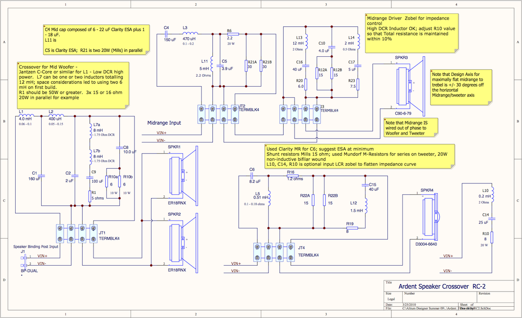

                                                                                Status update and Crossover schematic
                                                                                Been so busy I've didn't get around to finishing drawing up the crossover schematic for those that might be interested and posting it-
                                                                                I'll be putting together a BOM with general component selection guidelines during the upcoming week.
                                                                                A few notes are on the schematic, but a few more may be in order.
                                                                                The LCR network in the midrange, C17/L14/R23 came about from the listening campaign described earlier; it takes care of a bit of a bump in the 2 kHz region of the C79. Blue is "before" and violet is "after". This follows the Duelund transfer target better.
Name:	0307 LCR Mid Tweak.png

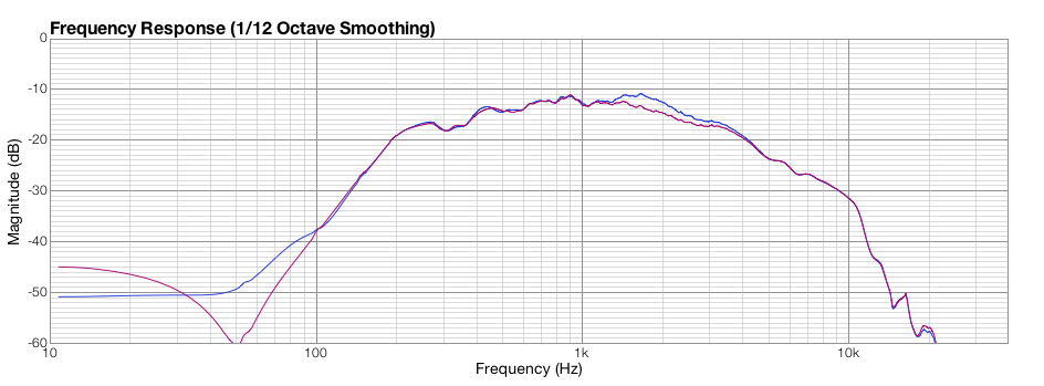

                                                                                Some have asked about the "fugly" diffraction pad- what does it really do?
                                                                                This plot probably shows the why's and wherefores better than any arm waving, at least as regards on axis.

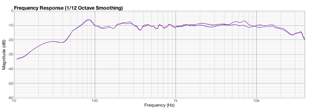

                                                                                Diffraction induced effects are also not usually uniform with regards to the measurement axis... so a "pet" theory of mine (which doesn't mean it isn't wrong) is that if you clean up the diffraction related stuff, if the drivers are operated in the right band and the crossover is solid, you should have pretty consistent behavior at least out to +/- 30 degrees or more (considering the limits of driver dispersion as you approach the top of the pass band).
                                                                                So, this is the response measured at 30 degrees off the horizontal axis.
                                                                                Not perfection, but certainly something I can live with.

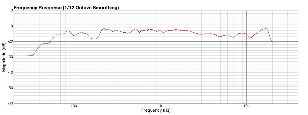

                                                                                For reference, set the Wayback machine to October in Denver, when first fired up based on just LspCAD calculations, and when they were running the D3004/6620 tweeters on top.

                                                                                    Jon I don't see components numbered "C17/L14/R23" in the schematic for the mids, am I missing something? Did you mean 13/16/10?
                                                                                      • 16077
                                                                                      #1167
                                                                                      Nope! But I am! Thanks for the catch- will correct and update! That's what comes from having too many things on different pieces of paper when you try to create the "master plan".
                                                                                      Updated evening of 3-25-2010.
                                                                                      Ryan, you can probably preview the cuts on Amazon if you want- it's an interesting album, more of an R&B feel on some cuts, definitely more of a "risk" taken then her first and most recent pop efforts. Probably why the label wasn't supporting it initially.

                                                                                        38 components per speaker! :E That's what is called a "perfectionist" crossover I assume? :P
                                                                                          • 16077
                                                                                          #1169
                                                                                          Other than three parts, it's what just get's the job done...

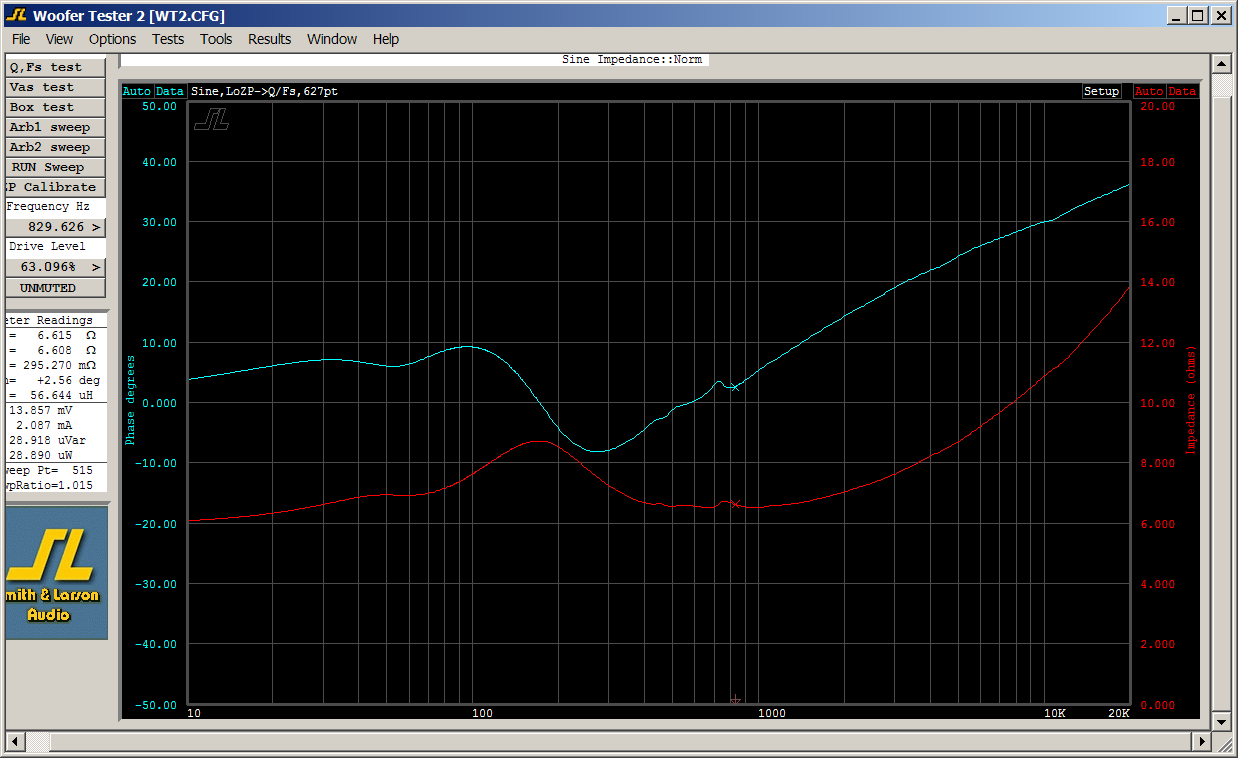

                                                                                          Alas, it's what get's the job done. Of course, I suspect you're counting paralleled resistors- though you may not be counting paralleled caps.
                                                                                          You could leave some parts out, but every time you do, things get a bit more problematic... like some of Tony Gee's crossovers.
                                                                                          For example, leave off the woofer low frequency zobel, and the interaction of the main LF inductor and the driver impedance shifts gives a nice bump in the upper bass- might be preferred by some that like their bottom end a bit zaftig.
                                                                                          The SS tweeter has a significant impedance rise which if left "untreated" will put a bump in the bottom end below 1 kHz- with the Duelund concept, we must match the transfer function well down to -20 dB or better-
                                                                                          Similarly, the C79 has impedance swings that can't be ignored either for crossover operation.
                                                                                          Click image for larger version  Name:	C79-Cab-Plot.png Views:	4894 Size:	73.1 KB ID:	854612
                                                                                          Steen's crossovers I've heard would make this one look like a piffle...
                                                                                          But if you want to build the "basic" version, as opposed to the "perfectionist"
                                                                                          version, then one can remove L10, C14, and R10, as their only purpose is to kill a bump in the impedance curve that occurs between the midrange driver and tweeter, which may interact with amplifiers with higher output impedance (vacuum tube or no feedback solid state designs), causing a bump in the presence region (that's how it models).
                                                                                          So, there are some options.... but those parts are so relatively small and inexpensive in the overall scheme of things, I didn't see the need to point that out. :B
