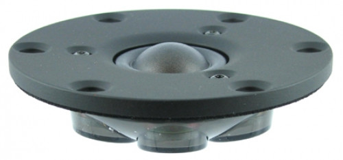

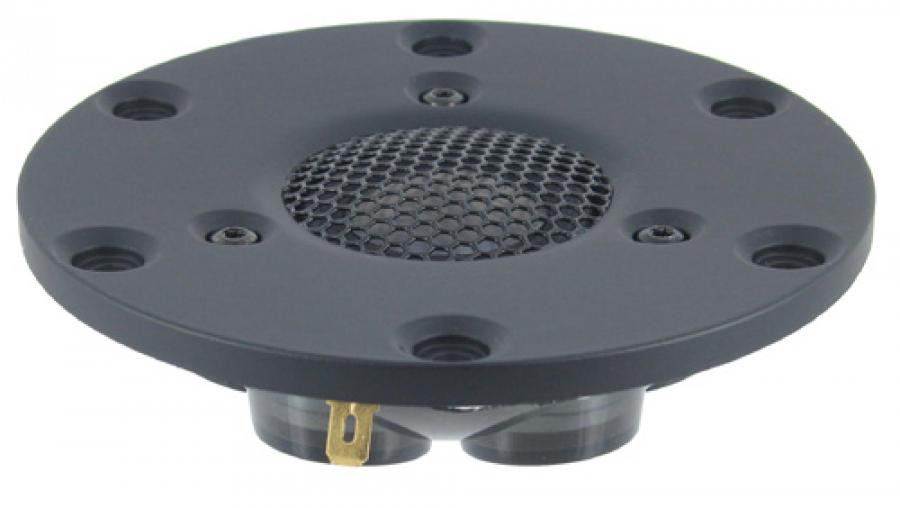

                  Now, interesting thing is, looking at the tweeter front plate,
                  it is more similar to this...
                  Enough that I'd hazard the mounting is quite compatible and the basic profile excepting right at the suspension edge nearly identical.

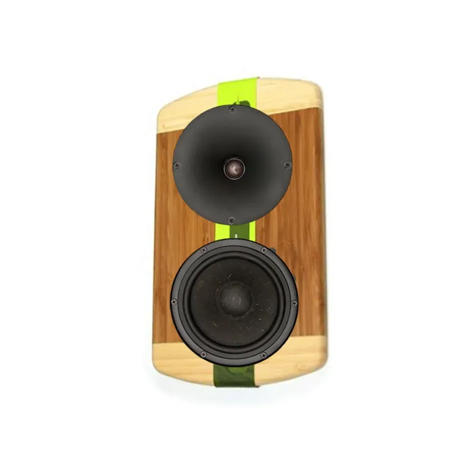

                                                Say, a waveguide tweeter, a 7" mid, two 8's, and then an LF assembly in dipole below 120 Hz or so. But I'm getting ahead of myself.
                                                Stop teasing me! Yesterday, I found myself staring at a display of True Bamboo 3205's as if they were a pair of :boobies: in the middle of a Target store. Why do I need a cutting board, I'm not building anything? (yet)
                                                Craigj
                                                  • 16073
                                                  #1059
                                                  you don't NEED one, but now, you know you WANT one. You know the potential locked up inside one of those little beauties... (and we're not talking about an Apple iPad- that's a story for another day....)
                                                  It's a sad day when we're talking about cutting board porn.... maybe I have more of an excuse, being a single guy.
                                                  Now, the next thing, is to figure out how to artistically cut the 3205's so as to take advantage of the blonde bamboo portion, and lay them up in a pattern, perhaps in front of a solid vertical sheet of the more standard LBL? Will have to give that one some thought...
                                                  • CraigJ
                                                    • 519
                                                    #1060
                                                    Now, the next thing, is to figure out how to artistically cut the 3205's so as to take advantage of the blonde bamboo portion...
                                                    I had mentally taken advantage of those blonde portions. Get your mind out of the gutter, I was thinking of this; Modula MT MkIV Dipole
                                                      Click image for larger version  Name:	Jonsdipole.webp Views:	0 Size:	14.2 KB ID:	936630
                                                      Now we're talking! :P
                                                      Too few dipole speakers here lately. :cry:
