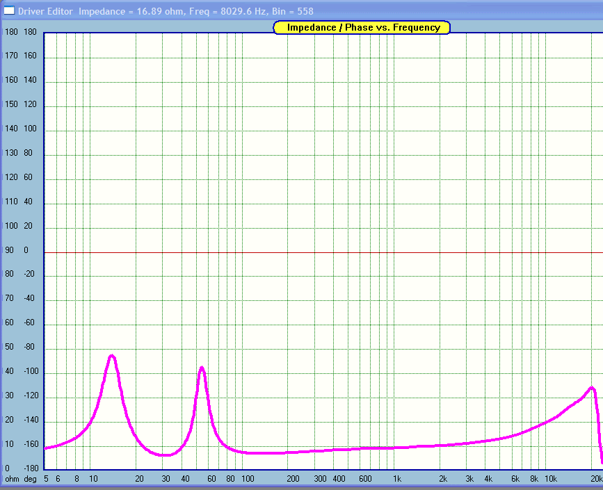

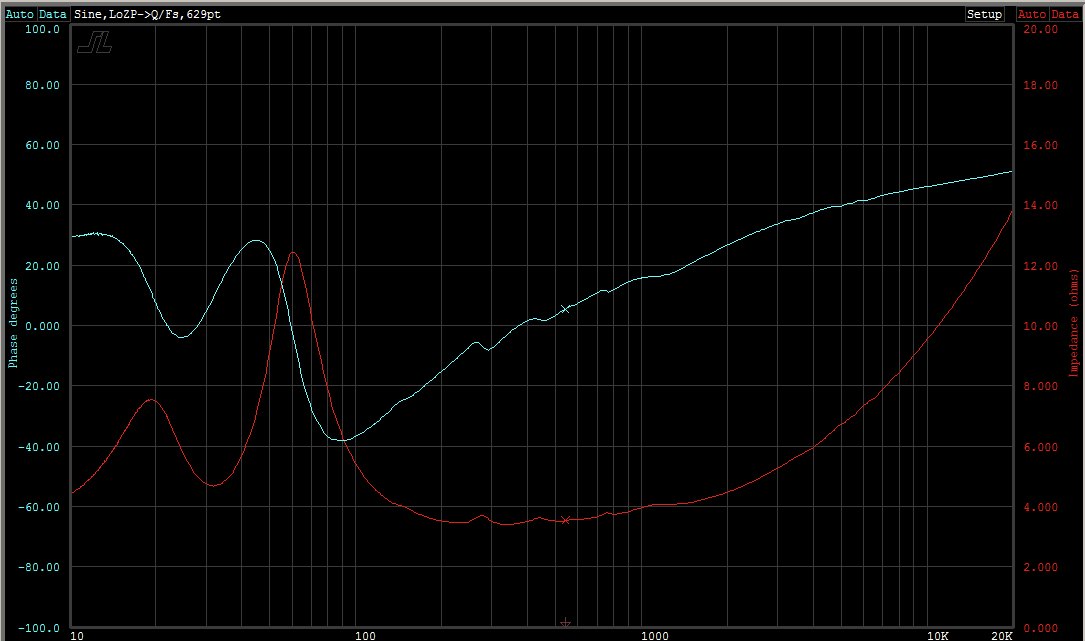

                        A few more comments re low frequency design
                        This tall cabinet does have a tendency to develop a column resonance wave- it's necessary to use some extra damping at the bottom near the port, or the response will have a dip centered in the 180 Hz area; an impedance bobble is visible in the woofer Z curves.
                        This measurement was taken with the lower chamber having no stuffing where the port is. The amplitude effects can be seen in the older test traces here, which are also comparing the sweeps with the LF zobel connected or not connected. Can you guess which curve is which? :W

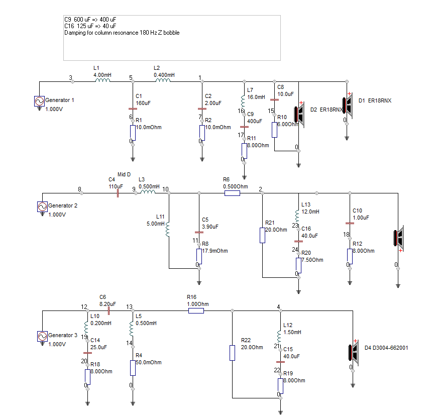

                            Last for now, this is the current working crossover network, except that the midrange series resistor is 1 ohm, likely to become 2 ohms based on simulation last night; tweeter pad shunt currently 30 ohms, to become 15 ohms.

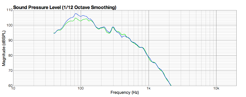

                                    I had the same issue in the redesign of the Lineup Maxx Mk2, that I did this year to replace the D26 tweeter version in the MA section.
                                    There were some impedance wobbles because I didn't have enough dampening material at the top and bottom of the box.
                                    Here's before adding the additional Acousta Stuf:
                                    Here's after adding more fill to absorb standing waves:
                                    Click image for larger version  Name:	LF-ZobelComp.png Views:	7439 Size:	45.4 KB ID:	853802
                                    Thank you for taking that additional measurement. It definitely appears to smooth the low end. In the past I've avoided really low crossover points between the mid and woofers because of the added component costs and high Q peak in the electrical transfer function below say 150hz, which appears to require that big zobel network. This appears to be the only solution given the Duelund style crossover slopes and selected crossover points. I just wonder if you'd have equal sonics with LR2 and FCs of say 400hz and 2.5k, which might simplify the crossover network and result in similar phase characteristics. I also believe the C79's low end tapers off like that because of the use of ferro fluid in the motor. Just thinking out loud.
                                    Your speakers do look amazing and the measurements are looking great. I agree that the mids might get cut maybe 1-1.5dbs more (you mentioned it somewhere), but having not heard them, I'm just going by what I see from the in room response.

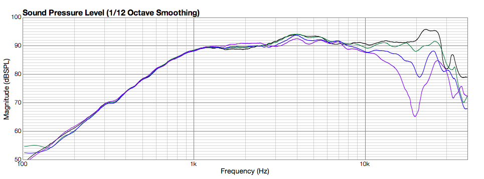

                                        Thanks for the corroboration and your plots, Jed. :T I think it's an unavoidable issue to be dealt with with a design like this.
                                        I did a lot of pondering and soul searching about the crossover point, considering a higher center frequency and different alignment to get a 400 Hz crossover, but in the end my conclusion was that because the midwoofer output is still important and sums with the midrange up to the CF (900 Hz in this case), I was pushing CTR-CTR issues with a higher crossover point and higher center frequency- I figured this roughly 250 Hz might work out better, and would distribute the power response region over a fairly tall stack of drivers, which might help floor bounce issues.
                                        I also think the low crossover point has helped integration issues- I can get nice measurements at 1 or 2 meters of course, but also as close as 18-20" on the midrange axis- sometimes this is a problem in three way systems. OTOH, I wouldn't call these nearfield monitors.. :lol:
                                        I think in the end that has worked out well, apart from the cost of the LF zobel. With just nulling the impedance peak centered at 60 Hz, two 8 mH high Z inductors don't cost too much, and now it's down to 400 uF in the capacitor bank, which seems, well, if not ideal, at least manageable. :W
                                        The midrange zobel is no longer just a zobel, but also plays an additional role in shaping the roll off characteristics of the C79, which as you can see from the plots, is quite different from the Avalon Indra.
                                        Unfortunately, this still isn't an inexpensive crossover; it's about as complex and expensive as it would take to do an Isis clone, for example.

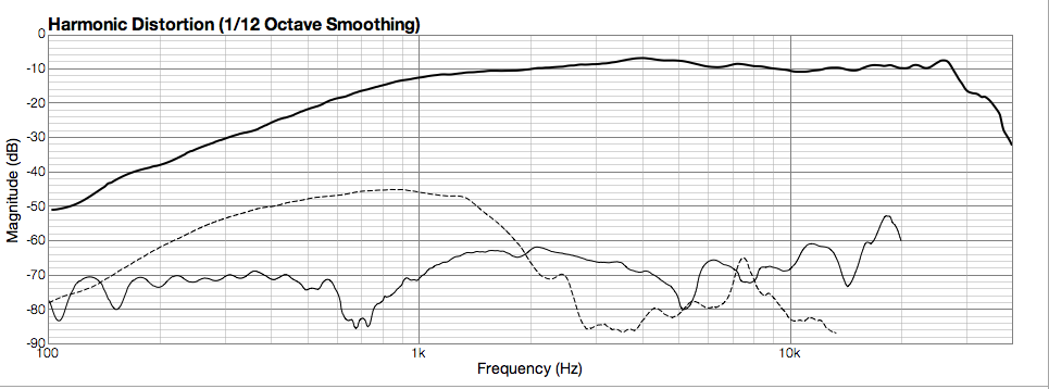

                                        Not a decision I have to make soon, of course!
                                        I think I'll need to give my hands some time to recover from construction stress before considering another big project, though!! :rofl: Too much joint clicking and a bit of carpal tunnel syndrome that comes and goes.

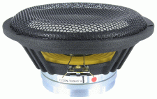

                                          But now ET is playing with a pair of 8" SS, and while I think they'll work OK in his project, I'm wondering now if a dual 8" 8857 big brother to the Ardent with the C173N-T6-90 midrange wouldn't be interesting... But should I "cheap out" and use the Accuton tweeters I already have (C30N) or get some more Scanspeaks? .
                                          Having experienced the 10" Revelator scan speak with the C173n-T6-90, I think about the only thing that would be better is a pair of them on the low end. The 8"ers would make for a nice relatively compact solution, without giving up too much-- I would say. My only reservation about the Accuton tweeter is whether or not it can handle a Duelund transfer function much below 2.5k. As you have proven, that's no problem for the Illuminator 6620 or Air Circ 6600. That is assuming you want to go with Duelund crossover slopes again. Believe it or not, the C173n-T6-90 can do it.
                                          Another option that is interesting, and something I won't be trying anytime soon unless I win the lotto, is a pair of Accuton 8" drivers. The neo magnet version looks interesting, but I'm not sure how well the T/S parameters will model.

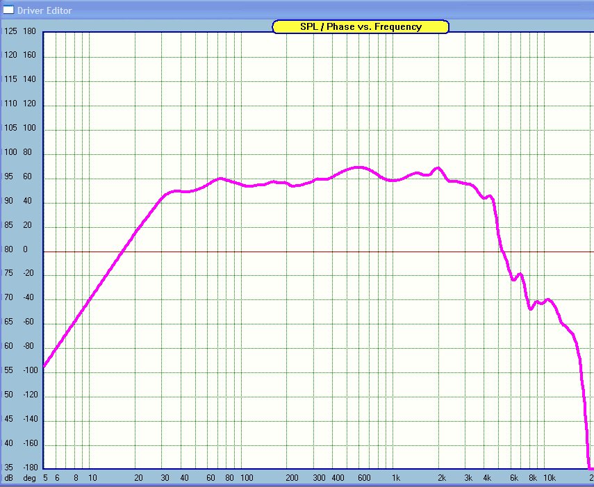

                                                        Here are some measurements of mine in/on box. The spl is nearfield-farfield-port merged, with HBT applied. I believe the hump at 500hz is baffle related.
                                                        Click image for larger version  Name:	TD12H_NF_FF_portmerge.gif Views:	0 Size:	23.8 KB ID:	936614
                                                        Click image for larger version  Name:	TD12H-Z.gif Views:	0 Size:	25.4 KB ID:	936615
                                                        Thanks for the heads up- I'll take a look- that sensitivity and claimed extension in a 50 L cabinet almost sounds too good to be true. Unfortunately the PDF link is broken, that is, it comes up with a message that the PDF is not available, as the data isn't ready yet. The BL product must be rather high, as the quoted Qts is 0.19- in a reflex, that will generally model with the response in the Fs area down correspondingly. if they had published data, such as T/S parameters and SPL curves, I'd certainly try modeling it.
                                                        Did you record distortion plots at a standard output level?
                                                                    No, I have not done any distortion measurements myself. I discovered the driver through Jeff Bagby and Jim Salk. They used it in Salk's Archos open baffle design. Jeff had given glowing reports of the driver and I trust Jeff completely. Then I heard the prototype speaker at InDIYana2008 and it knocked my socks off, so I decided to design something inspired by it, starting with the Lambda TD12H, but I used a different pro mid and tweeter than Salk used. Jeff used a maximally flat design for the woofer in 45L with an F3 of around 37 or 38 as I recall. I upped it to 52 liters and got the F3 modeled at around 35hz or so with a couple db dip at the bottom end. John J. will send you the TS parameters he measures on each driver he makes that can be used for modeling, if you ask for it.

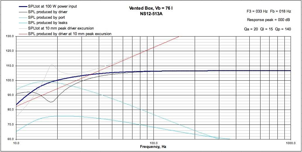

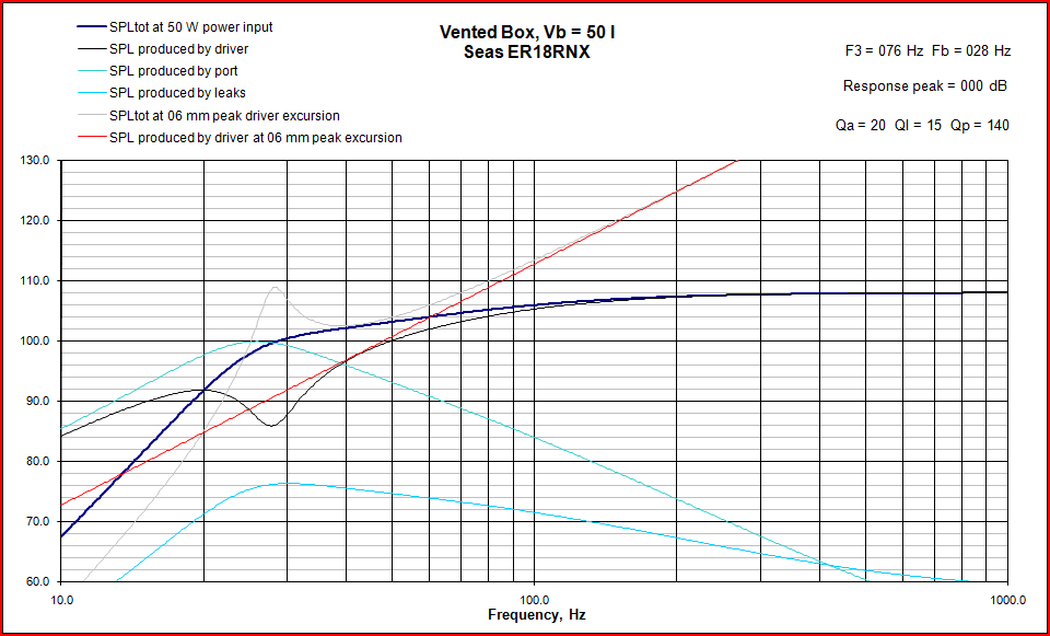

                                                                            Yeah, the only real drawback of the 10's (like the 28W/8867) (besides the cost) are the largish enclosures required for deep extension. I don't remember if I tried modeling dual 8867, but I think off the cuff you'd want north of 140 L- I should double check that just to be sure. I was hoping to avoid a box that size, but the 10's do work up pretty smooth to 1 kHz, enough to work OK with a Duelund alignment. So, I should look at those again just to be sure. As you might imagine, I'm looking for alignments that get close to what I modeled for the Aurasound 12 in 75 liters or so...
                                                                            In my experience these kinds of alignments produce the most satisfying and neutral in room performance if you're going with a ported design.
                                                                            The Ardent doesn't match the low end extension, but I was just looking for 30 Hz, and in room with only moderate boundary lift below 50 Hz they should work out OK- they certainly are turning the trick in Tom's living room.
