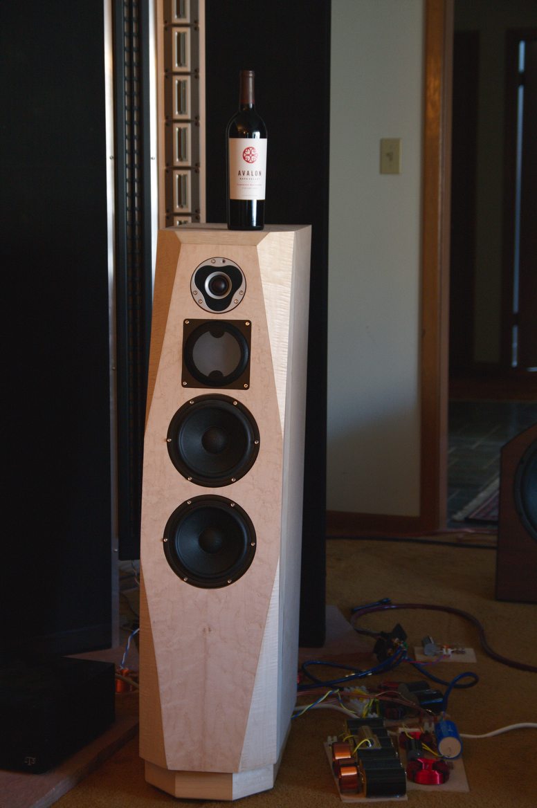

                                                                                          Testing and listening update
                                                                                          Thomas has been cracking the whip the last two days, and Colorado Tom came over this afternoon to check up on things.
                                                                                          Yes, there are two of these.....
                                                                                          And I measured both, but not having quite enough damping material on hand for the right hand cabinet, I'm just showing measurements for the left hand one for now.... :W
                                                                                          Thanks and a tip of the hat to Colorado Tom for the excellent photography aid... :B

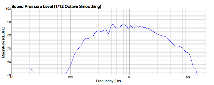

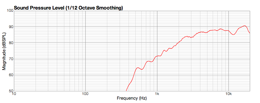

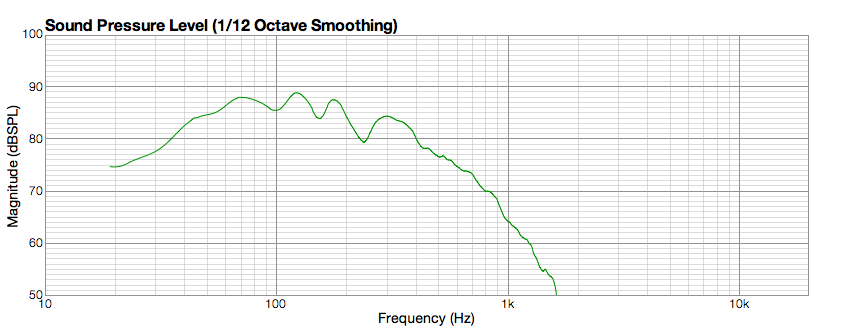

                                                                                            Some measurements...
                                                                                            Per request, the individual drivers are measured as well as the summed total, on the midrange driver axis. Gating window width is 60 msec, so room effects are visible, of course. The cabinets haven't been cranked up on the points fully, and cables are coming through the port, so LF output is a bit restricted- though it didn't really sound that way. Ports don't have the flare extension yet, but tuning frequency is ~32 Hz.
                                                                                            LF Measurement
                                                                                            Midrange Measurement
                                                                                            HF Measurement
