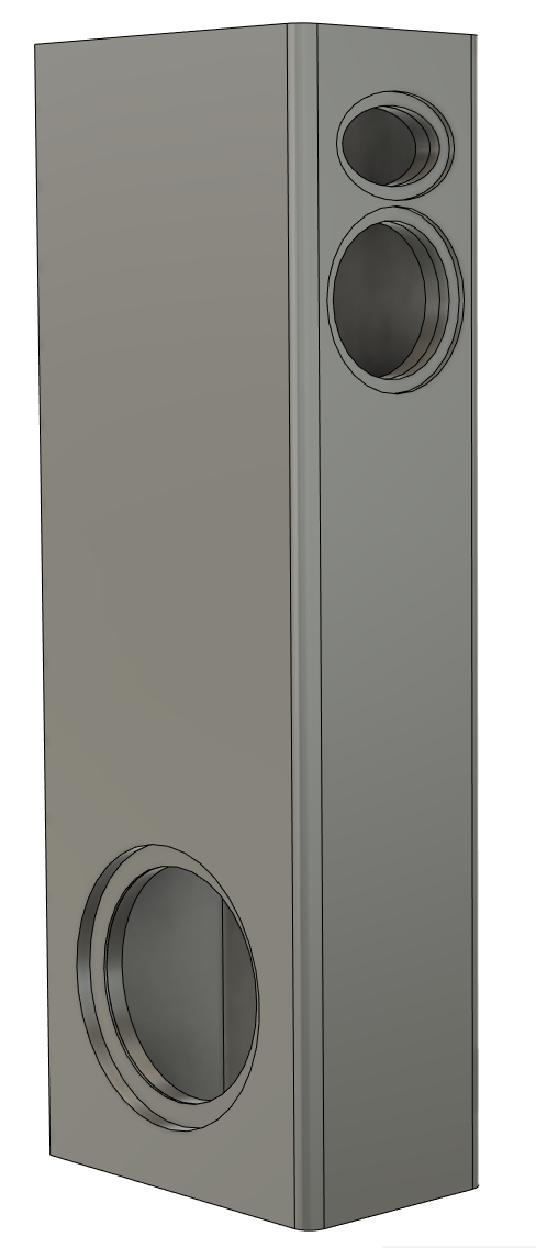

    Any thoughts on side mounted woofer (CSS SDX10) in floorstander designs?
    (Just more pondering with parts on hand)
    I currently have a pair of:
    1) SB Acoustics SB26ADC Tweeters
    2) SB Acoustics SB17MFC35-8 Mid-woofers
    3) CSS SDX 10 Woofers
    I was contemplating using the trio in a slim (relatively speaking) floor-stander with the SDX10 mounted on the side. Kind of like the Aerial Acoustics Model 8
    The crossover point would be in the 200Hz-250Hz range <-- mainly based on Erin's (of ErinsAudioCorner) measurements of the ceramic version of the woofer. He found distortion below 200Hz starts to climb rather quickly.
    I wanted to know whether fellow forum members have any experience with such designs, or if they see any concerns with proceeding with such a design.
    Also - I was thinking of utilizing the CSS in a 45liter sealed enclosure, which would result in a .707 alignment. F3 would be at approximately 43Hz, and F10 at 24Hz. With boundary reinforcement, I'm hoping the F3/F10 will drop by an additional few Hz. Another option would be a long rectangular port running up the back wall of the speaker.

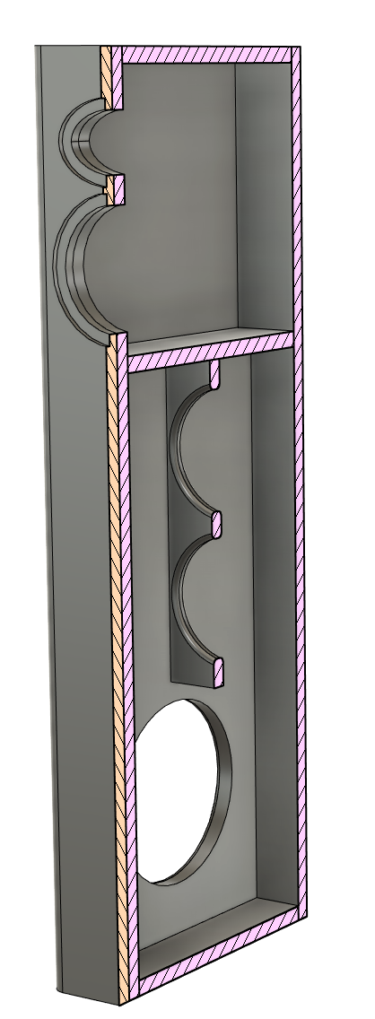

    Thoughts? (See picture below - obviously, I'll be including more bracing).

    You could also use a Dayton 10" PR on the opposite side of the woofer as well.
    You might want to think about having the woofer a little higher off the floor as well. I remember Jon did some experiments with woofer height and found the bass was a lot tighter with the woofer ~12" off the floor.
    Should be a cool project though.

      Thanks for responding, Steve. Will keep the 12" height recommendation in mind.
      In regards to going passive, I'm assuming the ideal location would be on the opposite wall, but:
      1) I don't think there will be any space as the motor on the SDX getts pretty close (just off by 1.75") from the opposite wall.
      2) Given the excursion capabilities of the SDX, I imagine I would need a pretty large passive radiator.
      I'm hoping the sealed output + boundary reinforcement will result in sufficient performance for general 2-channel music listening. However, if you think I'm wasting output/performance, please do let me know :-).

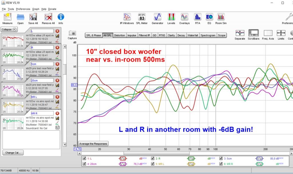

              • Juhazi
                • 239
                Originally posted by tktran
                I've got some 90 degree off axis measurements of 6.5", 10" and 15" woofers somewhere here. I can post that.
                The only thing is phase. I mean if a woofer is facing backwards it makes a difference, so at 90 degrees you would think so to...
                No, phase is not a problem. In a 3-way speaker and woofer crossed below Schröder limit, and in normal domestic conditions, phase shift effect will be minimal. With dsp-xo mid+tweeter delay setting is useful, to compensate this. Floor/side/rear surface reflections will boost bass spl with some ms delay and complicate things anyway. This makes a difference to what can be simulated or measured in a huge anechoic chamber or outdoor/ground plane. This effect is also the main reason why bass sound changes so much with different positioning (distance to wall).
                In a rather small room modes will also complicate things even more, but the lowest mode will also give extra boost which will help closed box bass. Closed has tighter bass and I recommend that warmly in this case. Naturally the port can be blocked...
                An example of my 10" closed box bass nearfield vs. room response.

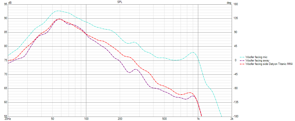

                              Wanted to circle back on this. I took some outside ground plane measurements of a passive subwoofer (Dayton Titanic MK4) I had on hand. The woofer is 12", but its baffle is as wide as the depth contemplated for the design above.
                              I then simulated the (late) Mr. Bagby "Universal Crossover" (i.e., 5mh in series, followed by a 200uf + 3ohm in parallel). The simulated response is below.
                              The dotted red line represents the 0-design axis (i.e., woofer facing right, as the mic sits facing the cabinet)
                              The dotted purple line represents the -90 degrees (i.e., woofer facing away, with the mic directly facing the side opposite of the side the woofer is mounted)
                              The dotted turquoise line represents the +90degrees (i.e. woofer now facing the mic).
                              (please note the rotational axis was the side of the bass cabinet, as it would be in a side-mounted woofer floor-stander).
                              Based on my review, there is quite a bit of variance between +90 and -90 (about 8db at the crossover frequency, approximately 200hz - 250hz), and even between +90 and 0 (about 5db in the 200Hz - 300hz range)
                              I also did this comparison between +40 and -40, and the variation again was 5db at between 200hz - 300hz.
                              Isn't that quite a bit of variance? I mean, I love the idea of a slim tower, but will I be compromising too much when it comes to sound?

                                What's the distance of your GP measurement?
                                • Efalegalo
                                  • Jan 2007
                                  • 162
                                  Approximately 2 meters.
                                  • tktran
                                    • 703
                                    I thought that you were measuring too close, resulting in differences in SPL due to relative distance between the mic and the driver. But I think 2 metres is enough- suppose your cabinet dimension is 50cm deep. Turning your cabinet backwards moves the mic from 2m to 2.5m and would account to 2dB loss, not 3dB or more loss that you’ve measured. (8dB at 200Hz)
                                    So there’s 2 outcomes I can infer-
                                    A) bass is not truly omnidirectional - in the bass you lose at least 3dB between 20Hz and 100Hz by rotating a cabinet 90 degrees
                                    B) we’re not measuring what we want to measure.
                                    Do you have a turntable or lazy susan type device to place the subwoofer; to rotate the sub and measure in the nearfield? (eg.20mm from cone or cabinet wall). (Sanity check)- should have same outcome as ground plane.

                                      Thanks for your thoughts Tktran.
                                      I think part of the difference observed between 20Hz and 100Hz can be partially explained by the increased physical difference between mic and actual woofer locations.
                                      When the woofer is directly facing the mic (i.e.,+90) vs when the woofer is facing away (i.e., -90), that actual woofer (sound source) is now approximately 18"-20" inches away. At least that was the case with the base cabinet I was testing with. Maybe with the floorstander contemplated above, this difference wouldn't be as severe because the actual baffle width would be 8"-9".
                                      • tktran
                                        • 703
                                        Yes I agree with you.
                                        So it looks to me that you could certainly do a side firing woofer; as long as you cross about 100Hz; at 200Hz you will encounter some challenges unless you design for it in your crossover/DSP, or accept the 2-3dB loss and adjust for it with in-room EQ. That’s what’s all my professional musician friends do- on location EQ for live sound.
