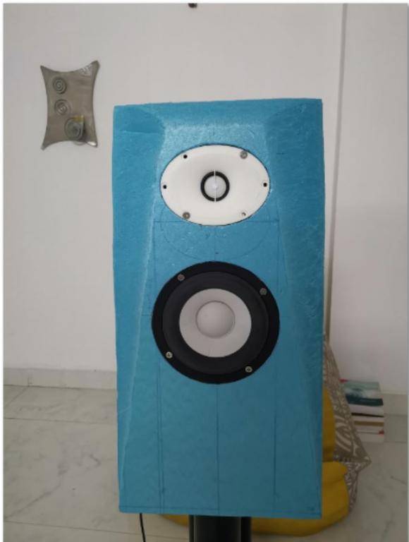

    As a first attempt, I have made a prototype of the top half of the intended baffle and started studying taking actual measurements using REW.
    Here are some pics of temporary baffle, measurements and resulting frequency response measurements, over 50 degree angle (0 to 50 degree or 10 to 60 degree, I lost one of the measurements, not sure which one).
    I made the baffle out of insulation foam material and carved the angular shapes/chamfers on the baffle out of it using pen knives. The dimensions are similar to the intended final widths and final look of the baffle (at least the top half of it). As of now, I am very happy with this preliminary attempt where I have been able to capture the horizontal off axis behavior of a waveguide to some extent.

                I have completed a prototype box and attached the baffle to it. The box size for the mid is currently about 10 L in volume. Using this, I have tried to do full 0 to +90 degree measurements in the horizontal plane on for both the mid driver SB15CAC30-8 and the tweeter SB26CDC004 in the 4 inch waveguide. Looks like they came out well.
                The tweeter in the waveguide looks good. Now it is time to start thinking about building the actual enclosure.
                In the meanwhile, I will use these measurements in VituixCAD and play around with it to try to design a prototype crossover for mid-tweeter.
                In the attached Pics,
                Pic-1 shows drivers on baffle

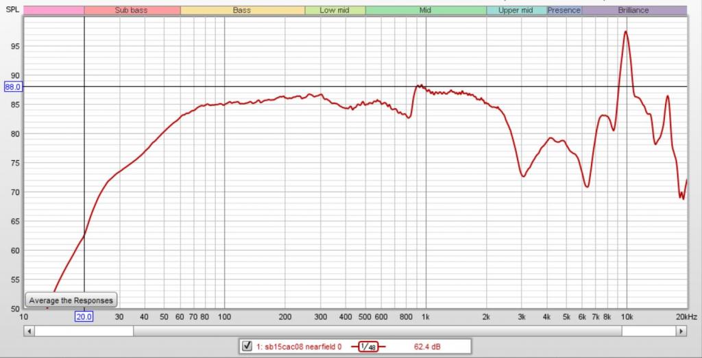

                Pic-2 is the nearfield measurement of the mid

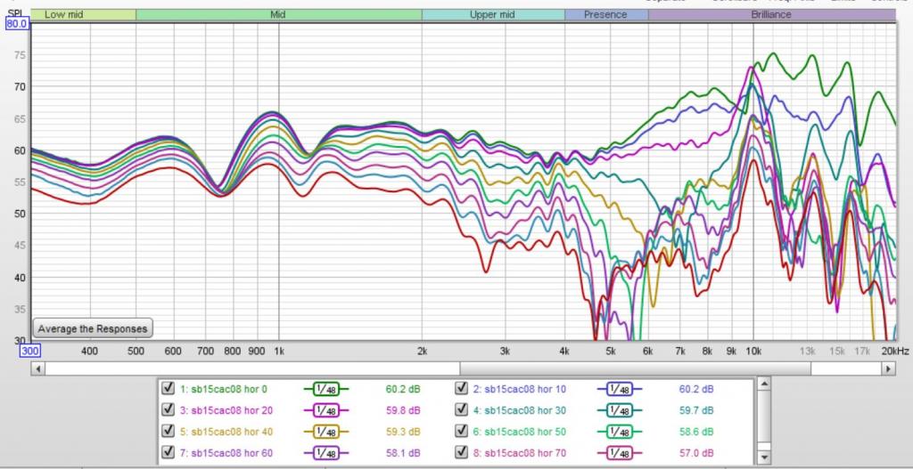

                Pic-3 is the gated far field measurement set for mid (gate = 4ms)

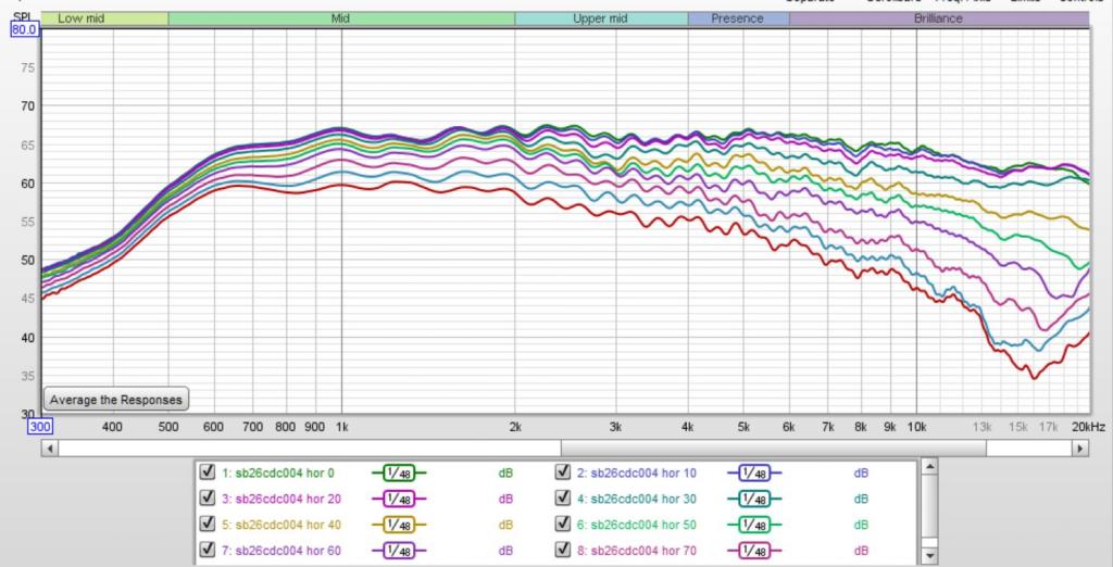

                Pic-4 is the gated far field measurement data for tweeter (gate = 4ms)
                I think now I understand what @xandresen was trying to say diffraction associated with the mid driver far field response. Around 800-1kHz, I see dips and peaks.

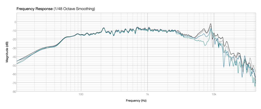

                      You might want to consider vetting your setup a bit more at first... do similar measurements with a large flat baffle (say, 4' or 5' on a side), and when you do a test box, do some evaluations with EDGE first for the size, shape, and driver mounting position.
                      I'd be careful about making attribution of the issues you're seeing in the 800-1000 Hz area before a more careful investigation. This could involved relatively near field measurements as well as measurements at several distances.
                      Consider these measurements made in a small MDF bookshelf test enclosure for the Anarchy 558, just a few polar points at 10 degree increments from 0 - 30 degrees, at 1m. Vertical edges are rounders. The expected baffle step is there, but nothing like the kind of "diffraction" dips you're seeing. Similar results with the 6.5" PuriFi.
Name:	Anarchy 558 0-30 polar.jpg

                        Thanks a lot for the suggestion.
                        I did these measurements with a dayton emm-6 mic with the baffle to mic distance = 1m and floor to driver/mic height close to 1.15m. 1.5 metres of space was clear all around the measurement area from walls/other reflecting surfaces. Ceiling height was about 1.8 metres from the mic/driver heights.
                        I also did a ground plane measurement of the mid (on-axis for mid) and superimposed it (after lowering SPL level of ground plane measurement by about 20 dB) with a 7ms gated version of the mid driver on-axis measurement. The mic used was a MiniDSP UMIK-1.
                        I have attached a pic below, in which I tried to compare between the two.
                        With the ground plane measurement, I saw similar dips and peaks around the frequencies where I see dips and peaks with the gated measurement setup, but with a higher Q. This is why I thought the dips and peaks were due to the shoddy construction of the current midrange cabinet using cardboard and Styrofoam.
                        However, as you suggested, next thing I am going to do is try to measure the drivers in a large baffle, so that I can have more confidence in the measurement setup.
                        Vineeth
