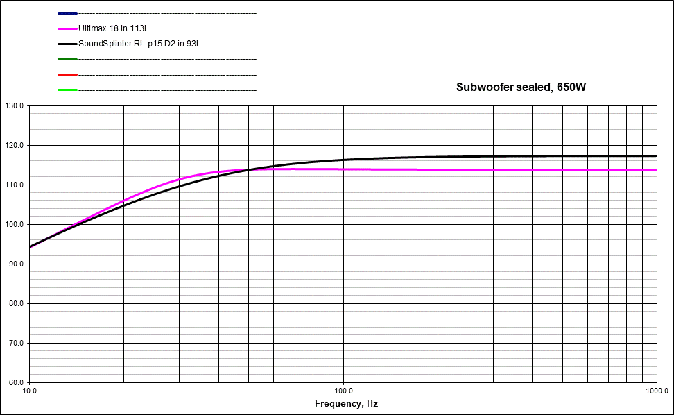

    But, when I model it, I scratching my head thinking I must be doing something wrong. This is powered by my old Behringer EP-2500, which has 650W per channel (so each sub would get its own channel).
    I expected a more gain going from a 15" to and 18"... it is about 2db between 20hz and 30hz. And this graph shows my current 15" out performing the Ultimax 18" from 50hz up.
    So, it has me wondering if this would be an upgrade at all. But, I also wonder about tech and quality. Has things changed in the last 15 years that would make a current Ultimax better than a 15-year-old Sound Splinter RL-15? Looking around on the internet, there are various opinions of both the Ultimax. I've seen lots of rave reviews, but other say it isn't musical, lacks punch, it is poor for mid-bass being defined as above 50hz.
    My Soundsplinters were designed with XBL way back when.
    And then there are the crazies that recommend cheaper drivers in big ported or horns and swear they'll have less distortion, because they aren't driven hard. I don't know what to make of that. I have a hard time believing it. I'd like to be able to evaluate it, but I don't think I'm willing to build live with that big of boxes. Sonotube is the only ported option I'll consider again.
    I'd really appreciate if someone can tell me if my model is wrong. Am I missing something? Will new Ultimax be better than my 15-year-old RL-P15? Any other good options for big subs. Mostly for movies. I cross to the Khans at 50 - 60hz .

    Looks like the Qts on the 15" is quite a bit lower than the 18". One note about Unibox, other simulators will depress the SPL curve as Qts decreases, but leave the 20Hz intercept the same. Unibox will model increased SPL at the bottom end as Qts decreases (i.e., it's just the rolloff from the "steady state" SPL). If you plug this into WinISD, you might see a bigger difference.
    Also note that anything above 80 - 100Hz for either one is illusory. You aren't going to cross either one at 350Hz, so the extra headroom on the 15" is realistically just more room for EQ (e.g., shelving filter).

          Yes. Thanks for the reminder. IIRC, when I was first building these way back, ThomasW said something along the lines of we don't care about the models, we care about how much room there is for EQ. He was an early proponent of EQ to fill in.
          The Ultimax would definitely have more room for EQ. The RL-P15 was starting to run out of excursion at 650W, but mostly below 20hz... I'm not sure how crazy I'm going to go with EQ. I need to investigate how much boost Audseyy may be giving me, if any or if it is all room gain. Unfortunately, my current receiver is too old to support the app that'd let me see it exactly. I guess I could get out the measurement gear, but I'm not sure anything I have is compatible with the current computers.... Or my time availability.

          I just can't believe the models are that close between a long-throw 15 and long-throw 18".

              You hit the nail on the head with the 'how much room for EQ' thing. That says the same thing but in a different way to - how do things look if you have unlimited power and run these into Xmax instead? Then you'll see what the Ultimax 18" will give you vs what you have now.
              If you really want something that will dig deeper/go louder without the need for EQ, or for additional power, then you're only option is to go vented, or with PRs.
              The RL-p15s, with an XBL2 motor, are going to be solid performers there isn't any real reason to replace these. Another option would be to buy some PE boxes and PRs. That will give you real gains down where it counts. What does the performance of the RL-p15 look like in ported/PR boxes?
                • 1044
                Instead of holding the box volume constant. Play with the Qts, and let the box volume float. Heavy fill and 711L will get you a Qts of 0.577 (Bessel). The way Unibox will model it, you will see a significantly higher value at 20Hz using 650W of power (~109dB). So, if you compare the drivers with the same Qts, the differences you are expecting will show up. After that, your new best friend is the Linkwitz transform. And a LOT of amplifier power, potentially, depending upon where you want to land (additional power compensates for the missing box volume -- TANSTAAFL).
                Unibox will take an LT input, but I've never done that.
                  Totally. Yesterday, I had played with the model a little to look at 650w vs 1000w. And even played some with EQ circuits. But, I didn't save the graphs and somehow I lost even my driver inputs.... But, then I'd be upgrading the amp too.... Getting expensive.
                  I'm not sure if that is what I wanted to hear or not. In some respects, it feels good to have confirmation that there haven't been any big leaps that rendered my 15-year-old drivers outdated junk. But, it's sad because it doesn't leave me with a good excuse to upgrade.
                  Ports, PR are always options. I've done it. It is fun. I'm getting old and there is something to like about the simplicity of a sealed box. ... I think our hope is after covid, we're going to try and find a contractor to move the laundry area and wall it off... Maybe I should go back to my dream of a big IB at the back of the room.... that of course would be in addition to to big subs up front.
