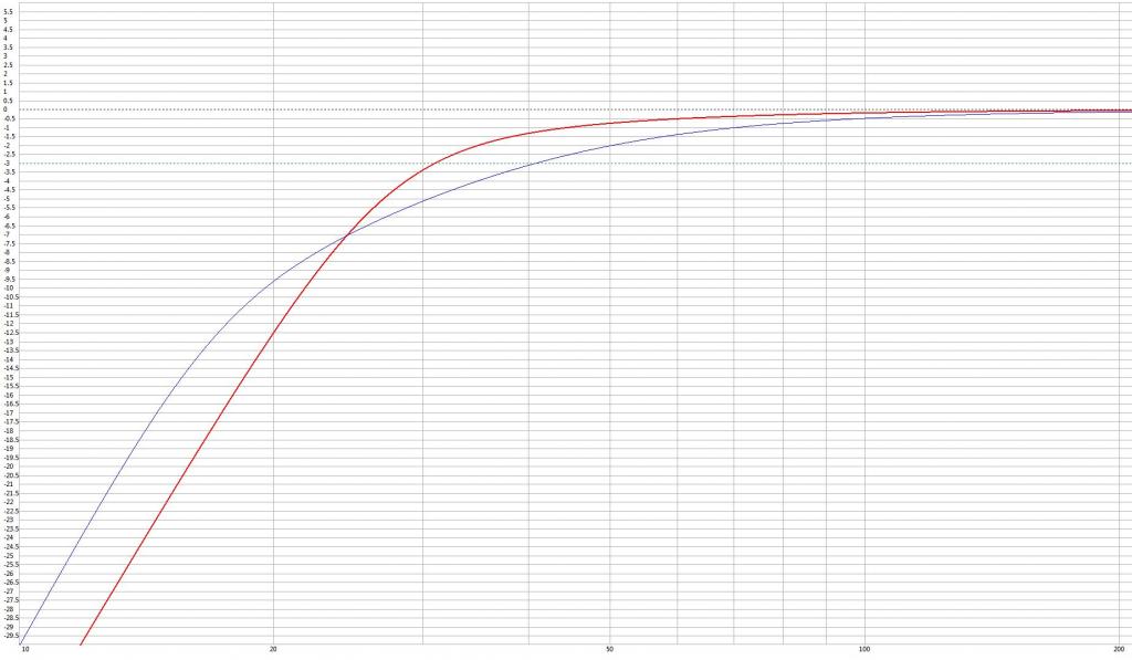

Bass!
So after experimenting with the speaker a little more, I decided I would take impedance measurements to check bass cabinet tuning.
DATs measured box tuning was 21.5hz. Utilizing WinISD, I modeled a pair of the Dayton RS225-8 (wired in parallel) in a 3.1cubic foot enclosure.
Per the directions of the Bordeaux kit, the inner tube of the 3" Precision Port tube is to be cut to 5", resulting in a total tube length of 11". The WinISD modeled exactly as DATs measured.
After confirming simulated response matches measured response, I decided to raise the tuning a bit. Given the Port flares, the shortest total length I could achieve was 6" (basically no inner tube, just the end flares). This results in a box tuning of 27.5hz. I wish I could go for a little higher turning, but then I would have to abandon one of the flares. Can't do that here because predicted port velocity is already kinda high (at max power that is - I'm sure at moderate volumes it should be an issue).
This significantly helps boost the bottom end. I think the bass is more in line with my preference now.
If I could do it all over again, I would go with a 4" Percision Port with a target box tuning of just under 30hz.
See graph below:- Bottom
Jim loves his bass, so all of the collaborated designs with Jim and myself have a slightly fuller, rich bass. Many builders have also found that the bass 'comes up' with the RS225's as the woofers break in. Give them time before you change too much...
- OTOH, feel free to experiment! That is the main advantage of DIY: The ability of modify a given design to suit your individual tastes and needs.
Remember: The room itself, the position of the speakers in the room, and the position of the listener in the room all contribute significantly to the apparent bass levels. Some experimentation with these parameters may reward the listener with a more optimal listening experience.
FWIW, I was a real bass head back in the early days. It took me quite some time to retrain my brain to hear nominally flat bass as optimal. While I still find excessive bass is more tolerable than a system lacking bass, I now perceive more bass as just more, not better.
C- Bottom

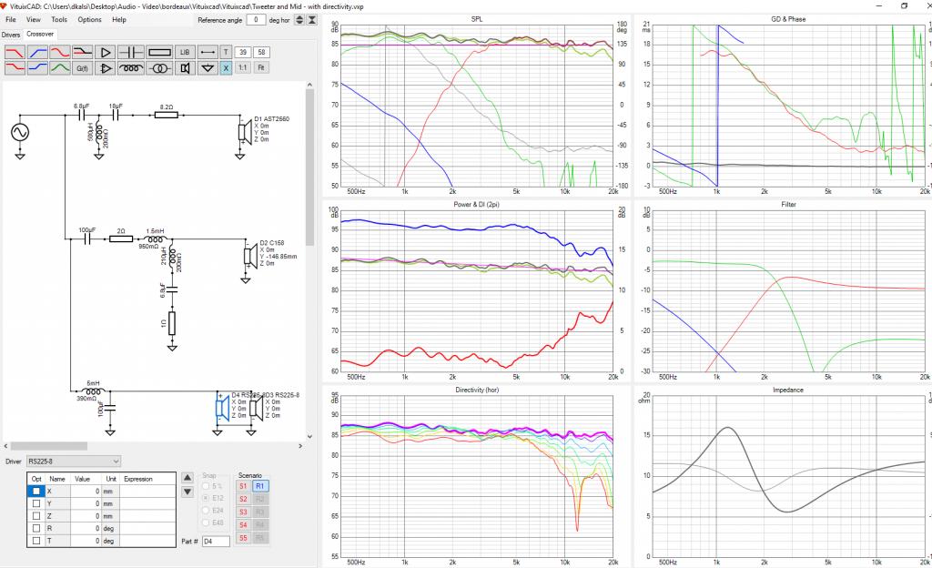

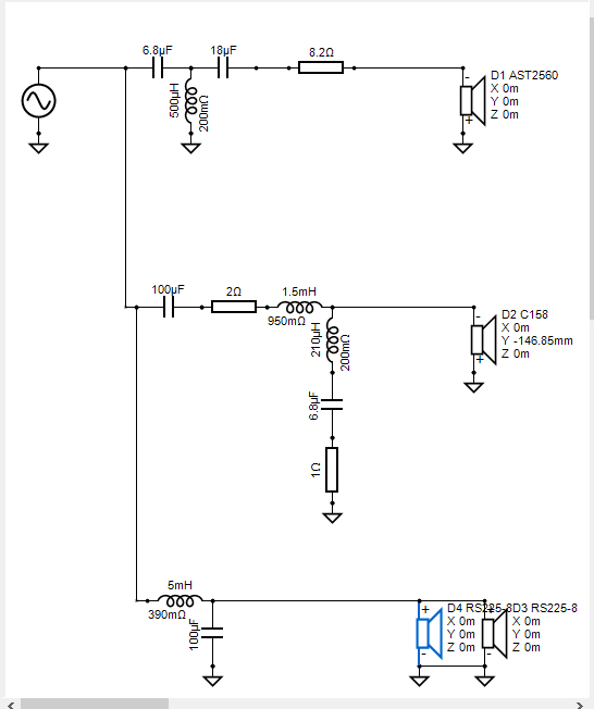

Final Crossover
After nearly 60+ hours of voicing, I finally settled on the following crossover. This was based on the best balance I could achieve for on and off axis response.
Minimum impedance (b/w the mid/tweeter) now is 5.6ohm.
The electrical phase is now within +/-30 degrees
Measured distortion is less than 0.1% at 95spl @ 1 meters
On-axis frequency response is +/-1db from 300hz to 20Khz.
There is excellent phase tracking between the mid/tweeter - resulting in a -30db reverse null measurement.
I'm super happy with the overall sound and even more happy that I didn't abandon the build.- Bottom
Very nice Efalegalo.
I hadn't had a chance to get back to finalize my crossover model, but it seems we were tending towards the same topologies. I'll double check to see if my model cooresponds with yours, but it should considering we are using the same measurement files. In the meantime...
I hereby proclaim we should call Efalegalo's crossover the one to use for new Bordeaux designs.
BTW, anyone who thinks 60+ hours of voicing is a long time... - It isn't.
Yes, its possible one can luck into the optimum crossover right out of the box, but that's only happened to me twice in all my designs.
Thank you Efalegalo for all your efforts to optimize the AST 2560 tweeter response issues in the Bordeaux design. I'm sure the forum appreciates it, and certainly Jim and I appreciate it as well.
Curt- Bottom
