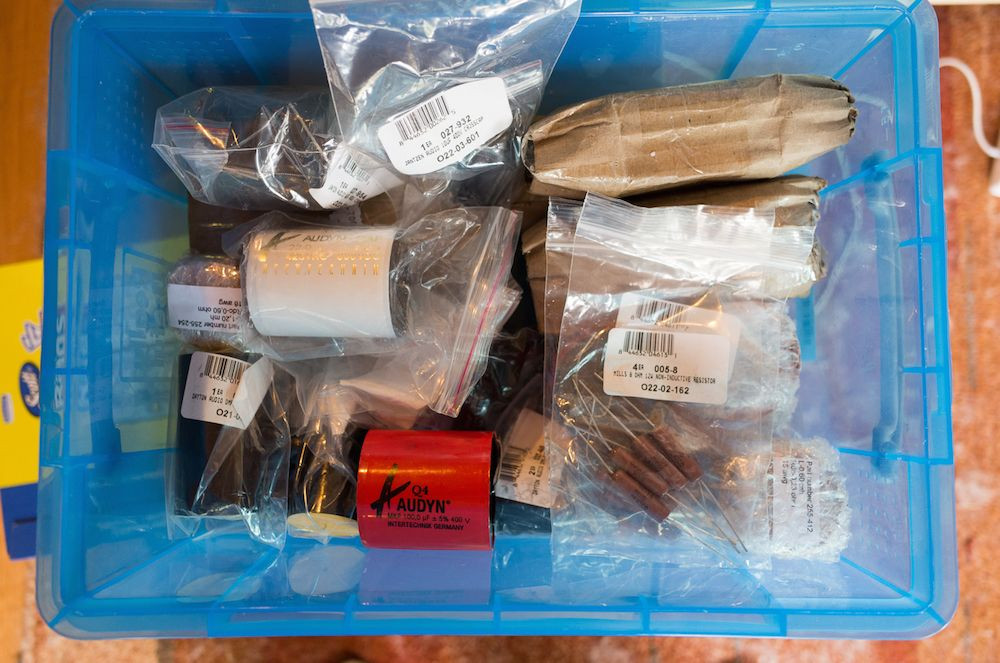

              Finally! Some days the UPS guy gets here at a pretty good time, others it's rather late- today was the latter...
              But I have a nice box of parts for building the first test crossover...

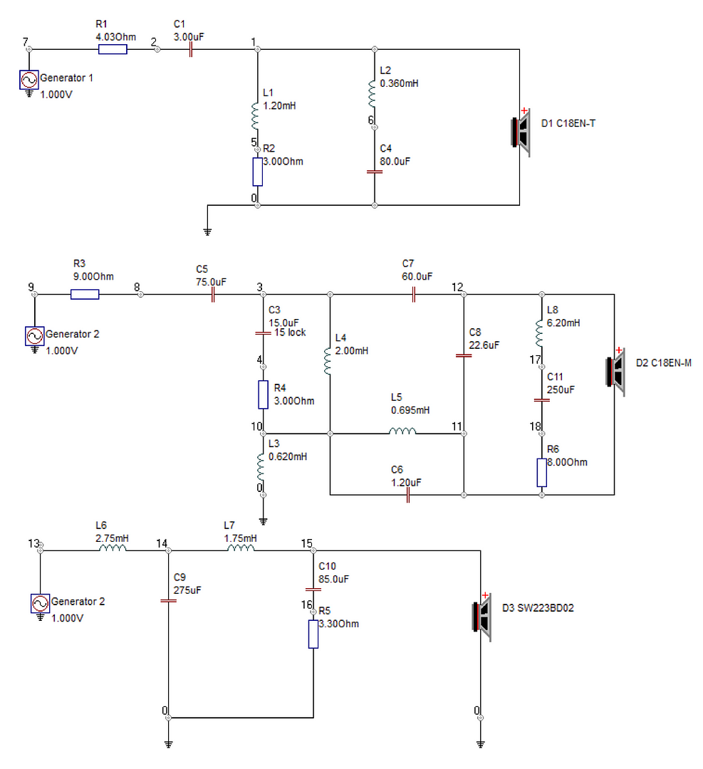

                          For anyone curious, here's how the LspCAD schematic is translating into a BOM at this time- it's also a good example of how even a mid to low spec component three way crossover always winds up being a bit pricey unless you're keeping really low order networks, in which case performance is likely to be compromised. This is especially the case when the woofer to midrange crossover is attempted at lower frequencies... in this instance, about 300 Hz. You wind up with much bigger caps and inductors all around, and no two ways about it, that costs money. In comparison, the Ardent has a midrange to woofer crossover point about an octave higher, 650 Hz. With the single woofer in this design, I wanted to try to have as much of the midrange as possible on the Seas driver, also considering that the Seas Midrange doesn't go as high before needed to really be slapped down hard.

                            Gee, you can build a very nice second amp and active crossover for that much money. And re-use the amp next go around. Active anyone?

                              Yes, but then you wouldn't have a complex wide range test loudspeaker to evaluate as a full range load, AND, some of the crossover transfer functions would be difficult to implement in an active crossover- not straight forward LR4, even, as both the mid and the woofer carry part of the baffle step compensation.
                              Closest tool I'd have that would do this is my Metric Halo LIO-8 with the DSP upgrade, but then I'd be locked into using it as the DAC. Worse things could happen, but then I have an AURALiC VEGA for this project …

                                Jon ...... not that it matters much, but I think the total for L6 in the woofer section is off?

                                  You are so right, and that is so weird, as this is supposed to be a calculated cell, applied to all the right hand column. This was a recycled version of the TA5 Ardent BOM.
                                  Oh well, only bought one batch of parts anyway this time around. I figure if I'm really lucky, I'll be able to log in to PE again next month, and just re-purchase that order...
                                  Thanks for bringing it to my attention.

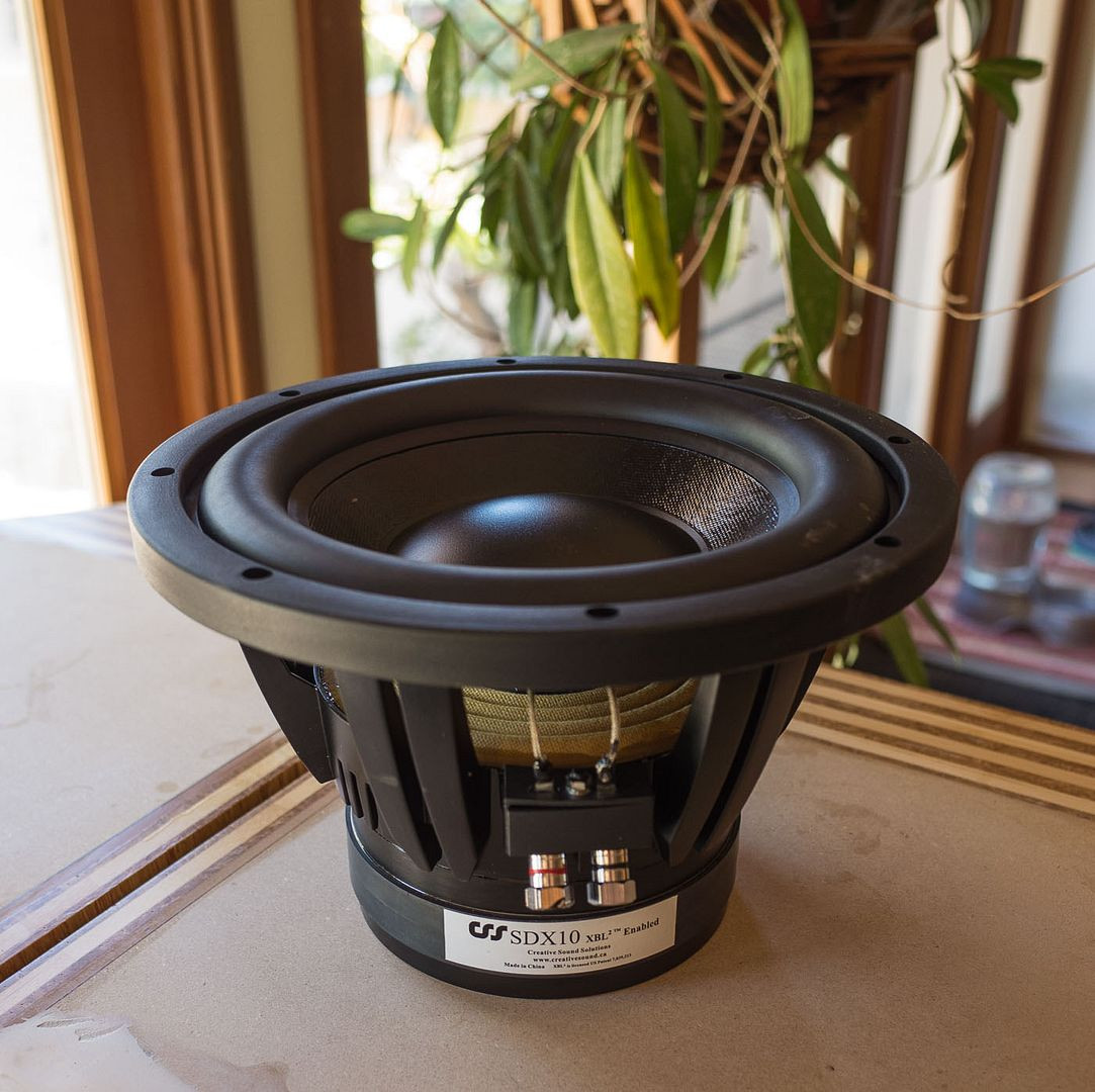

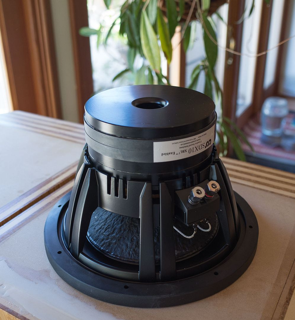

                                                          CSS SDX10 in the "flesh"
                                                          OK, got a box today with two pretty heavy drivers... not impressive packaging, but adequate- but the driver are another matter! :B
                                                          If a picture is worth a thousand words, I don't need to write anything else in this post.

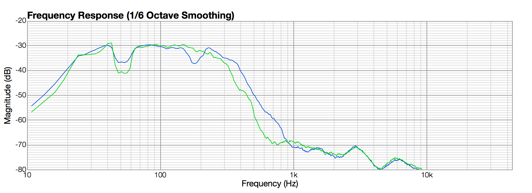

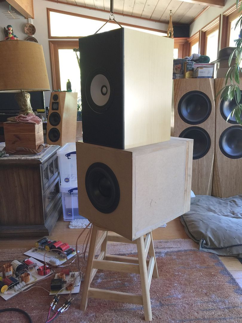

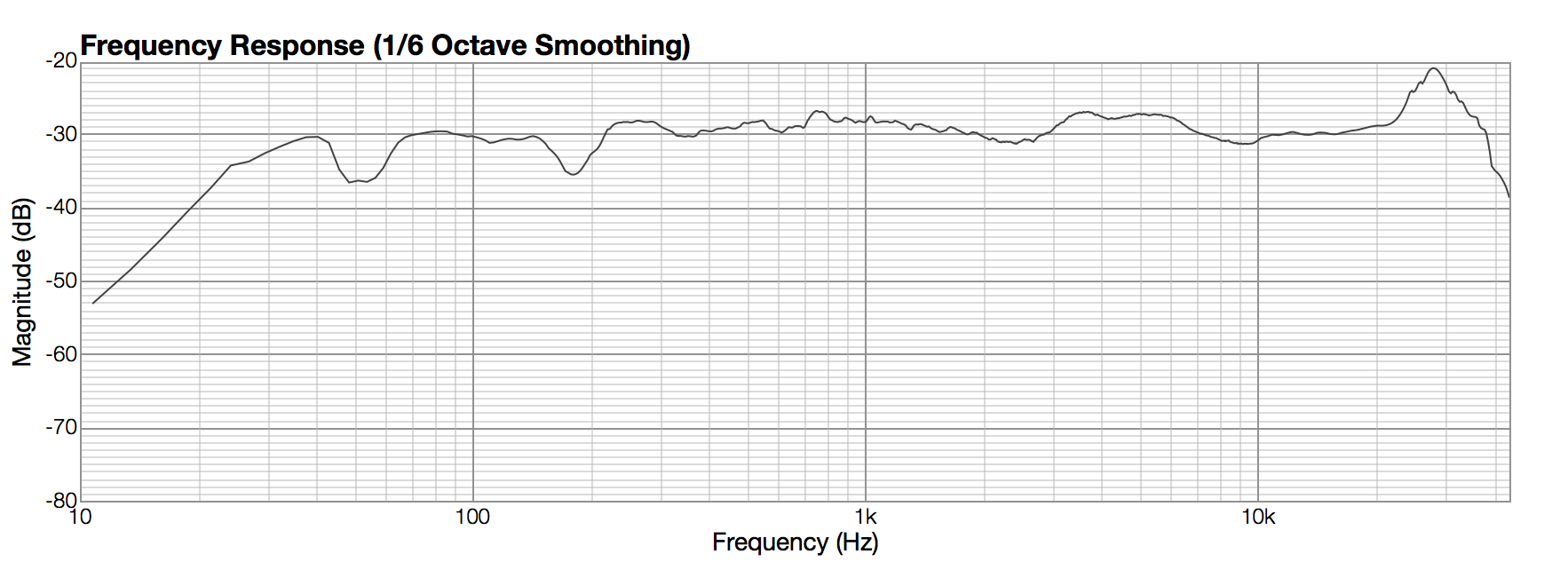

                                                                          First crossover tests on the test box configuration...
                                                                          This was the first test sweep, direct on axis, no tweaking, just putting them on the stool as a stand, and using the kind of overall position that's worked well in the past (re height of woofer, if not on the floor, such as with the Modula Extreme experiments).
                                                                          Too hot to do testing outdoors today, (94) or I would have considered that. The 50-60 Hz is a known room mode in this location I use for testing, and I expect the 175 Hz is floor bounce. Plan was to test with woofer and midrange unit in a variety of heights and relative locations. Plan was followed.

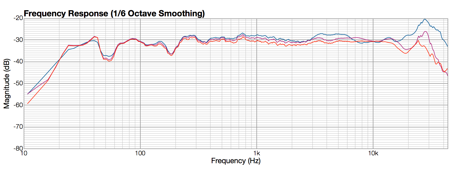

                                                                          Now, about that on axis presence bump between 2-5 kHz... do I fix the on axis, and put a dip in off axis, or just leave it like it is? This is 0-15-30 degrees.
                                                                          These do sound a bit like what I would call a monitor- basically pretty neutral, wide range in bass but nothing emphasized, and they're probably doing a good job revealing what the TC Sounds audio interface sounds like, and the NAD M22 hooked up today for testing is not the least bit forgiving or euphonizing the output. Bass guitar and percussion sounds quite good up and down the scale.
                                                                          Now I'm listening to "All or Nothing at All" from the "Daria" album... now I know I need to listen to a pair of these with a first line DAC...
                                                                          Overall, I think a pleasing voicing would drop the mid to tweeter range about 2-3 dB, and give that a bit of a listen long term with the good electronics... once I get the real enclosures and another set of crossovers built!
                                                                          Vocals sound good, really good with this setup... at least Daria's do! :B
                                                                          Last edited by theSven; 24 June 2023, 16:59 Saturday. Reason: Update image location

                                                                            the "as built" value of R3 wasn't 9 ohms, but 8.2 ohms; if I change that to 12 ohms, and change R1 from 4 ohms to 6 ohms, it looks to me that will be in the ball park for the voicing change I described above.
                                                                            I have to say I'm really enjoying listening to Daria on these right now as is... that's a good sign for the basic driver character, I think.
                                                                            Of course, one other nice thing- great vertical window! As well as horizontal. 30 degrees sounds just fine. If nothing else, I could also bring these with the crossover tweaks to the Burning Amp demo, besides the Ardent, just play one. No way I'm going to have time to build these before the event unless I took a week off after the FAE training.... hmmmm... why not? Oh yeah, the Class D SMPS project, which will be really hurting by then...

                                                                              Glad to see you get some play time in Jon ...... What's the volume on the mid cabinet? I suspect it's in here some place. I could see you doing a modified version of the TAD CR1, if you go the largish stand mount route. Going with the CSS SDX10, and 2 PRs, if you could live with the PR's on the sides, you might not have to do a floor stander. Depending on the volume requirements of the mid/tweeter, you might be able to go stand mount as well, and put the crossover in the bottom of the stand?
                                                                                • 16120
                                                                                With the SDX10 I need 2 to 3 PR's for the optimal tuning. For reasons of transport, (and reasons I have for being able to transport them, at least one set) going with the Wavecor is more compact and of course lighter.
                                                                                Still, I think I should give the SDX woofer a shot, with floor mount, but then they would really need more integration distance.
                                                                                Another possibility is a two piece cabinet approach; same top module for either design, and different LF sections.
                                                                                Midrange volume is not to critical, 24-28L helps keep The response reasonable, but note the LF conjugate network to deal with the impedance peak.
                                                                                Now, when am I going to find the time? :W
                                                                                  Well Jon you always know how to get a lot done with a small amount of time. This is what happens no doubt when you're used to working engineering deadlines!
                                                                                  It's nice to see that the floor bounce completely goes away with the boundary mounted woofer.
                                                                                  When I first tried the FST coax the vertical window was like a breath of fresh air. I do a fair amount of near field listening with mine too so it was especially noticeable. With wave guides/coax's though the optimum toe in is to actually have the loudspeakers toed in a lot. You need to have the on axis cross in front of your listening position, this is a very severe amount of toe in but it ends up giving you the widest sweetspot uniformity and also gets you listening to a decent axis off centre which is usually where coax/wg designs are at their best.
                                                                                  I think the degree to which that presence bump will need attenuating is one of those things that will become apparent from extended listening and how much baffle step/low bass emphasis/how much tilt down you build into them.
                                                                                    • 16120
                                                                                    My current intuition is that it is the overall power response I'm more concerned with, and i think with the alterations to the mid and tweeter level that are planned, I should be in the right territory-
                                                                                    Have some Mundorf resistors picked out already to order...
                                                                                    Ya gotta hear vocals on these to really appreciate the near field coherency in that range that derives from the coax. These should be pretty nice when finished, I think. :W
                                                                                    But I think I will do a two pice tower version with the SDX10, to try that development path, too. I could place the woofer at one end of the enclosure, and experiment with floor loaded and "air" loaded (different cross overs, of course). That I don't see getting to until next year. Work is scheduled to be a B*tch through next April at this point, unless one particular project is killed (it's a possibility, because it turned out my immediate boss didn't have it approved with the VP. Sort of a case of "Fire, Ready, Aim".
                                                                                    And I haven't forgotten about that tech paper, either, but with all the other things that have been loaded into the hopper, the parallel processing isn't proceeding very quickly. Sort of like giving six tasks to a two core processor...
