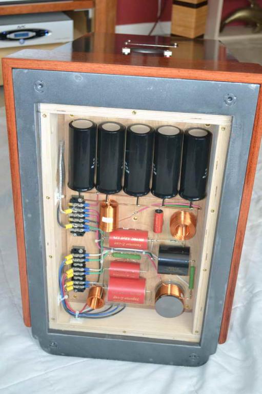

                                                                  The layout rehearsal. I'm a bit worried that the board will crack due to the weight of the big coil and the two capacitors as it is only 5mm thick...

                                                                    • 1671
                                                                    Is that 5mm ply? Usually ply can bend a fair bit before it snaps what's it like at the moment?

                                                                      Yes, it is and I cannot increase the thickness because the components are so big that an extra 5mm will prevent the lid from being attached.
                                                                      All the components weight exactly 3kg. At the moment I don't have them attached yet as I'm figuring out the best layout so I cannot pick up the board of everything collapses.
                                                                      The big coil on the left alone is responsible for half the weight (1.57Kg).

                                                                        • 1891
                                                                        I think you should be fine, how is the board getting mounted inside of the cabinet? When I built my crossovers for my Jensen's I used floor underlayment which is about the same thickness and I had no problems, especially once they were mounted. The biggest thing I worried about was what glue to use so the components would not come loose since they hang upside down. Here are a couple of pictures of mine ......

                                                                        • kimmosto
                                                                          • 589
                                                                          Why? They have 400...500 g coils of 6 mH.
                                                                            • 1670
                                                                            [ATTACH=CONFIG]25081[/ATTACH]
                                                                            [ATTACH=CONFIG]25082[/ATTACH]
                                                                            Holy shit Steve...
                                                                            That's one heck of a crossover, I'm official impressed. And a little bit concerned for you - that level of perfection can't be healthy ;-)
                                                                                  Very nice indeed! :T
                                                                                  I was double measuring again and I'm clear to use a 10mm board if I decide to. By the way, as my components are also going to be upside down I'm facing the same problem. I intend to attach the big capacitors and all the coils with plastic braces but for the others I will have to use glue. What glue did you use?

                                                                                    • 1891
                                                                                    Originally posted by TEK
                                                                                    Holy shit Steve...
                                                                                    Thanks TEK ...... Me to TEk .... me to, I'm certainly my own worst enemy and critic that's for sure.
                                                                                    • cochinada
                                                                                      • May 2014
                                                                                      • 658
                                                                                      Well, mainly because it was the only one they had on the store and I didn't want to use a very low AWG because of power dissipation issues, but you are right; I could have gone with a lighter model like 000-1499 for instance if it was available, that is.

                                                                                          • 5204
                                                                                          A hot glue gun works well. That's what I've always used. It has more than enough strength to hold things in place, but can be easily removed later for rework, if desired. I've read other use a silicone. Just don't bury the resistors in glue.
                                                                                          BUT, I wouldn't solder or glue until you've listened to them for a week or two or three and are satisfied. Wires just twisted together can be good enough connection if you're not moving around and abusing. I seem to remember CJD not having solder one of his speakers when he demoed them at Iowa.
                                                                                          • cochinada
                                                                                            • May 2014
                                                                                            • 658
                                                                                            Hmmmm I've already used it before I'm not a particular fan of hot glue for a couple of reasons. Namely you have to be incredible quick before it cools down and there is practically no chance to make small readjustments when positioning the components. Secondly the glue is so hot that not only it is dangerous to work with but you risk damaging your components like I did in the pass when I applied it directly to some ceramic resistors and the terminals became loose. To prevent this the best is to apply it to the board and not to the component but this makes it even more difficult to be precise in the positioning.
                                                                                            All this being said I would rather much prefer to use some kind of glue that not only sticks really, really, REALLY well to plywood and plastic but also allows some readjustments before it completely dries.
                                                                                            So, is there any one that fulfils these requirements AND is also capable of holding a coil with 1,5 kg or plus upside down? Plain silicone? I always associate silicone with bathrooms and kitchen...
