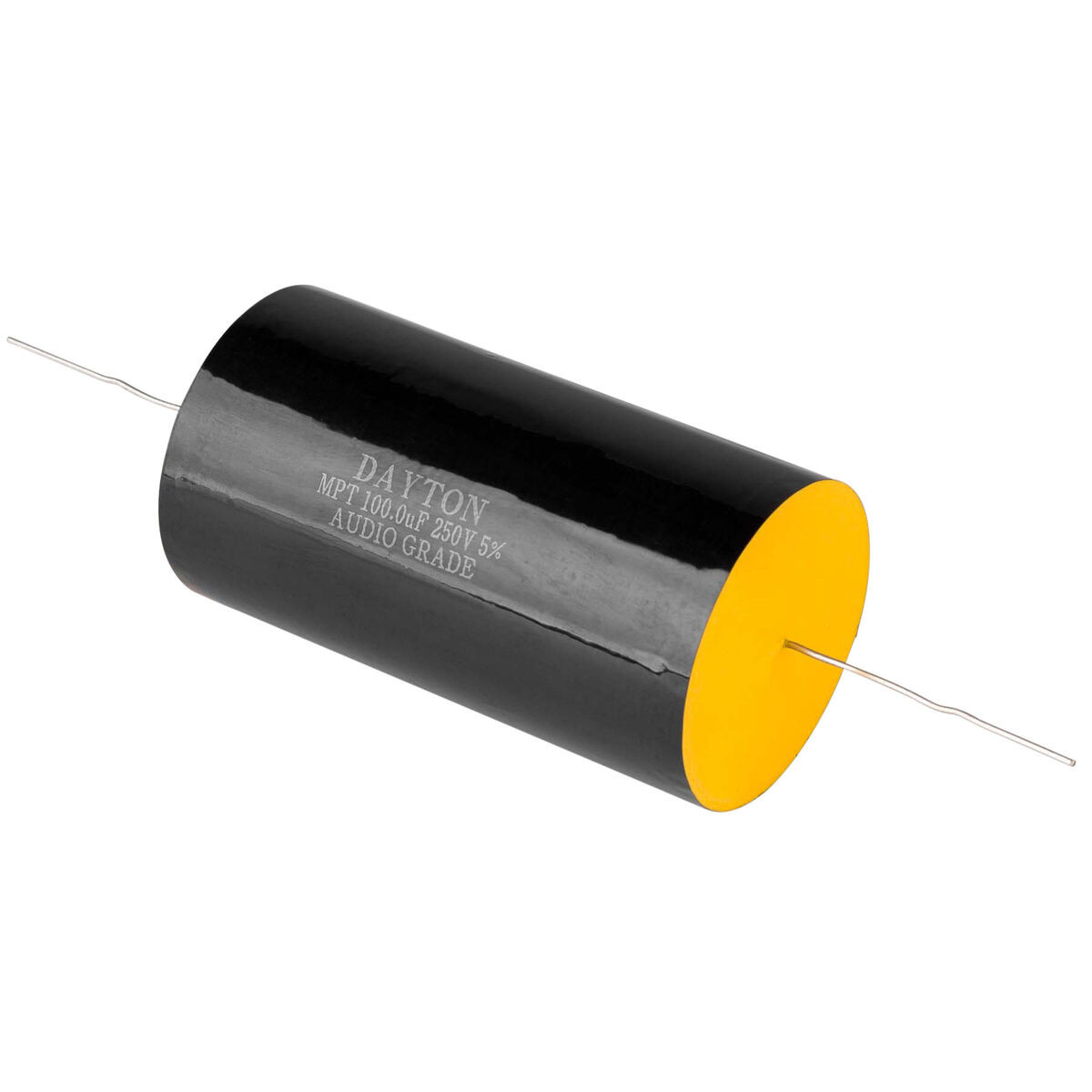

                                        What brand/model are you contemplating for the Flux Capacitors?
                                        Paul
                                          • 16088
                                          Dayton 100 uF MPP (it's what's in the junk box! - this is a "junk box crossover" due to lack of time and some budgetary constraints). Had more than a few of these on hands, due to past projects. For example, each 26W/12867 will get 4 x 100 uF in series.

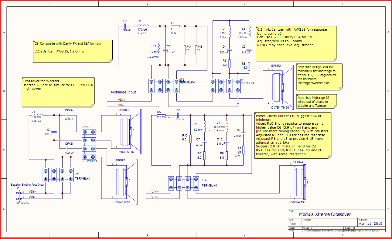

                                                Getting closer to the final crossover
                                                For those curious....
                                                This is still the "junk box" crossover, and final component recommendations may change as I tune it up after the Northern CA DIY. Just have to see how that goes. Probably will upgrade the tweeter cap, for example, possibly the midrange caps.
                                                It always seems so straight forward in the concept phase, but getting all the work done in a rather finite amount of time makes it more like a job than a hobby!
                                                Last edited by theSven; 02 August 2023, 07:51 Wednesday. Reason: Update image location

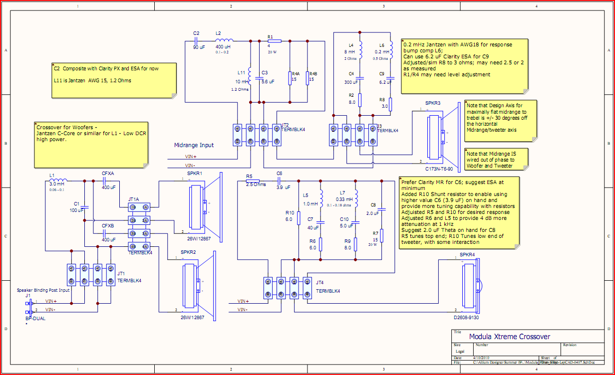

                                                    Evolution continues
                                                    May be ready to button it up, soon.

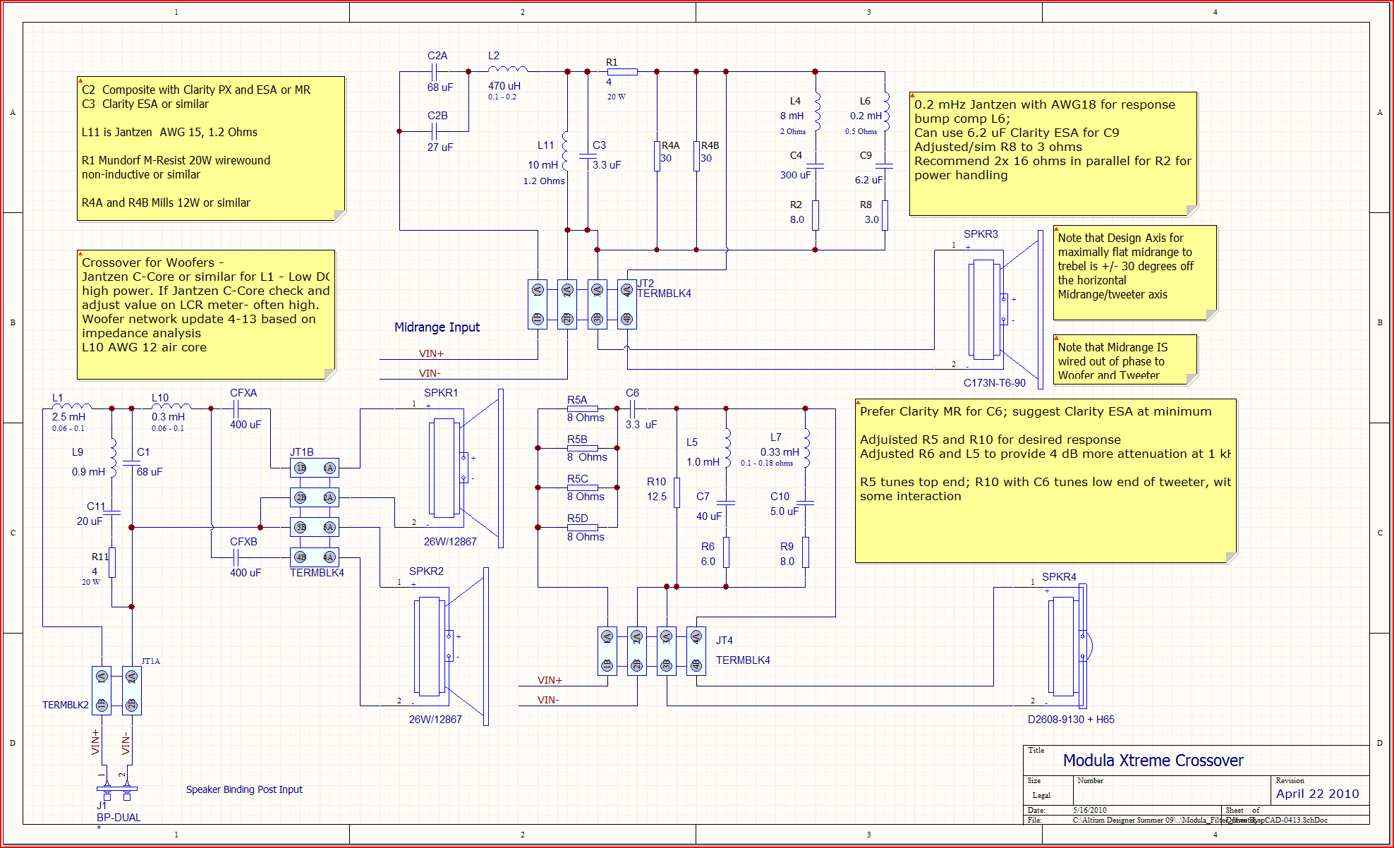

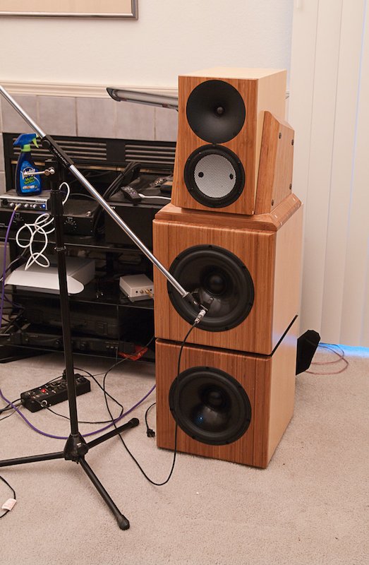

                                                          Speaking of the Modula Xtremes...
                                                          Not forgotten, just not posted.
                                                          They've been done for a while (late April, natch) except for swapping out some higher grade caps in the next month or so if things go as planned. No time to work on the documentation, but here's a teaser. I'm pretty dang happy with them- relatively compact, great midrange (I may have owned the T6-C90 longer than Jed, but he's been working and listening to them longer- this is a great midrange driver!), and lots of dynamic detail all up and down the range, due to the low driver distortion (those W26 are super once you get them tamed!) Nice clean bottom end to a bit below 40 Hz, high 30's. They will play loud for the size... think of them as miniature Wilson's. The flux capacitors seem to work nicely- no hint of boom or hangover.

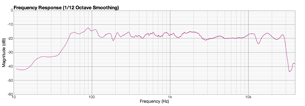

                                                          The network has evolved a bit, I've got a piece of paper with all kinds of scribbling to prove it, but no computer docs yet.. :W ...soon

                                                            Holy smokes, those look awesome. Looking forward to a distortion plot.
                                                            Oh, and nice to see you alive. <3
                                                            -Josh
                                                            • Jed
                                                              • 3621
                                                              They've been done for a while (late April, natch) except for swapping out some higher grade caps in the next month or so if things go as planned. No time to work on the documentation, but here's a teaser. I'm pretty dang happy with them- relatively compact, great midrange (I may have owned the T6-C90 longer than Jed, but he's been working and listening to them longer- this is a great midrange driver!), and lots of dynamic detail all up and down the range, due to the low driver distortion ........
                                                              Sweet build Jon!!! I concur on the Accuton Mid.... probably the best in the world. It is the only mid that I've heard that creates a holographic soundstage outside the speaker limits in space. That makes sense to those who have heard it.

                                                                        Those things look gorgeous. I'm definitely going to use the LBL technique on my next set of speakers, I LOVE the bamboo look.
                                                                        Well done. Can't wait to see the Modula XE SO's
                                                                        What's the target crossover point for the woofers and the mid? Are both woofers receiving the same signal or is the bottom one adjusted to account for it's proximity to the floor?
                                                                        Nathan
                                                                          • 16088
                                                                          Nathan
                                                                          This is a Duelund based three way with a center frequency of 900 Hz and aleph of 3.3. This defines the target function, which was met pretty well in practice. Translated into more conventional palaver, that's a lower crossover point of about 300 Hz and an upper of 2700 Hz.
                                                                          Yes, the woofers have different loading due to differences in the boundary effects, but after considering a few options (and because of the relatively low crossover point) I went with a common filter. It's kind of like the new VFR1200F; yes, the front cylinders have longer exhausts (deliberately according to Honda) and those cylinders supply more torque down low- have something similar between the upper and lower woofers, but one thing to keep in mind is that with the crossover point and midrange operation, in the 150-450 Hz area you have a pretty tall source, which helps smoothing out floor bounce effects in that range. Having two woofers, IMO, is a definite advantage; otherwise you really need to pay attention to driver location in an Allison like sense, and might even need to move the crossover point up a little higher.
                                                                          I plan to put a test article together for the SO version pretty quickly, with a simpler mechanical assembly; to save time getting it together, and to present a simpler alternative to the more "massive" construction I did here. Got to order another tweeter and a couple more woofer cabinets, should be doing that the end of the month when I'm done with some biz travel coming up. I'm pretty curious to see how the SO Vifa "full range" 7 driver does. Finessing the crossover will be a little more tricky due to the driver impedance, but I'm hoping it will work out. Otherwise you'll need to have some Aragons like I have to drive them!

                                                                                In my bid to chip away at posting info now and then when I have a little free time before crashing, here's the final (I know, never say never, never say final) crossover schematic for the Modula Xtreme; I expect the SO version will be equally complex, so don't say I didn't warn you! :E
                                                                                This is higher resolution than I would usually do for a post, but it will print decently.
                                                                                The woofer crossover goes in the lower woofer enclosure, the midrange and tweeter in the upper. I've got all kinds of pictures, and will start working on a PDF soon, I hope.
                                                                                NOTE: This version is obsolete as of the end of May, a modified Tweeter crossover has been implemented which appears to be a keeper. More attenuation in the low range of the tweeter, and flatter response in the upper range.

                                                                                  This shows a nearfield plot of the midrange mid way through crossover updates; it highlights the response needed BEFORE the effect of baffle step below 1 kHz. With baffle step, the response at 200 Hz is about 6 dB lower farfield, as you'd expect.
                                                                                  Considering everything with the range the mid must cover (about 100 Hz to 6 kHz) I wouldn't change the rear volume based on my experience with this. I'd probably rather have a different shape enclosure, and get rid of the diffraction bump on axis at 2 kHz, but this is a Modula with prebuilt cabinets (well, sort of!), so that's one limitation. No way I'd have had the time to build a pair of Isis clones in the same time frame I did these!
