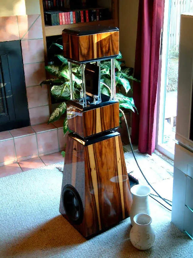

      I think we may have a winner on looks from one of these.
      Both of those are gorgeous. I am partial to the second. Just watch how the grains will raise differently on the different species. I foresee lots of sanding in your future. Can't wait to see pics. :T
      BTW; I like your logo. Maybe an aluminum or stainless plate with the characters Waterjet cut out of the center on you can see the wood grain behind. Just an idea.

        If I do sloped, then I have the option to do one continous baffle, with no need for rear bracing of the open baffle mid panel.
        You might want to wait on that until you build it. My last speakers had a single panel for the baffle which included the front of the sealed woofer cabinet and the upper OB portion. The upper panel vibrated quite a bit from the woofer. I never did anything about it, but I'd suspect you wouldn't be happy with that.

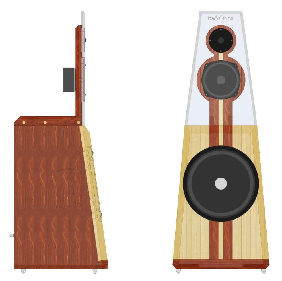

                                In order to have the thin center piece, I had to shift the lamintes from my original design, which had a laminate edge cetered. This makes the whole center section a 3/4" narrowe or 1-1/2" wider. I chose 3/4" narrower. Then I added the name and/or logo on the polycarbonate. Hopefully, this can be done with a template, as CJD suggested. I'll have to check on the cost for a template, of course.
                                What do you guys think?

                                  How does it looks with dln on top (like your first picture) and BaSSlines on the bottom, below the woofer?
                                  I like dln on top better than BaSSlines on top.
                                    • 1456
                                    #242
                                    I can do that, give me a minute!

                                      • 1456
                                      #243
                                      Something like this?

                                        That looks pretty good to me. I'd visualized the lower text in black, on the front baffle above the base... basically, where you had your logo in the earlier pictures. Black text might look nice under the black woofer. But your version looks more understated, which I also like.
                                        Disclaimer - I am known to have very little eye for design
                                          #245
                                          I liked the black logo at the bottom better.

                                                                      I made some small changes to the design and have started cutting mdf. I have cut the raw pieces for the mdf bass bins, but have to cut some rabit joints and all of the slots for the ribbed box construction. I will try to take lots of photo's to document the construction as I go along. For initial testing, I'm making the bass bin baffle and the open baffle section out of mdf. This is because I want to test the concept of rear mounting all the drivers, inset 1/2" with a 1/2" roundover.
                                                                      For the tweeter, this will function as a shallow 1/2" waveguide. I followed Zaph's concept for this, proposed for an easy way to mount the Vifa D2NC55, on my Duo project and it worked exactly as he predicted, providing a 3db or so boost centered about 3khz. When equalized in the crossover, it has the potential to drop distortion levels even further and allow it to play at a higher spl without strain at the low end. It also, sets the tweeter VC back another 1/2", getting it in closer alignment with the woofer and midrange. I will test this with the Peerless HDS tweeter. If it tests out well, then I can mount the tweeter behind the Lexan baffle face, cut the appropriate diameter hole and do a roundover on the Lexan. Of course, I will have to test that on the Lexan first as well. :E
                                                                      For the mid it will not really provide any real benefit. If it was a wood baffle, the rear mount would allow you to avoid having to router that odd shaped hole, but for the Lexan, you will still see the whole flange, so there is little advantage. Alternatively, if I want to mount the mid flush, it will take more work to extend the mid 1/2" forward to make it flush with the Lexan. In that sense, a rear mount, 1/2" deep, with 1/2" roundover may still be easier to accoplish. Of course, I will not do this mount if it has a detrimental effect on the FR of the any of these drivers in the passband.
                                                                      For the TD12H, I like the idea of rear mounting because it visually plays down the mass of the driver, which is very dominant in this design. It will mean, however, that I have to make the front baffle removable, which is not a big deal and typical of most of my designs. I like to have full access to the inside of my box in case I decide to make changes in the future, like re-using the box for a different design with a different driver and baffle configuration. To rear mount the woofer also means it has to be lowered about 4", so it will fit into the box when mounted from behind and under the chamfers on the edges. This probably has the benefit of a bit more boundary reinforcement from the floor, but it separates the mid and woofer a bit more as a trade off. The temporary MDF baffle will allow me to test this configuration before I have to cut holes in the laminated version, which I obviously want to get right the first time! Below is what it would look like with a rear mounted woofer, sitting 4" lower. You can see the actual size of the woofer frame under the baffle in this drawing.
                                                                      I also have to come up with a good way to attach the Lexan to the laminated wood support behind it. I may have to drill a few holes through the Lexan and countersink for some flat head screws, but I kind of hate to do that. If the drivers are mounted behind the Lexan, I have to keep it removable, in case a driver ever had to be replaced. Speaking of Lexan, I found a source that I can get a 1/2" x 24" x 24" sheet for $75 shipped. It should be here in the next couple days. I can't make any mistakes, however, since I need to get two tapered 11.875"-7" wide by 18.75" baffles out of it. It should leave a small amount for testing roundovers, logo etching, etc.
                                                                      Any thoughts?

                                                                        Hi Dan,
                                                                        As far as the Lexan goes, I thought would do it, exactly like your picture suggests. Couterbore the Lexan for the driver flanges and use the driver screws to sandwich the lexan to the backer.
                                                                        -David
