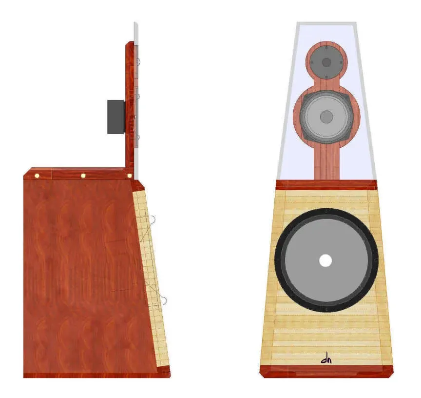

                    Well, I'm finally ready to start on this project more seriously. I have made a few changes to the design (see mock-up below). I'm thinking of doing the baffles out of solid hardwood, 1.5" thick. The idea is to laminate them from 1"x2" hardwood stock laid flat and stacked. I will mix a second hardwood as shown stricktly for aesthetics. I like the stacked laminated look and can easily cut the chamfers and in that orientation, I don't think splitting will be an issue. The woofer baffle would be mechanically attached to the box, not be glued to it.
                    I'm also considering mounting the midrange and tweeter from the back, leaving maybe 1/2" wood between the driver and the baffle face. I would use a 1/2" round-over on the edge. This would certainly make the mounting of the odd shaped midrange driver easier. The tweeter would look like the one in my Duo project, which has a 1/2" deep waveguide. I like the simple clean lines that this kind of mounting offers. Of course, I would have to do some testing to see just what effect this will have on the drivers frequency response before making a decision to do this kind of thing with either of the drivers. If there was a significant detrimental effect, I would abandon the idea.
                    More will be coming as I get further into it.

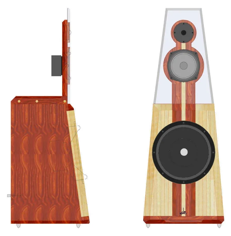

                            Here's a little update:
                            I'm going to try a different kind of box bracing scheme on the bass bins (see attached pdf). It involves dadoing 1/4" wide x 1/4" deep slots and installing 1/4" wide x 1.5" deep red oak or perhaps baltic birch ribs along the sides, top and part of the front of the box (on each side of the driver). These ribs are oriented by starting with a rib in the center, since that is where the bracing is most needed, and then placing the others in a golden mean ratio from the middle rib and/or the corners. Two 1"x2" hardwood cross braces will be used to tie the sides and front and back together. The ribs will offer additional gluing surface for the cross braces. My hope is that it will be at least, if not more effective than typical window bracing, but perhaps lighter and burn up a little less volume.
                            After seeing Zaph's test of the three Pro mid drivers, I've decided to go ahead with the B&C 6md38, as planned. Now I just have to get my hands on some. Ther are on backorder at PE.
                            Also, since two of my goals with this design is to reduce the mass of the speaker in room and, as always, a high WAF, I'm considering using arylic or glass for part of the open baffle section. I have found 1/2"x24"x24" acrylic online for $38.50, 3/4" for $68. One sheet of 24"x24" will do two baffles. I'm thinking of ordering a couple sheets to try. Exactly how it will be designed will depend on how easy the acrylic is to work with. Glass is also a possiblility, which I will explore with local glass shops. Below is a mock up of what it might look like.

                              Lookin' really sweet Dan. You're an artist!
                                #195
                                The ribs are an interesting idea, but in the end I think it's more effective to use multiple 'window' or 'ladder' style braces to lock all surfaces of the box together.

                                  Hi Dan
                                  I really like to looks of the clear panel. You may want to consider polycarbonate. (Lexan)
                                  As acrylic is very brittle and prone to chipping, cracking and scratching, Lexan is far more durable and free machining, although that comes with a higher price tag.
                                  -David

                                    • 1456
                                    #197
                                    Hi Thomas,
                                    You may very well be correct, but let me explain a bit further how the side are tied together. I left this out in my initial explanation.
                                    There will be two cross braces made from 1"x2" red oak from side to side and front to back and one from the top to one of the cross braces. The sid to side cross braces and front to back cross braces will be resting on one another, so they can be glued or bolted together. Another option is to put a small dado in them so the overlap and mechanically lock them together in the center, using glue to secure them. This will ensure that the cross braces are supported in the center so they cannot flex or vibrate and it ties all 4 sides together.
                                    FWIW, I did a comparison between this and the original window bracing scheme I had, which had 3 horizontal window braces of 3/4" stock with the panes of 1 1/4" wide. It had a brace volume of about 193 in3. The ribbed box has a brace volume of 161 in3. There is about a 0.5 liters brace volume reduction in the ribbed box, or about a 17% less, so not a tremendous savings in volume. If only one cross brace was used between the sides and front and back and top, that would drop the ribbed total to about 131 in3, for a 0.85 liter reduction or about 32% less than the window brace option.

                                          #200
                                          I'll third lexan over acrylic, though understand that it is very prone to scratching.
                                          I'd actually recommend tempered glass.

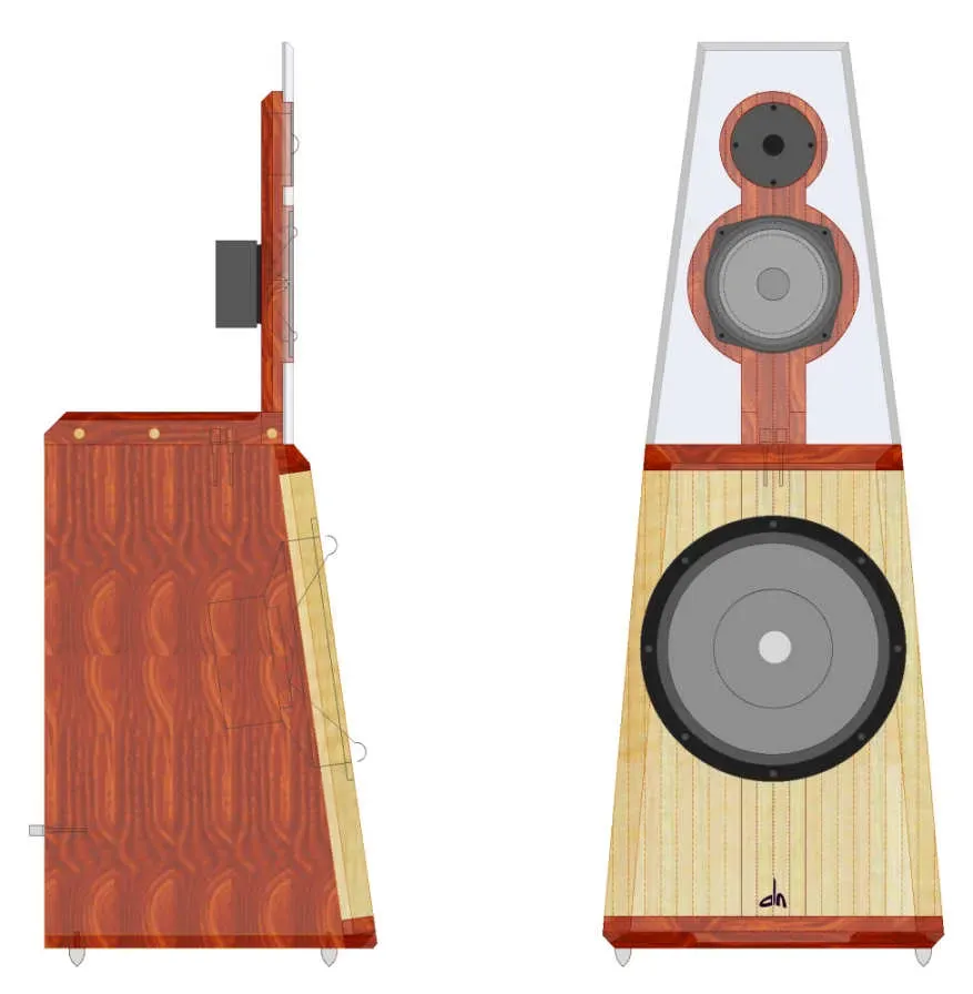

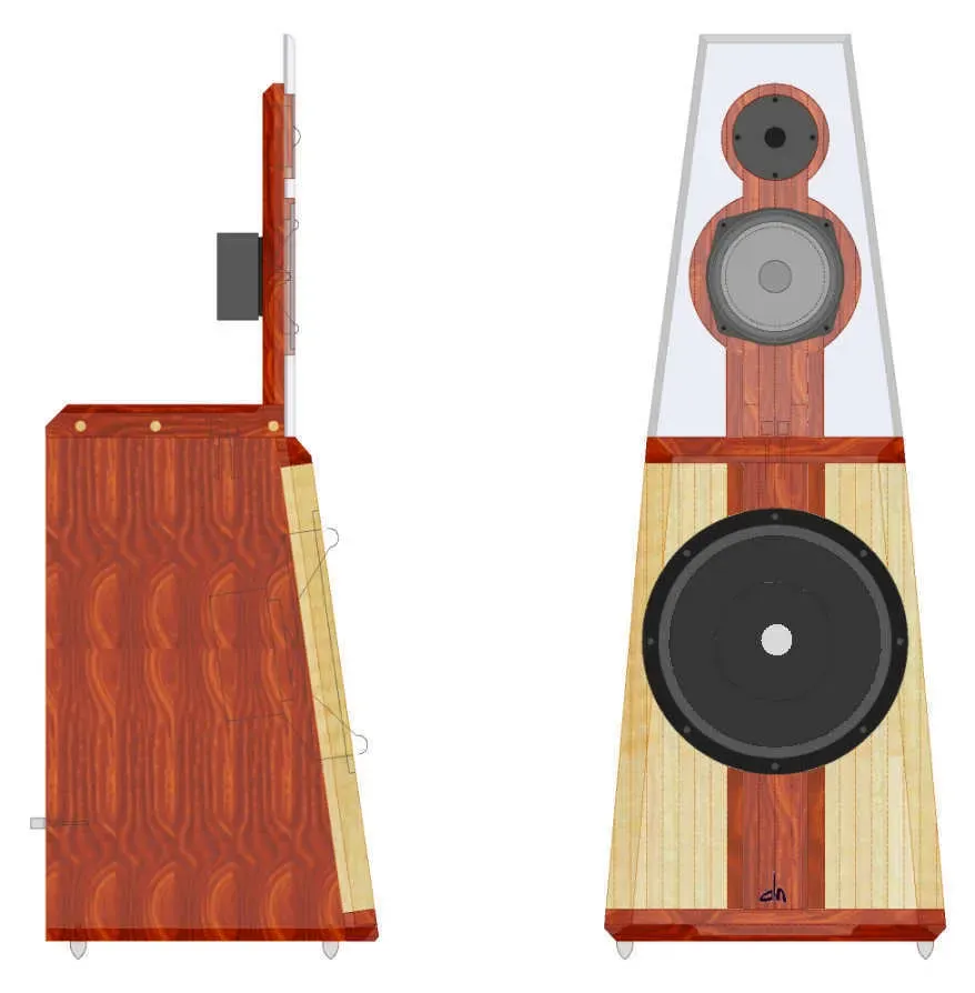

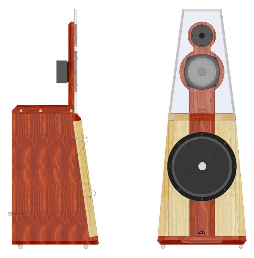

                                                                                  Opinions Please
                                                                                  Hi all,
                                                                                  Based on feedback, I have put together a couple other options for how these will look. What do you all like the best? :rollhead:
                                                                                  Original:
                                                                                  Click image for larger version  Name:	BaSSlines-v3-glass-c3-small.webp Views:	0 Size:	25.8 KB ID:	941075
                                                                                  Vertical laminations on bass bin:
                                                                                  Vertical lamination's and center accent:
                                                                                  Dan N.

                                                                                    • 161
                                                                                    #221
                                                                                    I like your first option the most. All three look beautiful!
                                                                                      #222
                                                                                      Second. I like the way the vertical lamination flows into the top piece.
                                                                                      I'm not an engineer and not an artist. But, I would probably experiment with the round wood ovals for the mid and tweeter. I think the round shape doesn't jive with the triangle shape of the enclosure. Don't listen to me, I'm always proved wrong by artists and I try to let them do what they do best and stick to what I do best.
                                                                                        #223
                                                                                        Curious: why have the top baffle vertical, and not continue the slant?
                                                                                            What happens if you add a third center stripe to the last option that goes all the way up?
                                                                                            I may continue the slant. I want to test the drivers in a test baffle that approximates this one (out of mdf) at which time I will test flat and sloped to match the bass bin. If I sontinue to slope, the vc's come very close to being time aligned, especially if I mount the tweeter in a 1/2" deep waveguide. If I do sloped, then I have the option to do one continous baffle, with no need for rear bracing of the open baffle mid panel.
                                                                                            I think we may have a winner on looks from one of these.
