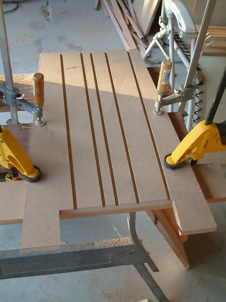

    More Photos:

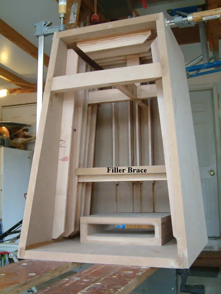

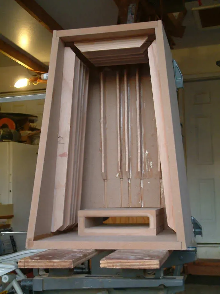

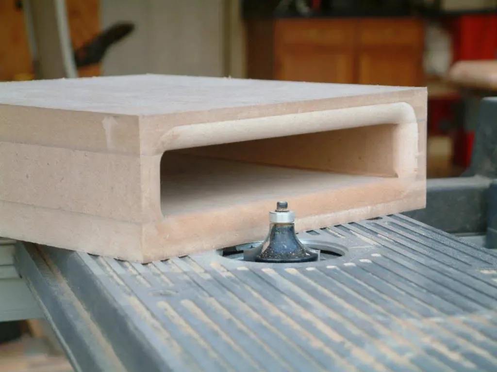

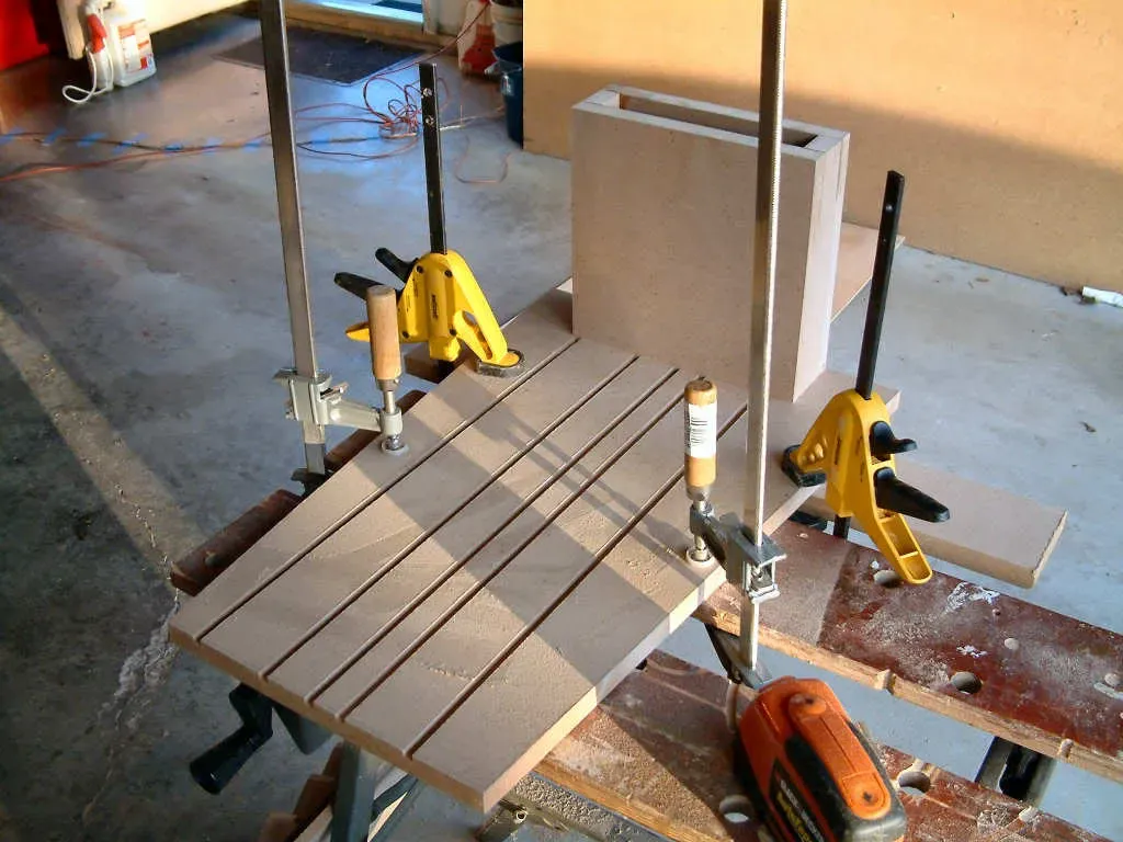

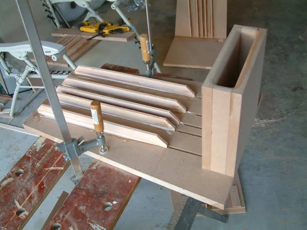

      And three more (the slot port remains removable). Next up is to glue it all together and add the cross-braces and then work on the removable woofer baffle:
      Dan N.
      • Paul Ebert
        • 434
        #273

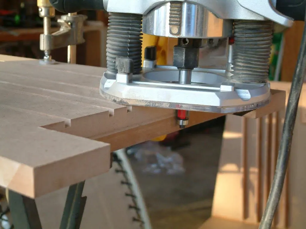

        So, the dadoed slats are for reducing panel resonance?
          • 1456
          #274
          Yes, that's the concept. Reduce panel resonance, while using up less volume for the bracing as compared to standard window bracing. I actually compared the volume of my original window bracing plan to the ribbed construction plan and the ribbed had about 17% less volume for bracing.
          There was a thread on that over at the PE forume here:
          Ribbed box construction
          Dan N.
            • 1456
            #275

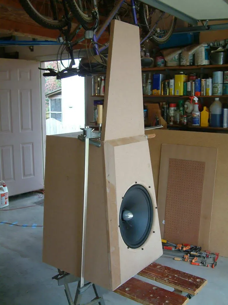

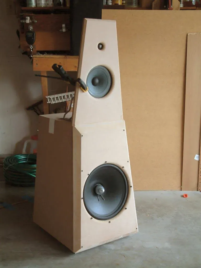

            Here are some more construction pics. FYI, the baffles are test baffles. The finished ones will be laminated hardwood and Lexan as planned. The box has been glued up (except the top). The slot port will remain removable for two reasons. First, so it can be adjusted if need be, based on testing and listening impressions. Also, it will either be painted (the box will be veneered with Bubinga) or it may be replaced with a hardwood slot port. The woofer baffle will be removable. Here you can see the cross bracing implemented, including a "filler brace". This brace will be glued to front of the cross brace and have speaker gasket material on its face. It will physically connect to the back of the woofer. This will essentially connect the woofer to all four sides, to distribute vibrations and reduce motor movement. I have to add the small dowel, top to bottom, through the port, add front face cross braces that will be used for mounting threaded inserts for the baffle removal and pack the space between the ribs with insulation.
            When the top and baffle are clamped on, the box does indeed sound quite dead, from a knuckle rap perspective. I have no other way to test it. Of course it will be even better when the top is glued on, the filler brace fully implemented and the final version of the port glued in.
            You can see the woofer mounted from the back, 1/2" inset, with 1/2" roundover. I want to cut a steeper chamfer on the top of the woofer baffle, probably 30º or less.

                  I really like the dadoed slat idea. I think I'll do the same for my Trilliums. It appears that you ended up going with oak, correct? I'll use oak as well, since it isn't undersized like plywood. I don't have a dado blade, so I'll have to use my router and router table.
                  Thanks for the idea!
                    • 1456
                    #279
                    Yes, they are red oak. First I ripped several pieces and decided it would be simpler to buy 1/4" stock, which my local Menards carries. I bought 1/4"x8" stock and ripped them to 1-1/2" wide slats, then set in 1/4"wide by 1/4" deep dadoes.
                    I described how I located the slats in the posts below, though I ended up with the 1/4" red oak in the end, all the same depth.
                    One other interesting thing is that the ribs give a lot of extra surface to glue cross-bracing to, instead of just the end of he brace, if you get what I mean. Only glue was used, no screws.

                      I’ve got a prototype of my BaSSlines together, for testing purposes, though I don’t yet have my midrange drivers yet, since they are on backorder until October 10th. Instead I popped in some used Audax Pro mids into the open baffle.
                      I started with Jeff’s original crossover for his Salk speaker and just made some adjustments by ear and also knowing that the tweeter would have a boost at the low end due to the 1/2" deep waveguide mount. Based on my raw listening impressions, I'll say is I think these could be very, very good. The TD12H is one clean woofer. I think the Peerless HDS tweeter in the ½” waveguide is going to work out very well also, based on this test.
                      Here are a couple of photos of what I’m listening to as I build the second box and wait for the mids to get into stock. I should be starting on some measurements soon on the TD12H and the HDS. I have the Lexan for the open baffle section, but see no reason to mess with it until the design is nearly finalized.

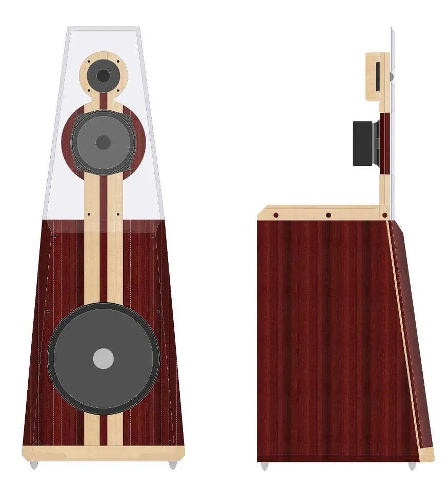

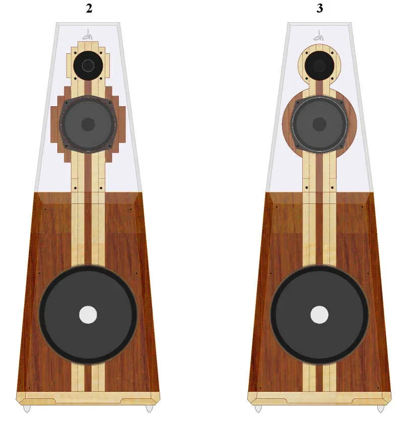

                                  Well, I finished the boxes and Im ready to start some measurments, but I don't have the mids yet. They are on backorder until at least 9/30. In the meantime, I’m starting on the laminated baffles for the BaSSlines. I'm going to keep it simple and use easily available hardwood for the laminated sections, most likely walnut and maple. I decided to flip the color scheme and go with a predominantly dark baffle with light accents and light box (see below). Which do you like?

                                    • 16120
                                    #287
                                    3 for sure for me.
                                    • Saurav
                                      • 1166
                                      #288
                                      3. Definitely not 2 On 3, I'd even make the 2 outermost laminates on the tweeter dark, so you have a constant width to the narrow stripe. This may look better if you made the baffle 'rings' wider so they meet between the drivers, either at the circle edge/tangent, or if you go even bigger, then as partial circular arcs. Though I'm not sure if you have enough baffle left to make the lower circle bigger, and just making the upper one bigger may look weird. But if they met with a thicker 'joint', to where the dark brown from the lower circle touched the upper one, that might tie them together too.
                                      But I'm not sure that idea will work, so yeah, 3.
                                      • augerpro
                                        • 1871
                                        #289
                                        I like the dark with light accents better too.
                                        ~Brandon 8O
                                        DriverVault
                                        Soma Sonus
                                          #290
                                          3. Not 2 for sure.
                                          Have fun!

                                                I vote for option number two

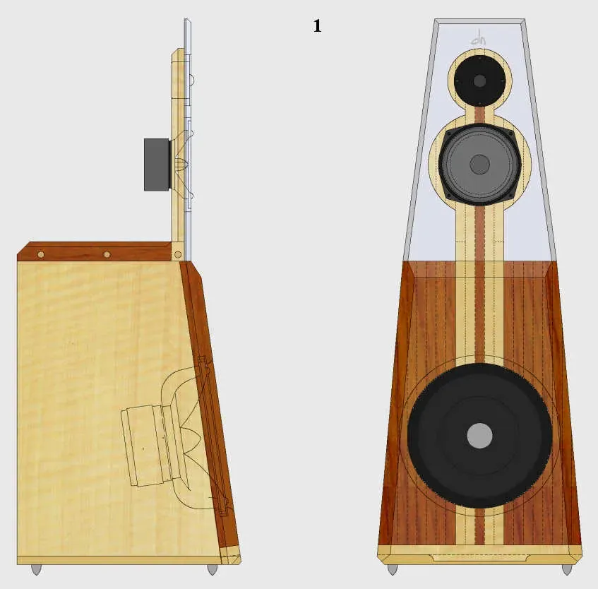

                                                  • 1456
                                                  #294

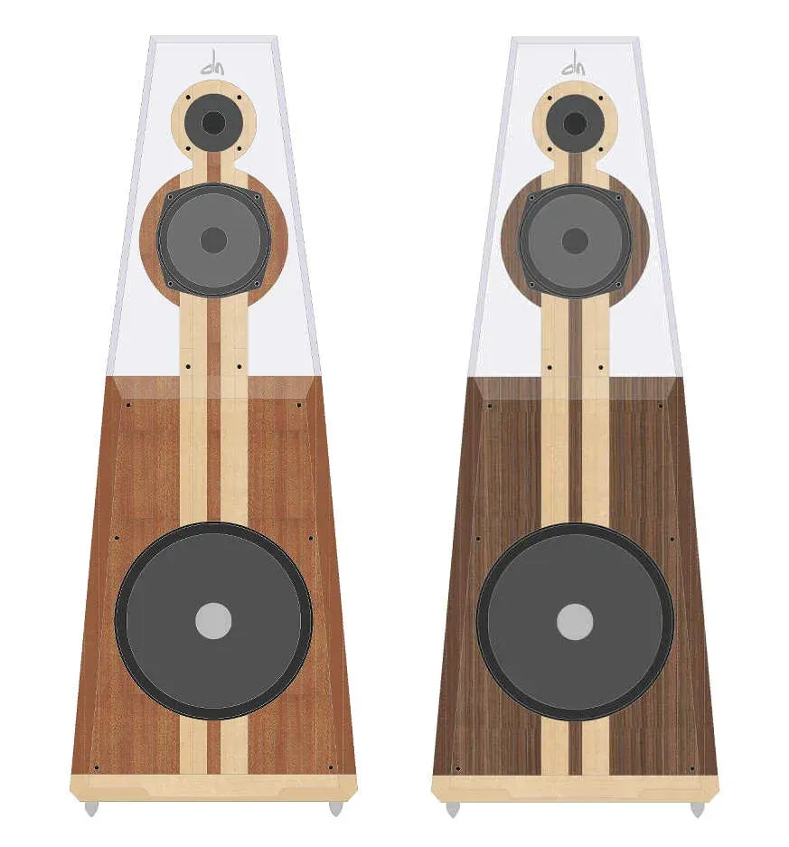

                                                  I appreciate the feedback guys. It looks like # 3 is the winner. My wife likes it best also. I just have to figure out what hardwood to use. It is so expensive now and I figure I need about 35' of light colored hardwood and 70' of dark colored hardwood for two speakers!
                                                  I was looking last night at Maple and Walnut as a combo at Menards. A 6' 1"x6" walnut board was $43.50! Maple was nt too bad at about $16.00 for that size. Other possibilities for the dark wood is Cherry and Mahogany. I've never used Mahogany, but it is low priced at under $12 for that size, bu cherry is just about the same price as walnut.
                                                  The dilemma is that I have to use the natural wood colors due to the way these are laminated and will be sanded flat together as one panel. I'm trying to decide between Walut/maple and Mahogany/maple. This is a more realistic mockup of those combinations.

                                                                    • 1456
                                                                    #303
                                                                    Hi guys,
                                                                    I'm starting on some measurements. I'll post some later. Here is what I'm currently thinking on the finish. Padouk and Maple or Sycamore. This one is with maple.

                                                                      • 16120
