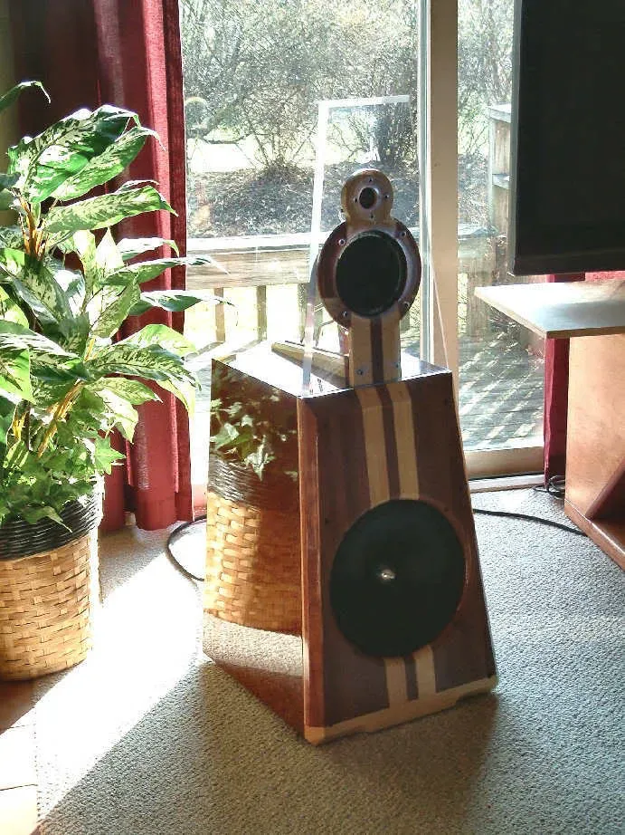

    Wow great job! Looks very neat with the lexan baffles.

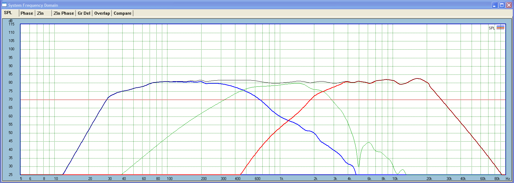

      They are finally complete! Below are the final details for the BaSSlines design. I'm extremely pleased with the results, which I believe are my best effort so far.
      Included below is the crossover schematic, the simulted frequency response, the simulated polar response from 500-3500 in 500hz increments, the parts list (using all PE available crossover parts) and cost estimate for the pair, not including the lexan, the hardwood, mdf or veneer and finishing supplies and a photo in our main room.

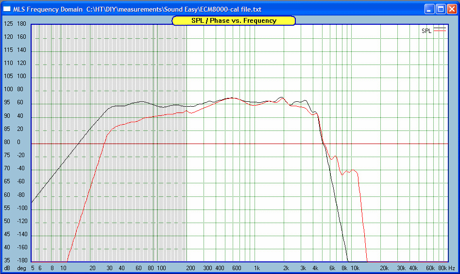

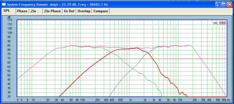

                                          I meant to post this here, but never got around to it. I have been struggling trying the get the crossover right since December, after I showed the prototypes at the Lexington DIY. I had decided to make some physical changes in the driver layout, prompting a new set of measurements. I have just recently figured out my error. Below is what I posted on the PE forum in regards to the trouble I've gone through and my major screw up. ops: I'll post some more updated results after this post.
                                          As many of you know, I was shocked at how bad the BaSSlines sounded to me at Dayton and at InDIYana for that matter. For those of you who also heard them at Lexington last year in their prototype form, you know how much better they can sound. Well, I've finally figured out what happened and boy was it a bonehead screw-up on my part.
                                          At Lexington, they the XO's were preliminary but the response was not too bad. I decided to make two changes to the design after that. First I lowered the tweeter nearly 2” to improve the vertical polar response. Then I sloped the MT baffle back 5º, instead of leaving it vertical, in order to try and get a better tweeter alignment with the mid. The result of these changes was a need for all new measurements and that is where the ship veered strongly off course.
                                          In the first measurement below you can see what happened at the crux of the problem. The red curve is the bass measurement used in my model, the black is what it should have been, both with nearfield/farfield and port contributions merged. When I did my nearfield measurement, I applied a full 6db of bsc, which I didn’t do in the prelim measurements and should not have done here, because the 12” woofer is very close to the floor, meaning little or no bsc was required. In addition, I must have made an error in merging the nearfield and farfield data, since there is obviously more than 6db of bsc shown here.
                                          As a result, my model going into Dayton (and InDIYana) looked like the red line in the graph below, or so I thought. What the response actually looked like is the red curve to about 350hz and the black curve below that. So, instead of having about a 3db drop in the midrange for the open baffle, I had more than a 6db drop. It's no wonder they sounded so bass heavy. Still, they sounded good enough in my listening room, because of the bass null I have at the LP and also because we have an open floor plan that includes most of the bottom floor and up a two story foyer to a tall vaulted ceiling and an upstairs family room, so that I didn't pick up on the problem as I should have. Still, I have been tweaking them on and off since December, after I took the new measurements, because things were just not coming together and I was mysteriously unhappy, despite what the model told me. You can see why now.

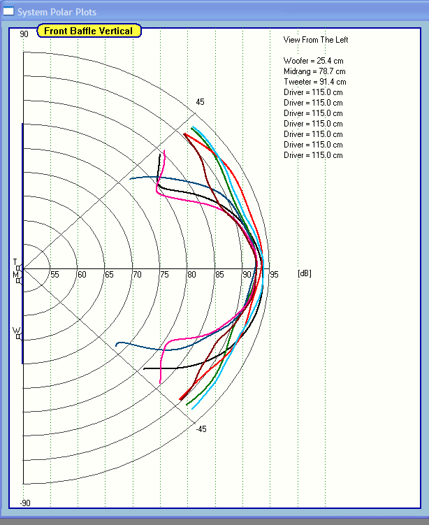

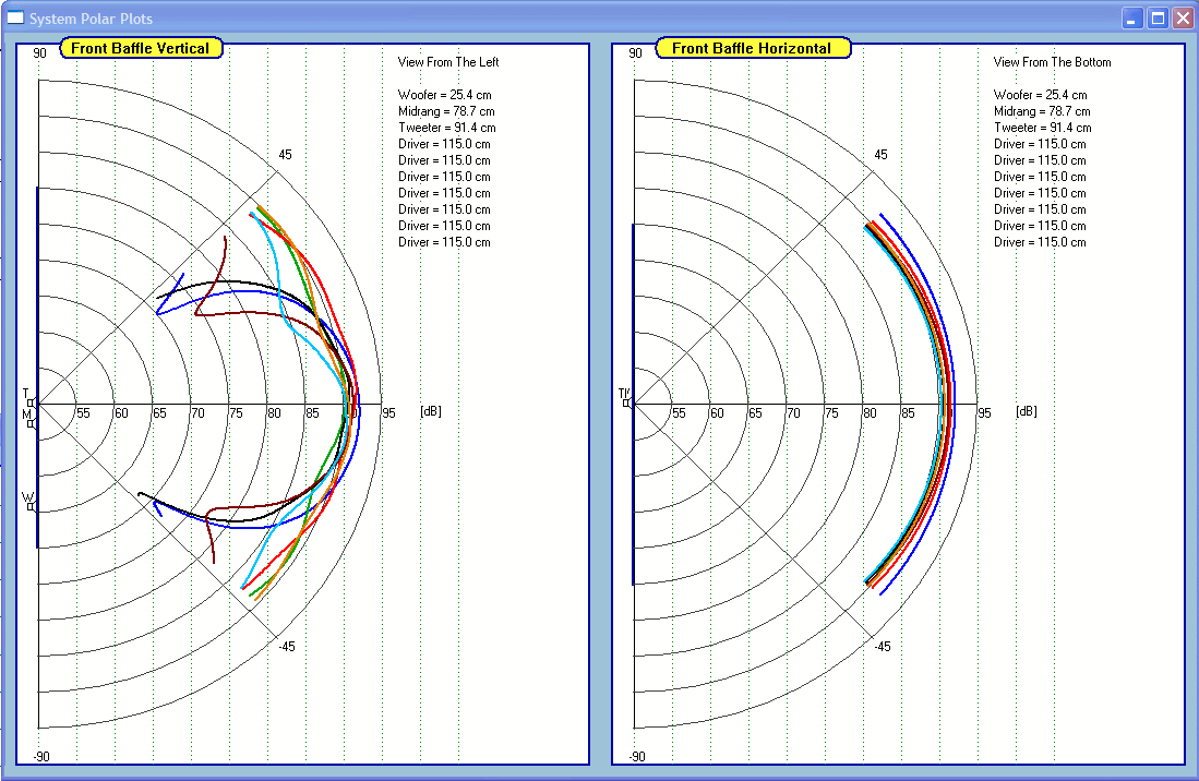

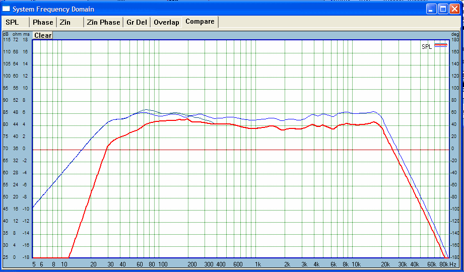

                                            Here are some other results. First is a simulation of the vertical polar response. These are from 500hz to 3500hz in 500hz increments.

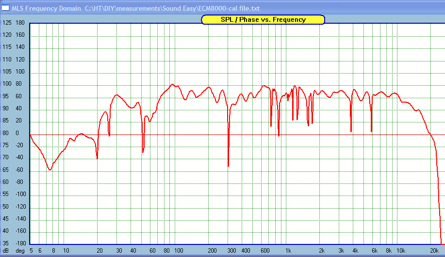

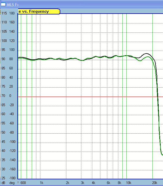

                                            The second graph is the measured frequency response, left speaker over right. The mesurements were taken at 101", with a gated window of 6ms (speaker was up on a stand inside the house). It has been cropped because the data below 500hz is not acurate. I'm shooting for a 2-3db dip in the midrange due to the open baffle mid, whose rear radiation is not shown in this gated graph, but is heard in the room. I had an oops with one of the first pair of HDS tweeters I purchased. This was before they went unavailable for a couple months. The replacement I ordered was from a new batch and measured a bit differently, which may explain the difference above 13khz or so, or perhaps there is a little difference between the fabrication of the DIY waveguides from the left to right speaker. I don't find it an audible difference.
                                            I don't know how accurate this method is, but since I don't have a software like REW to measure the in room response of both speakers at the listening position, I tried to measure it using MLS in SoundEasy. I took separate measurements of the left and right speakers with a very large gated windown (500ms, IIRC) and then summed their responses in SE. This is what the summed response looked like. I'm not sure this is valid, but you can see how the midrange is filled in. Actually the tweeter is down a little bit, I'd say. Also, the bass null I've been struggling with at my listneing position and that I mentioned in the previous post, is probably the dip that shows up from about 30-80hz. I think this is part of why it took me so long in figuring out what was going awry. ops:

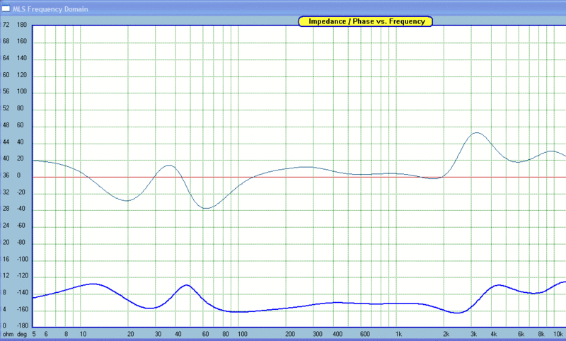

                                            Here is the measured impedance and impedance phase. It dips slightly below 4ohms at 2.5khz.

                                                                    Oh- forgot one more thing-
                                                                    Are you going to mount the tweeters the same way this time? IIRC, they were different in the previous iteration of the BaSSlines.
                                                                    Later,
                                                                    Wolf
                                                                      • 1456
                                                                      #484
                                                                      Ben,
                                                                      You are correct. The original design had the tweeter faceplates removed and they were mounted from behind in a 3/4" deep mini waveguide, which was not particularly effective. The Morels will be flush surface mounted as will the rear tweeters.
