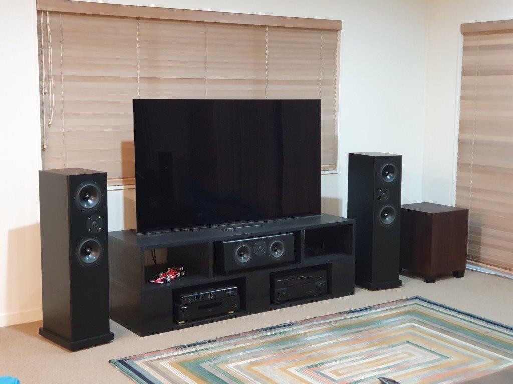

    Hi Folks,
    I have had most of the parts both towers and centre channel speakers for far too long and am finally getting around to making sawdust.
    The Towers are 3.5way and centre 3 way.
    My problem is I left buying some of the inductors until last, the towers use an 3.6mH Erse Super Q inductor for the lower woofer and thes now seem to be unobtainium.
    Parts Express have them listed on the website not in stock with no ETA, I contacted them and they have said Erse are no longer in business.
    This is weird as their website is still active, I actually managed to order a couple online but then got an email to say the order had been cancelled, an email as to query why has gone unanswered.
    So I have a couple of questions,
    Does anyone know where these might be available?
    Can I just leave them out and run the towers as 3 ways?
    Last one is a little left field but I do have a pair of 3.0mH inductors from another build no longer in use (both Erse 16ga Super Q). Is it possible I could get someone with the correct knowledge and equipment to wind some more wire onto the these coils to bring them up to the correct spec?
    Thanks in advance for your help. I am currently running a set of Modula MTM's and CJD RS150 as front three in my home theatre system. The plan is to use the ZDT's up front and move everything else to the rear.

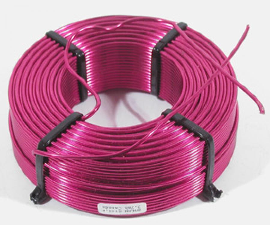

          I found a 16 AWG 3.5 mH/0.28-ohm steel laminate inductor that is in stock and, I think, from India. The company is The Audio Crafts DIY Unlimited. The link I'm providing shows a cost of 690.00INR, whatever that means.
          https://theaudiocrafts.com/x-over-parts/hi-quality-inductors/16-awg-steel-laminate-inductors-ofc/Steel-Laminate-Crossover-Inductor-Coil-16-AWG-3.50mH
          Hope this helps.
          Paul

          • Absinthe
            • Sep 2021
            • 48
            INR is the Indian Rupee.
            1 INR = 0.013 USD so the inductor would cost approximately $8.68 plus whatever VAT and shipping charges are involved

                          Is there another centre channel using the RS180 that will suit the Natalie P's if I built them? One of the reasons I liked the ZDT was moving to a 3 way speaker and I have a 230mm max height to fit the cabinet. Also aware there may be BSC issues putting a centre speaker in the cabinet but again I'm happy to compromise here and I built the cabinet as well (I've built legs for them since the photo was taken to raise the tweeter closer to ear level)so could modify if needed to fit a bigger speaker plus I hope to move at some stage next year. With any luck I'll be able to wall mount the TV and place the CC on its own stand (dedicated media room is top of the list).
