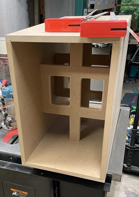

    Main box without baffles.

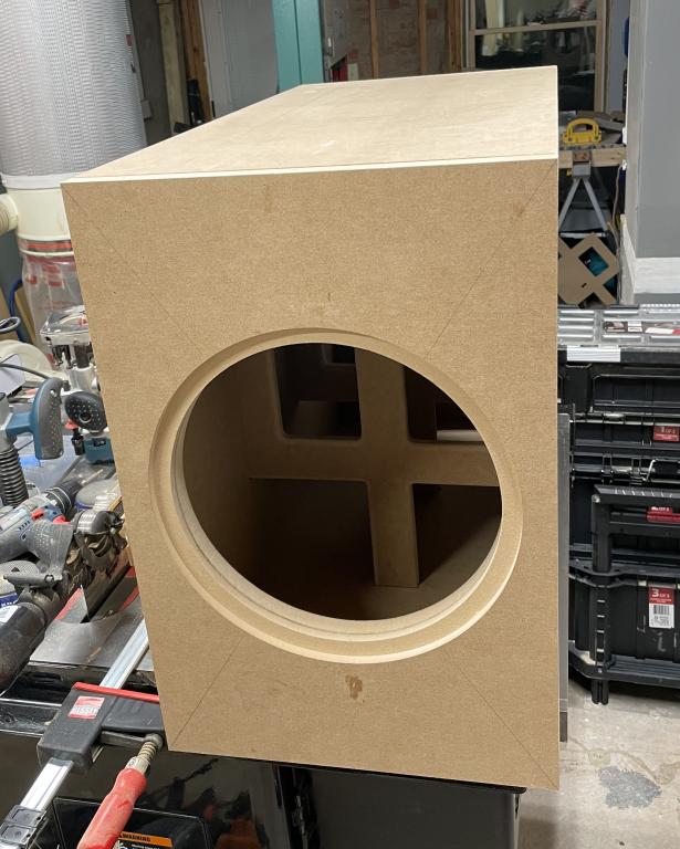

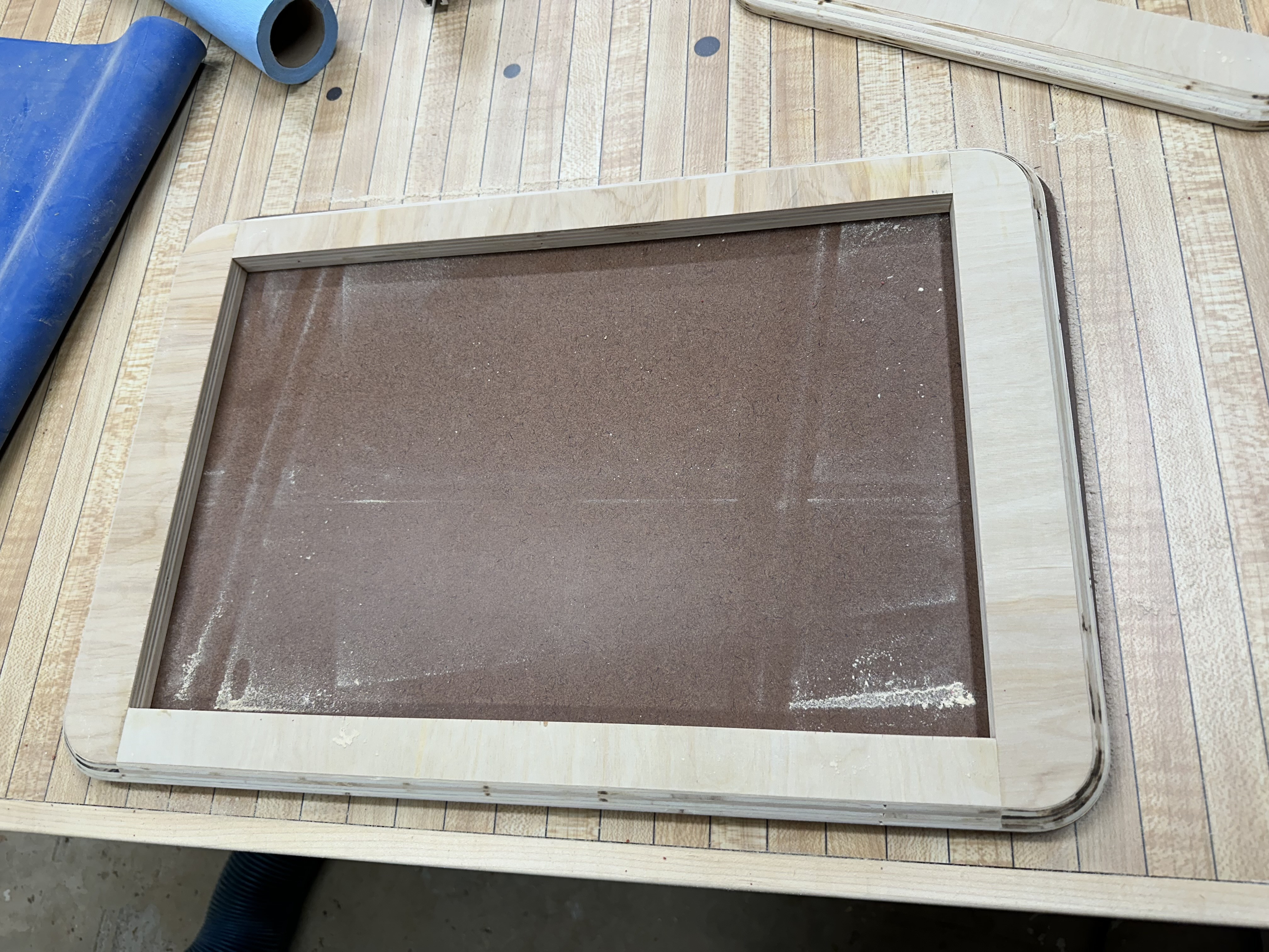

    Baffles dry fitted.

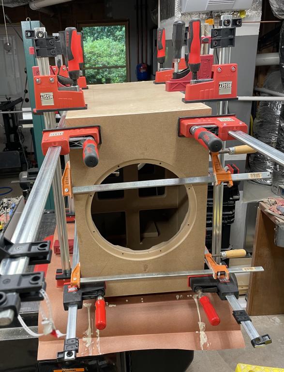

    Glue up.
    • 1024
    The presence of all those clamps suggest you're a bit past being an amateur!
    • Carl V
      • 269
      8O and the machines in the background...table saw etc.,
      regardless, looking good, keep us up to date.

            • 1038
            ....and the interlocking joinery.
            On a more serious note, the main mechanical stresses will be on the baffles. You might want to retrofit (if they aren't already coming) bracing to mechanically link the front and rear baffles together. It doesn't need to be a lot (2" strips are about the sweet spot), and they would work best glued perpendicular to the rest of the cabinet walls (i.e., like a lip for a shelf or a truncated I-beam).
            The Dual-Opposed concept works very well, but a mechanical assist here and there is even better.

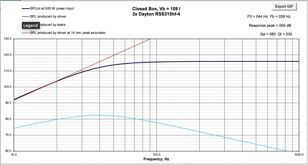

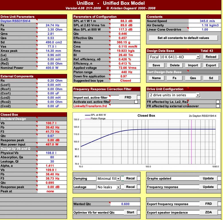

              So, being new at this, I never saved off my original calculations. I went ahead and recalculated based on what I had for dimensions and it may have exposed an issue in my original calculations. Unibox also doesn't seem to agree with the parameters Zaph had. It calculates the QTC lower than what his target was.
              So here is the Zaph plots for a single driver unit that got this started.

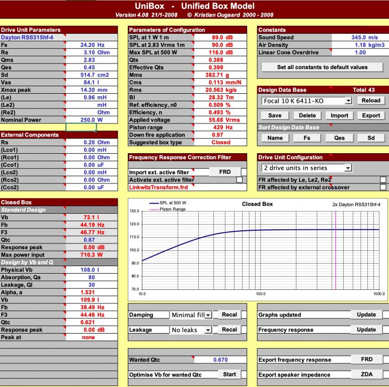

              This is what I had for the modeling result from Unibox for the dual driver configuration.
Name:	Subwoofer modeling.jpg
              This is what I input for the parameters.
Name:	Subwoofer modeling input.jpg
              So, what to do next? Should I have gone smaller on the box?

                  • 15284
                  Short answer, no. Possibly larger- it all depends on the amplification setup you plan, but lower Qts just means the transient response will be a bit better damped, and you may need a bit of EQ to "level things out".

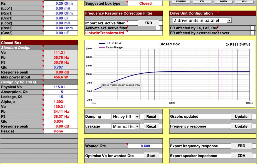

                  Now, an interesting thing is that you are doing a dual driver sub, with the HF-4 version, whereas I have a system design that is more for a woofer with extended bottom end and output capability using two RSS315HFA-8 - this driver has somewhat different T/S parameters and of course, 8 ohm voice coils I can wire in parallel for a 4 ohm speaker load.
                  Let's look and compare with the Isiris build, in which the Daytons were chosen to replace Auradound 4 ohm woofers.
                  First, the working pane for the sealed design:
Name:	RSS315HFA-8 2x Sealed Isiris Design Unibox.jpg
                  This shows that for these drivers, and the desired Qtc of 0.6, a "standard design" would need a box volume of 111.2L, and that's pretty close to the actual cabinet volume of 115L, and the other parameters are entered based on the "as built" characteristics, including heavy fiberglass fill.

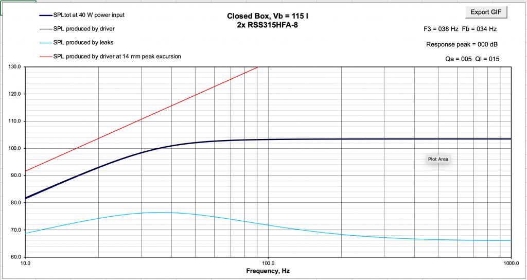

                  And the calculated response profile:
Name:	2x RSS315HFA-8 Isiris Sealed.jpg
                  This is the level produced with a total of 40W input power, calculated from the RMS voltage into a resistive load (which the driver isn't), and the calculated F3 is 38 Hz, pretty much on the money as with the Aurasounds, with a box Fb of 34Hz. Things are pretty much loafing along to produce 103 dB SPL, and there is headroom for a single cabinet to produce 110 dB at 30Hz at Xmax. But these are stereo speakers...

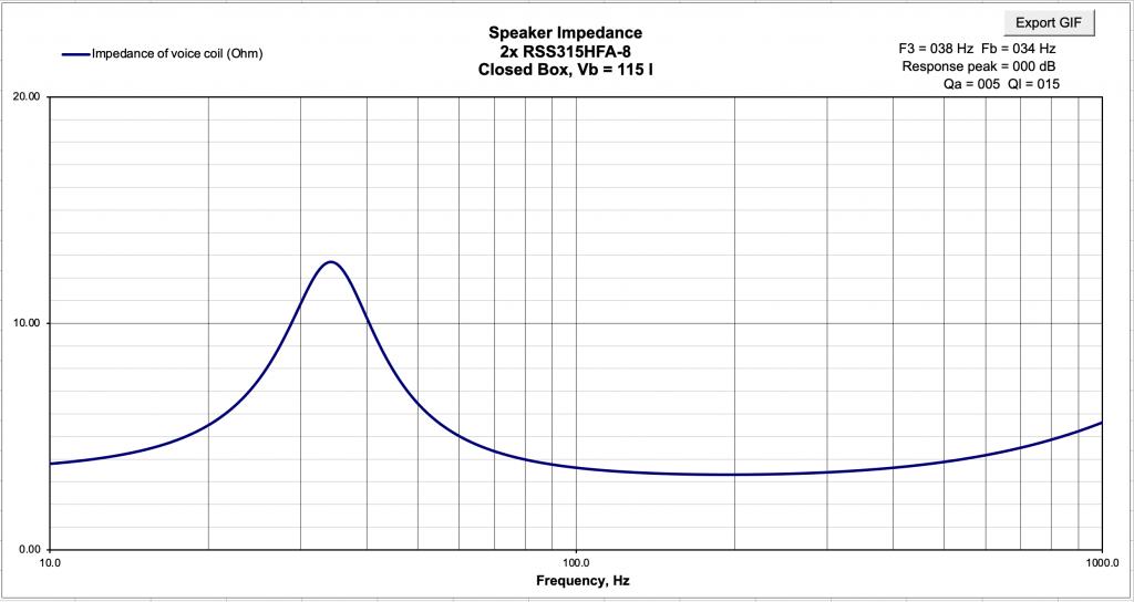

                  The Fb is shown with the impedance peak in the impedance profile:
                  And the calculated impedance profile:
Name:	2x RSS315HFA-8 Isiris Impedance.jpg

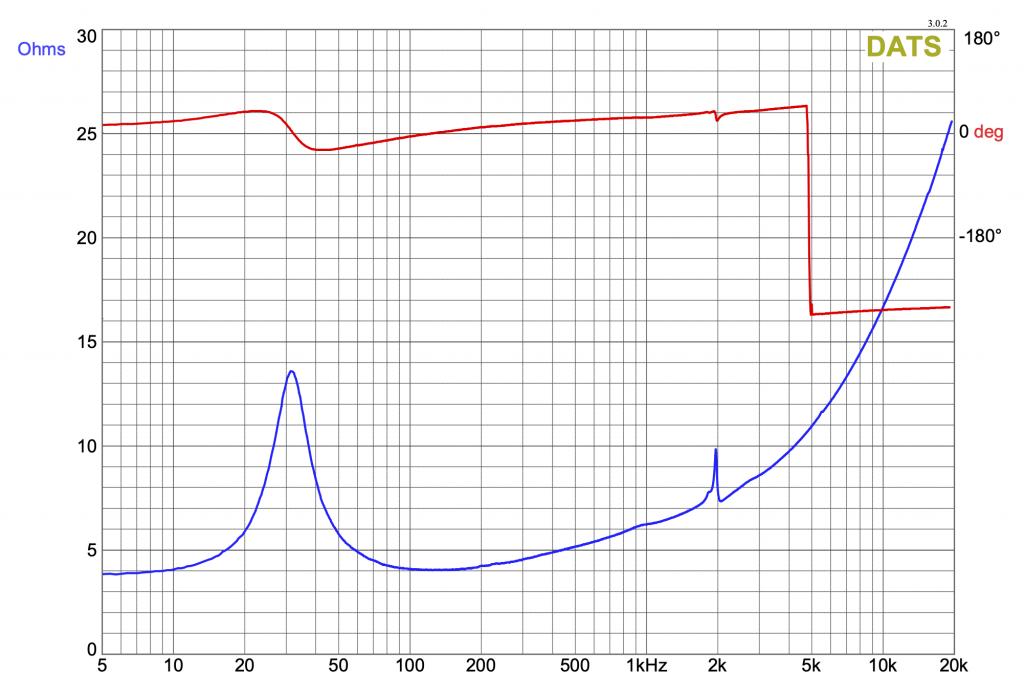

                  And for comparison, the measured impedance profile:
Name:	Isiris-RSS315HFA impedance.jpg
                  Which shows the Fb is more like 32Hz than 34 Hz, which is what I was hoping for all along.
                  Do you already have your HF-4 drivers? If not, and if your driving arrangements permit, you might want to consider the RSS315HFA-8.

                        Where did go wrong with unibox? I can’t seem to get those numbers to work.
                          • 1038
                          Hmm, I figured being 1.5" thick, close to the side edges and having the extra lips glued in there it would be fine.
                          You've got fairly extensive bracing on the side walls, but with a subwoofer that will likely be crossed <100Hz, you are looking at very little energy (3rd - 5th harmonic, at best) that excites the sidewalls. The bracing will help with the "knuckle" test, but in practice there won't be a lot of energy there from your content. In other words, you should hit the sweet spot for overkill there.
                          Your sub box is proportionately tall, though. If you are really looking at driving these things hard, then a 2" - 3" lip that is perpendicular to your top and bottom walls that connects your front and rear baffles with the rest of your bracing structure (looks like you'd need three sections for each wall) would get you to overkill by breaking up the length of unsupported baffle. If you are happy with your test fit, though, then go with what you've built.
                          As far as Unibox goes, you probably don't need the 0.2 ohms of resistance in the model unless you are running a long length of copper between the ICEPower module and the woofers. Given the applied power, I'm guessing that you've got a 1000ASP module? The Unibox model is showing 500W applied (the power is per driver) with the drivers wired in series. That's an 8 ohm nominal load, and it will affect the overall model a fair bit (so will the series resistance).

                            I decided to pull the trigger on a crown xls 1502 since the price was right. That should be enough even at 8 ohms. I have enough msg to create some vertical trial braces but I am not sure how much it will help.
                            I guess I need to model a the 8 ohm version of the woofer just to see how it differs. I was thinking my calls were off but it looks like the 8ohm version models a bit better?
                              • 15284
                              Remember, all the different versions have somewhat different T/S parameters; the HO are nominally optimized for small enclosures (I think car audio when I hear that term) and the HF for larger enclosures. Interestingly, the HF usually have a longer throw VC... but cone mass and compliance vary too, and the HFA version is not the same as HF. HFA is a relatively newer part.
                              I like to use the verbiage that they model differently, and whether it's better or not depends on your usage case. Also, remember, a small amount of EQ can see you through in leveling out your LF response. And that can be as simple as something like an inline filter as described in the voicing filter thread, but adapted to low frequency by changing the capacitor and resistor values.
                              you've got options... take a deep breath, and just keep investigating.

                                  So, it looks like I made some notes on what my original input parameters were and they are quite different for the driver. The parameters from PE were not as accurate from what I recall and I seem to recall using DATS to verify.
                                  This is the updated model.
Name:	Subwoofer modeling input updated.jpg

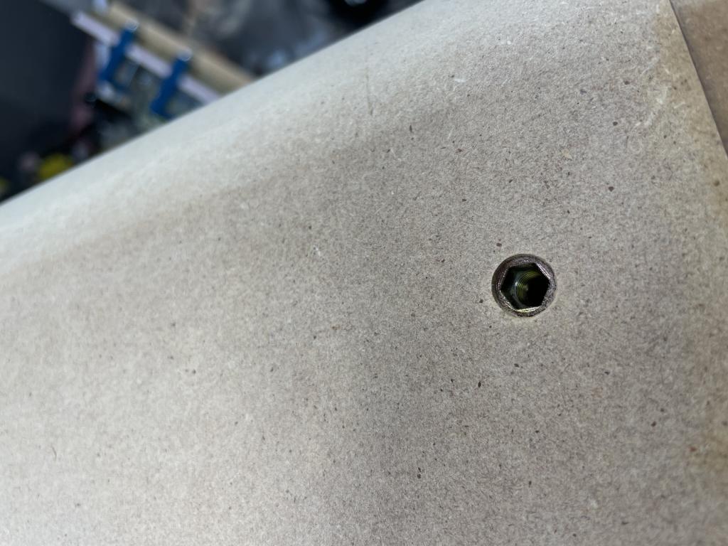

                                  I purchased some SVS subwoofer feet and self tapping inserts designed for mdf. In a couple experiments, it ends up splitting off some of the mdf upon inserting at several different predrilled hole sizes. How does one avoid this and do you you veneer and then add the inserts or add the inserts and veneer?
                                    • 1024
                                    Yeah, those big router bits can get scary...I did the same thing yesterday. I really prefer using those large bits in a table router, but sometimes that just doesn't work. I also only did half the edges I needed to do as the router and bit were both uncomfortably warm (and my hands were tired).
                                    • CADman_ks
                                      • Jan 2012
                                      • 497
                                      I don't recall what feet I used when I built my sub, but the inserts that were provided with them did bulge up the edge right around the insert. Luckily for me, I had predrilled the holes in the panels before veneering, so I was able to simply sand or chisel off the area that bulged up.
                                      I wouldn't worry too much about it though, since the foot will cover up all that area. I think that the key is to just get it flat, so that the foot is sitting on a flat plane...

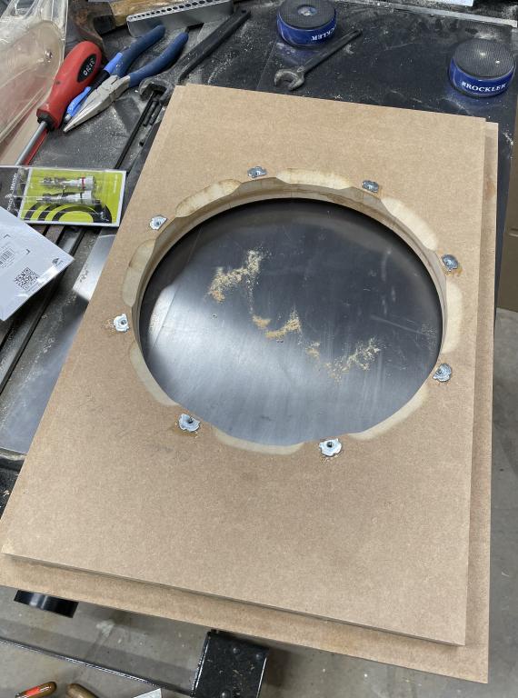

                                                    Threaded inserts added for the feet. Used the jig and glad I did due to not using brad point bits. It wanted to wander a bit. I am slowly replacing all my harbor freight bits with better ones but the size needed was unusual.

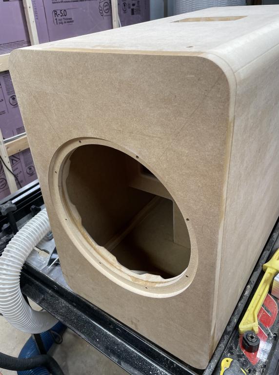

                                                    Round overs complete as well. I had to rework the edges on half due to the trim router base being so small and the bit not staying perpendicular to the front edge. Using the router table on those may be harder but is far more accurate.

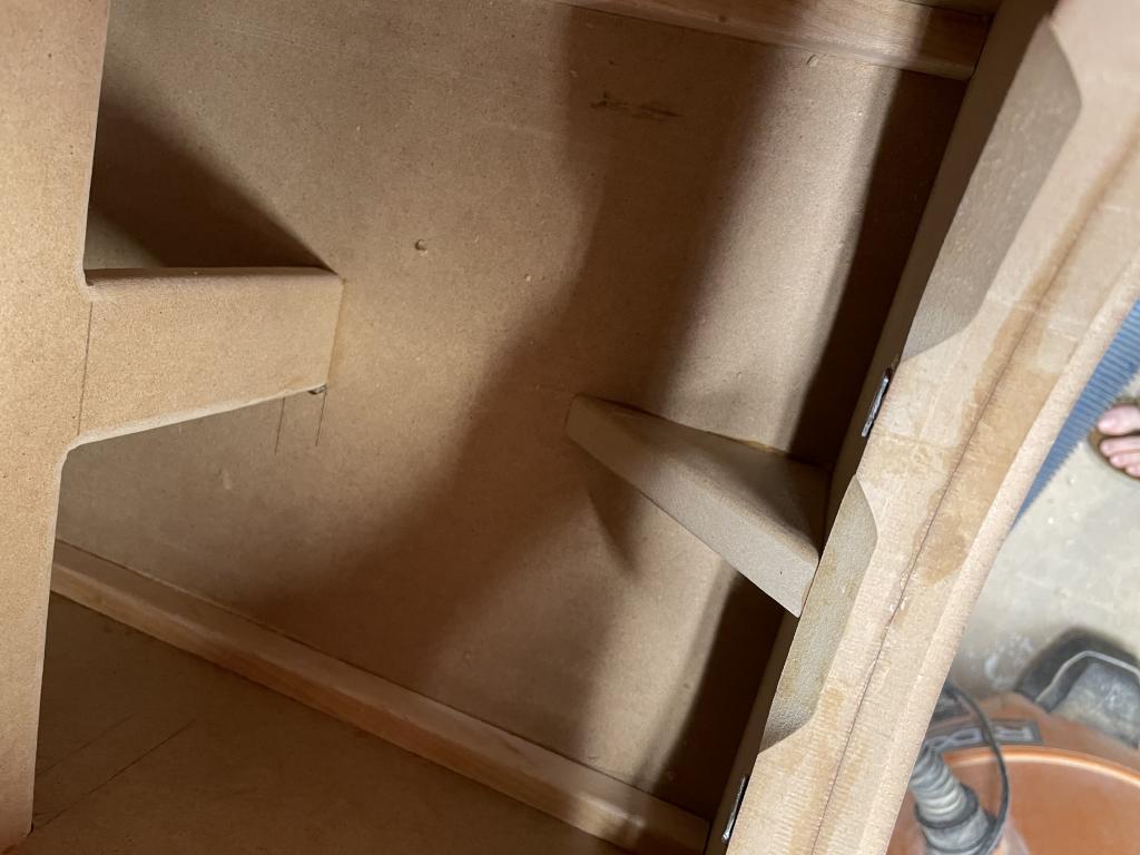

                                                    Bracing added top and bottom. Glued in and pin nailed to hold it as it dried.
                                                    Next up will be more cleanup from the patches and giving it a nice smooth surface to prep for the walnut veneer.
                                                    Being new to woodworking, I am learning to dial in the tolerances and some of the issues when using a router.
                                                    Finding time and waiting on the patches to dry has taken some time. I can’t blame it on the 1.5 month old
