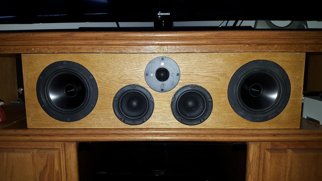

    I am building the boxes (From the original size in two thousand eight) a set of Sealed Statements. I will be using the RS225-8 woofers, the NE123-8 mid bass speakers, but I want to use the RS28F-4 tweeter... basically a Sealed Statement II with the change from the ribbon tweeter to the RS28F.
    The reason for this is that I already built the Center channel speaker and would like to match it.
    So... my question is, which crossover design should I use for this build?
    Here is what my center looks like.. as well as what I would like to match Click image for larger version

    The tweeter circuit for the Finalists center will be the closest. No guarantees that it won't need adjustment but that should get you close.

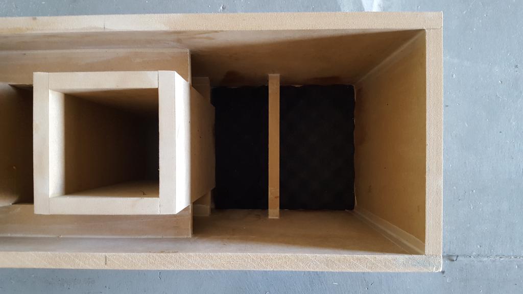

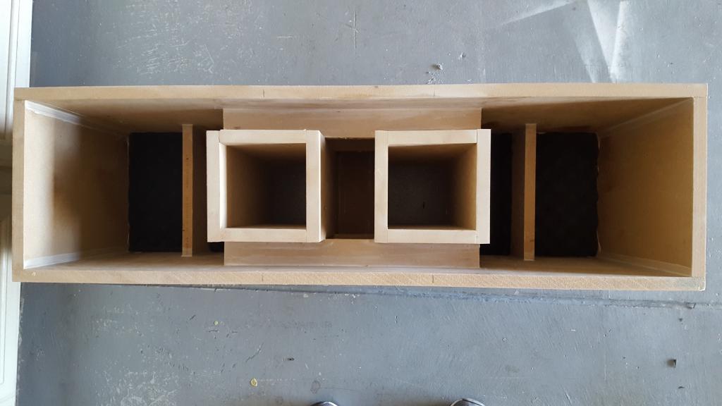

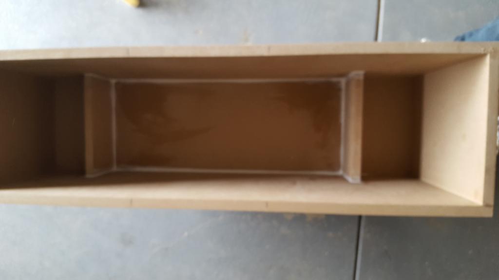

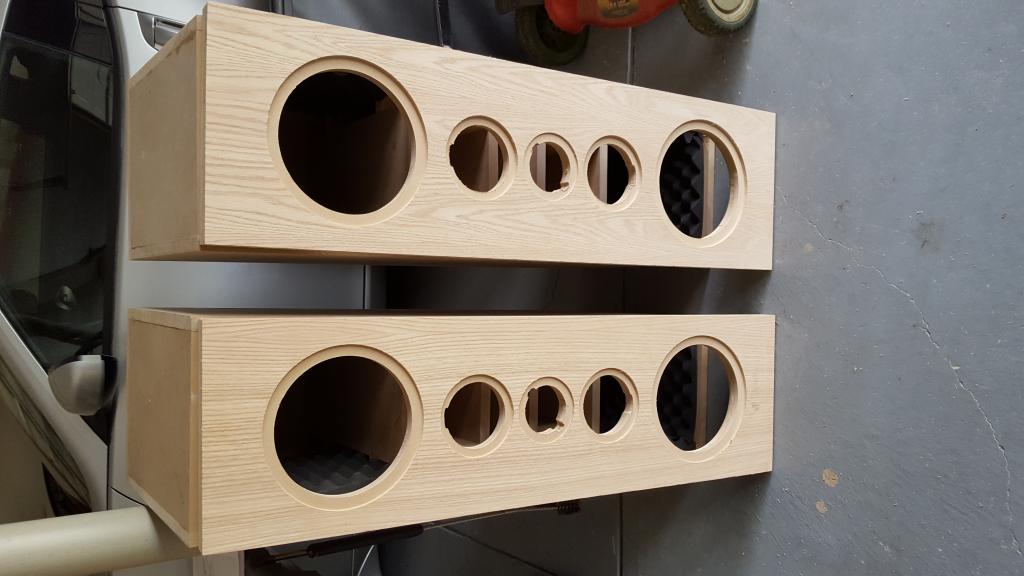

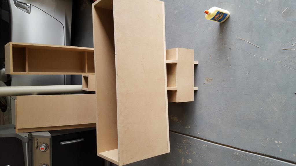

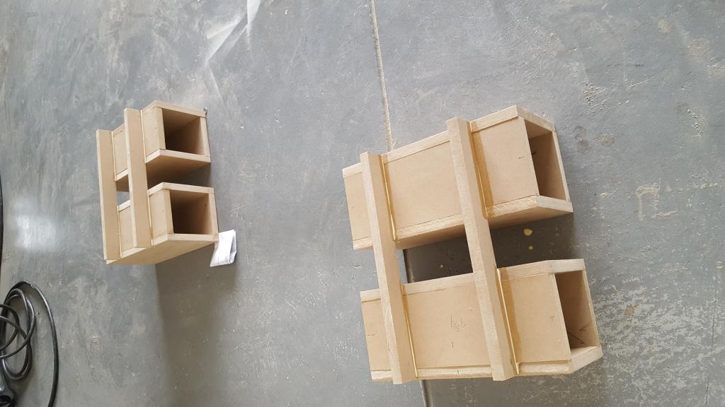

          Going for it! Decided to do the ported Statements II (With the RS28F) Tweeters. Here is a sneak peek so far...

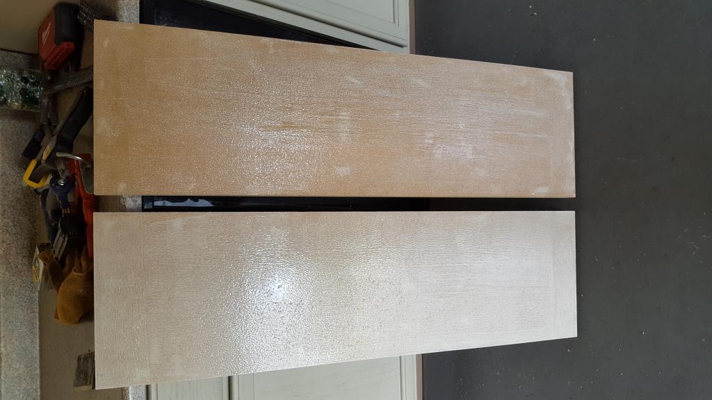

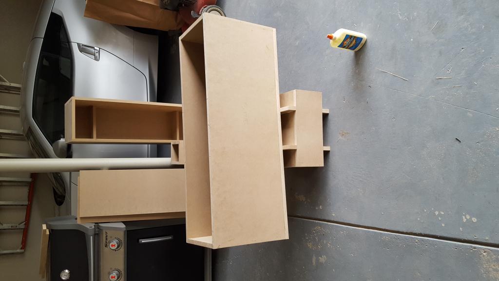

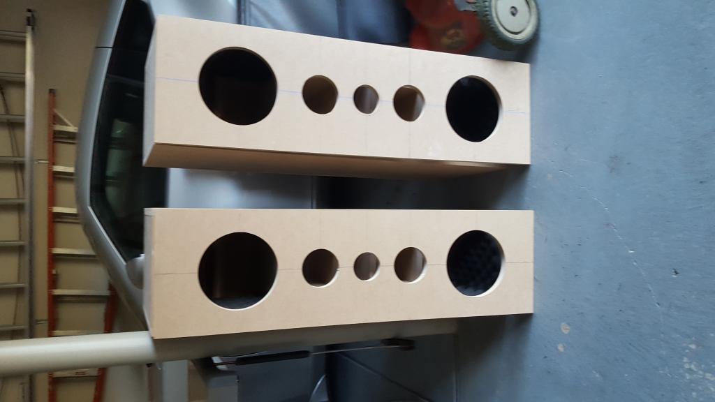

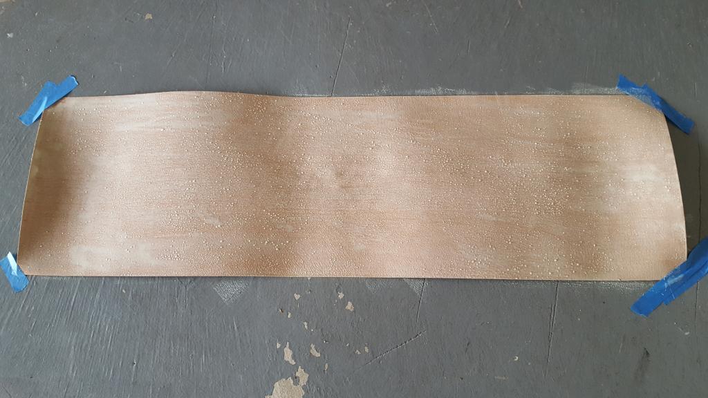

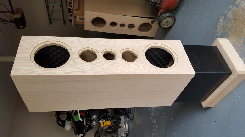

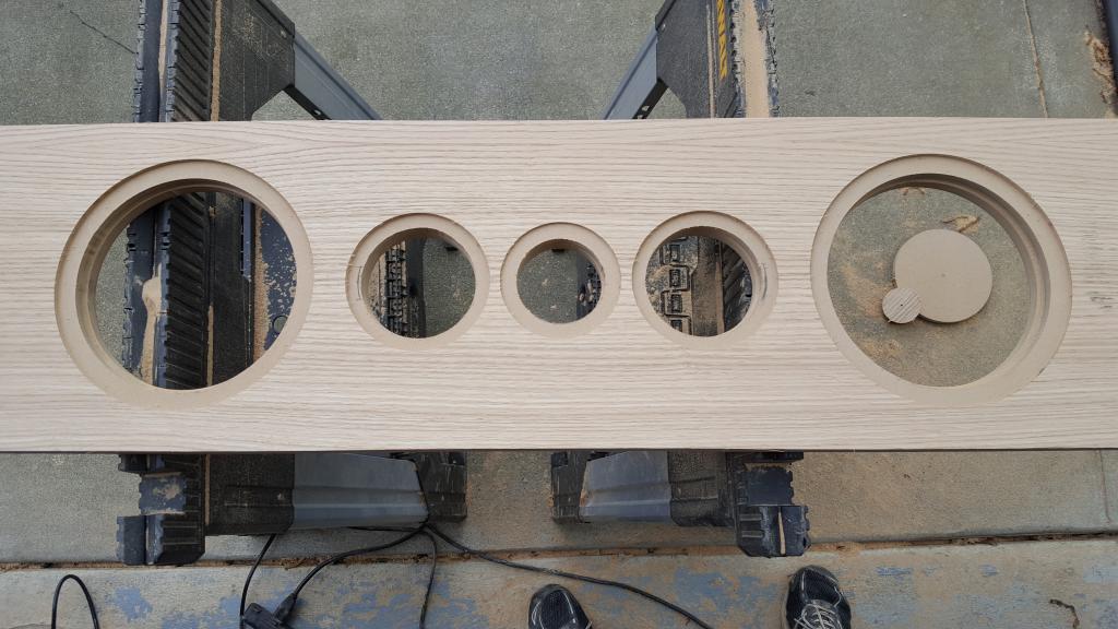

            Statements II RS28F Tweeters
            Stages of the build.. YouTube is your friend here if you want to apply veneer to MDF.
            Last edited by theSven; 08 April 2023, 09:46 Saturday. Reason: Update image location

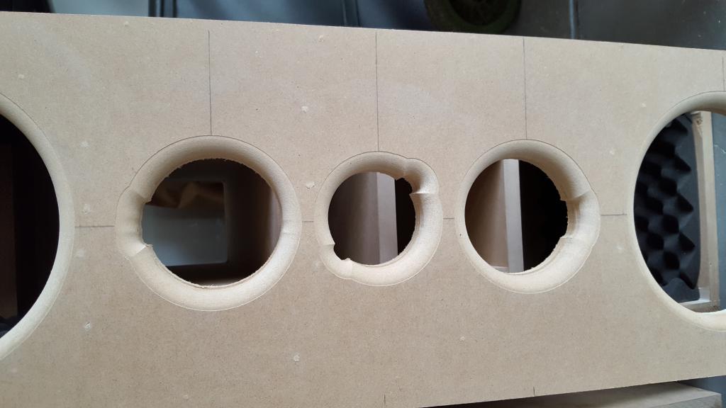

              A few more.. then on to the Crossover Build.
              Click image for larger versionName:	20170423_133437.jpgViews:	2Size:	57.2 KBID:	862907Click image for larger versionName:	20170423_115724.jpgViews:	2Size:	51.6 KBID:	862908Click image for larger versionName:	20170423_115714.jpgViews:	2Size:	53.2 KBID:	862909Click image for larger versionName:	20170422_162646.jpgViews:	2Size:	63.4 KBID:	862910Click image for larger versionName:	20170422_162544.jpgViews:	2Size:	55.2 KBID:	862911
              Last edited by theSven; 08 April 2023, 09:47 Saturday. Reason: Update image location

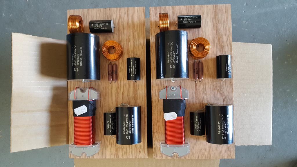

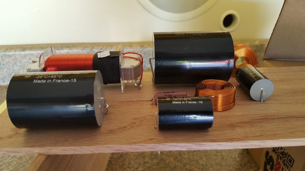

                  The Crossovers... Waiting on back ordered resistors. Will add terminal strips as well

                    Jim, I noticed a difference in the capacitor value from the (center channel) to the statements II speaker. I thought this was odd so I thought I would chime in.... I am seeing a 68uf value on the centers, and a 60uf on the original statements II. This had me confused because they should remain the same as far as the speakers go. Volume should not play a part from what I understand? I am hoping this was a typo. I went with a 51uf and a 9.1uf (due to stock at P.E) in parallel to achieve a 60.1uf value. Hope I am okay with that.
                    I also used the updated mid woofer Xover circuit for the Statements II, coupled with the Tweeter circuit for the change to the RS28F (As it is in the center channel).
                    By the way.. not sure if you caught the post, but I cannot help myself...This will be a PORTED statement build! I figured with the time involved and having to build some sort of base for them... I may as well go all the wa
                    Let me know if you see any issues in my build.
                    Thanks again,
                    Dan

                      Hi Dan,
                      You should use the Statements II crossover for the mids and woofer exactly as speced. The only difference is you'll substitute the RS28F tweeter crossover from the Finalist center for the ribbon. Again, no guarantees this will be perfect, but it should get you closer to correct. Ignore the mid and woofer crossover from the center or original Statements. The different cap values change crossover frequencies depending on the drivers and application.

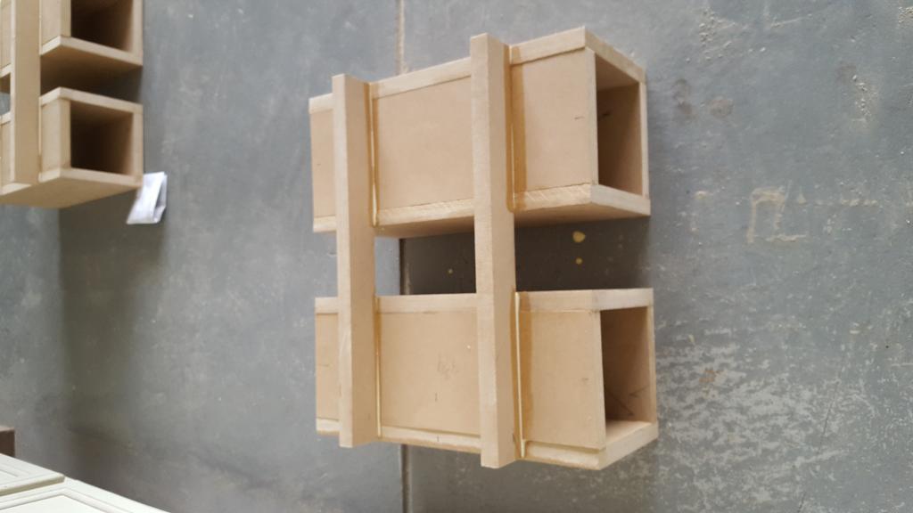

                      I prefer ported. However since you have a sealed size cabinet the port can't go directly behind the RS225 for a rear port. Somehow, you'll need to bottom port it. This is the "Y" in DIY. :W
                      HTH

                        Oh yes, I am doing exactly that with regards to the crossovers. I think I was mis understood on the cabinet build. No worries there, I am actually building the full size Statements and porting them. An easy change to the non ported... I am going to take the cabinets I have built and cut the bottom mdf openings, then add the 15" section to them and do a black on the oak section where the port will go. So they will be 55" tall plus whatever base platform I decide to go with.
                        All is good!
                          All is good!
                          Hi Dan,
                          You've got it nailed. Be sure that there's plenty of room for the port to breathe on the bottom. There was a running change in the Statements base that wasn't very well documented in that I cut a 5" wide channel out of the bottom 3 layers of MDF exiting to the back of the speaker. It never runs out of air.
                          You're close!

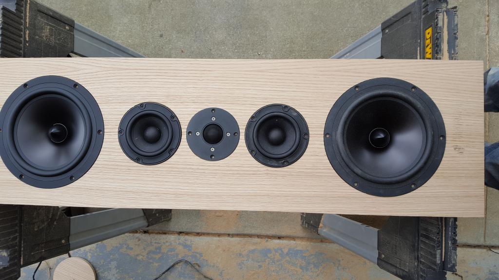

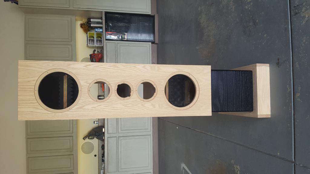

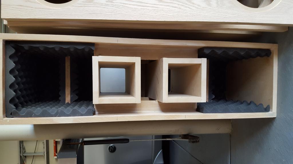

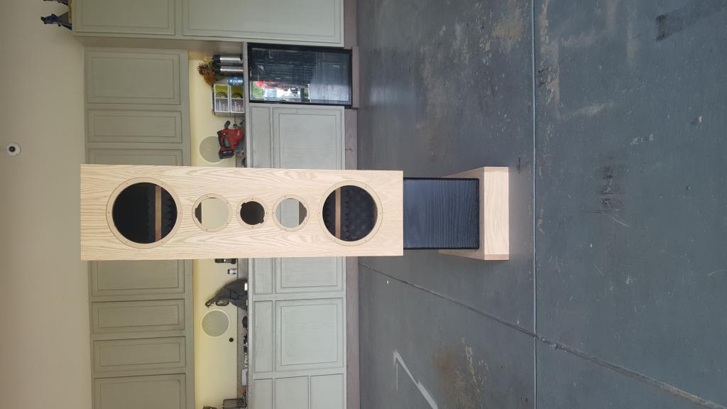

                            Lots to do, but... PROGRESS!
                            So, now that I am waiting on some parts, I had enough to focus on the finalities with one speaker. So, here we go...

                              your loosing points for having such a clean & well organized garage.......
