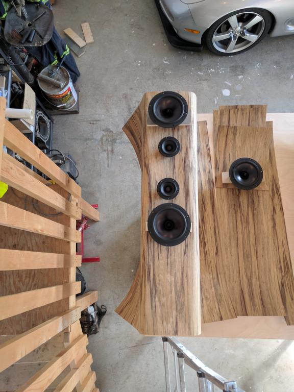

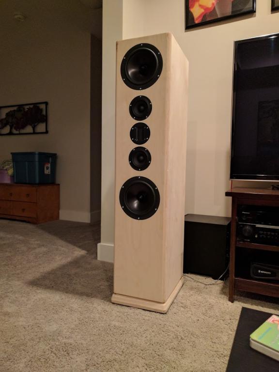

    Perhaps less of a build thread and more of a setup thread as the build is more or less finished and I'm not much of a cameraman. I still need to do the veneer work, but was eager to listen for a few weeks before I began that.
    I deviated from the prescribed plans in a few spots; I shortened the cabinet height by around 3.5" overall as I wanted the look of drivers close the edge of the baffle; The overall cabinet depth is 3/4" shorter; Did my own thing for the base; and the cabinets are rear ported with a cabinet tune of 26hz, mostly due to the smaller volume.
    Here is how they look now.
Name:	Statement II - Copy.jpg

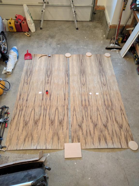

    I have a mahogany veneer to cover them with. I am undecided on how I will finish that, likely a silver stain and shellac or just the shellac.

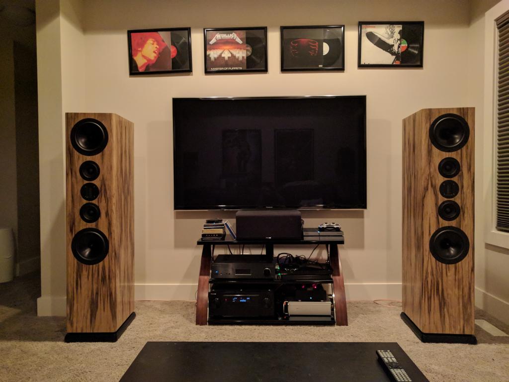

    They have been setup for about 3-4 weeks now, guessing 30-40 hours of use and have been doing great.
    Played around to the best of my ability with room placement, the room is cozy at 10'x13' so there isn't much for options. As they sit they are about 6.5' apart, 8.5' from the main listening position, have a subtle toe in, are 21" from the wall, the right speaker is about 10" from the side wall, they left is generally open to the side as seen in the picture. This seems to give the best balance in the room. I am however open to tweaks that might help get more from them. The room is open to the rest of the house on the left side. I am toying with the idea of some room treatment, but need to learn more before I commit to anything.
    Listening impressions; First and foremost they sound really good, great clarity and detail, the soundstage is excellent with a superb stereo effect/central image. They get loud and stay crystal clear doing so.
    However, this is where it gets a little dicey, unfortunately, I cant say my expectations were fully realized. The Statement II's are replacing (and directly compared with) Paradigm monitor 7 v7's, IMO an excellent entry level speaker. I will say that the statement II's are better than the paradigms, however in most cases the improvement is very subtle. For instance there is just tiny amount more detail in some cases, most noticeable in the bass; they sound more open, but its only subtle; in some recordings I get a sense of more 'sparkle' or 'texture', but again its very subtle. Much more noticeable is the low extension and the overall clarity at high volume.
    This is where I'm looking for help, perhaps my expectations where to high, perhaps my ears aren't golden enough, or perhaps the rest of my gear is holding things back? I have also directly compared them to some B&W 604 S3, this difference/improvement from these to the Statements is more apparent. The plus side is that I'm impressed with how easy the integration into the rest of the system was given the similarities to the Paradigms.
    Admittedly I haven't spent any time listening to true high end gear, so I tend to think my expectations were out of line. I know audio is a game of diminishing returns...
    I am fairly confident that the crossover is correct, as is the cabinet assembly.
    Gear is as follows; Chromecast audio, connected via optical cable to a pioneer VSX-1018 receiver, run in pure direct to a Crown XLS 1502 amp. Generally I stream either FLAC's or stream via Google play. Did some back to back listening tests between CD and 320 bit MP3's years ago and couldn't tell the difference.
    All in a fun build, great sounding result, and I am happy. I want to get the rest out of these or readjust my expectation on what they can do.

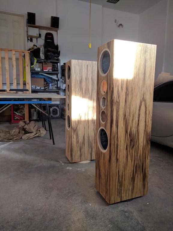

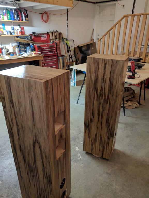

    UPDATE: Added pictures of the veneer, see below for more. I need to add that any hesitations I had on these at the start are gone, superb speaker!
Name:	IMG_20171017_205711 - Copy.jpg
    Last edited by RookieBuilder; 06 November 2017, 17:27 Monday. Reason: Added finished picture
    I suspect that the rest of your gear is holding you back. Rerun the CD vs 320KB MP3 test you ran years ago. If you can't tell a difference, your electronics can stand an upgrade. The statements are capable of resolving the difference if presented with the right signal.
    In your shoes, I'd start with the Pioneer, replace with a decent DAC and analog preamp or processor if you're using HT too. I don't remember the model but I was very disappointed in the performance of a friend's Pioneer receiver when I set up the Nat-Ps I built for him. I'd tested in the shop with a portable CD player driving a Hafler DH-500 and they were great. Pioneer in the system not so much. I haven't heard it, but Emotiva gear has a good following here based on performance for the price. The Crown is a decent subwoofer amp, but lacks the finesse that the Statements deserve. Then consider some better form of streaming source. I can't remember the threads where Jon has mentioned his favorite streamer, but take a look in the On the Test Bench forum.
    As for a standalone DAC, I was shocked by the improvement going with a Schiit Modi MB compared to a number of other built in DACs that I own. They include PC soundcard, m-Audio FW410 interface, Oppo BDP 103 and a Yamaha DSP-A1. The others had been very close, but the Schiit blew them away. Pretty darned good for $250. There was a noticeable improvement even with a set of old speakers and a 15W T-amp that I had at the summer camp. I'm running a Cambridge 851D now which is another big step up.
    If you can temporarily set up your statements in a larger room using the Cardas positioning you will get a feel for what the speakers are capable of. All the stuff in your listening room has an impact. Try to remove as much as you can, and get the right speaker a bit further from the side wall.
    Hope this helps.
      Bob nailed it! I couldn't have said it better.
      The Statements II will continue to sound better as you feed them a better source. Yes, you should easily be able to hear the differences between "very well recorded" CD's and MP3's. I don't know what your listening tastes are so some genres simply have few great recordings to do valid comparisons. I did a quick search of Paradigm monitor 7 since I've not listed to them and after looking at the driver compliment, The Statements II should be a significant step up. So, try to get some better amplification and front end gear with quality recordings to compare the speakers before making any decisions.
      Just another quick thought. Decide what your system goals are. If home theater is your main use, you'll enjoy the benefits of much greater dynamic range and clarity with the Statements II but probably not the sound quality they're capable of with top notch recordings using your present electronics. That doesn't mean you have to listen to only recordings that are highly regarded but the lessor recordings probably aren't going to blow you away. If music is a top priority, your electronics are your 1st order of business.
      Good luck!

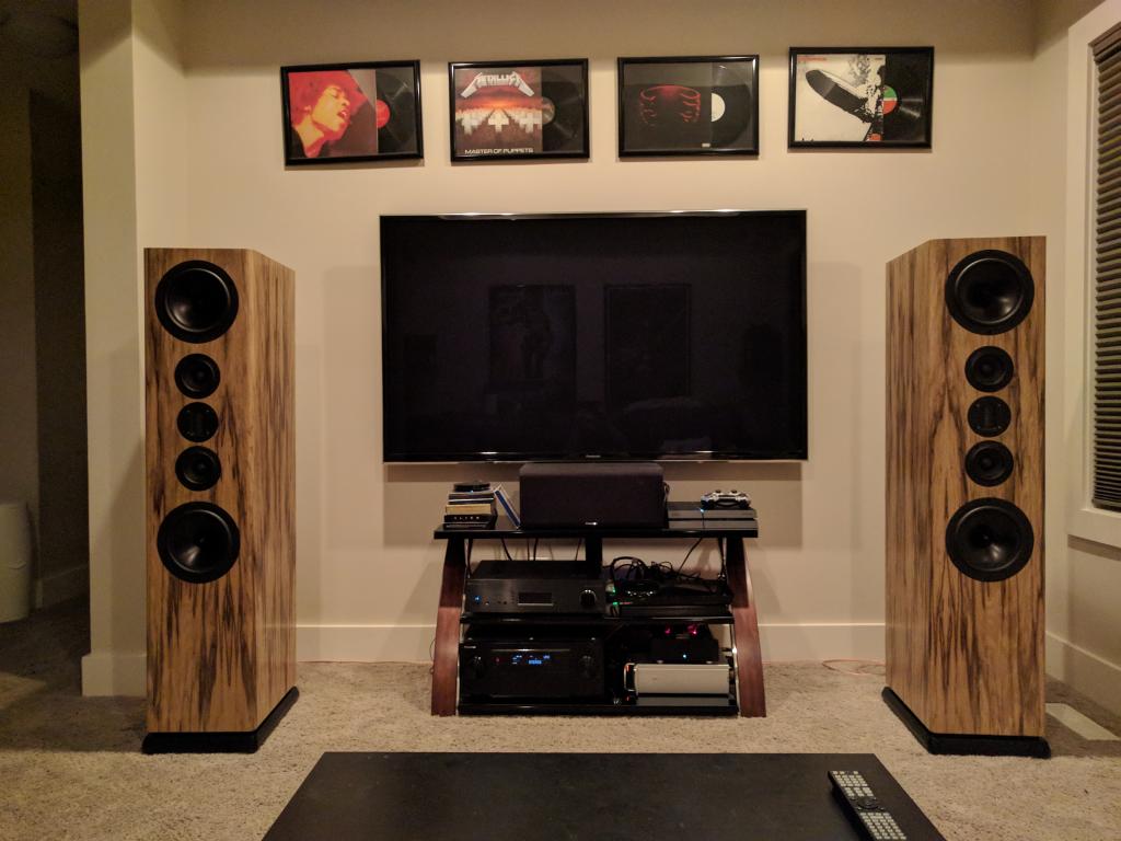

                            Really positive update. Did some A/B testing with the two receivers and the difference between them was significant. The short story is a large step in the right direction, and it's fair to say that I'm much closer to any expectations I had!
                            Longer version; started by comparing CD to streaming from Google play music. Couldn't really tell a difference, maybe if i really wanted to believe but even with fast switching any percieved difference was lost in less than a second.
                            2nd step was to hook up the vsx-1018 to the paradigms with the Chromecast and the sc-1227 to the statements with the cd player. Time aligned the tracks, balanced volume, and muted one receiver. Being same brand one click of the mute would flip the audio instantly. Also handy for a 'blind' test if i didn't look at what device was muted. Listen to a variety of tracks, then swap the speaker leads so the statements were on the vsx-1018 and the paradigms were on the sc-1227.
                            I was surprised that the receiver would have ad much impact as it did. The statements sounded better 100% of the time with the sc1227, and by a lot. With the statements hooked up to the vsx1018 and the paradigms to the sc1227 it was a much closer contest, generally i would prefer the statements but not always. So needless to say the vsx1018 was really crippling.

                                                    Finishing work
                                                    Update: Finally bought and finished the veneer on these!
                                                    I had originally purchased some mahogany veneer and was never happy with how it looked. I setup the speakers and let them sit as raw plywood for about 9 months, I accepted that I was going to pay more than I had first thought for a finish I liked, decided on this black limba veneer.
Name:	IMG_20170928_185525 - Copy.jpg
                                                    I had a rough idea on how I wanted it to look, but mocking up the options anyways
Name:	IMG_20171009_104925 - Copy.jpg
                                                    Veneer was glued on with titebond and an iron, the near speaker has the first coat of water based poly on it. This is the second project that I have veneered, I'm glad I had some practice as I had one almost major whoops, there is a subtle wrinkle on one of the round overs, luckily I caught it soon enough that you cant tell unless specifically looking for it. My last project, I had the same issue and went further making a small wrinkle into a major wrinkle.
                                                    I went with water based poly because I wanted the woods colour to show without being tinted with oil.

                                                    From the back, if I was to do it again I would trim the veneer to run deeper into mid tunnel, as it sits the foam doesn't quite reach the veneer (not that anyone is looking at the back)

                                                    Finished product, updated electronics, updated cabinet, wall mounted the screen, all the little details brought things together. One of my goals was to let the mid tunnels breath as best possible given my small area. I am really satisfied with these as a whole.

                                                      They look stunning! Great work!

                                                        Wow those are really incredible looking - maybe the nicest statements I've seen! Beautiful beautiful choice of veneer and well done.
