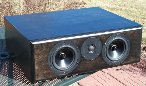

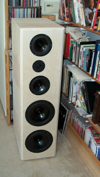

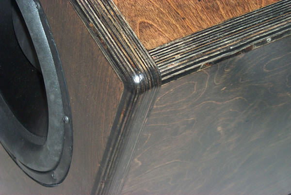

                              The thing is you can build an acoustically dead cabinet but it is going to be very heavy and/or expensive.
                              The thing with BB is it's quite a bit more rigid than MDF, you can push the resonances higher breaking up spans with bracing and kill 'em there more easily. I think. I know it works well for subs, you can have a lighter box that rings when knocked but isn't excited by anything in the intended bandwidth, so it's "dead".
                                All I meant by "prepping" to use hardwood at the corners is all the very careful planning that you would need.
                                That said, I am quit fond of raw birch ply.

                                • JonW
                                  • 1601
                                  Hey Folks,
                                  I'm very glad to hear you all speak in favor of the birch ply. I'd much rather work with that than MDF. :T And yeah, it does look pretty good raw. So maybe I'd get the good stuff and then just add some finish. Or maybe the cheap stuff and try veneer. Not sure yet. Hmmm...
                                  To eliminate cabinet resonances, wouldn't just making the cabinet twice as thick help? Say glue 2 pieces of 3/4" birch ply together. In addition to bracing, etc. That could make for some really solid corners, too, with effectively a 3/4" rabbet. Or does that just make things too big and heavy?
                                    The big towers I did are two sheets of 1/2" laminated for the main box, 3/4 for the baffle (3/4 for bracing).
                                    The bottom pic is a Tumult, which is two sheets of 3/4 laminated and a 3/4 roundover.
                                    I can not imagine how heavy any of that would have been in MDF!
                                    Good bracing goes a really long way to an inert box.

                                          Jon: The big 3-ways are raw, unfinished.
                                          THe light MTM's are tung oil finish.
                                          The dark ones are an ebony stain.

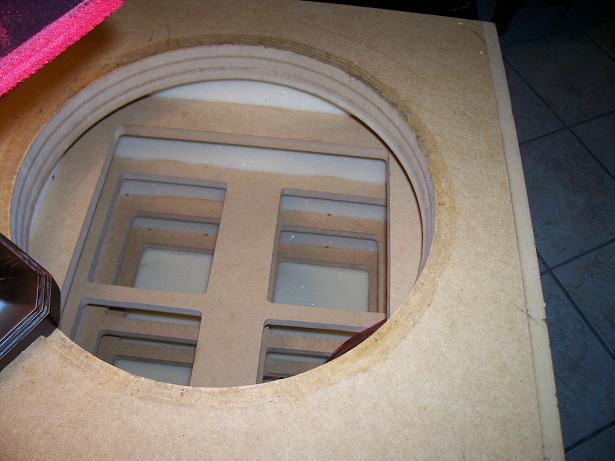

                                              how's this for a dead cabinet...
                                              the enclosure for a Tumult 15". Another 1.5" of front baffle has since been added.
                                              ...our brains and nervous systems constitute a belief-generating machine, a system that evolved to assure not truth, logic, and reason, but survival...
                                              2x15" TC Sounds .45Q sealed
                                              M. Boutte HT
                                              3x15" @ 10 Hz
                                                Thick is good.
