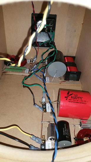

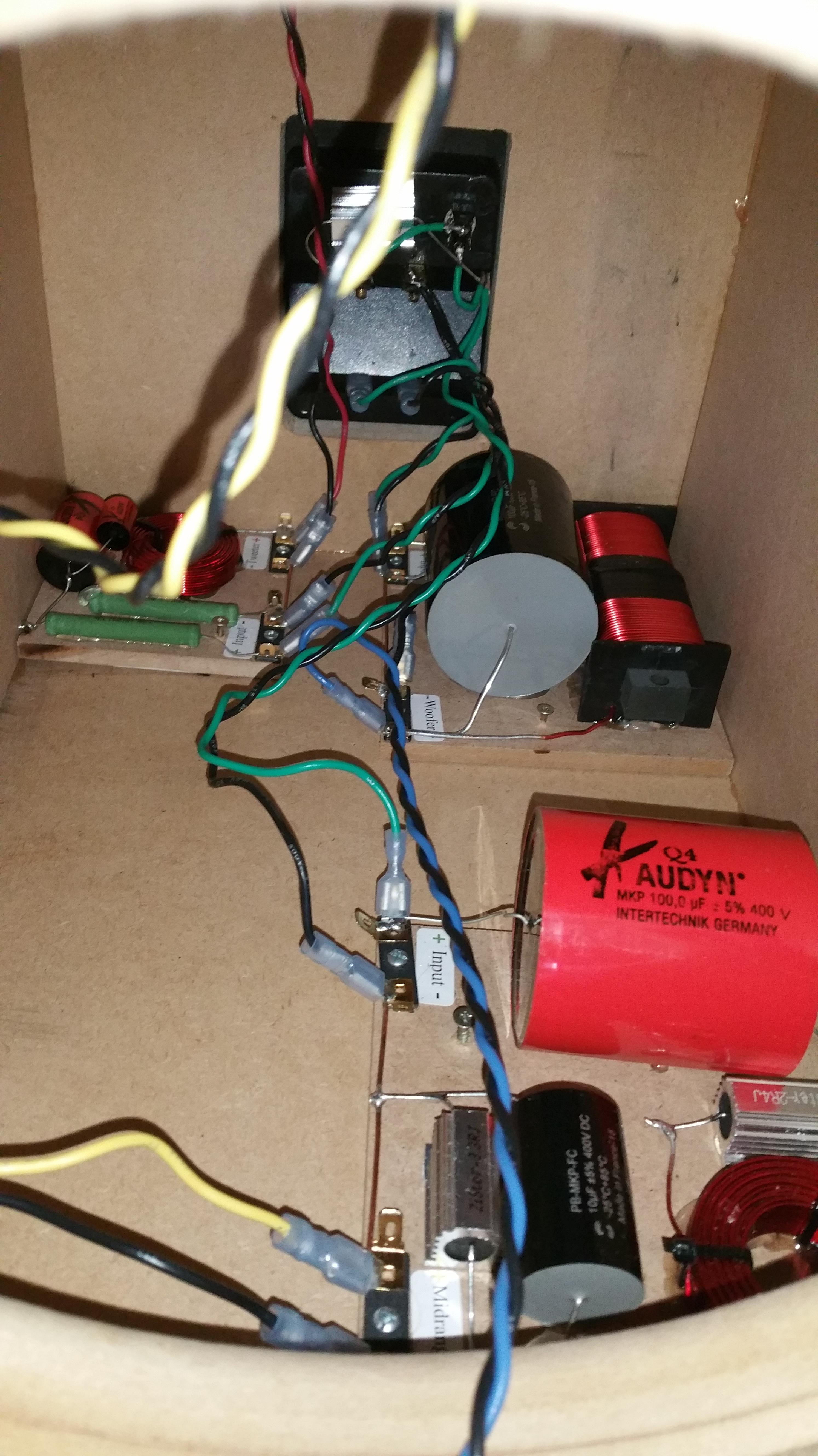

    I would definitely check your crossover. If you post good photos of the crossovers with all the wires on the top so we can see them clearly, I'm sure we can check them. You might also have a bad solder joint or something. I always just twist my crossovers together for testing and then after completely done do the final soldering. You may need to unsolder things and redo, but post the picture and then we can go from there. I'm curious about the Near/Far resistor and how you have this wired. Might be the first place I check.

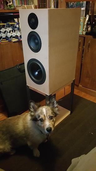

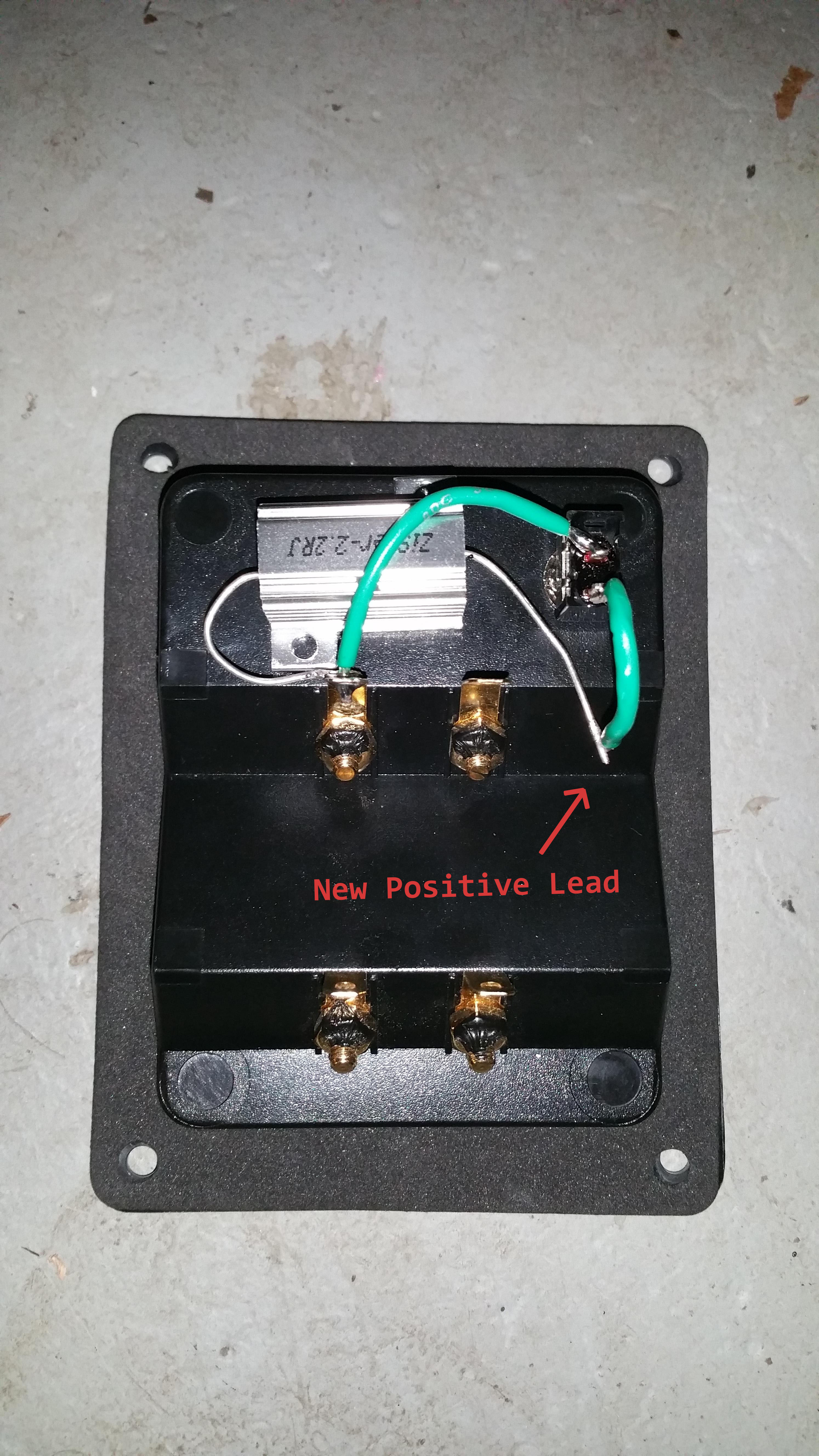

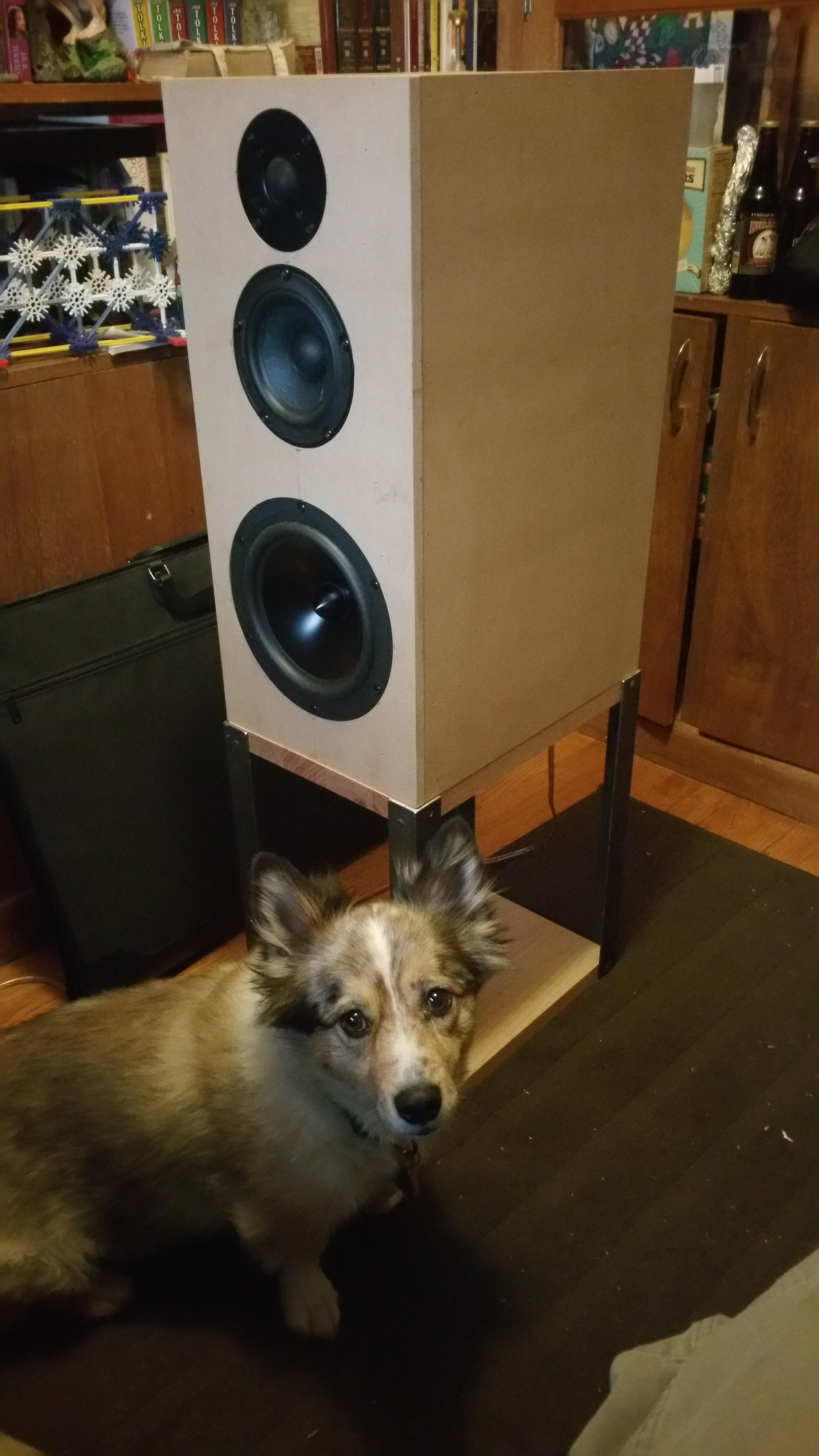

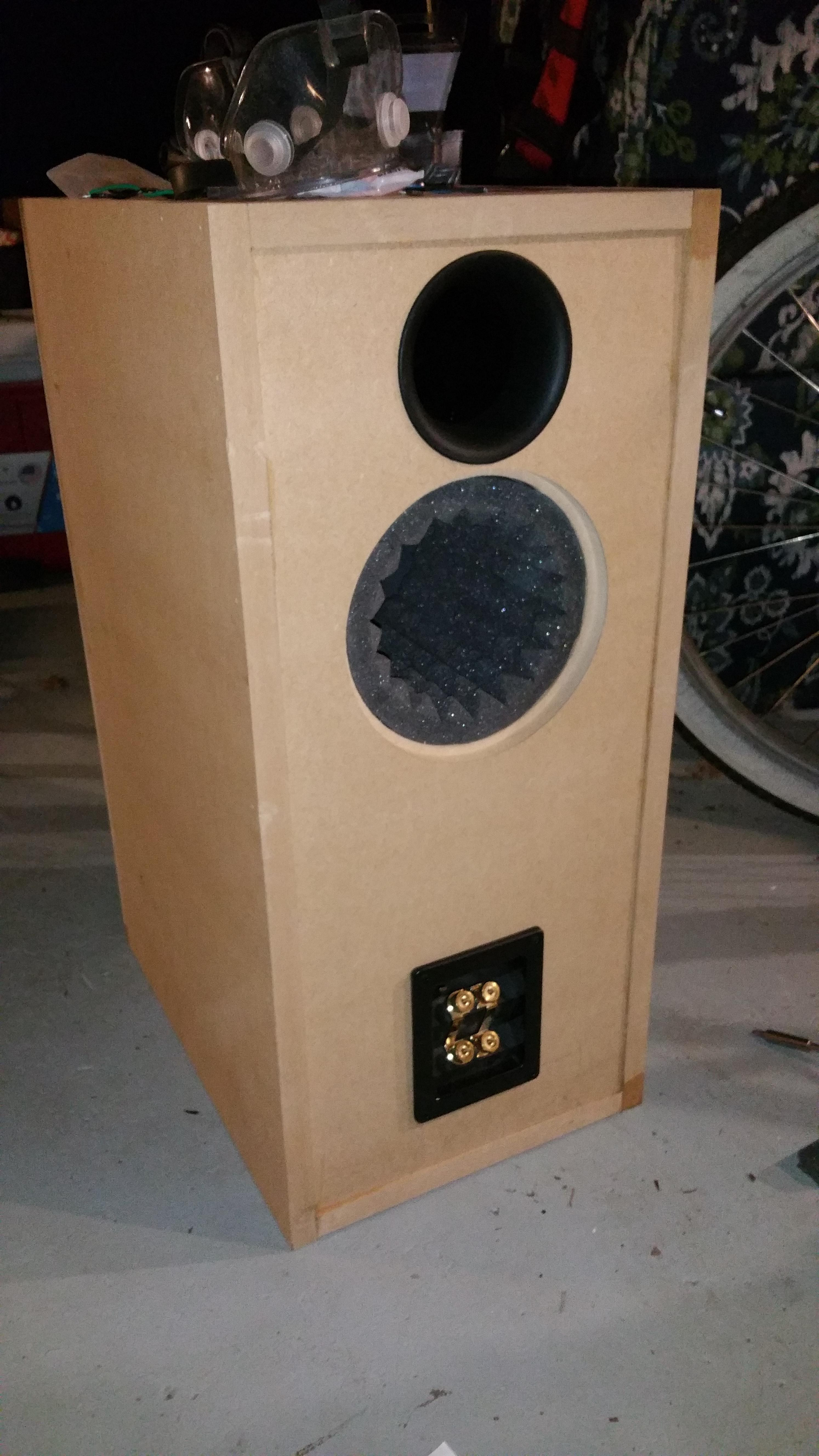

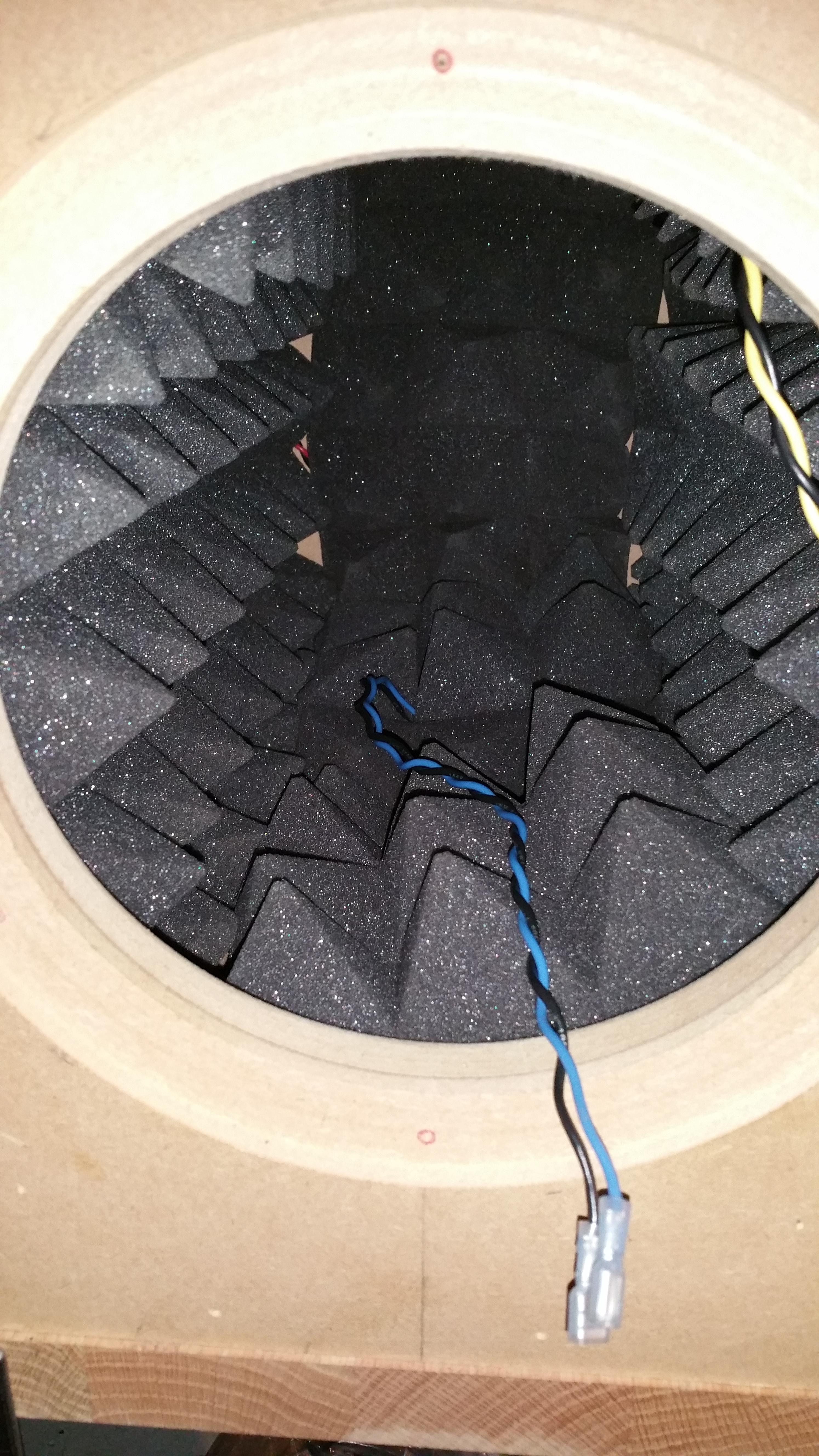

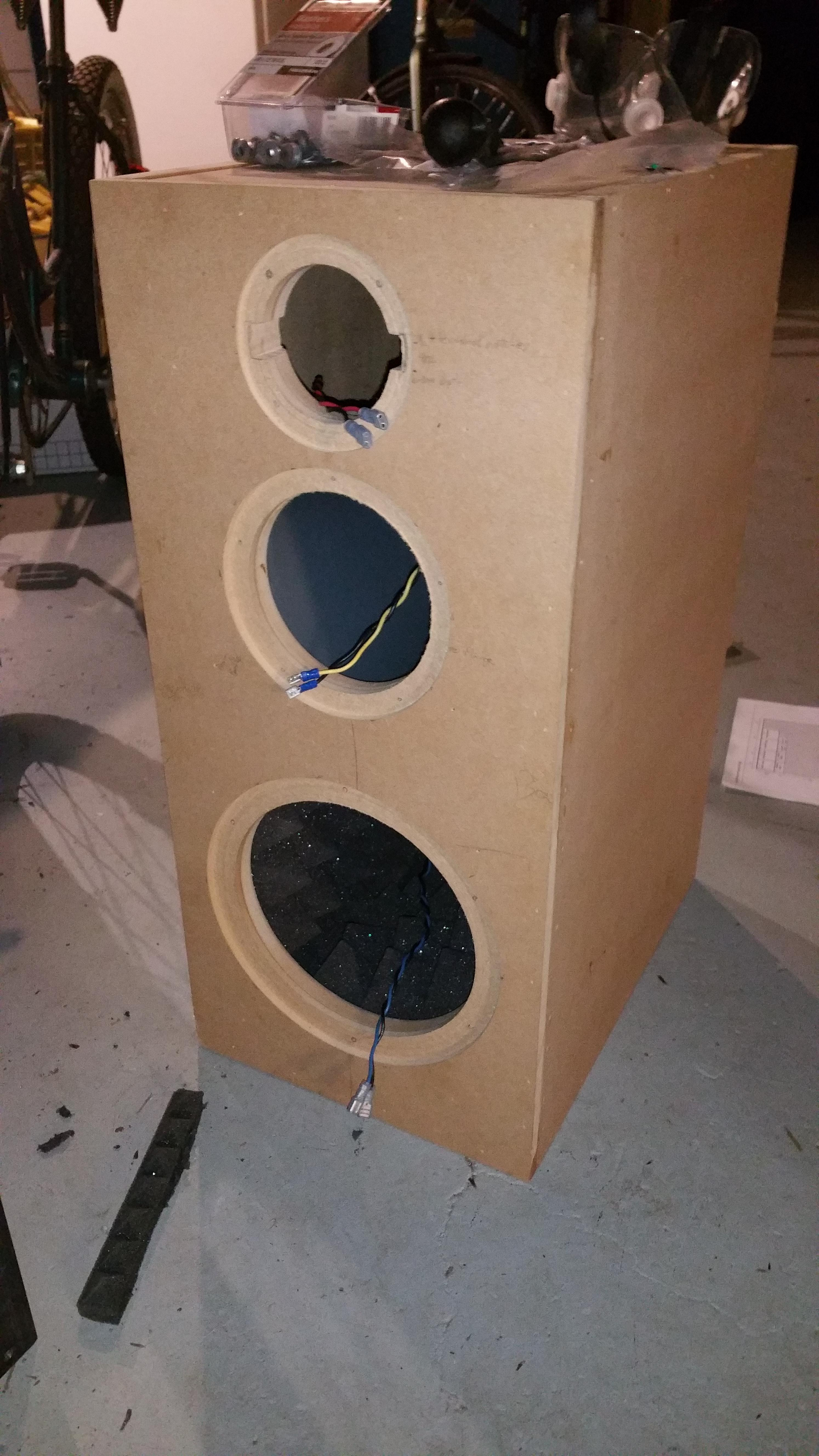

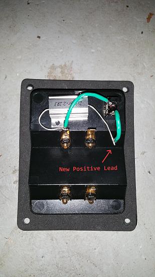

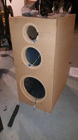

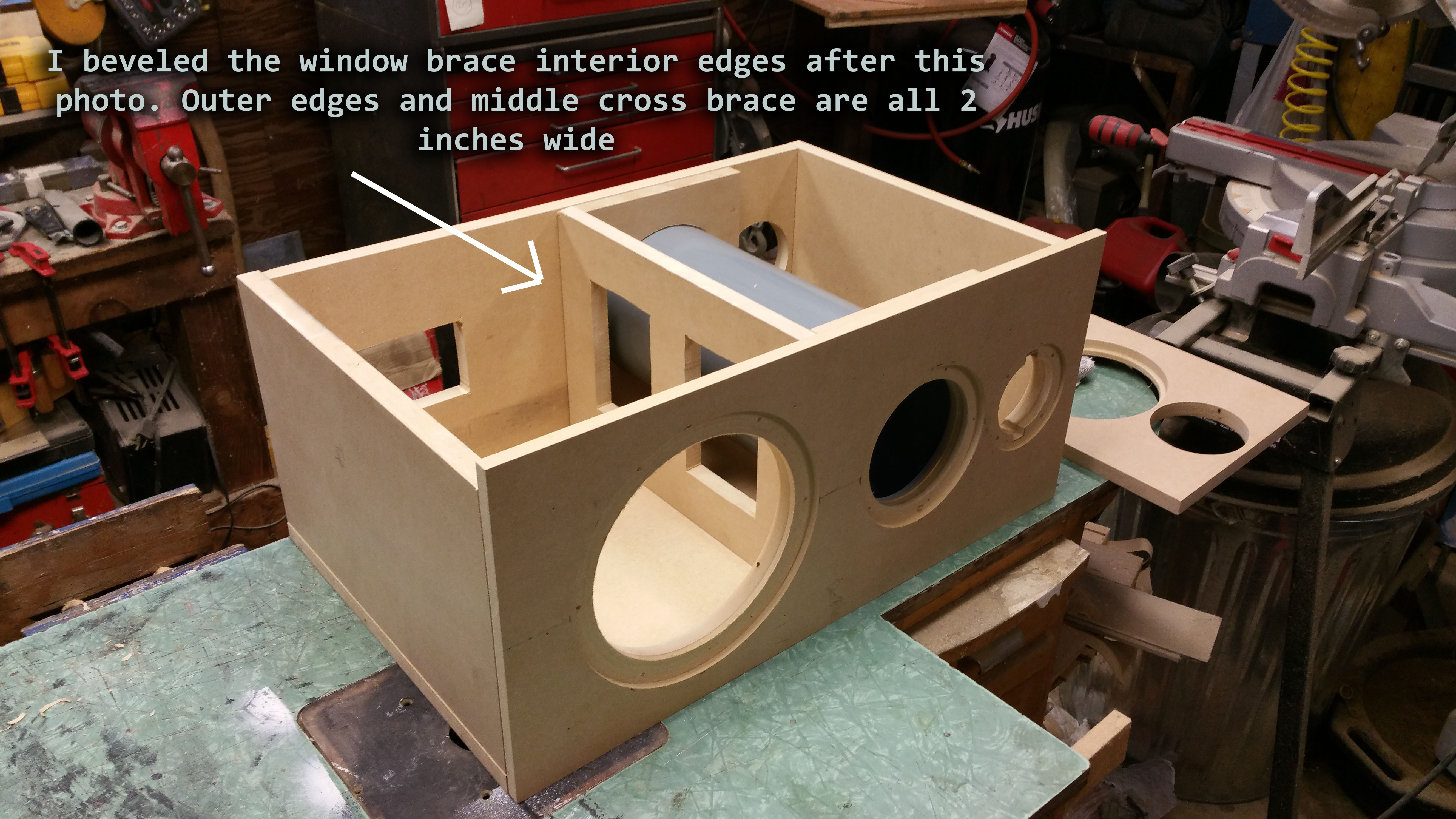

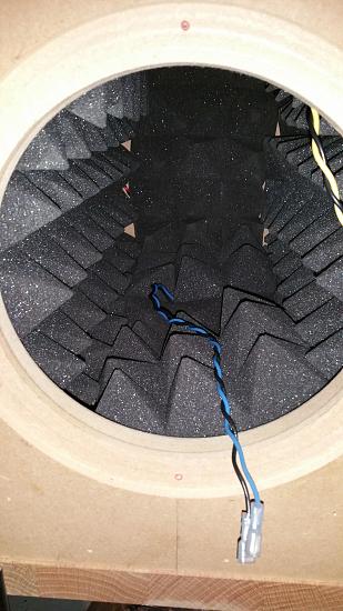

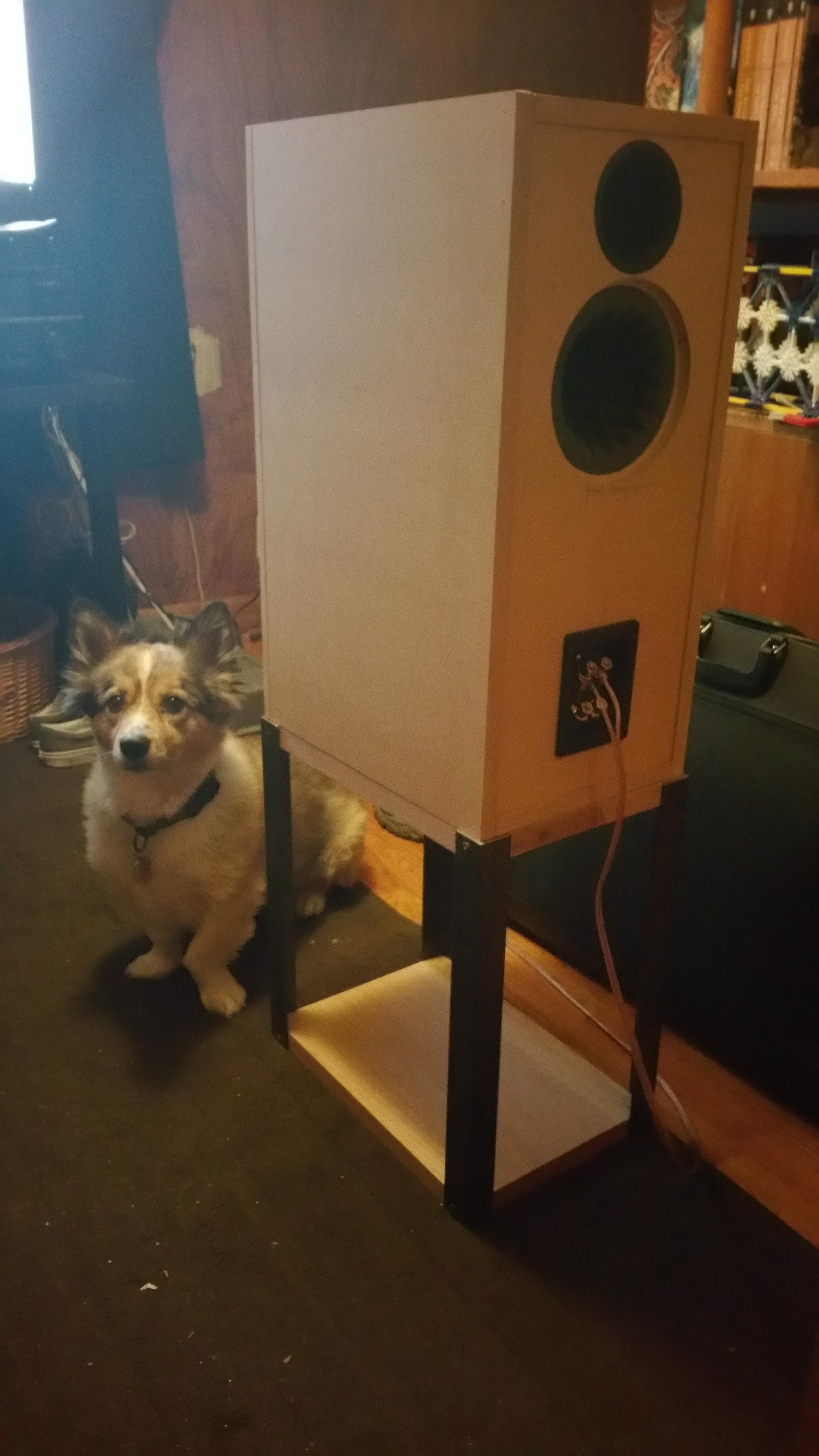

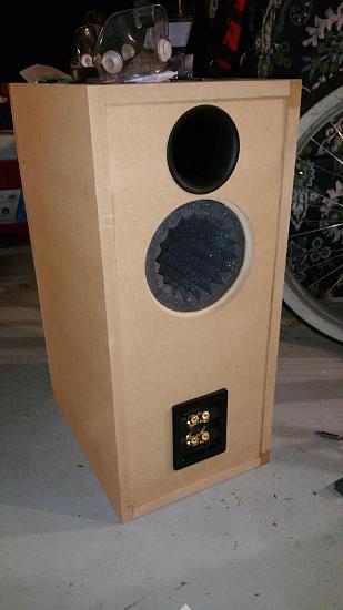

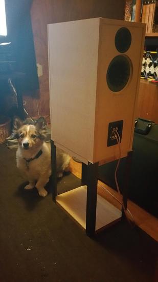

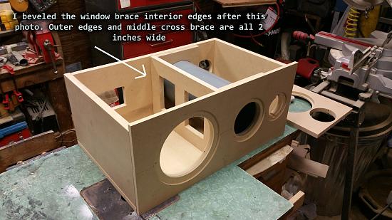

            Thank you all for the replies - attaching some pics but I'll need to get some better ones of the crossover. They were built by meniscus and look pretty good so I'd be a bit suprised if that was it. I will try to move the foam fill next - might be too close to the woofers. Both speakers sound the same so if I messed up, at least I'm consistent :P
            Will pull out the crossover asap and get a better photo - took this during the build.

              Thanks for the pictures. However, I can't see the switch from the front but I assume you have a 2 pole switch that either routes the mid/tweeter crossover through the resistor or bypasses it depending on the positioning and whether or not the mid tunnel is plugged for close wall use.
              So, that brings the question. Can you hear a difference in volume from the mids when you flip the switch? In one position they should be louder (resistor bypassed) which would be for close wall mounting to keep up with the reinforced bass and when flipped to the other position the mids should have less volume which would route through the resistor for normal positioning.
              I'm curious what the purpose of the bi-amp binding post plate is?
              Everything else I can see looks very good. They should have excellent if not chest pounding bass.
                I can't see how much if any foam you have around the window bracing. To get the deep bass from the port, you need good air movement from the woofer area up around the mid tunnel to the port. The gaps around the tunnel are small, so make sure nothing is stuffing it up.
                I'm not sure I understand how Curt's near/far switch is working or supposed to be wired. So, I don't understand the binding post photos. I need to study the wiring diagram further.
                I'm guessing Meniscus did your crossover right, but I thought I read a couple times on the internet that they had a mistake or something. I don't know if I'm remembering it right. But, they are human and can make mistakes late at night too. So, it is worth a little effort to double check.

                  -Foam wasn't blocking window brace holes - also tried with some of it removed and it didn't have much of an affect.

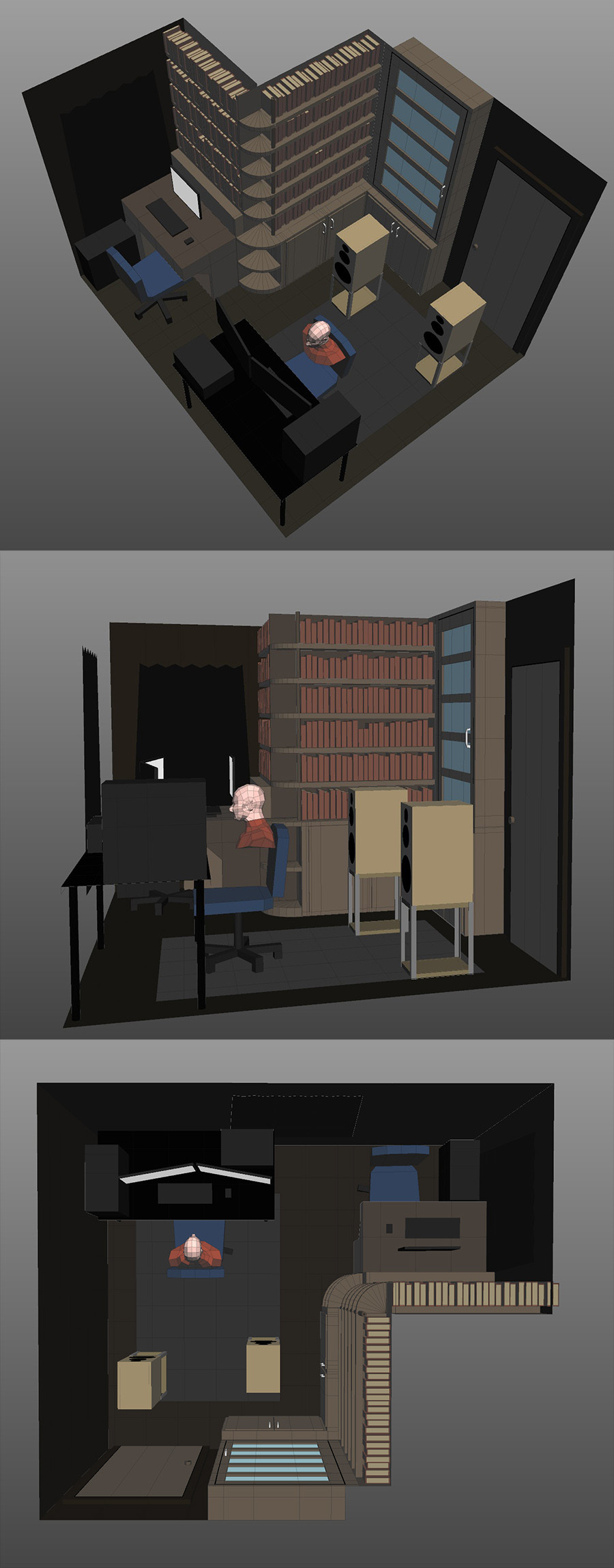

                  Here's a quick 3D scale model of my room / speaker layout. Not great but they still sound fantastic in here in closed mid mode.
                  I'm looking into acoustic treatment for the room, or even better - move and get a bigger office
                  I'll also finish the exteriors soon.
                  Thanks for all the tips and advice everyone. You guys are great.
