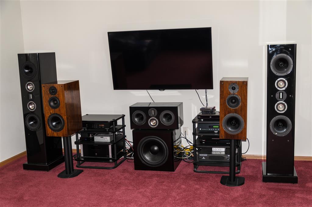

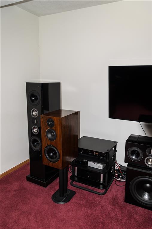

        Well, we took these to PewterTA's house yesterday for a real audition since I have no where to put them in my current place. There were 5 of us listening to these from both a brand new Yamaha receiver, then connected to a Rotel amp. The source material was lossless tracks from a central music server connected throughout the house. As a direct comparison, downstairs lives a set of sublime B&W 802 Diamond series speakers hooked up to a bunch of Rotel gear playing the same server sourced tracks. (Not a fair comparison, I know....) Both the Finalists and the Yamaha have less than 20 hours on them.
        I had planned on doing a small review on their sound. However, since I left them at PewterTA's house so they could break in I have decided to keep my comments to myself until I can go back after some time. I am interested to see if I can hear a speaker break in in the first place. After my second visit I plan on not only reporting their current sound, but also the differences, if any, that I perceived after they have gained some playing time. I am looking forward to this totally non-scientific experiment.
          They Rock. Enough said.
          Actually we will be doing a full review here soon after some "break-in" and a little more proper speaker placement. We all agreed so far that they are very sensitive to room placement. Which due to current networking and cable connections in the house, caused the speakers to be in a not so optimal position. I'm hoping to get time to run the network and cable over to a different wall....but I have some work to do to figure out the top plate positions and if I have any potential blockage (horizontal bracing in the outside wall). Once I do that, I can definitely move things.
          Course I'm not opposed to have a 25' network cable and RG9 cable running across the floor for a little bit... hee hee.
          But since Michael didn't hear them in the corrected positions I might not move them until he at least hears them one more time before the move.
            Poor Michael, he backs down from no challenge yet sets his performance standard so high.
            Just as Kermit struggled with his outward tinting, so to, does my V, V good & special friend, Michael, battle his demon of perfection demanded from everything he does.
            Not only does he require the brutal honesty of Dan (PewterTA) & my criticism after his Finalists’ were gentility transported down to Dan’s house yesterday for audition (where they now reside for a few hundred hours of break-in), but the reference system for their comparison is comprised of B&W 802di’s & a modified Rotel RMB-1090 amp.
            Michael’s Finalists’ were pared to Dan’s new Yamaha rx-a820 receiver. After an initial evaluation, we also by-passed the internal amp in the Yamaha, routing the line-level signal from the Yamaha’s DAC through Dan’s modified Rotel RB-1080 2 ch amplifier. Thusly arranged, Michael’s Finalists’ took full advantage of the tighter cone control that tightened up the bass significantly & the sweeter hi-end frequency that added some detail sparkle. In other words, these speakers deftly & honestly revealed all the improvements the modified 1080 had to offer compared to the Yamaha’s still respectable output.
            Michael has set his expectation bar quite high (as usual). While he may initially feel he has not hit his mark, from my standpoint, I find these Finalists’ quite the impressive product of his creative imagination, building skills, execution & sound quality.
            Prior to getting into the ‘how do they sound’ part, I first must comment on the esthetic & build quality. To be brutally honest, Michael’s description of his initial concept just did not ring true for my personal taste. I am quite the traditionalist, despite having great appreciation for the bold, creative & modern. Hey, I love Andy Warhol. I just do not want to live in his museum.
            But then yesterday, I saw them, up close. I could smell them. I could sense them; feel the ‘vibe’ they give off just sitting there. These things sing before you put any power to them. The corners are so clean, so sharp. As multiple planes of real carbon fiber meet to form edges so straight, so crisp, so perfect they could cut your retina quicker than a laser just by looking at them too long. The fit & stitching of the coal-black leather is immaculate. The fit, the form, the presence they command in the room is one of strategic purpose, not a bling-bling boy-racer wanna-be that in all sincerity I was afraid I would see once Michael’s creation made its debut. But knowing Michael as I do, I should have known better. These things are serious. Stunning. The concept……. The choice of materials……… the execution…….. All are are such that I have only ever seen at a true ‘craftsman’ level. I could easily live with these. And though they would not blend well at all with the interior décor of my listening room, they certainly would not degrade or cheapen it. I think the best compliment was from one our friends who arrived later & commented how handsome these were & asked, “Just what brand of speaker are those?”
            I can not imagine a better complement.

                                            I've been playing with my Finalists and Statements the last few days. Here are a couple pictures of how they're positioned. No rocket science, just plopped them on stands next to the Statements and hooked them up.
                                            Keep on listening and posting feedback!

                                                      Right now, I'll have to snap a picture when I get home tonight, I have them about 6' to 7' apart and if I had to guess, I'd say about 14"s or so from the wall. I have the switch in the "less midrange" position because the mids were just over powering. Since I put in the cotton fill (which I'm only using half of what I'd do, about half the tube filled) that has lowered the "stand out" of the mids and moved them slightly behind the speakers. I know some of this is room placement as I'm going across the shorter side of the room vs. the length of the room like I should be doing. It's because I haven't wired that wall yet for streaming. I also wanted to leave them there since that's where Michael heard them before.
                                                      They keep getting better and better and heading in the right direction in my opinion! Just got to take more time. I am very surprised on how power hungry they are. I have to go +10db over any other speaker I have to get the same volume....so it definitely takes some power to make these sing!
                                                        I know the RS28A is slightly different than the RS28F, which I don't think is the problem. Then the highs sing, they really sing well. And it's the same driver that WKHanna has in his NatPs, so I know the driver itself can produce the highs. I really still think it's a lot to do with breaking in.
                                                          Here's where I got them sitting that they sound the best so far. They are about 9 to 10"s from the wall. If I pull them out more they really get a very forward presentation that I don't care for. Right now the sound stage is just behind where the speakers are, which I like. I'm sure I could do more with them if I had them going from right aiming towards the left in the picture as that's the length of the room.
