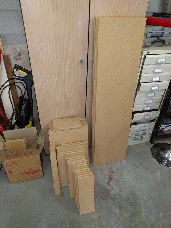

    After finishing my first pair of speakers (Zaph's BS3), I thought I'd step up and build something more challenging.
    I've read a lot of great things about the Statements, and decided to jump straight in. I bought the components (including pre-assembled crossovers) from Meniscus Audio, and found a wood supplier who would pre-cut (but not do holes and routing) the MDF I need. Because they sell 32mm MDF (I'm in Australia - everything's metric over here), I decided to use these instead of gluing together 2 sheets for the baffles.

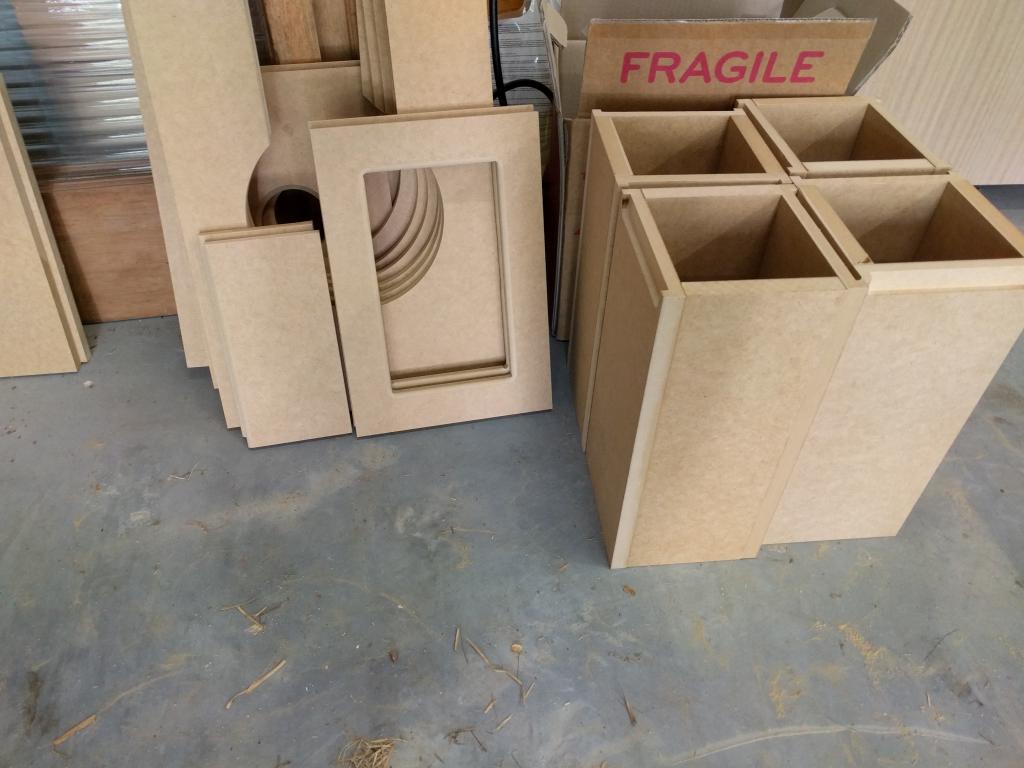

    I got the mid channels up first

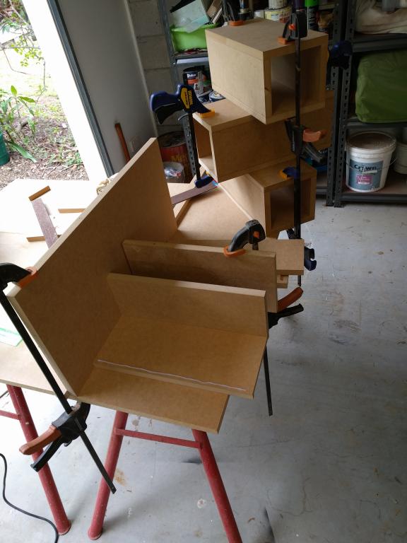

    And assembled them, and the braces:

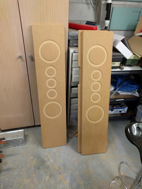

    I had a few attempts at the baffles (whoops), but eventually got them looking approximately correct:

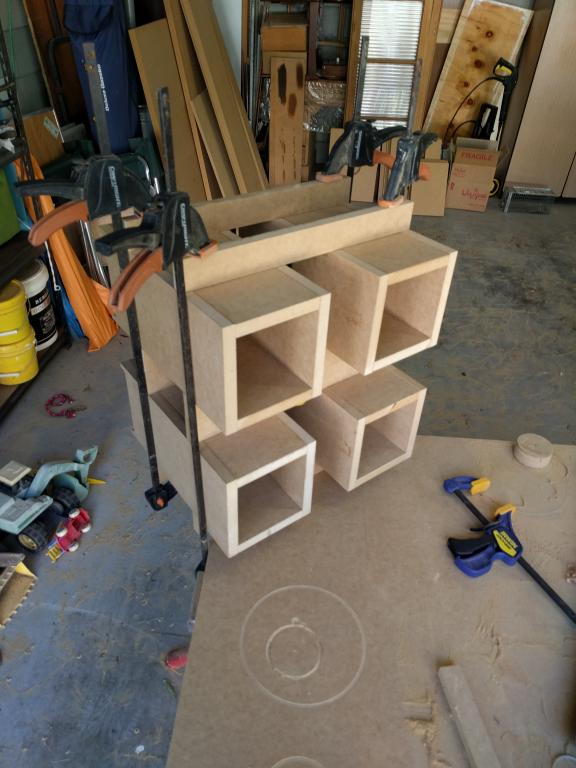

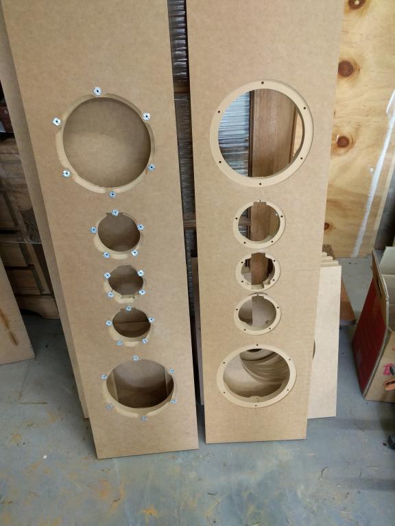

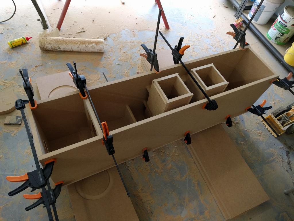

    Today, I've started putting the boxes together, and have finally finished (I hope) cutting the baffles - trimming them down will come later of course.
    I'll update this thread as I continue these things (it'll take a while), but a question for now:
    I have wooden floors at the moment. I'm thinking that I will felt the bottom of the speakers, but should I raise them? (and by how much?). I've cut a fairly big channel to the back under the port. In short, I'm not quite sure what to do at the bottom, and am happy to take suggestions.
      Welcome to the open participation in the forum, Chupa. Keep the progress pictures coming.
      The port needs some room to breathe. A channel in the bottom and speakers only raised off the floor by a layer of felt will affect the port tuning, and the restricted area could cause chuffing. I'm guessing Jim and Curt will chime in on minimum, but I'd say you want to give it the same breathing room as if mounted on spikes, say 30-40 mm minimum. You can use rubber or wooden feet to eliminate marring your floors. Something about the usual practice of spikes on pads seems counterproductive to me.
        Welcome to the Statements family! Bob's advice is spot on. The base tunnel really opens it up so the port can breath but getting it off the floor will eliminate any possibility of chuffing. I've been using these rubber feet when I needed to protect the floor. They're inexpensive and work well. The link is to the USA Amazon website but I assume that they are also offered in your country.
        The build looks great and I really enjoy the great documentation and pictures.

                Oh, and make sure to glue in those hurricane nuts! I can't tell you how awful it is when one of those comes out of the wood, you're basically screwed. I've seen some people use epoxy, and others just use a blob of glue to hold them in.
