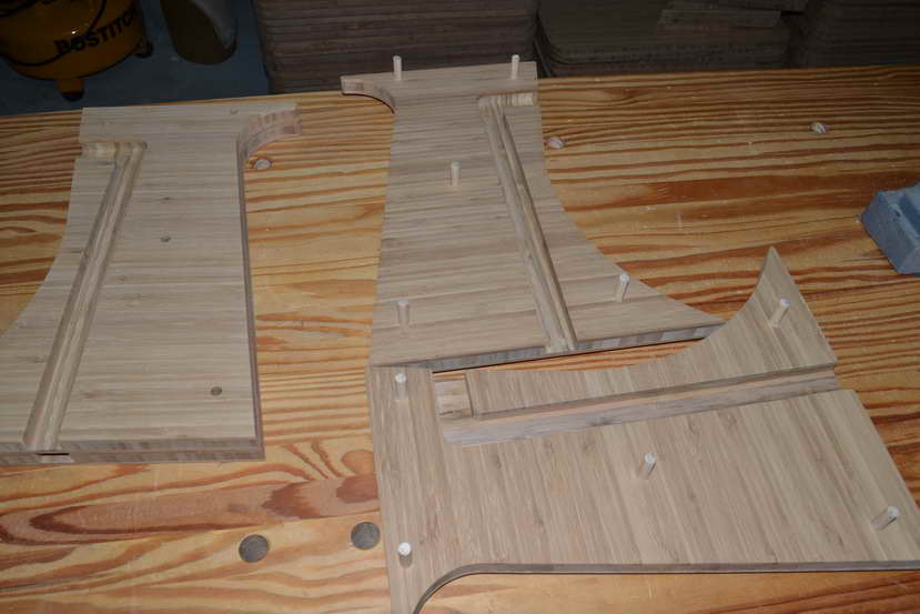

      Yep, the first part of the process this afternoon was cutting dowels to length to make sure of that alignment ..... still you always wonder if you got the drawing right for those hole locations!! 8O

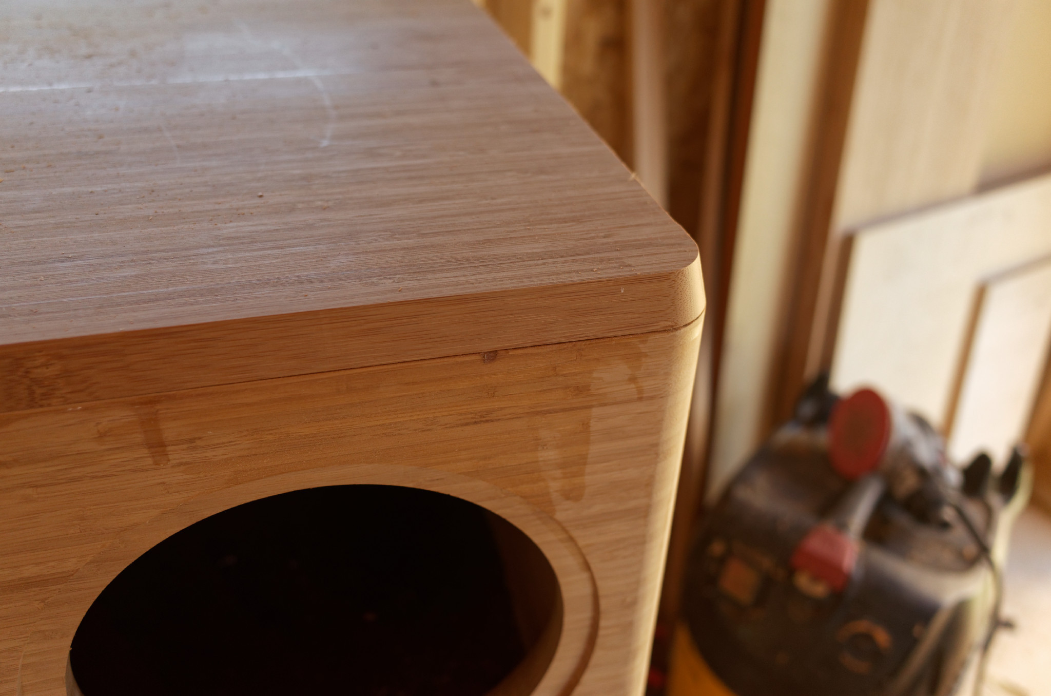

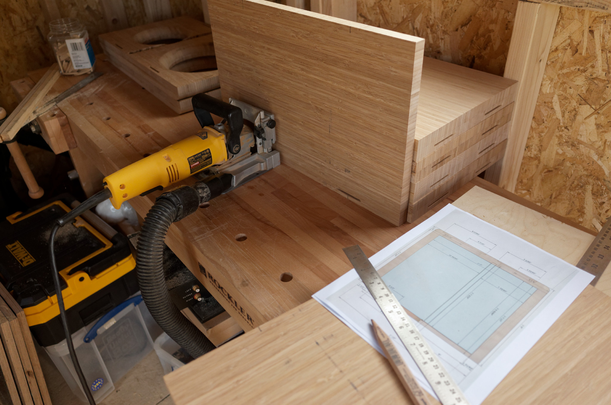

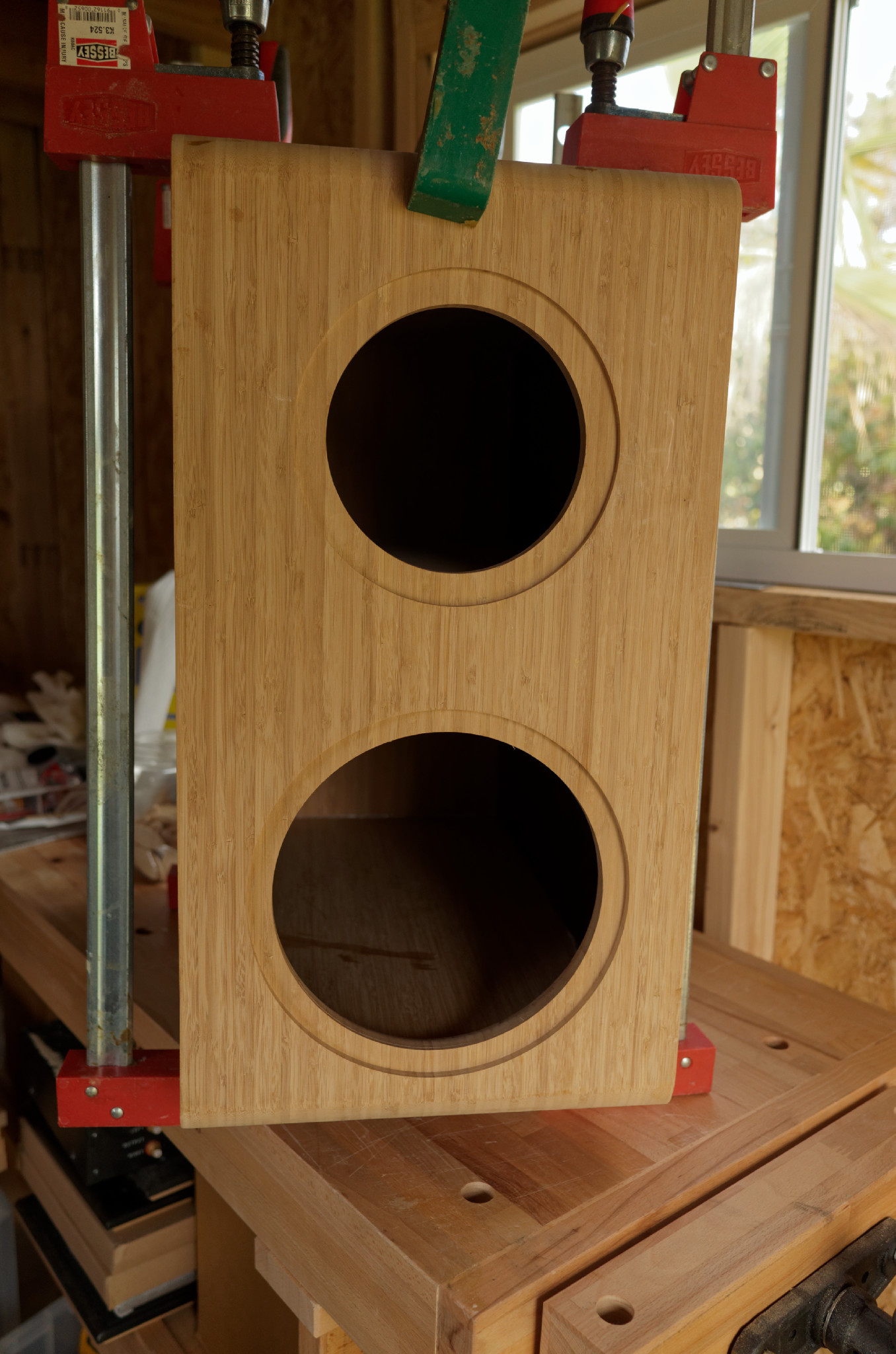

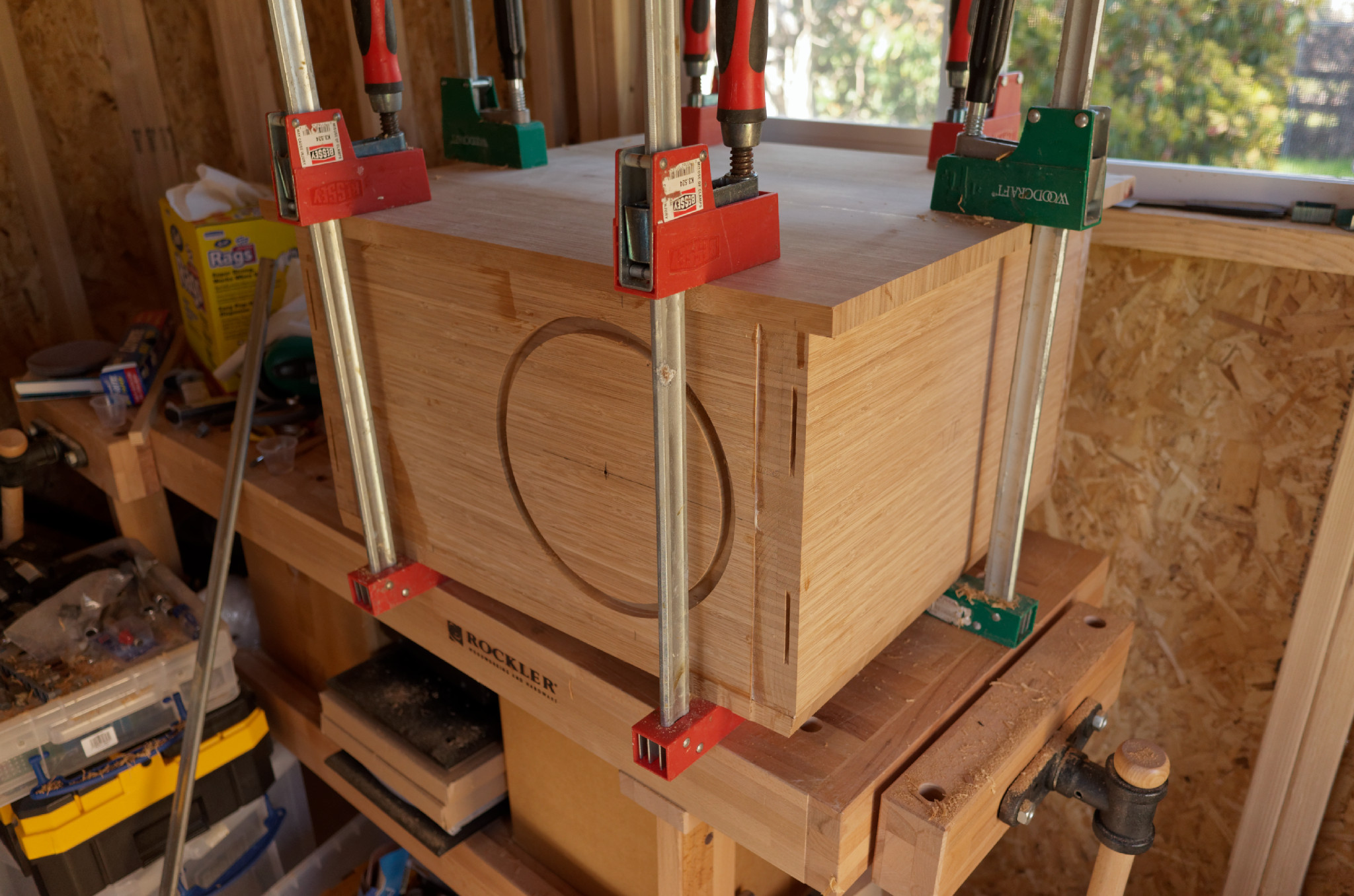

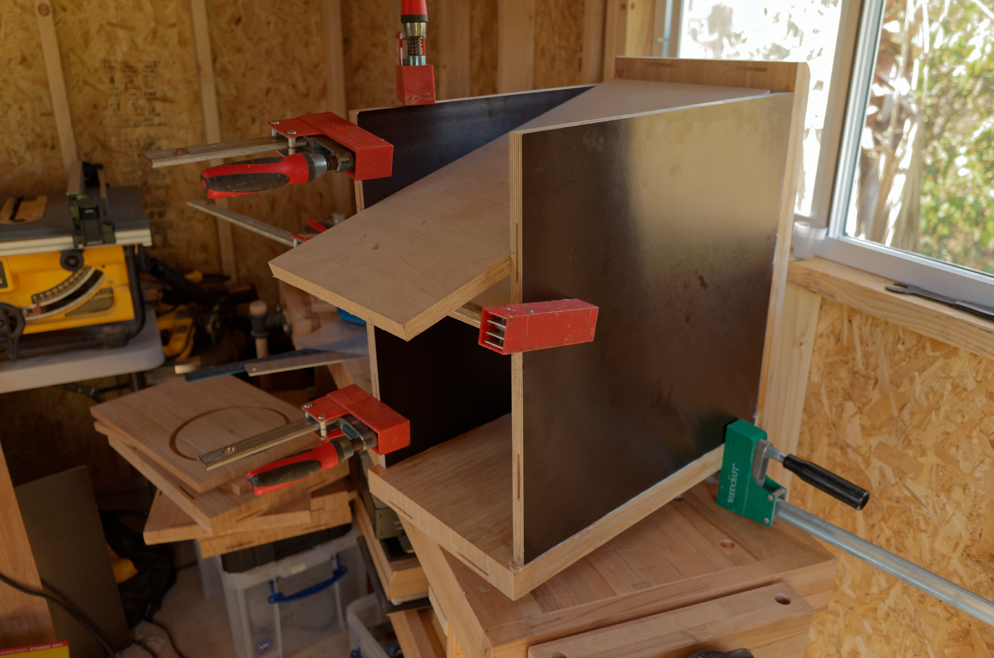

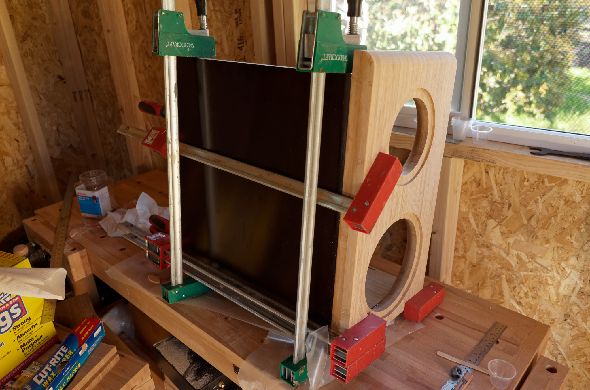

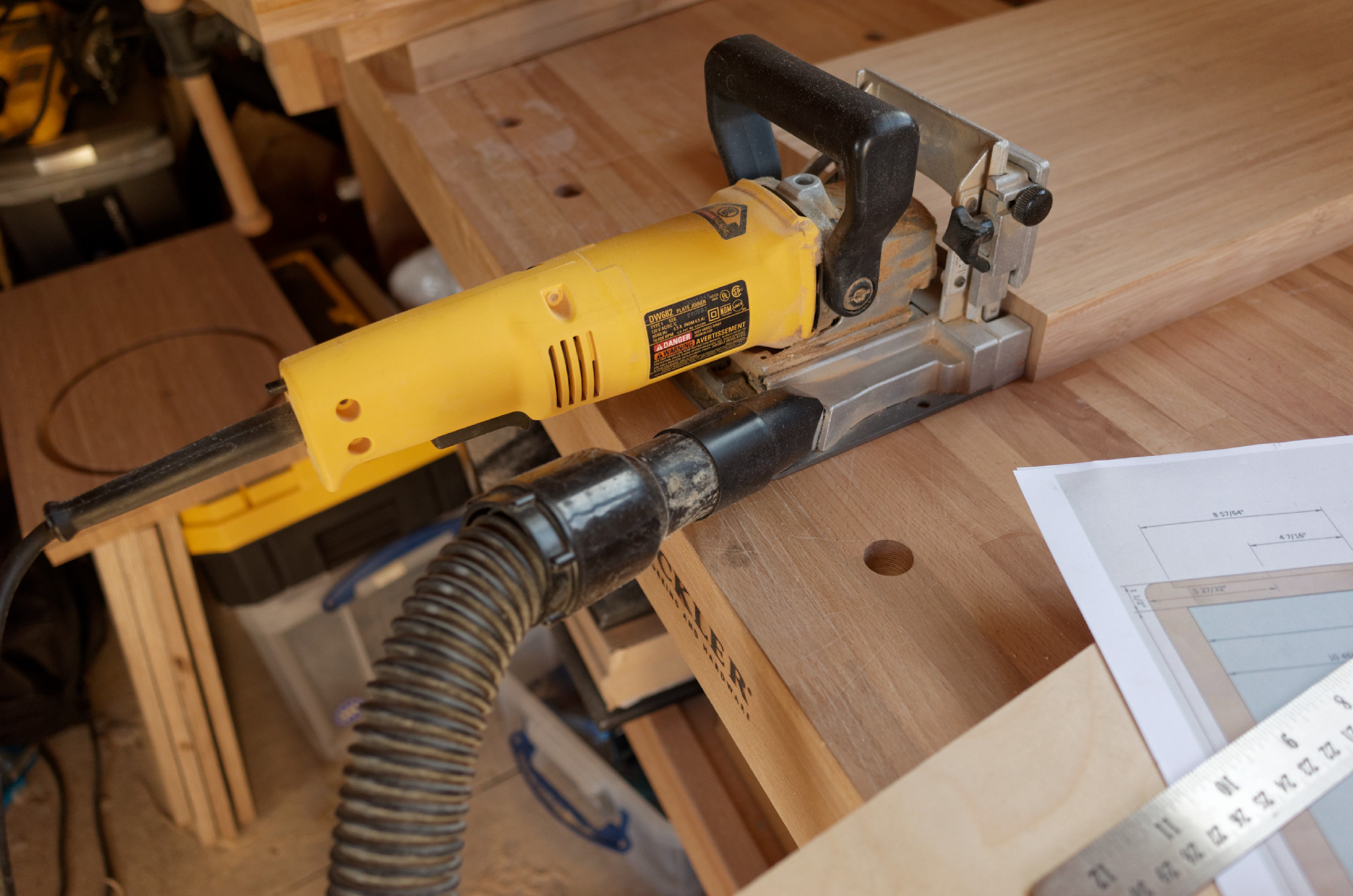

                      well, as I've been a good boy and got up EXTRA early today to start back at work (emails) I'm taking a small break now to post a backlog of pictures before my next conference call at 10...
                      Ah, this is all so horribly old school, my apologies, but it's the only way to get the second level acoustical prototypes put together! (at least out here!)
                      This picks up from finishing up some of the piece parts, such as the work on the front panels previously shown. Now, I've actually got to finish up the last bits for the front panels, which is routing a locating rebate in the back side of the front panel for the front to rear compartment brace to fit in (separating the midrange and woofer compartments).

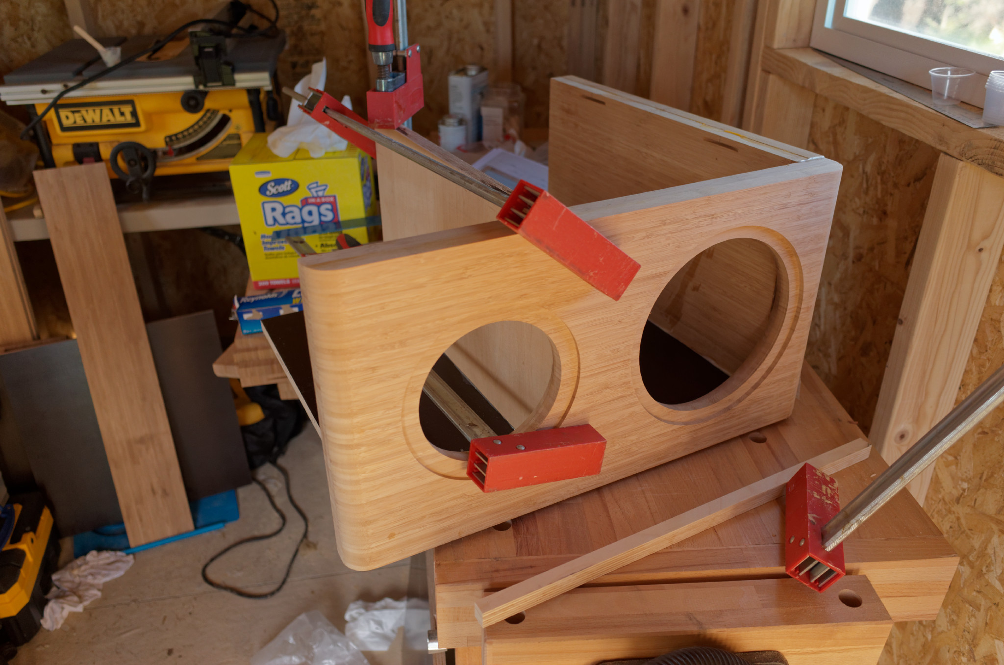

                      Then the next steps were cutting biscuit slots for aligning the gluing operations of the various pieces- trusty DeWalt biscuit jointer gets the job done, with dust collection by DeWalt too. (there seems to be a pattern there, regarding DeWalt and I)

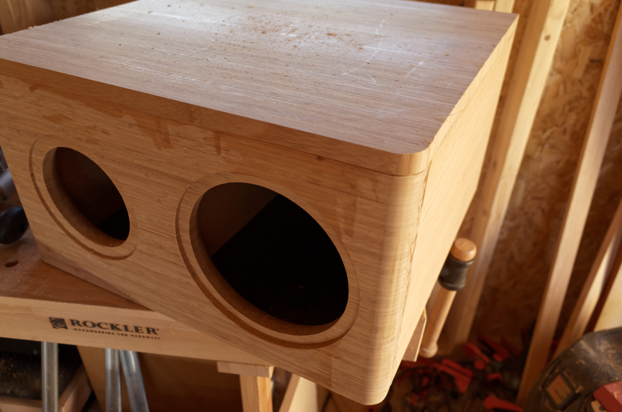

                      Impromptu panel support and alignment...

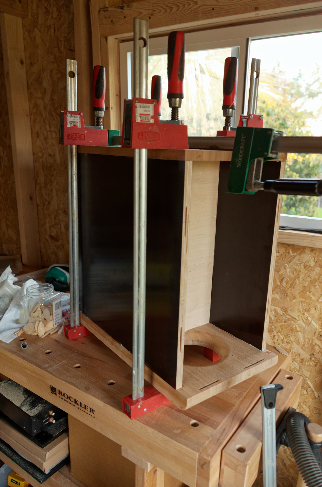

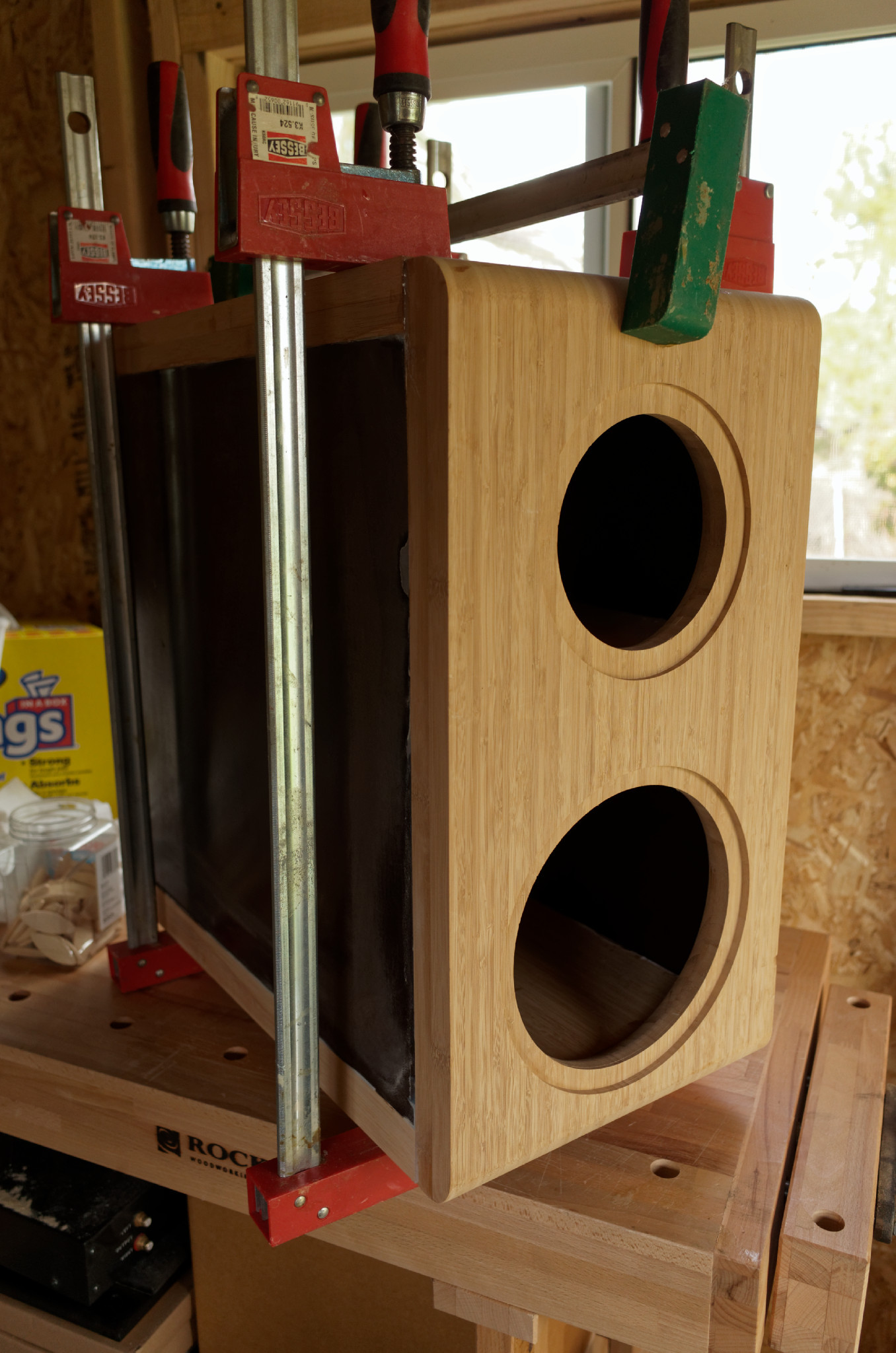

                      Now the real fun begins, gluing up the first three pieces, a bottom, side panel, and front. Should have started with the top panel, ideally, as any misalignment is more visible with it. The black side piece is BB ply with phenolic veneer for tooling- had it around, didn't want to order more. It's the inner side, actually, an outer panel of LBL will cover it.
                      Next up is the center divider baffle gluing.
                      Followed by another side panel

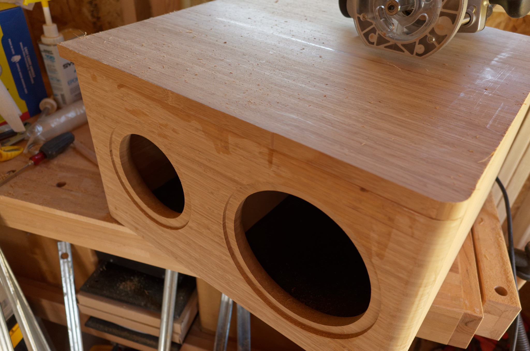

                      After that, the back panel- only single thickness LBL, as the midrange doesn't put much pressure on it, and the bass section is mostly a hole for the PR, with very short LBL spans.
                      Then the top panel...
                      Now doesn't this just look like a slightly over grown mini-monitor from the front?

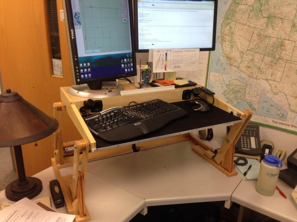

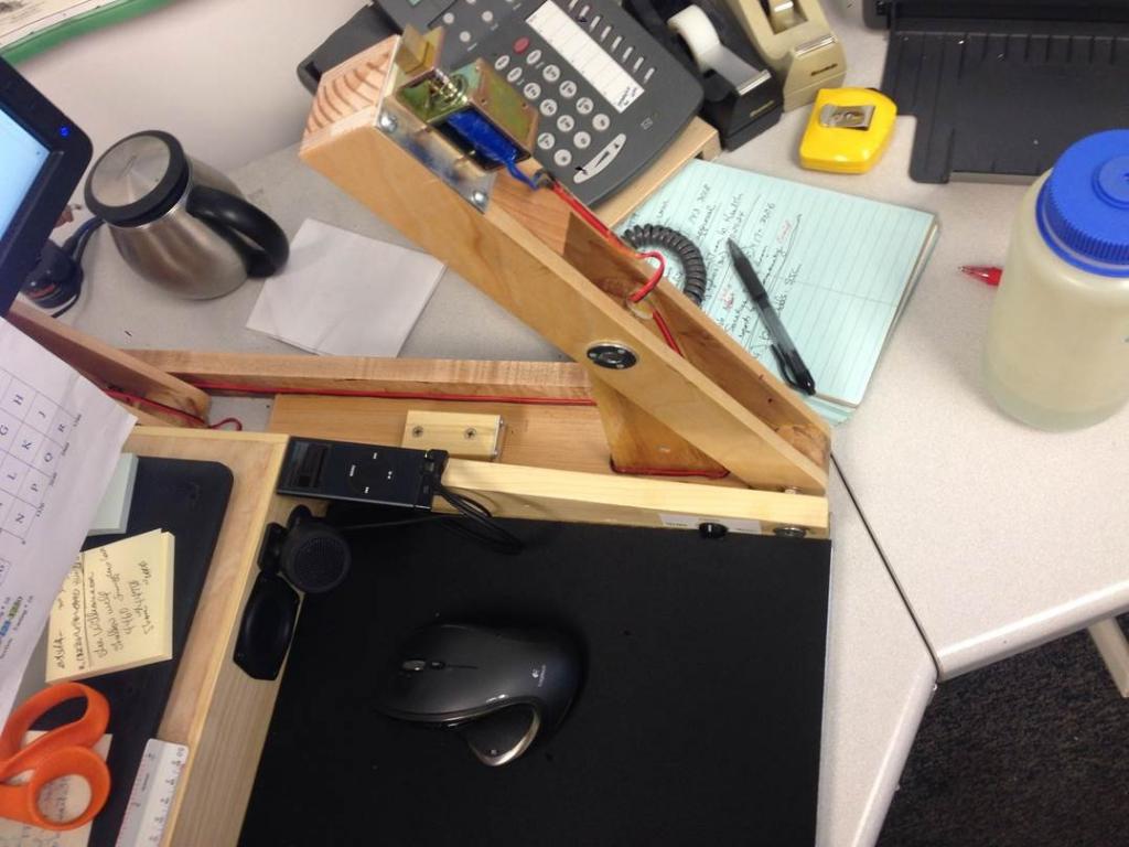

                            well, this has been a very productive Sunday, on NECESSARY, not FUN productive things.
                            <snip>

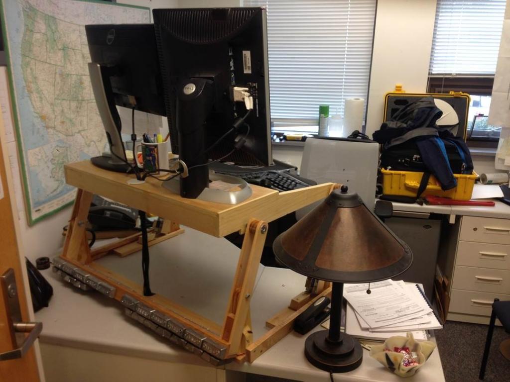

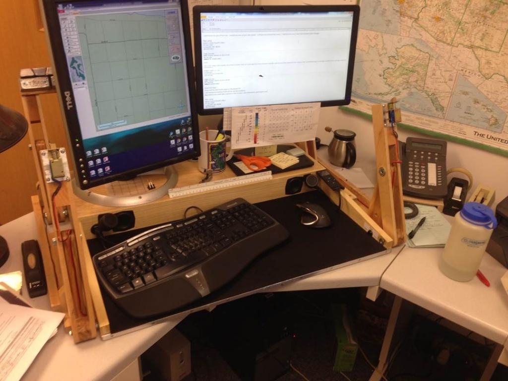

                            Oh, and yes, that is a bamboo desk, actually one of those motorized sit/stand models. I love it... good tools will always serve you well!
                            Since were on the subject of sit/stand desks, here's my version (manual) that I recently finished. It comes complete with a built in speaker system (so it's legit to post here):
                            Desk in the “up position” from the front:
                            Desk in the up position from the back, note the 45 lbs of counter weight:
                            Down position from the front:
                            Lifting column showing the electric latch, button release for latches is to the right of the mouse, on the side rail. Right channel speakers are on the vertical panel:
                            The speakers are Dayton Audio ND65-4, and a pair of really cheap 'aimable' piezo tweeters. Subwoofer sits behind the desk. This really became something of a challenge for me to see if I could make it work, not sure I’d do it again. Woodworking is a bit rough but functional.
                              • 16166

                              Pretty slick for home brew- did you come up with the design?
                              • IslandHydro
                                • Jan 2016
                                • 21
                                #195
                                Thanks, Yeah I designed it from scratch. It was a somewhat iterative process as I didn't realize how heavy my monitors were, but in the end it all works fine.

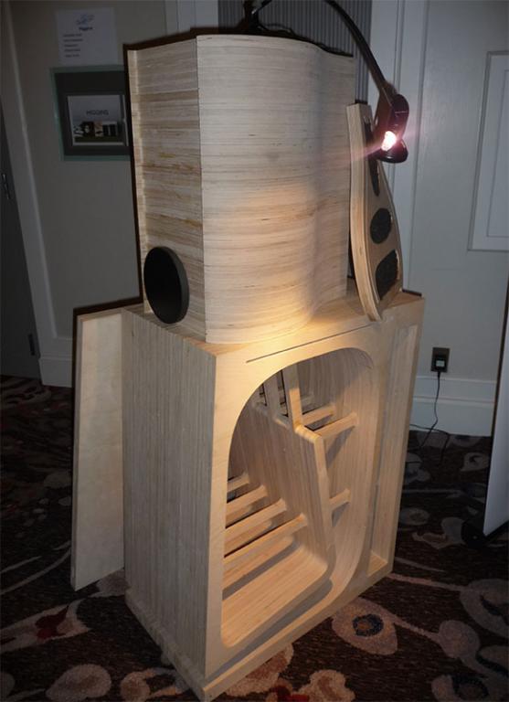

                                                        I should have put a winky in that last post I made... because I know! It was sort of a leading comment, you might say... imaging doing an even bigger speaker that way just beggars the imagination, for me. Which is why I never tried a translam construction in the past.
                                                        You mean something in this size category ......

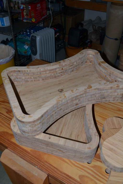

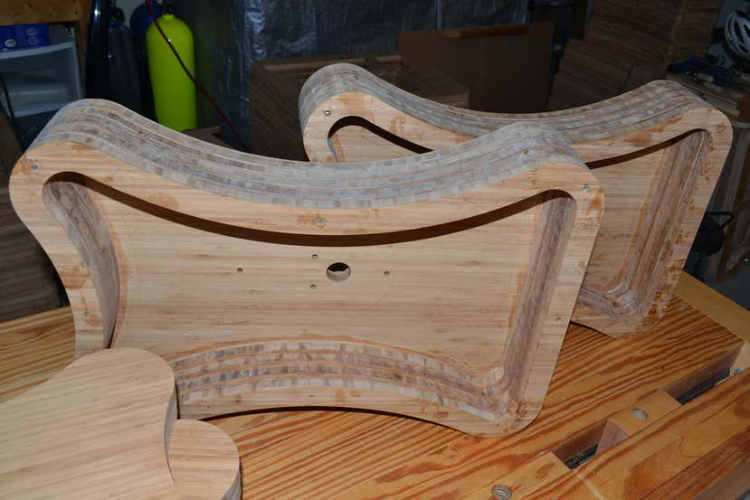

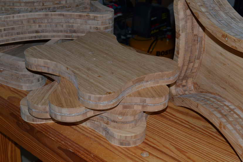

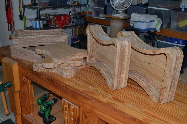

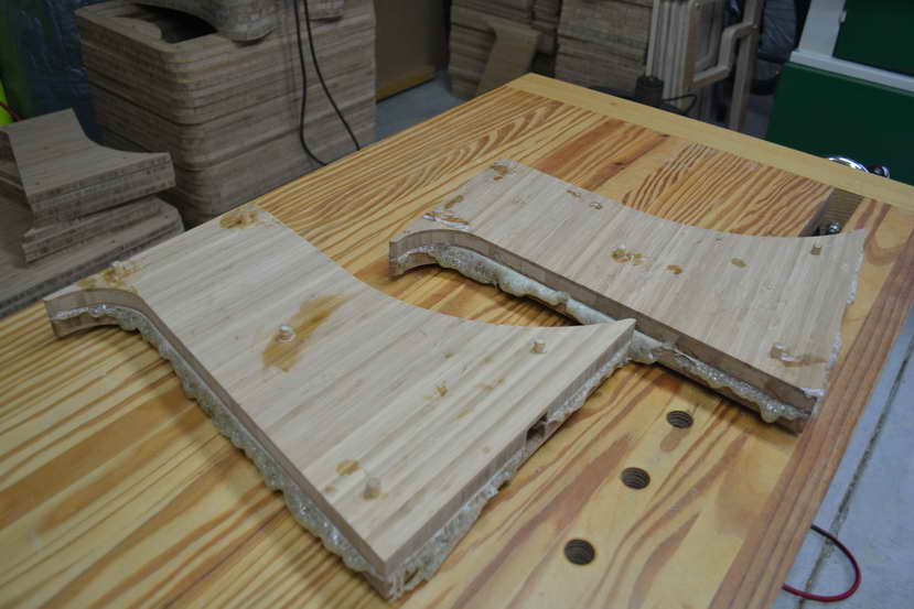

                                                              Small update ..... got the stand tops and bottoms (crossover compartments) glued up. Even with the alignment pretty good, as hard as this lbl is, sanding is still going to be a bit of a chore ....... 8O
                                                                • 16166

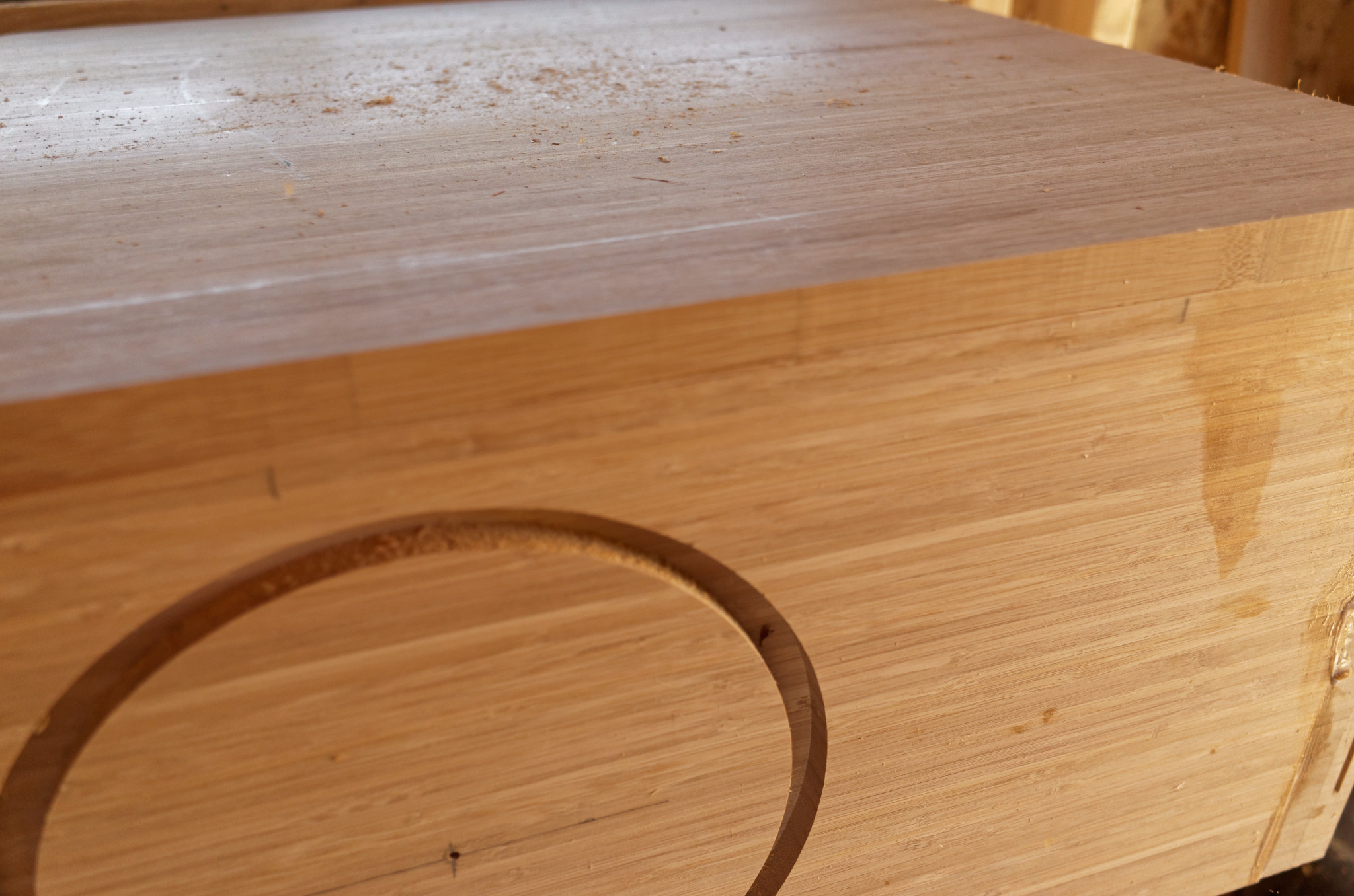

                                                                #211
                                                                Nice looking pieces...
                                                                In theory, this stuff is about 30% harder than red oak, to put it in perspective.
                                                                I'm almost through with work stuff for today, hope to be by 1:30, then may go out and make a little saw dust...
                                                                • bobyoungren
                                                                  • Aug 2015
                                                                  • 29
                                                                  #212
                                                                  With the mix of end grain and face grain it is really hard. A sharp card scraper would probably help get the edges smooth. Once I learned how to get a good sharp bur on a scraper it really cut down on the use sand paper in my shop.
                                                                    • 2140

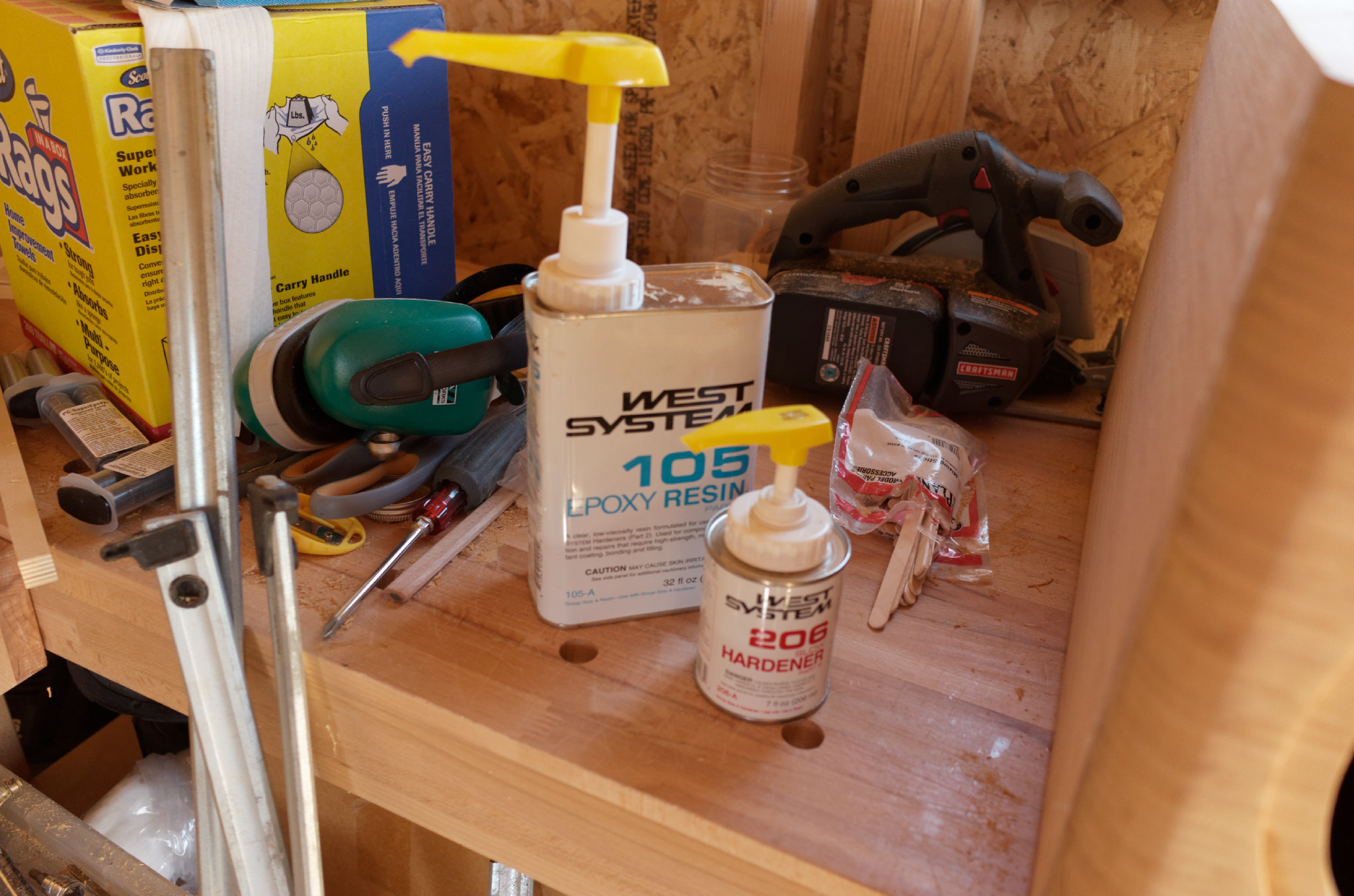

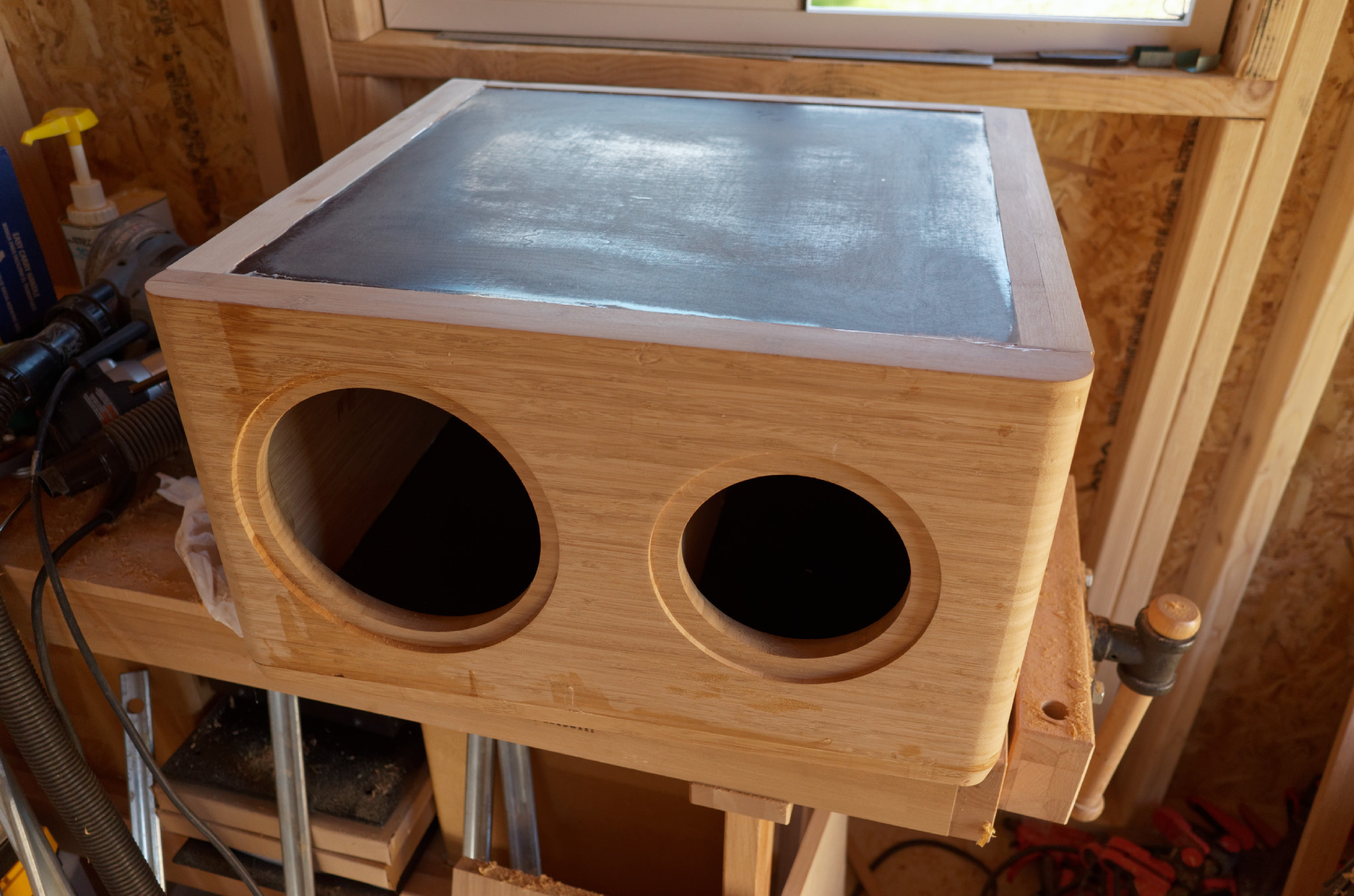

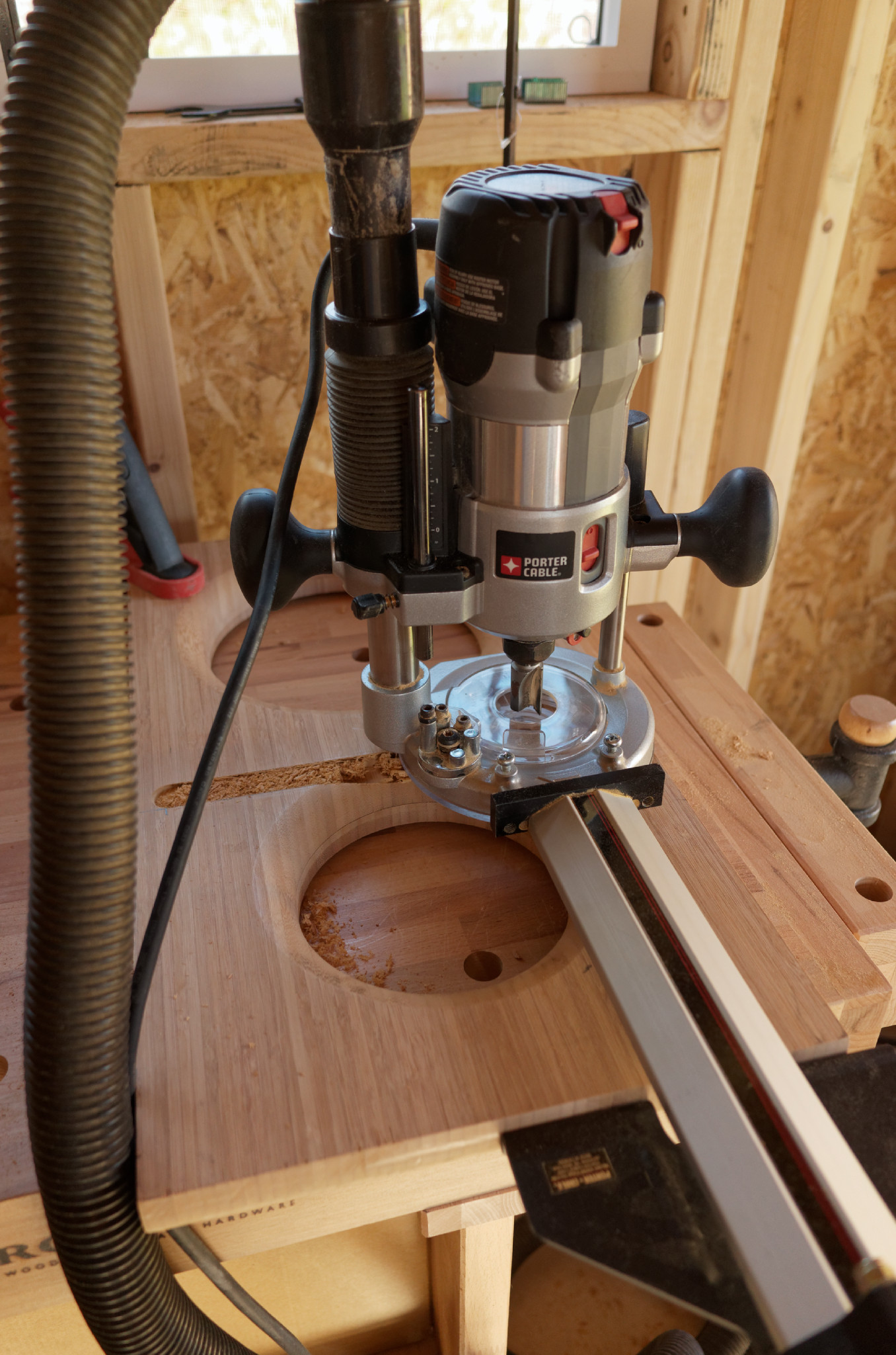

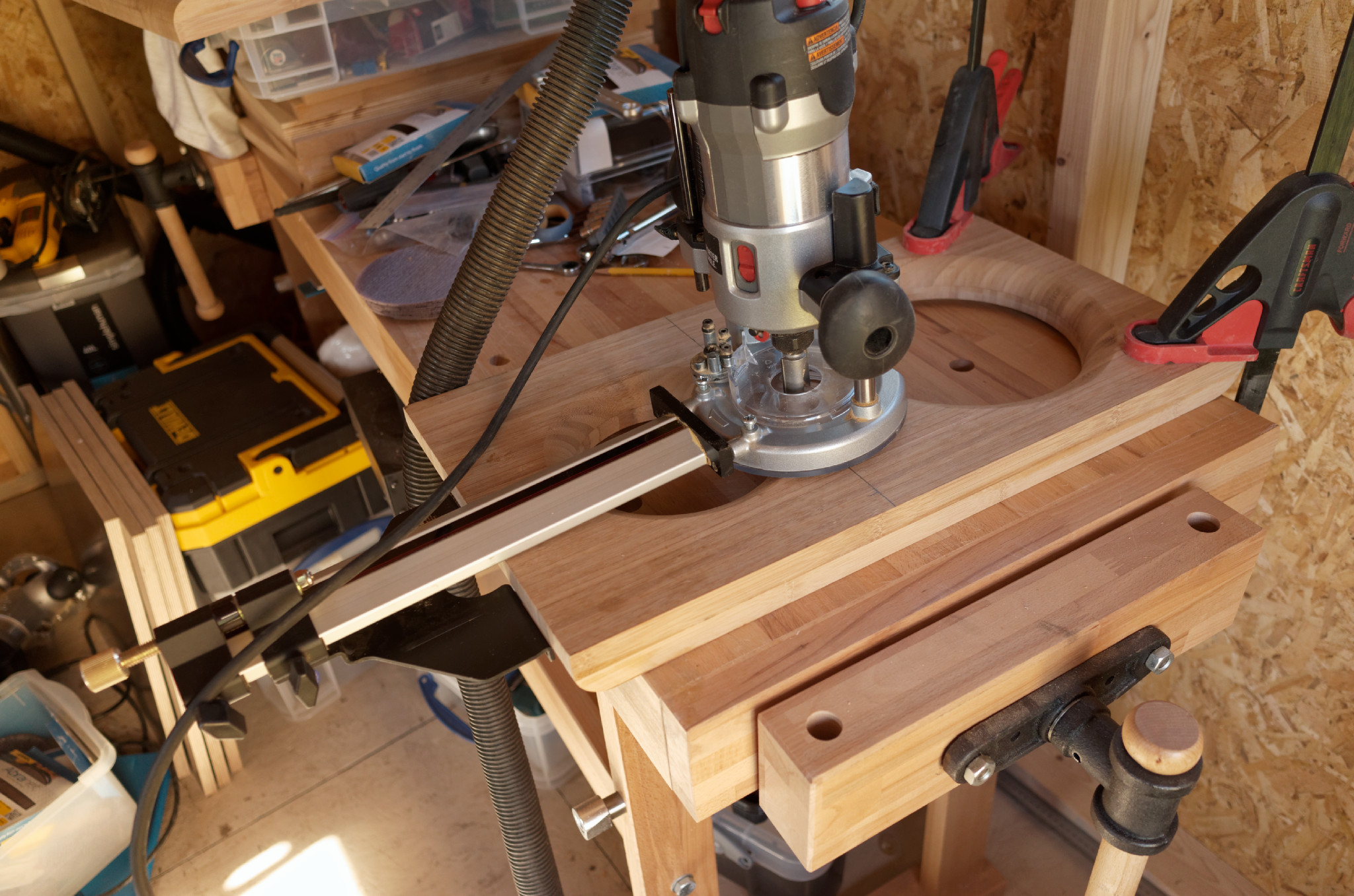

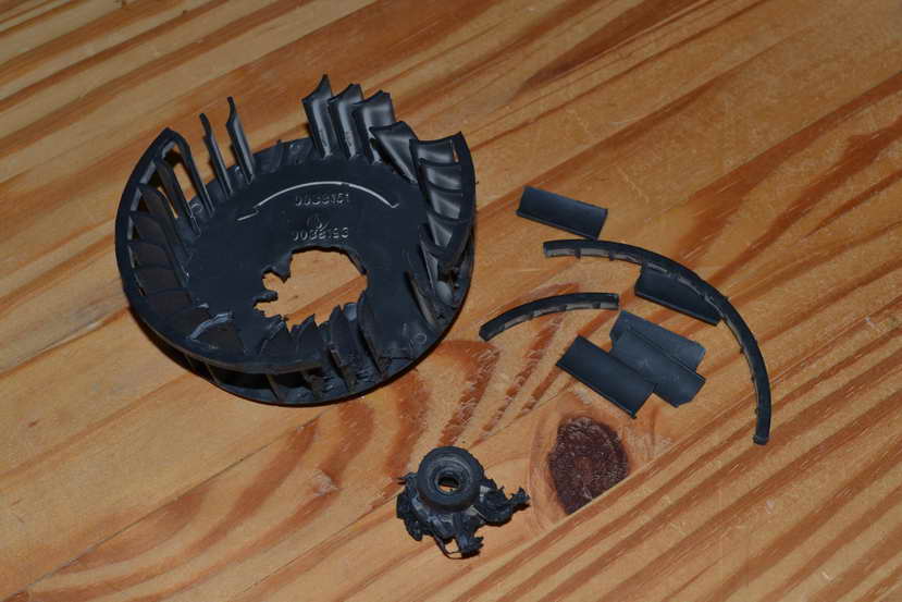

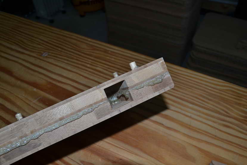

                                                                        Had a not so good start to the day ...... turned on the compressor and soon there after was greeted with a bang and some plastic bits ......
                                                                        A little disassembly revealed what I expected .......
                                                                        A new fan is on order .... After that minor detour, I got on with what I had planned for the day, sanding, gluing, clamping, repeat ...... Today the stands vertical section was on tap.

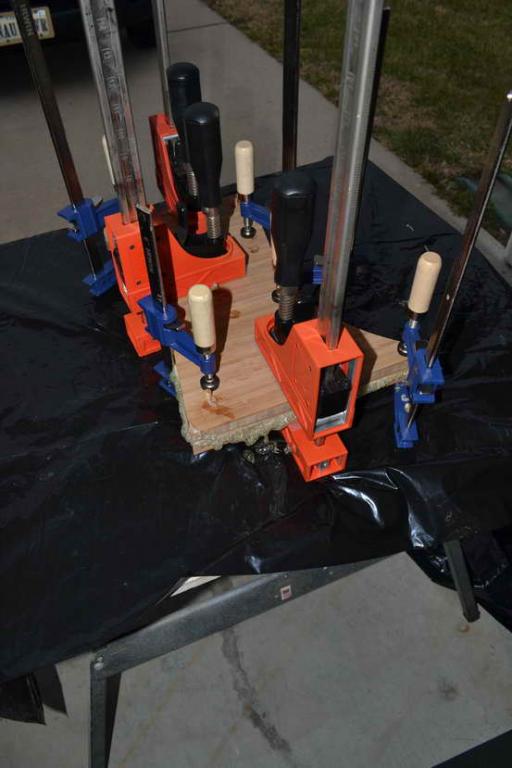

                                                                        This should be interesting getting the squeeze out cleaned out. The tunnel needs to be open for cabling to run through.
                                                                          • 16166
                                                                          #216
                                                                          The old fashioned way...
                                                                          Yeah, that does pose a bit of an issue? How tough is the bubbled glue once it's set? That stuff looks pretty vile and foamy, I have to say. That's why I chickened out....

                                                                          Last time I was working I'd cut and glued on one of the side panels, but no pics. So, this being the internet, it didn't really happen. But today I trimmed the panel that wasn't glued, first with a 5" battery powered circular saw (Craftsman, saw was cheap, battery and charger not so cheap, but it all worked remarkably well) then went around the edge of the side panel with what looks like an overgrown laminate bit (overgrown, as in 1/2" shaft and about 1" diameter follower bearing)
                                                                          When you see the back with the "outside" side on, then it all starts to make a bit more sense. (this was the original plan before Steve and I cooked up the new build he's working on).

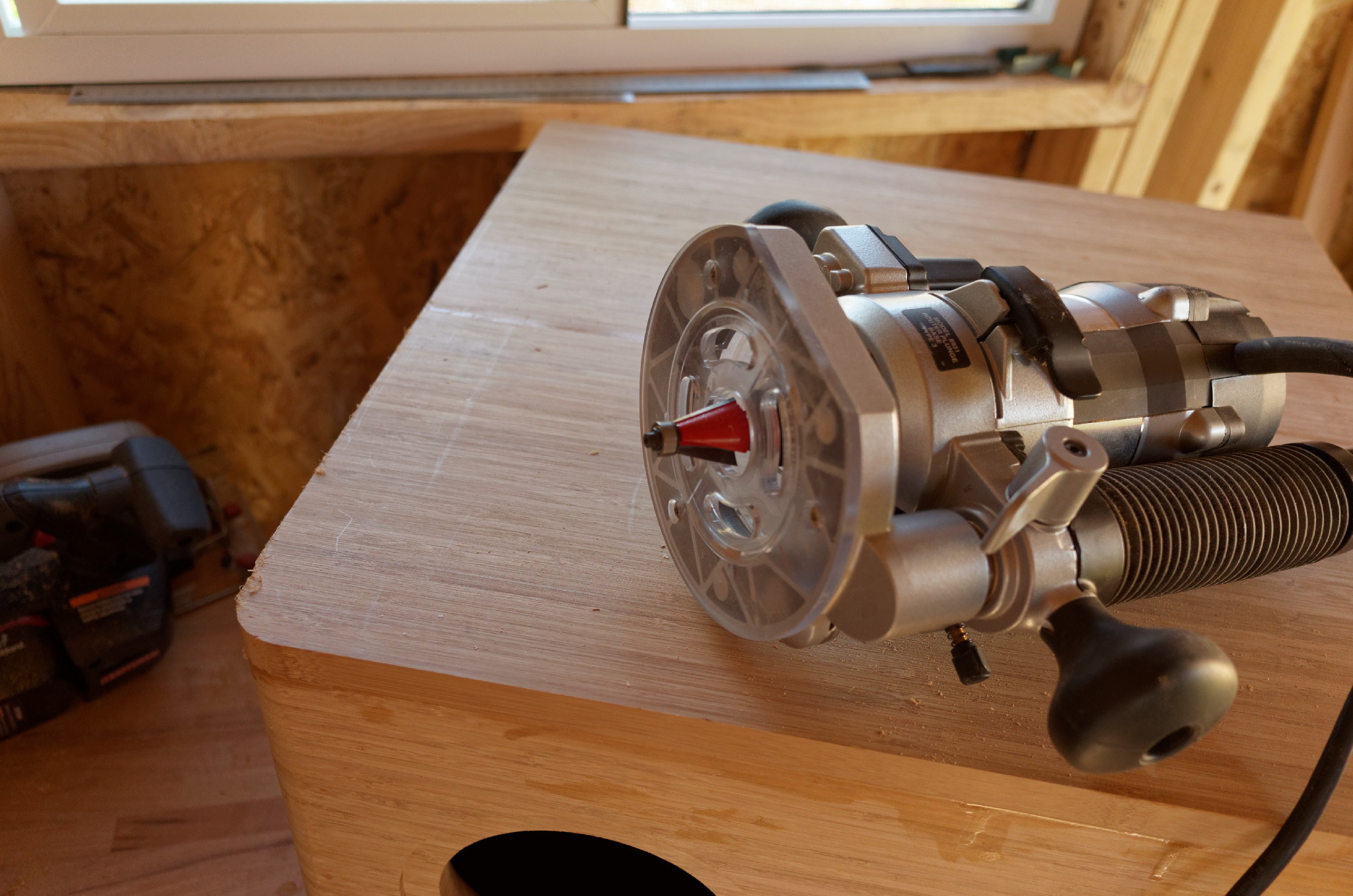

                                                                          This is only step one of trimming the side panel...

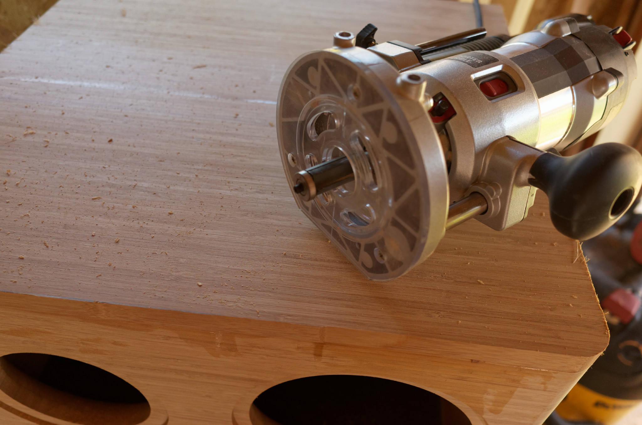

                                                                          Next up, the 15 degree bevel; bit!
                                                                          Now it's flipped over and ready to glue on the other side panel...
                                                                            #217
                                                                            Jon, what is it in that is on the side panel here?
                                                                            Is it a metal sheet?
                                                                            • CraigJ
                                                                              • 519
                                                                              #218
                                                                              https://www.flickr.com/photos/98266298@N05/25183275755/
                                                                              From one of Jon's prior posts; "The black side piece is BB ply with phenolic veneer for tooling- had it around, didn't want to order more. It's the inner side, actually, an outer panel of LBL will cover it."
                                                                              More importantly, what the heck is this:https://www.flickr.com/photos/982662...n/photostream/ ? 8O
                                                                              Fun build thread and I'm enjoying your new workshop. Oh, it's also good to see some sawdust laying around as it looks more like my "shop".
                                                                              Cj
                                                                                • 16166

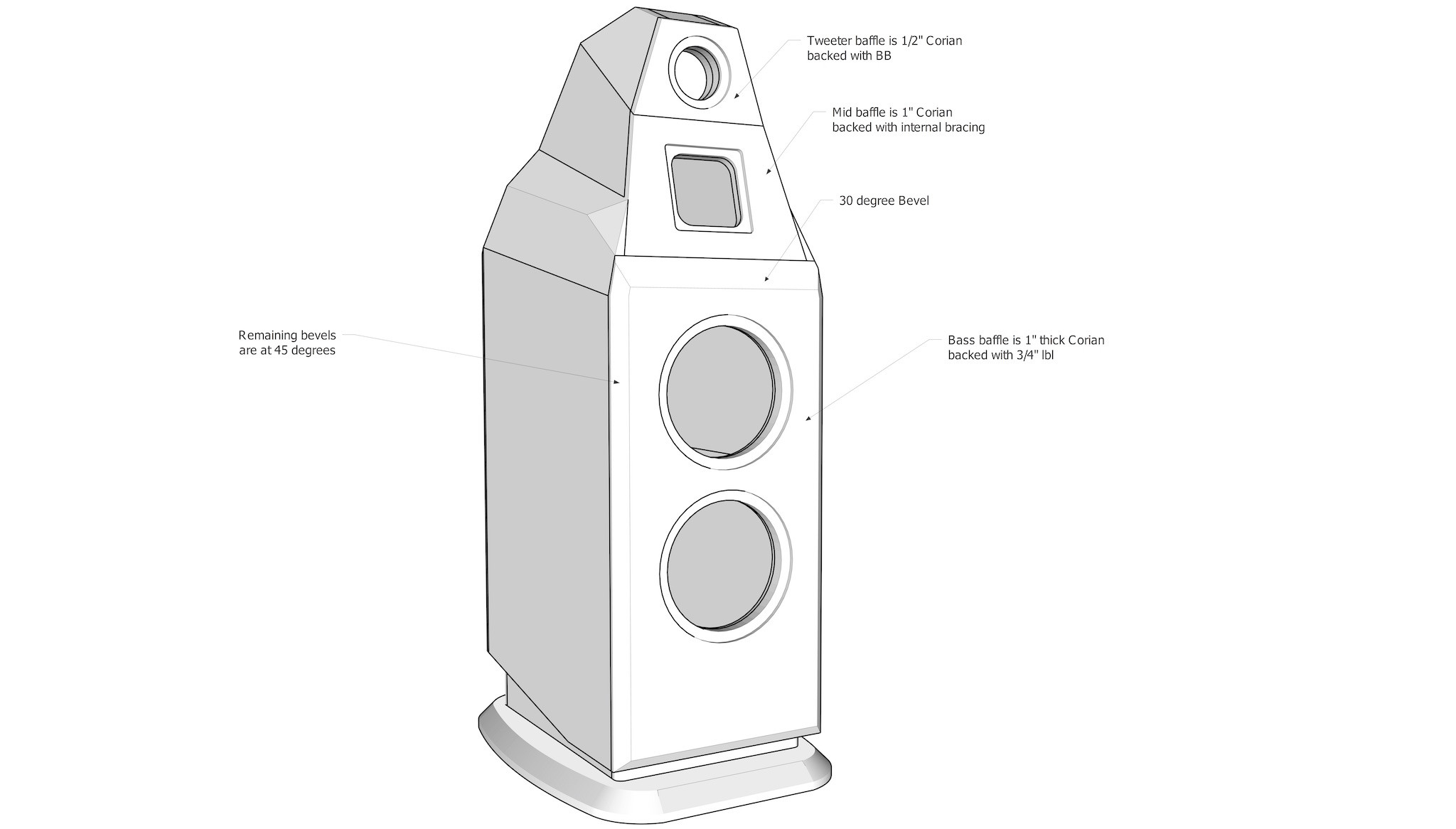

                                                                                #219

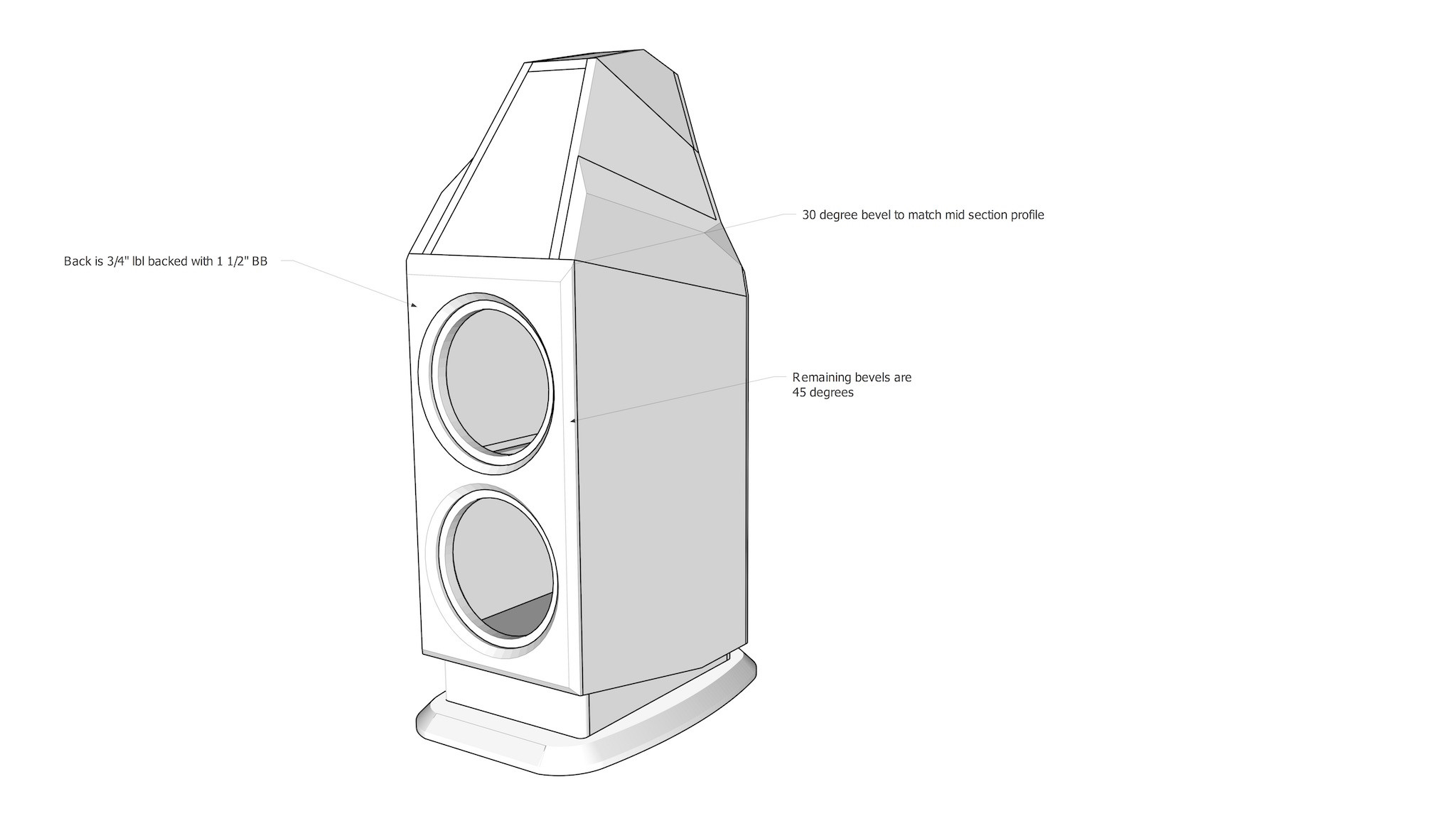

                                                                                That's a concept Steve Manning came up with for a Wilsonesque repackaged version of the Ardent, but also using dual PR's, one for each SW223BD02, as with the Minerva, which only has one SW223BD02, and one SS 10" PR.
                                                                                I'll post the front and back views later today- it's a bit tricky to get links from Flickr on an iOS device. I'm on my iPad Pro at Starbucks right now.
                                                                                  • 2140
                                                                                  #220
                                                                                  Cj
                                                                                  Hey Craig ....... That is what I've called at this point, the Ardent - S, (the S is for Sasha, I like some of the Wilson aesthetics). It's on the back burner at the moment until I get back to work to be able to fund it. I was playing around with Unibox looking at giving the Ardent a little more low end and asked Jon his thought's. It of course fit into his "more is better" philosophy and he had already been thinking of the driver combo's anyway.
                                                                                  So I have a cabinet design pretty much ready to go, just waiting on funds to pull the trigger.
                                                                                    • 2140
                                                                                    #221
                                                                                    Looks like you had a productive day Jon ..... To answer your question, this glue will be pretty easy to remove in comparison to epoxy.
                                                                                      • 16166

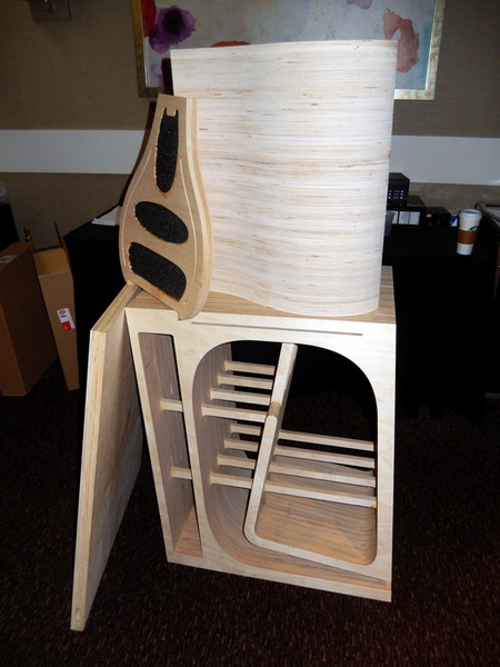

                                                                                      #222
                                                                                      Views as promised:
                                                                                      For those who like the Wilson esthetics, these could be pretty killer...
                                                                                      Steve did a very nice job on the cabinet design, IMO.
                                                                                      Of course, you'll have to have the right skills and tools, or be able to sweet talk Steve into helping you!
                                                                                        • 16166
                                                                                        #223
                                                                                        Fortunately I'm pretty good at containing where the epoxy goes!
                                                                                        BTW, these cabinets are SUPER stiff- tap on the walls, the resonant frequency is WAY above the passband of the drivers, especially of the woofer. I mean, we're talking several kHz. Probably be a good idea to put some damping pads on the midrange enclosure, or at least, it couldn't hurt. The woofer space, I think I'll just line with the owens corning 2" fiberglass board, I think. I ordered a couple of boxes of that which I never got around to building acoustic panels with!
                                                                                          #224
                                                                                          Views as promised:
                                                                                          Click image for larger version  Name:	24913192421_ee808dfb88_o.jpg Views:	0 Size:	147.2 KB ID:	943518
                                                                                          Click image for larger version  Name:	24913221651_f96da39515_o.jpg Views:	0 Size:	137.9 KB ID:	943519
                                                                                          Hmm, that socket isn't Wilson design, is it?
                                                                                          Seems familiar. A bit B&W 802 and something else in there?

                                                                                            #225

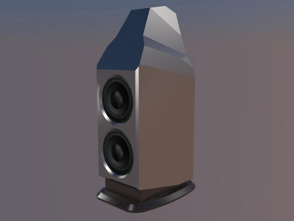

                                                                                            This is where I see the finished design .......
