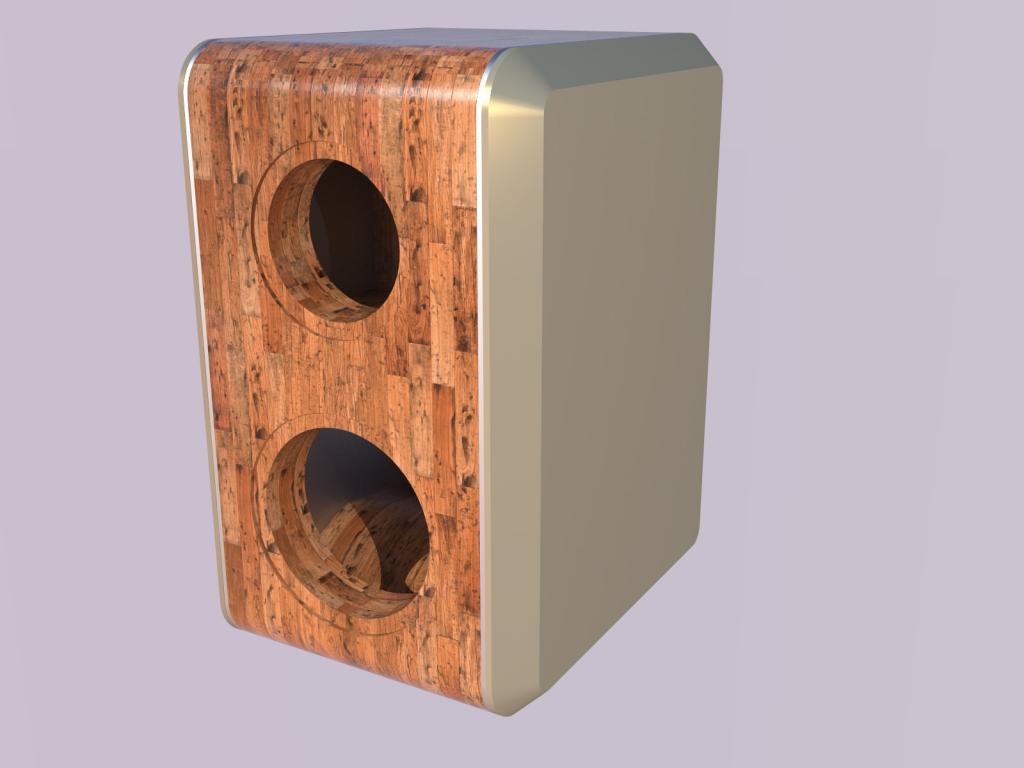

            #230

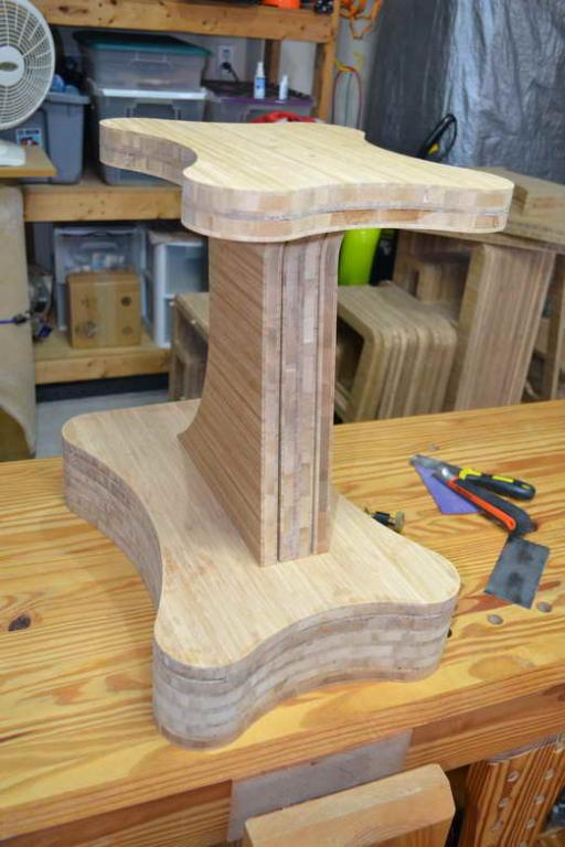

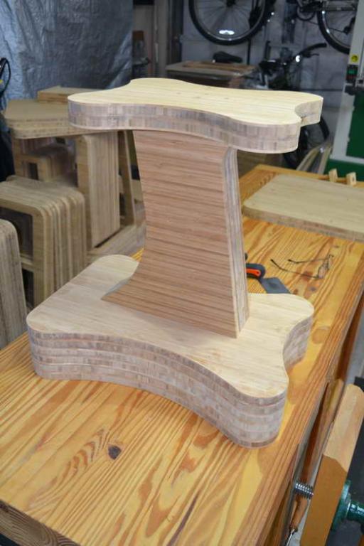

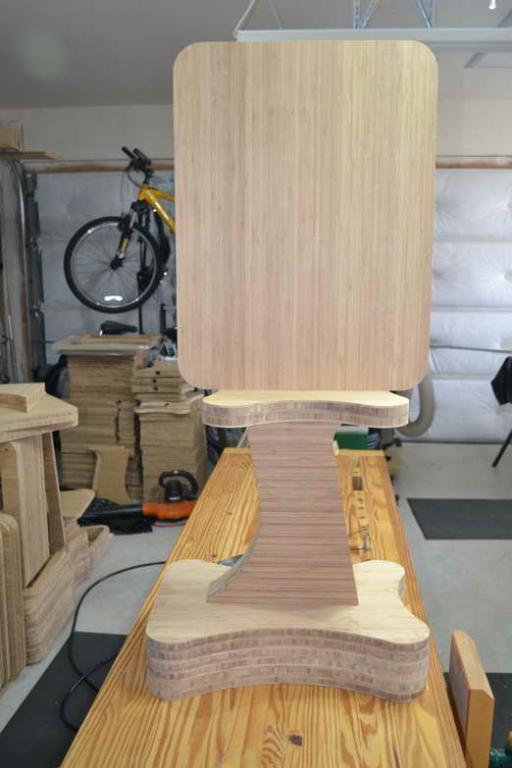

            This is where I see the finished design .......
            [ATTACH=CONFIG]25243[/ATTACH]
            [ATTACH=CONFIG]25244[/ATTACH]
            With such a large woofer box, and wide baffel, have you (and Jon) evaluated the possibilities to go up to for example 2 x 10" or 2 x 12"?

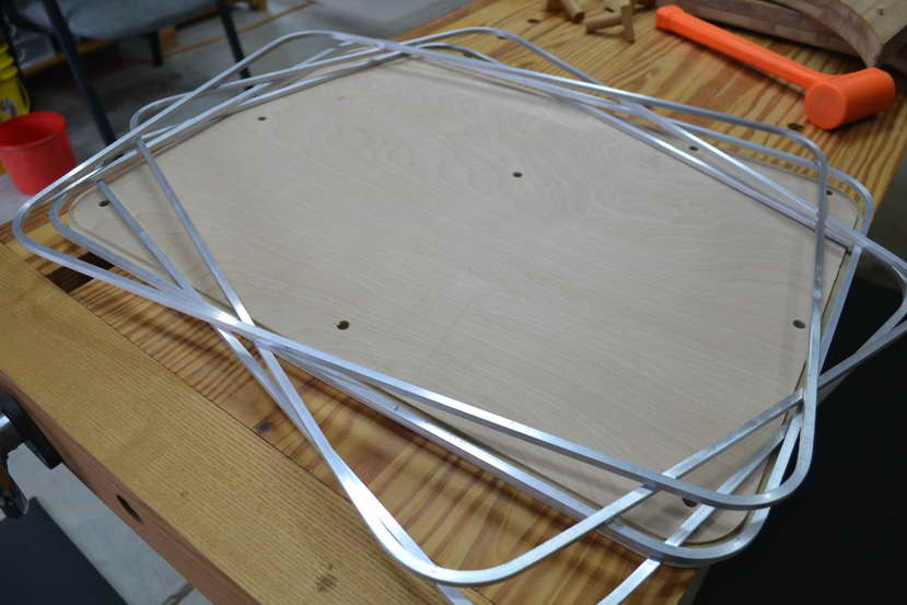

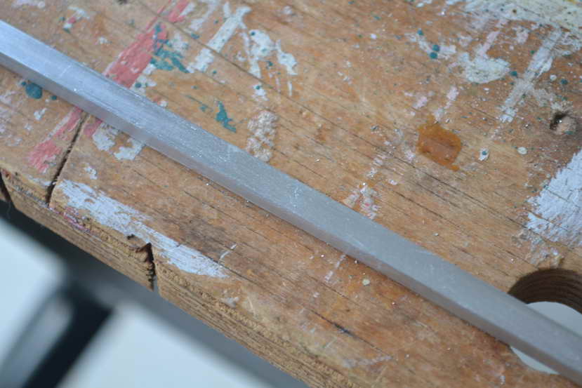

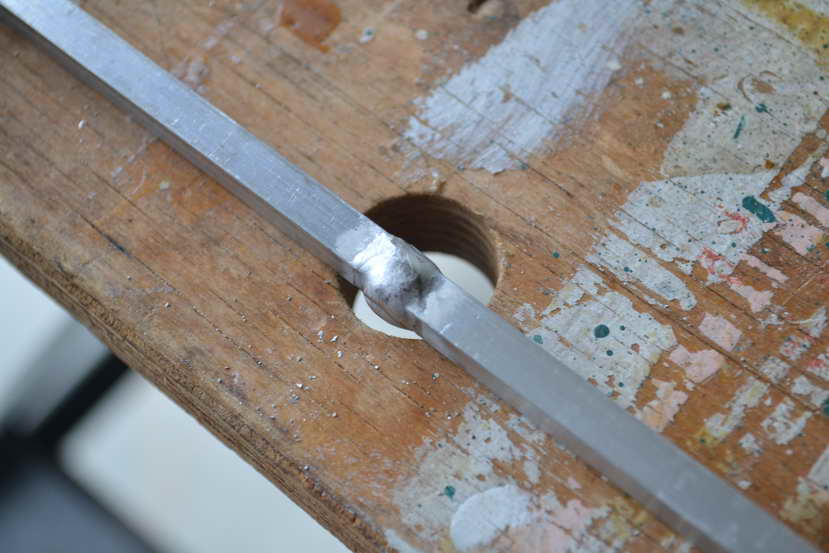

              ALuminum Trim

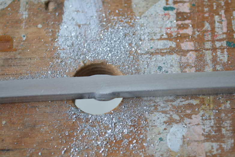

              Got the aluminum trim back for the cabinets, from the welder today .... here are some pictures.
              Needed to do some clean up of the weld areas, this is what they looked like to start ....
              A file was all that was needed to get the excess removed. One side done .....
              All four sides filed ....
              Half way done ......
              The frames will need a little tweaking to adjust the fit and then some polishing and sealing before they are completely done. So far it looks promising though.
                Hey TEK .... The way it sits at the moment these should get down into the low 20's. The base section is actually only 2 cu ft, which is not all that large really and the cabinet is only 14" wide. It could handle a 10", but not a 12" driver.

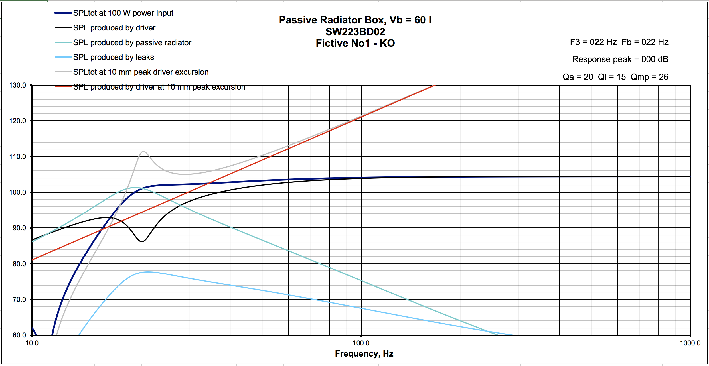

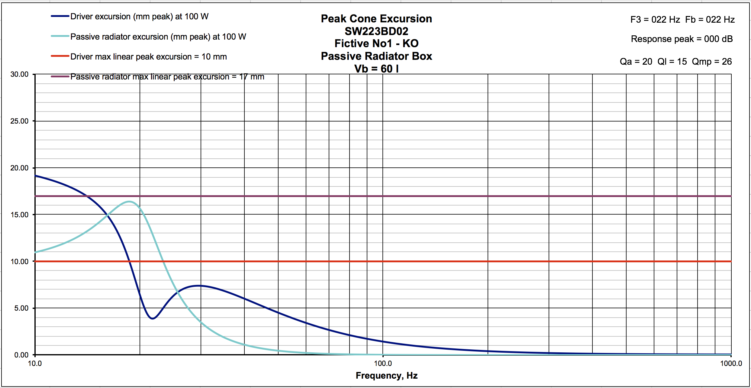

                  As Steve is getting at, it's really all about the complete system tuning and the compatible drivers. The 10" PR's on the back give a fair amount of radiating area for the low frequencies, but they will kick in only on the very low frequency stuff. We're not trying to make PA speakers, after all, but a wide range home music system.
                  OTOH, this cabinet is significantly larger in volume- each 9" waver and 10" PR requires about 30-35 liter, (60-70L total) where as the total volume sealed for the Wavecor Ardent isn't much more than 40L.
                  Let's look at the anechoic response potential predicted by Unibox, which I find to be fairly accurate. First, the predicted SPL vs frequency for 60L setup for the two drivers and two ScanSpeak PR's:
                  Now, under those same conditions, the driver and PR excursion:
                  The SW223BD02 is comfortably under it's Xmax limit, though the PR will be pushing pretty hard by the time you get down to 23 or 24 Hz. For this size box, that's some pretty respectable LF extension. This is anechoic, for one cabinet; with boundary reinforcement one should see about 6 dB more output. :T

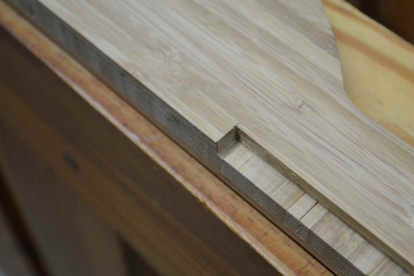

                              #239

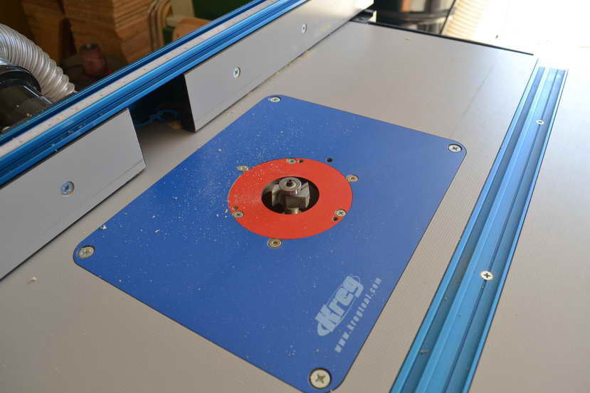

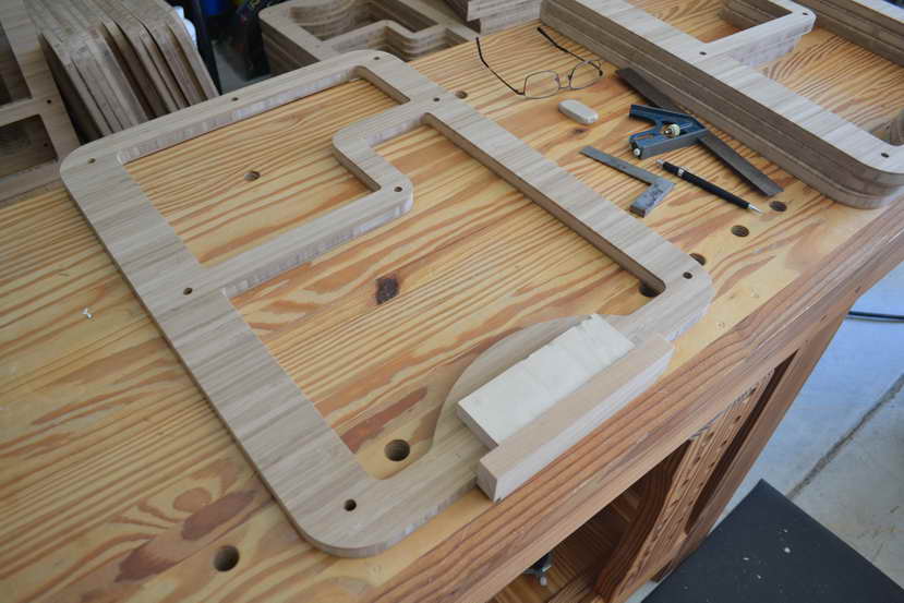

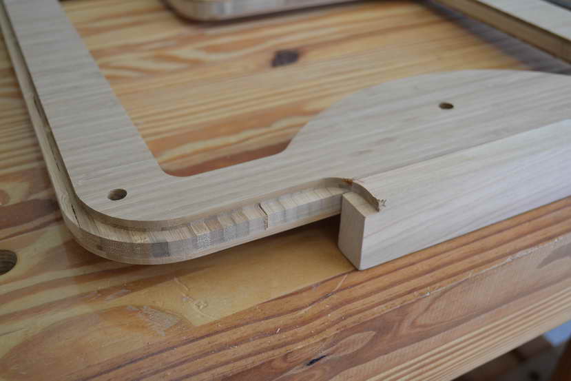

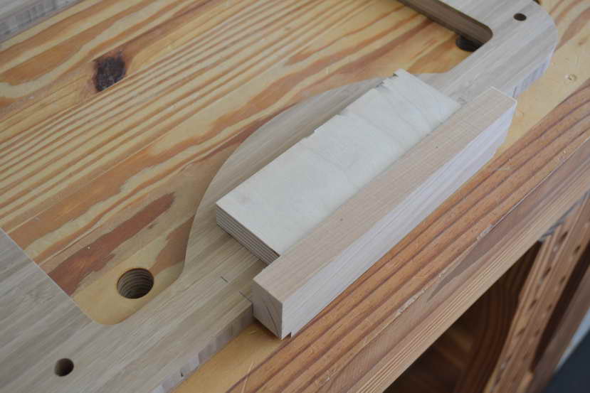

                              Productive day in the garage ....... had to go with plan B on the aluminum trim. I was a bit concerned with the trim pieces fitting once they were welded. Even though they were setup in a jig, they were still essentially bent by hand. As such trying to tweak things to get them to fit was just not working. So I've decided to remove a section of the trim on the bottom of the cabinet so I can make adjustments. Things will look essentially the same from all angles, except the bottom.
                              The plan was to cut a around the circumference for the trim to sit in. Now I had to modify it with a start and stop point.
                              The high tech. jig, scrap boards and carpet tape .....
                              New rabbeting bit set up to go ....
                              Rabbet cut ....

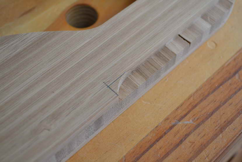

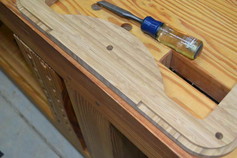

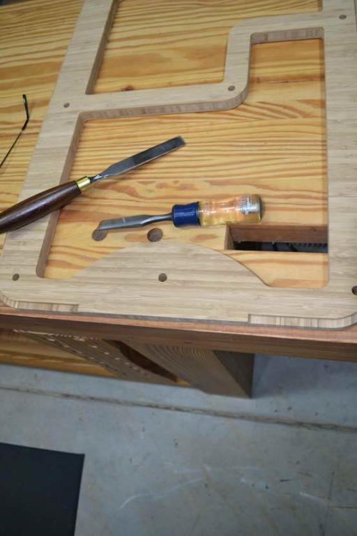

                                #240

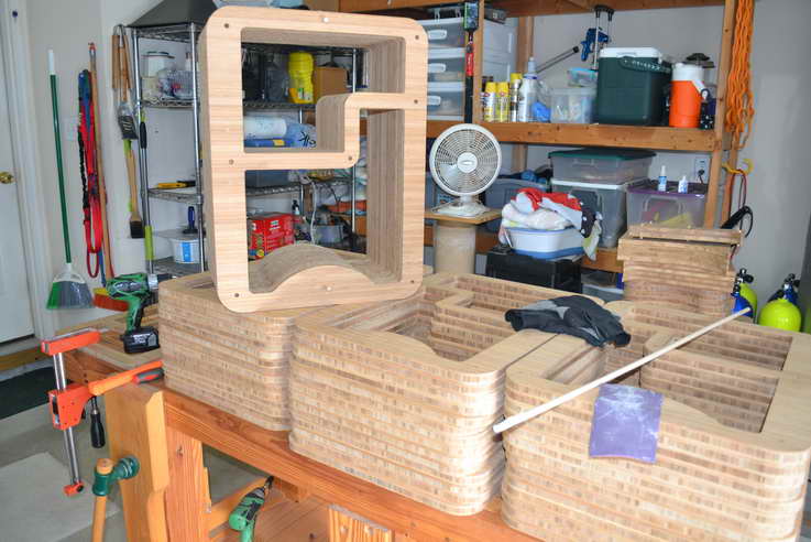

                                Marking the squared out finish ....
                                After a little chisel work .....
                                All cabinet pieces are rabbeted at this point ....

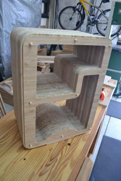

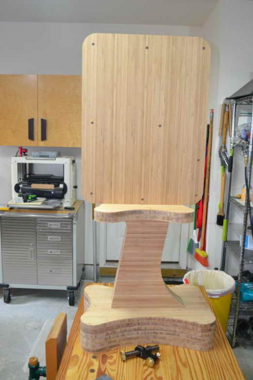

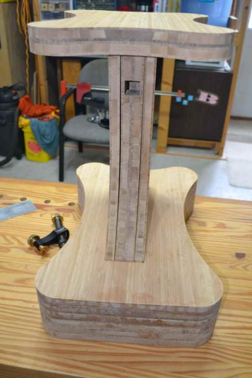

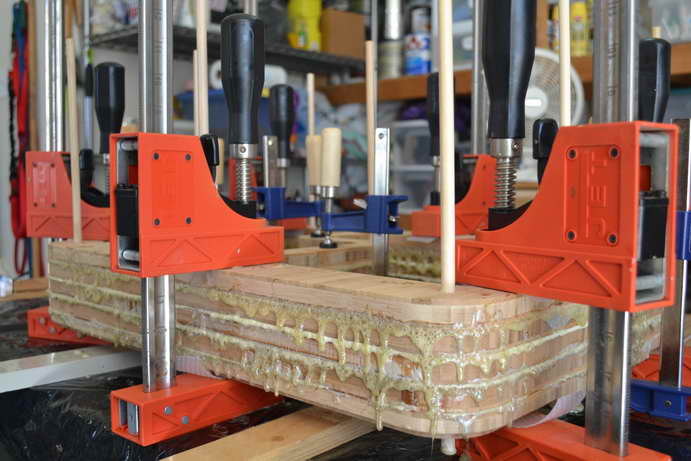

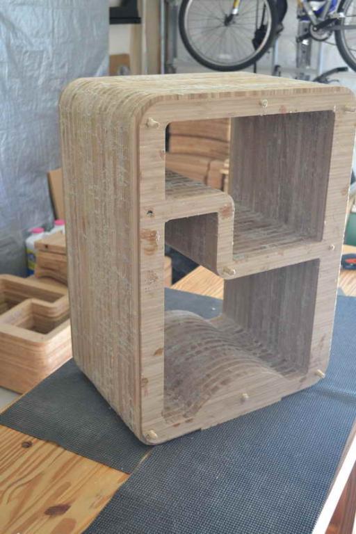

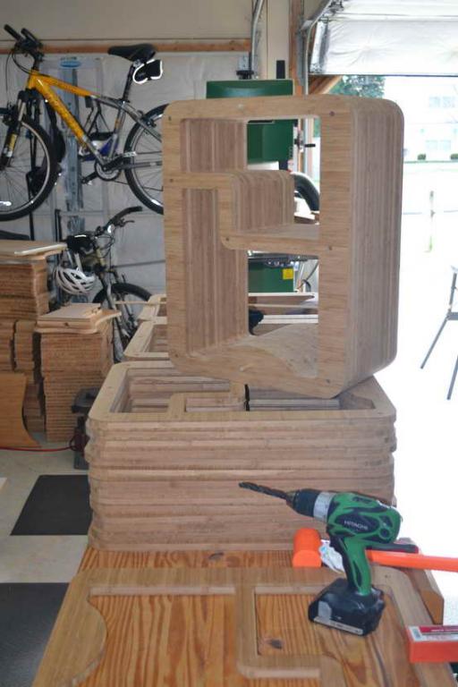

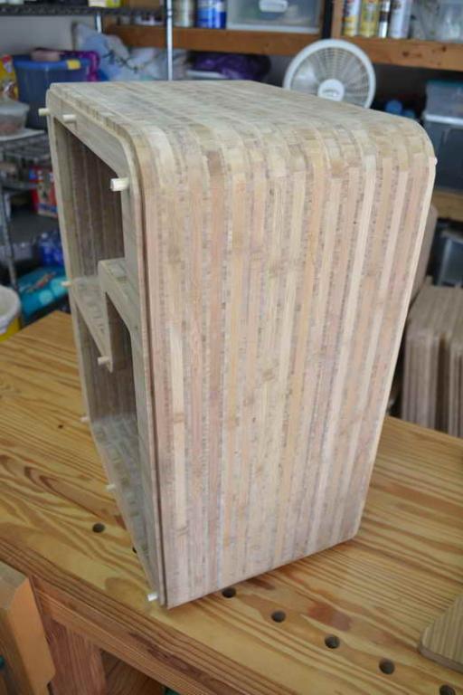

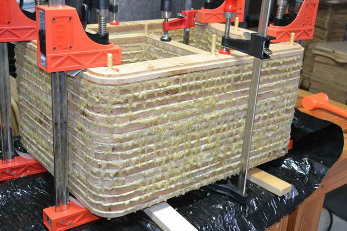

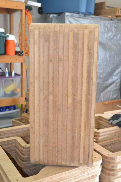

                                              Cabinet One Glued

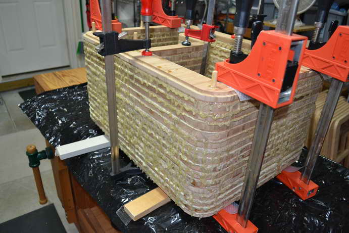

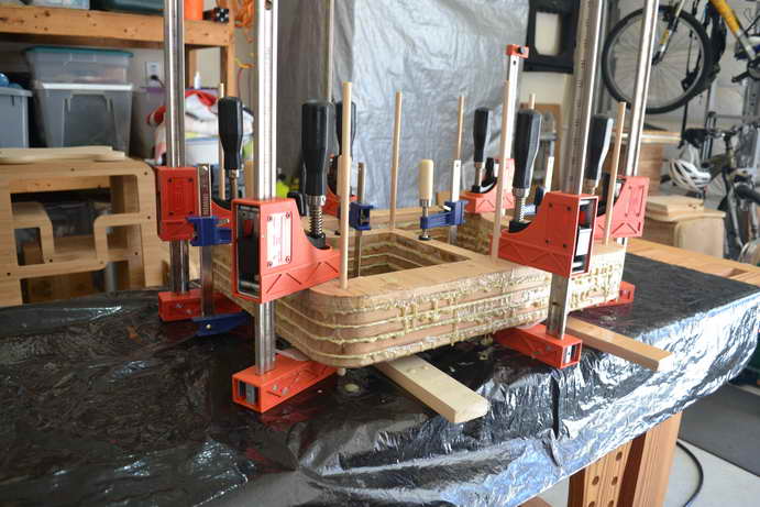

                                              Spent the day gluing up the first cabinet. Split things up into three sections to deal with open time for the glue, etc. I think if you had a second person working with you it could be done in two steps vs. three. Where is that Jon when you need him ...... :B
                                              The first glue up ....
                                              At the end of the day .....
                                              Now comes a bit of clean up ......

                                                      #251
                                                      So, how did the alignment turn out? I would think the dowels would only do just so so (at maintaining alignment) when you're looking at that many stacked pieces. I'd guess that when clamping pressure was applied (and glue began to flow) there would be a tendency for the whole stack to 'swim' a bit. How square do you think it ended up overall, and how much sway (variation between pieces)? I love the concept, if it works well I think it'd be something to try!
                                                        • 16198
                                                        #252
                                                        I think by only doing a third of the stack up at a time, Steve is mitigating the "swimming issues". But let's see what he says...
                                                          • 2141
                                                          #253
                                                          I'll let you know when I scrape the glue off ..... though with that many dowels I think (hope) it won't be too bad.
                                                            • 2141

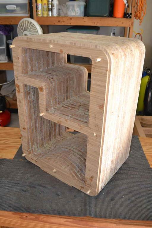

                                                            #254

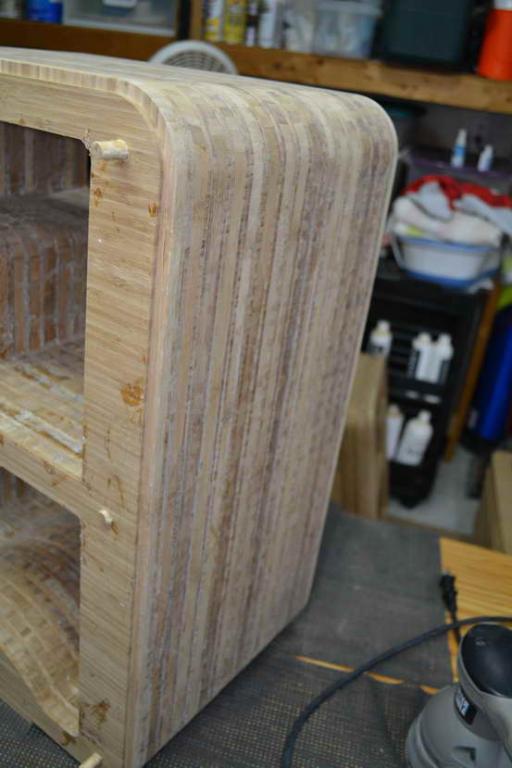

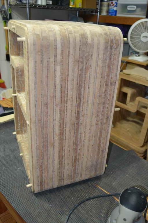

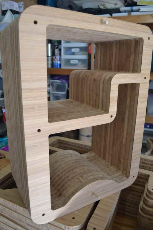

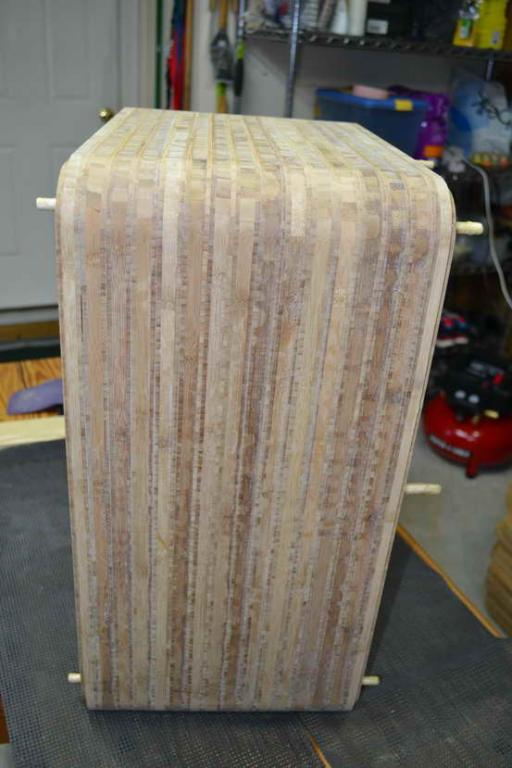

                                                            Well the glue has been scrapped off ..... loads of fun to be had there 8O
                                                            This is what it looked like after that was done. Alignment looked pretty good.
                                                            Then spent some time with a scrapper and some rough sand paper ( 50 & 80 grit) on the sander and got a couple of sides semi smooth. Sanding this end grain is like sanding steel. It's going to take a bit of work to get it finalized, even though the alignment is good.
                                                              #255
                                                              I'd say that's better then a slap in the belly with a wet fish! :T
                                                              Are you going to sand smooth or skin the surface with epoxy or something first?

                                                                                  #265
                                                                                  So while Jon is out west chasing Unicorns ..... I've made a little progress on things here is the shop. At present I'm gluing up the side panels for the cabinets, (there two layers of lbl each). While the glue is drying on one I've cleaned up three sets of others I decided to take a look at the scale of the stand vs the cabinet. It always seems to be different in real life than in a drawing ........
                                                                                  First three are of the stand. At this point the top and bottom sections are glues together as is the center two layers of the vertical. The vertical outside pieces are just press fit together.
                                                                                  Here is the stand with one of the outside layers sitting on it. I figured putting the entire cabinet up there with no bolts was not going to work very well 8O
                                                                                  All in all though the cabinet profile is "chunky" I think the scale is not too bad.

                                                                                    #266
                                                                                    Also finished rough cleanup of the first cabinet Tuesday. Inside and out are sanded to 80 grit. I also did some tests using my hand plans on the lbl and it worked rather well. To get it to this point was ~ 7 hrs of work.
                                                                                    Last edited by masterofnone; 30 June 2023, 11:18 Friday. Reason: Update image size

                                                                                      FIY AudioXpress has published test data for the Wavecor woofer we are using here.
                                                                                      In this Test Bench, Vance Dickason measures the SW223BD02 8.75” subwoofer from Wavecor, part of the brand’s rather extensive line of subwoofers. Wavecor’s SW223BD02, which is the 4-Ω version (SW223BD03 is 8 ohm), was designed specifically for high performance compact subwoofer applications and has a generous feature set. This article was originally published in Voice Coil, April 2015.
                                                                                        Click image for larger version  Name:	DSC_2151_resize.jpg Views:	754 Size:	51.6 KB ID:	861391
                                                                                        Click image for larger version  Name:	DSC_2153_resize.jpg Views:	781 Size:	49.0 KB ID:	861392
                                                                                        Looking very nice, Steve- you're making some great progress while I chase down the Unicorns and Tesseracts. I guess we each have our crosses to bear... :W
