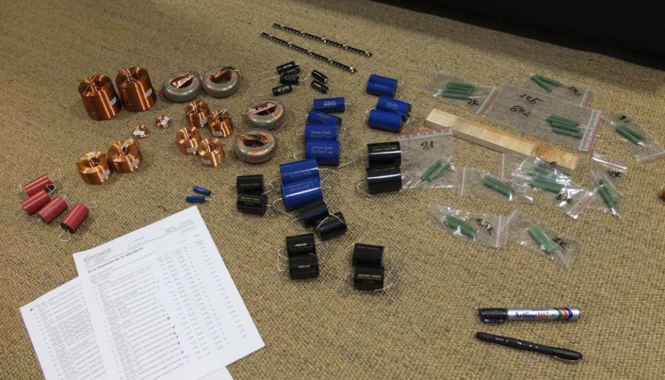

    I finally got all the parts, so now in next days onto thinking how to place and assemble these so that if it works it'll fit inside the box too.
      • 16202
      #632
      [ATTACH=CONFIG]25749[/ATTACH]
      Super! :B :T
      I just love seeing pictures of big piles of crossover parts.... and I know what you mean, some of mine have started arriving, and I'm going to try to have to make a layout that will work in some fashion in the based of the Translam build, as well as for the Minerva TS variant.
      There's also an MR18REX on the way- and I am curious to see how it stacks up against the C18EN001 on the bench, and otherwise. For now I'll probably put it in the original test enclosure and give it a whirl there...

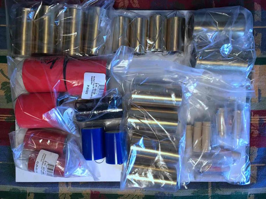

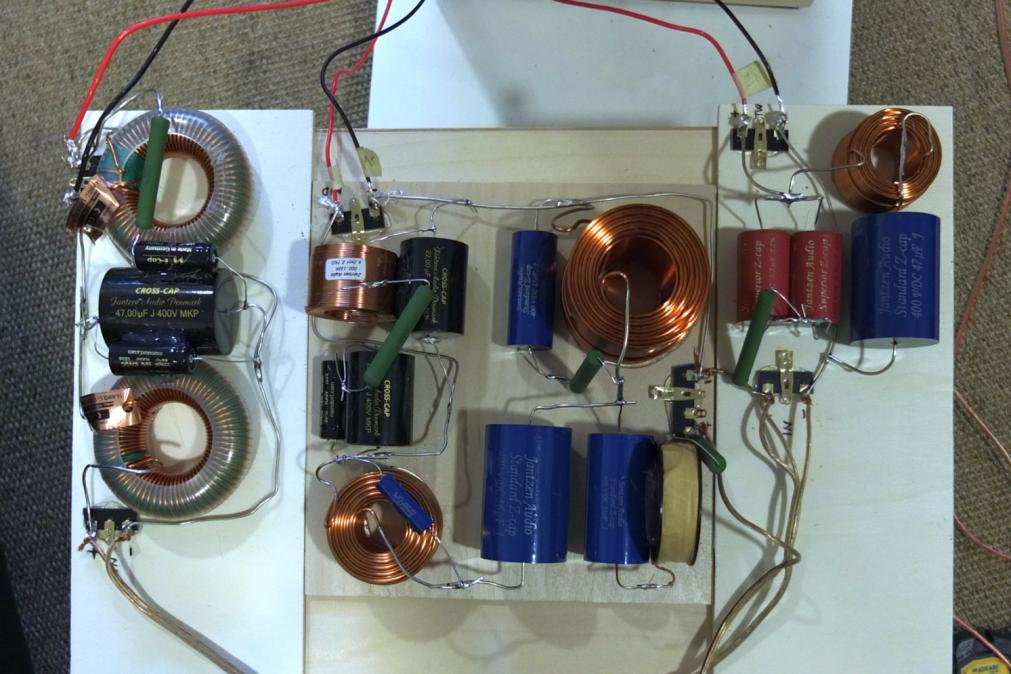

        No inductors yet, but I'm getting there... lots of shiny bits!

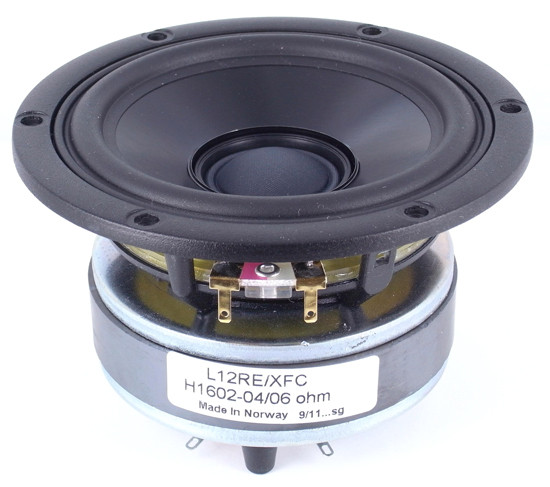

                Impressive.... most impressive! Now, the only thing that remains is to install a coaxial driver in place of the laser beam focus mirror...
                Stephen Manning's next assignment will be to complete construction of the LBL Death Star... I am most certain we can find the ways to properly motivate him...
                Then, the only task remaining will be to integrate a Seas L12RE into the Laser Focusing parabola- undoubtedly a trivial task for one as skilled as Stephen...

                        #641
                        What flavour are the gold colored caps?
                          • 16202
                          #642
                          Those are from Obligattor, sourced through Parts Connexion in Canada. Something of an experiment, they're the "Gold" series, non-resonant construction with non magnetic metal tube and heavy encapsulation, made with German sourced polypropylene film in China. Recommended by Tony Gee and others as good value, fairly high performance with reasonable prices. Construction is very similar to Jantzen Superior Z caps.
                          • flamethrower1
                            • 392
                            #643
                            Sweet, I was hoping that's what they were, I have been looking at those.
                            Have not purchased the caps for my uber build so it will be interesting to see what you find out.
                            Thanks, Greg

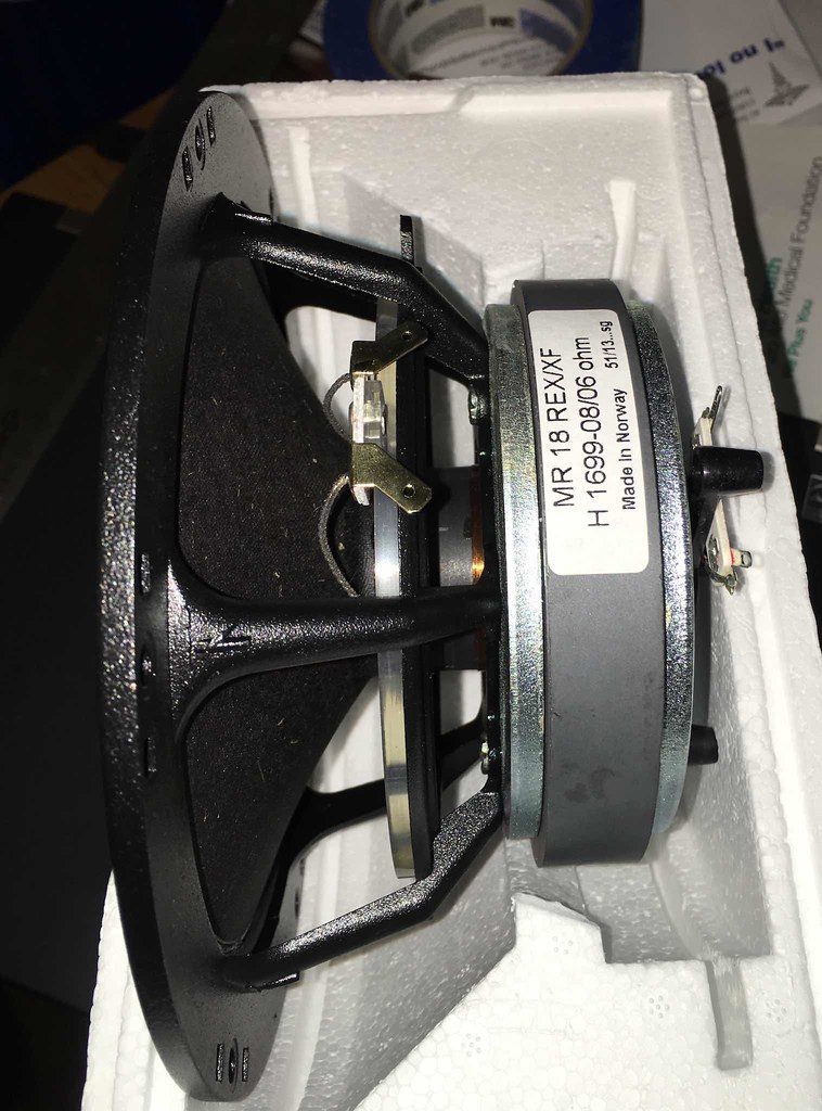

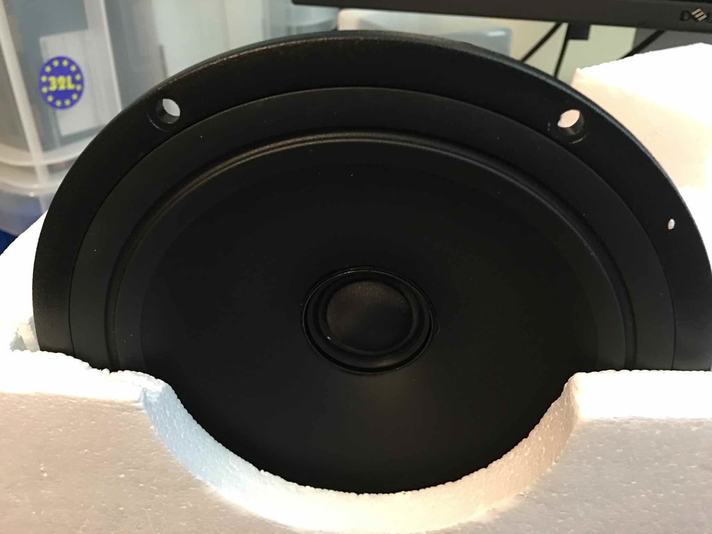

                                              Well, UPS delivered, rather late, but they delivered.
                                              It's apparent from peaking at the voice coil, that there is enough overhang to have the quoted 5mm or so of Xmax; on the other hand, the front suspension is pretty much identical to the C18En001, which is really not designed for anything more than 1, maybe 2mm, so this is clearly still a midrange driver.
                                              It will be interesting to get some testing done after we get back from the Tahoe area... don't expect that until later next week, though. Must admit I'm curious.
                                              Truthfully, I'm curious, too, how the C18EN would do with a reed paper cone...

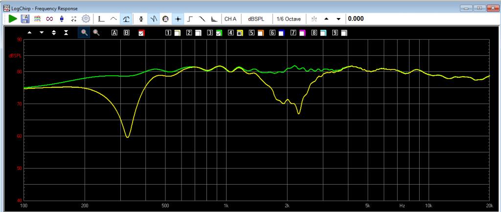

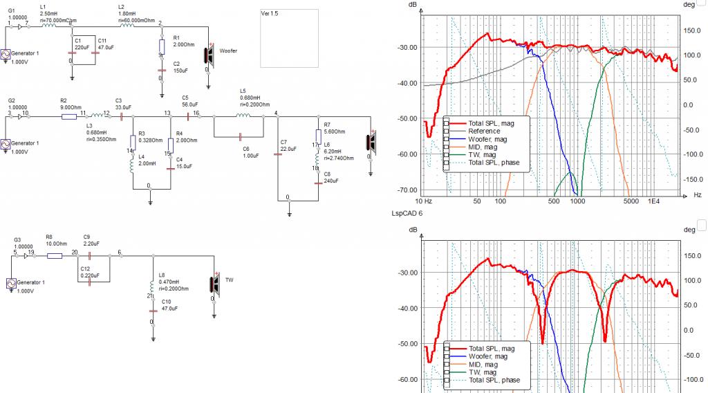

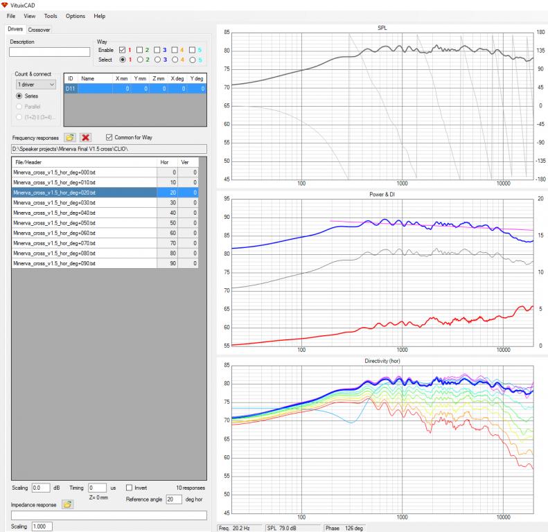

                                                    Some progress. Both crossovers are attached to base boards and one is soldered up. I made a small change too in mid cross I replaced L3 from 0.62mH to 0.68 for a moment as the one I ordered was too small a wire diameter, so I decided against using it. Measurement with 0.62mH one gave very slightly different result. I will check further and perhaps unwind the 0.68mH ones to the intended value.
                                                    The LspCAD plot shows simulated versus measured (gray line / 10ms window)
                                                    VituixCAD plot shows the 0... 90deg measurements with this xover and again 10ms gate.

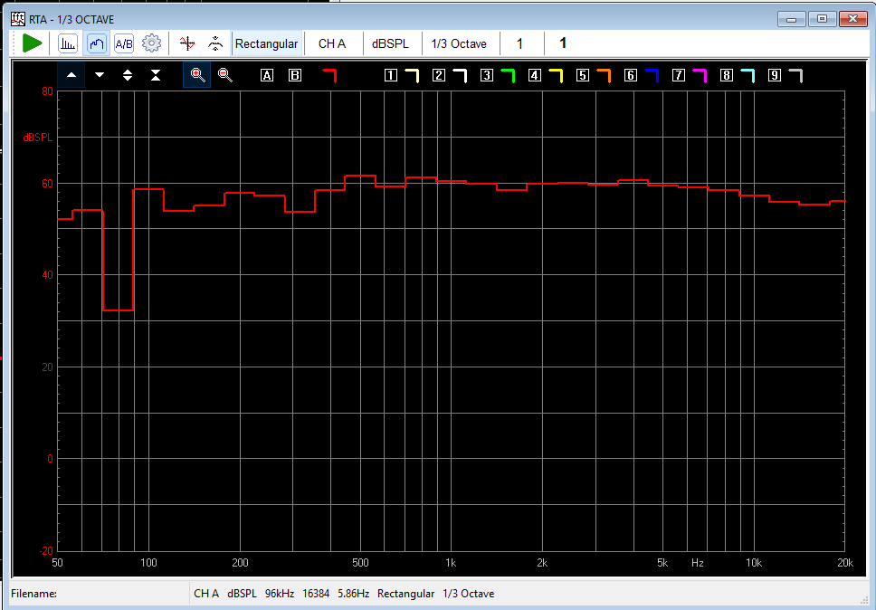

                                                      Measured hor+20deg with MID normal and reverse polarity (not quite as good as simulation)
                                                      And 1/3 octave RTA in middle of the room
                                                        • 16202
                                                        #657
                                                        It's looking pretty good to me- especially the RTA plot, which is also very room and placement dependent.
                                                        Now, the $64 question is, how does it sound to you with program? 8)
                                                        We're heading out the door shortly for the south Tahoe area- will be back late Tuesday night.

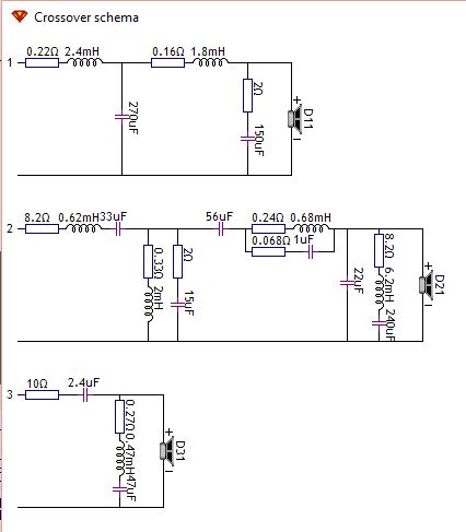

                                                              #660
                                                              Ergo how did you enter the midrange components into virtuix cad? Can you screenshot the main page with the mid crossover entry?
                                                                • 698
                                                                #661
                                                                This is the 1.4 version from Jon
                                                                  • 2142

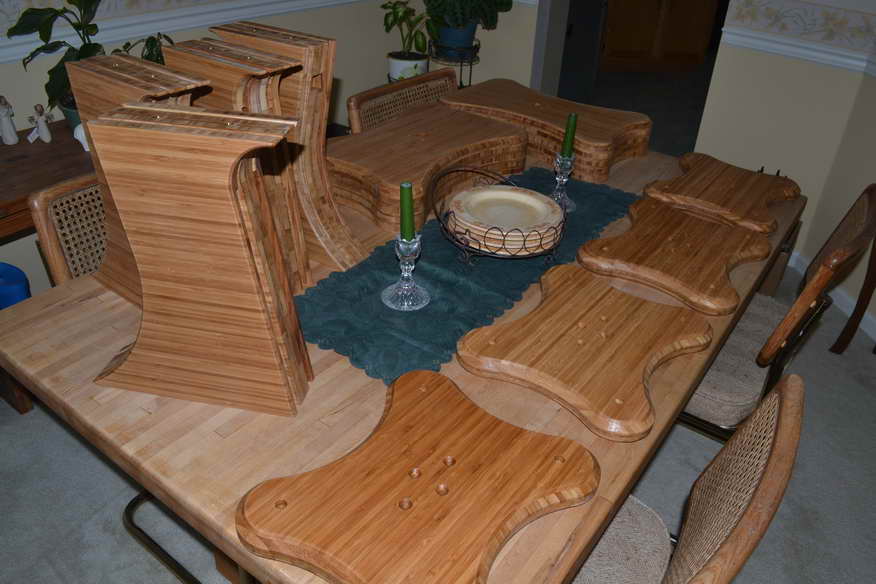

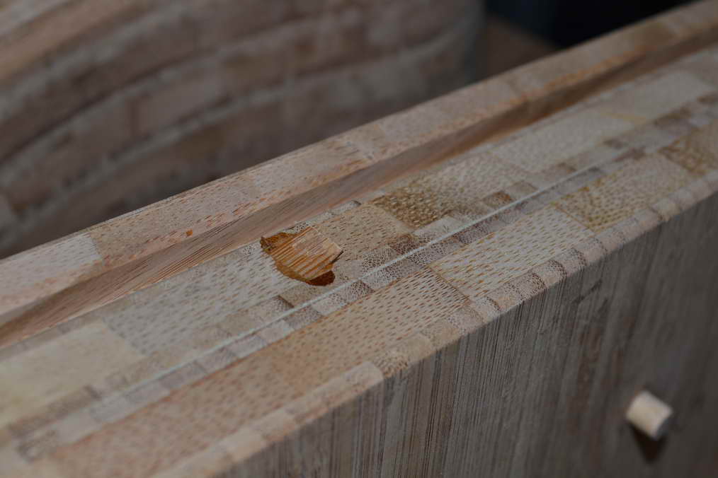

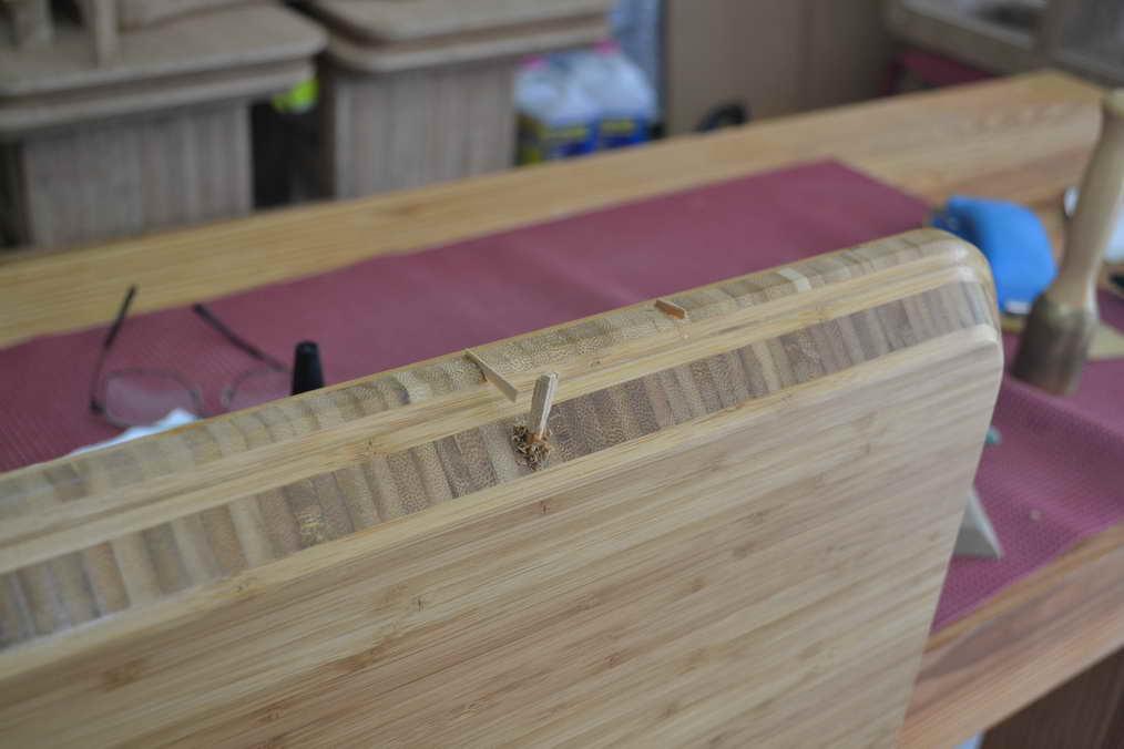

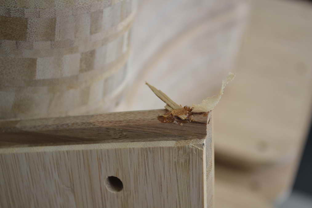

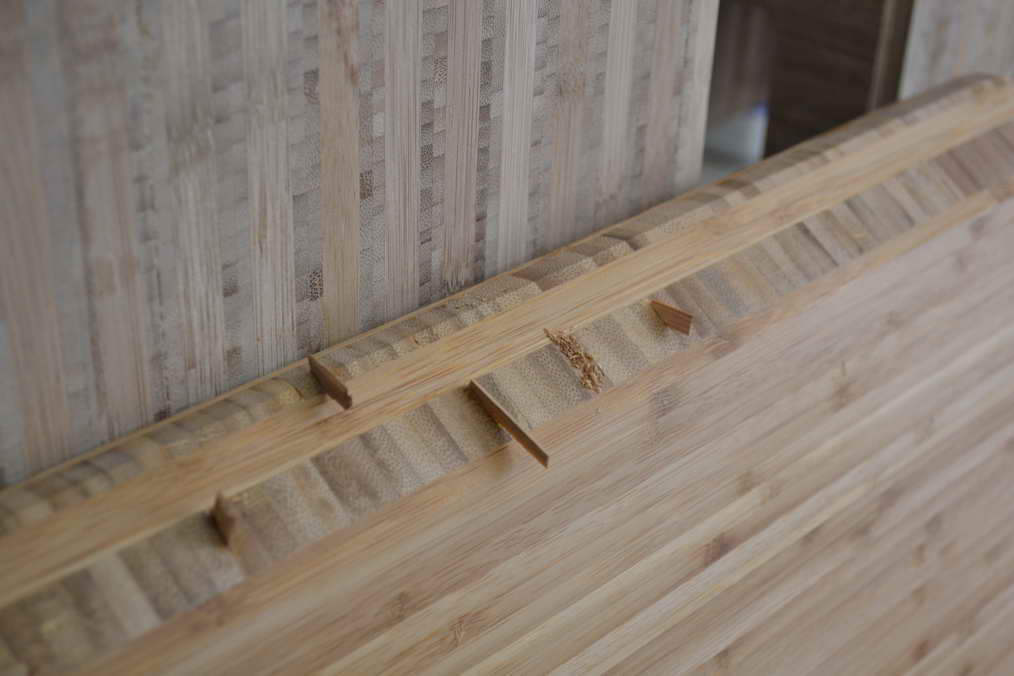

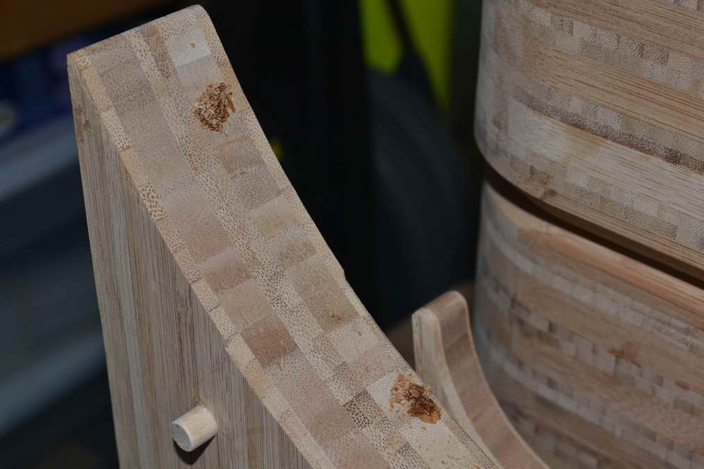

                                                                  Prep work continues for spraying finish ...... at this point ~70% of the parts need some kind of repair of voids, as well as sanding to 220 grit and 2 coats of sealer. This is adding considerable time to the process as one can imagine.
                                                                    • 2142

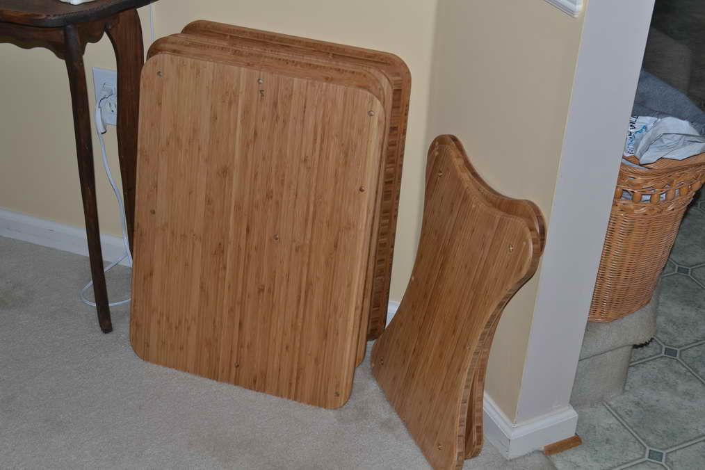

                                                                    #663
                                                                    Even so ..... the pile is slowly moving from the garage into the dining room as they get finished. I'm expecting all of the stand parts to be ready for finish by tomorrow ....... I also have half of the cabinet sides done as well ......
                                                                    Hopefully the parts will be safer there with our cats than me in the garage :unsure: Though they can get creative when they want to.
                                                                      • 16202
                                                                      #664
                                                                      Those are looking very nice, Steve! :T Cats can be a problem, if they take a shine to something...

                                                                          Great work Steve. Hope this project has not turned to 'oh I'm sick and tired of seeing those pieces again' phase yet and you'll get to the music listening part soon as well.
                                                                          I got both speakers wired with crossovers finally yesterday and verified with quick measurements. All xovers are outside the boxes for now.
                                                                          Initial rush listening session that covers small samples of various music styles gave a positive first opinion. Wife agreed as well and commented that there is finally enough low end body in music... with Modula MTmkII-s we have in family room this department is still kinda soso only.
                                                                          More listening and driving the speakers in to be done in next few weeks before I start trusting what I hear, but I am very happy to be far enough finally to be able to enjoy this next step

                                                                                    #671
                                                                                    I got the emulation to work today and listened to single speaker for about 30 minutes with the VituixCAD ver of your crossover and then very slightly modified one trying to get the phases to match with my measured data.
                                                                                    I do like the sound potential - that is there for sure... the details of voicing - too little listening still. I will be attempting to make some measurements of the speaker in mid room as well as in listening position to see if the balance seen on screen maps to what it is in room.
                                                                                    [ATTACH=CONFIG]25581[/ATTACH]
                                                                                    [ATTACH=CONFIG]25582[/ATTACH]
                                                                                    Hello Ergo,
                                                                                    I could say this with just a PM, but I think it is more appropriate to mention in front of the whole forum (well, those reading this thread) Thank you again for bringing the VituixCAD software to our attention- it's becoming a very indispensable tool, in spite of the few small things I miss from my previous favorite- there are so many convenient and useful functions, especially in the Tool Box, that I foresee a long and fruitful (hopefully!) association...
                                                                                    Thanks again! And thanks to Kimmo for developing this and making it available to others at a very reasonable price! :T
