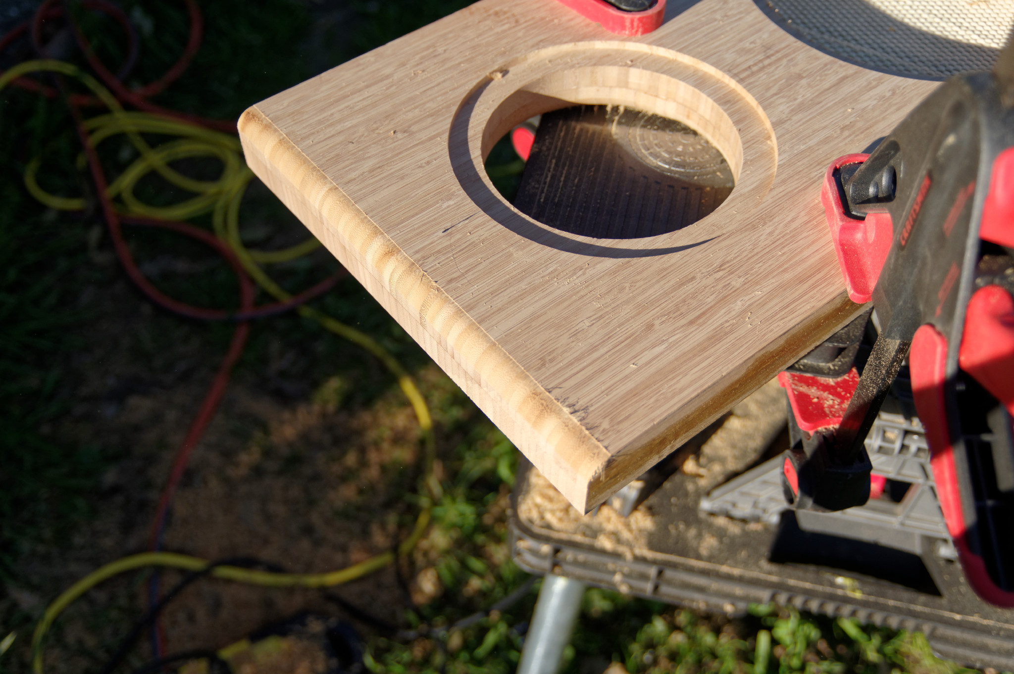

    Time for some old school work...
    This is so low tech, I'm almost embarrassed to post it, but ya gotta do what ya gotta do...
    Yes, we can build stuff with ordinary tools and a bit of foolish technique. Today was making progress on the front panels, finishing the hole cut outs and follow routing them smooth...

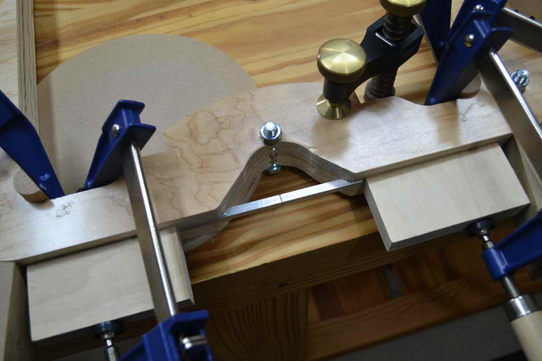

    Back relief for the driver holes, in two steps- first 3/4" rounder, then 1-1/4"

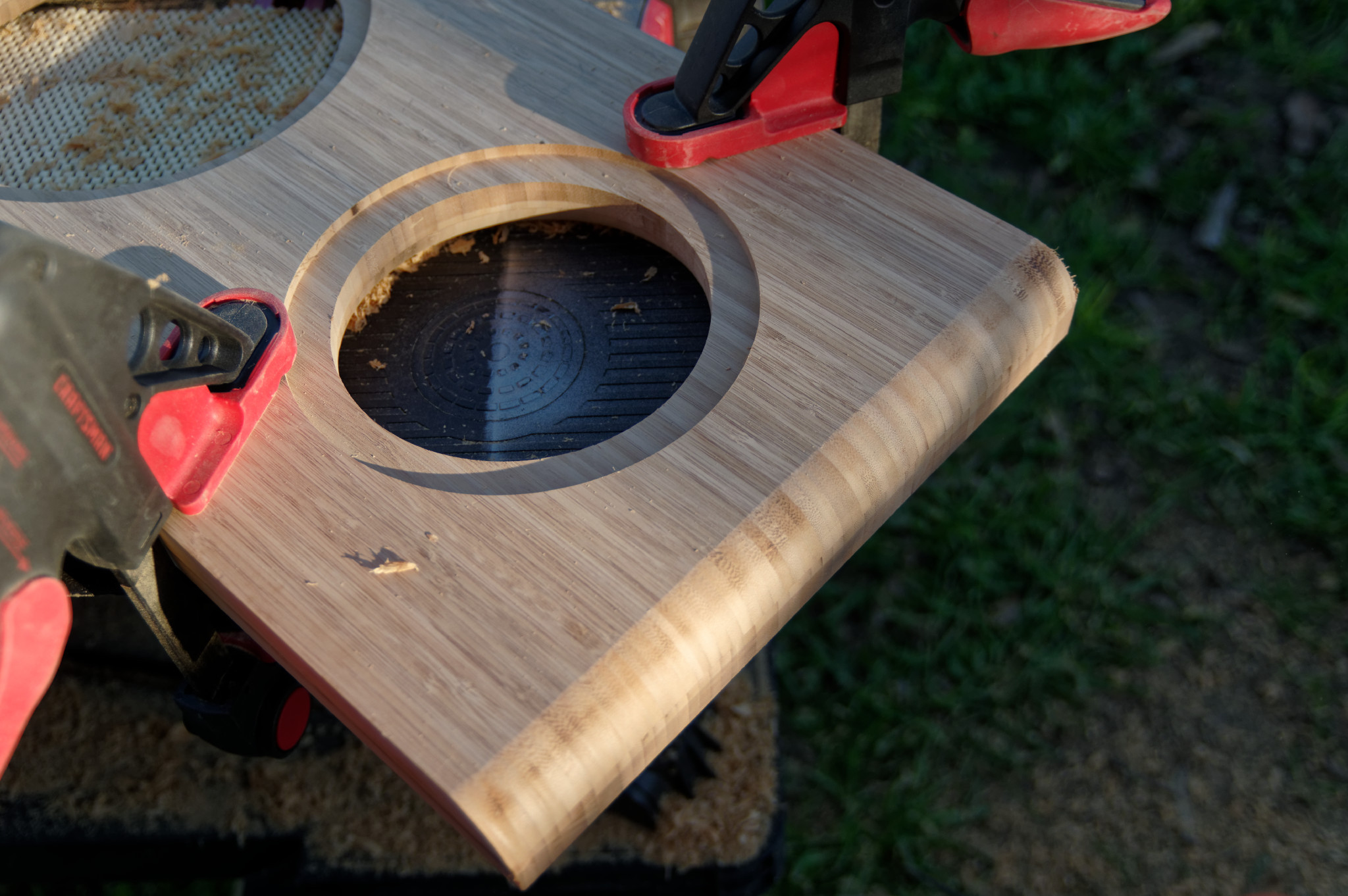

    And getting the top and bottom edges rounded over, same way.
    How I should have done this was with my router table, but I would have needed a new plate to clear that honking big bit, so I did it the old fashion way hand held. NOT recommended, only for the fool hardy and careful, with sharp bits, low rotation speed, and slow careful feed.

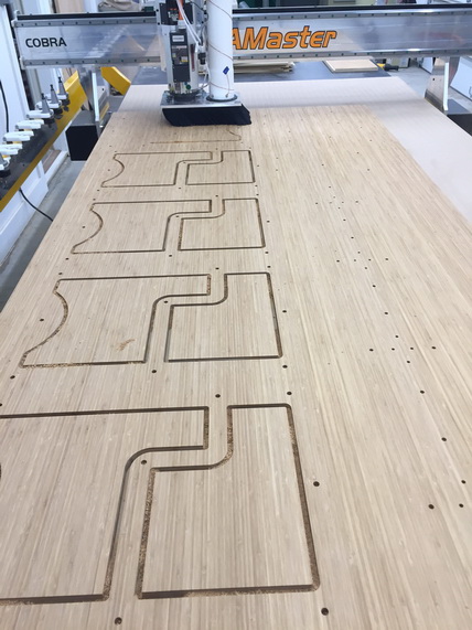

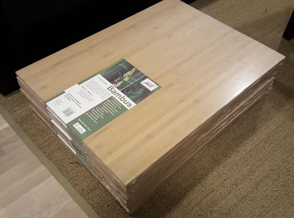

            I got the bamboo sheets today - so material ready now. Did not need a forklift, but weather this economy plan will work out is yet to be seen of course.
            Really itching to get some sawdust flying. May be I can start this weekend already, but not sure yet.

              That's a nice looking stack of bamboo. Steve said the batch we got in at his vendor was about 1300 lb. - that's forklift territory in my book- especially after having dealt with a stack of 4' x 6' for the Isiris build a few years back. Do you have some similar size lower cost materials to do test cuts with, or is your system already well sorted out?
              Steve tells me our vendor may get to this job later this week... I'm on pins and needles to see how it turns out. Your cutting plan is very efficient for wood use... ours is efficient for vendor use- he'd probably flip out to have so much intricate work. I hear from Steve that his normal jobs are cutting pieces for cabinet builders, and I think that goes pretty fast on a per sheet basis.

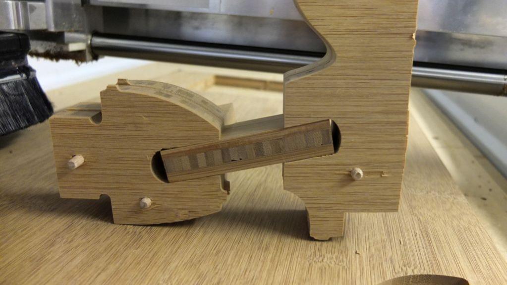

                I plan to first make a pass with cutting 2 layers worth of corners and either some or all of inner panel pieces and then check the fit etc. I have two 400x800 pieces I'll use as test material (same LBL).
                Then if all seems good and the slot for separator and dadoo holes get right cutting parameters I'll cut the rest. Will try to leave front panel and side panel pieces to later as it is easier then to cut them smaller and larger according to the true box measures after glue-up.

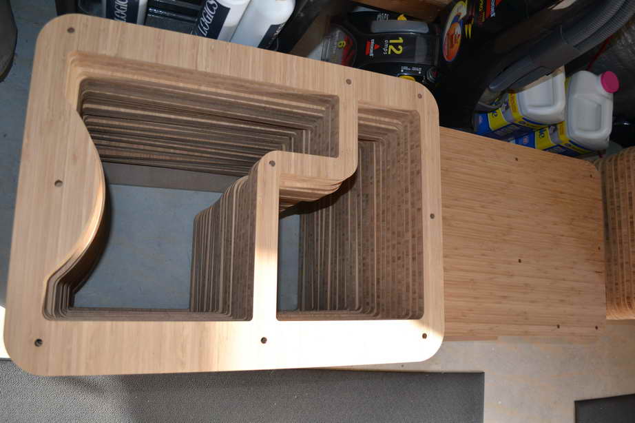

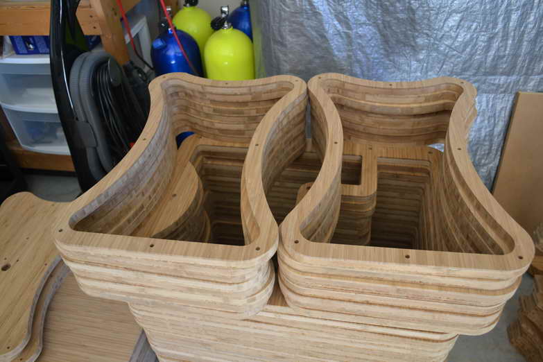

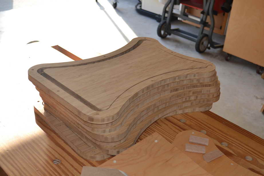

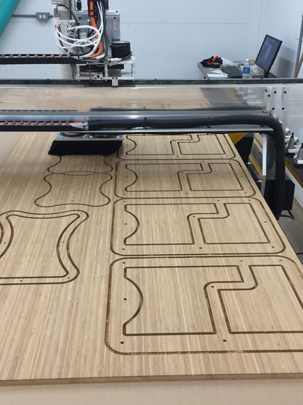

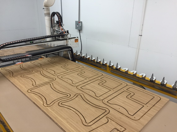

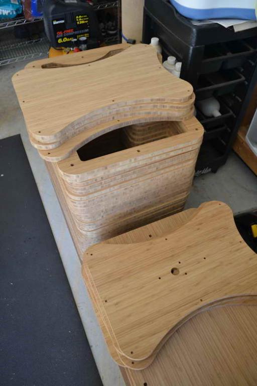

                    At Long Last ...... Parts

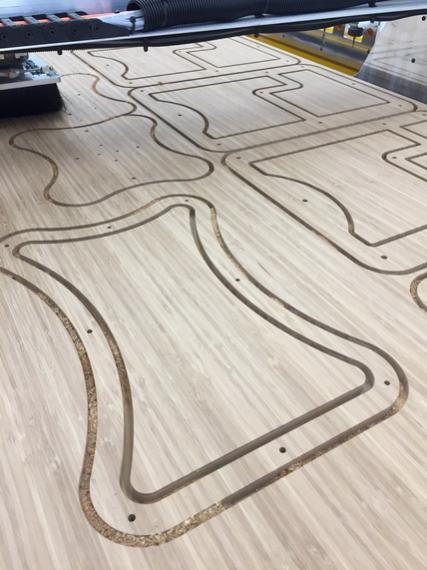

                    Finally got the issues worked out with cnc preparations and all the parts have been machined. The guy took some pictures in process, he started at 2 am ...... I was not there. 8O ..... I know where's you dedication ...... what can I say.

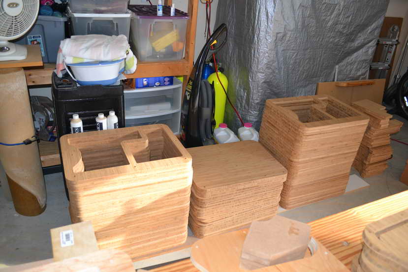

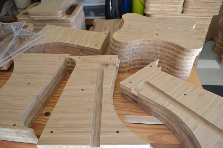

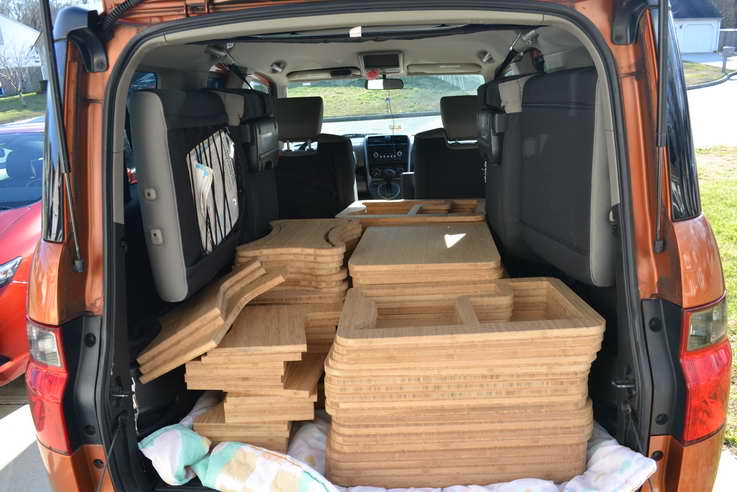

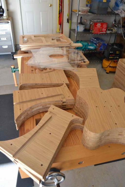

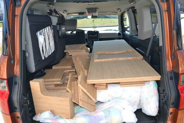

                      Picked up about 2/3 of the parts and got them in the garage this afternoon ...... going back for the remainder tomorrow.
                      All I can say is ..... these things are going to weigh a ton when there finished. 8O
                        • 4153
                        #146
                        HOLY $H1T! That's a lot of speaker wood!
                          • 571
                          #147
                          Very nice...you must have felt like an expectant father
                            • 698
                            #148
                            Very cool 4 speakers worth is a lot of material indeed.
                            These speakers are no tiny ones either. I printed out some parts in 1:1 scale from time to time to get a feel of whats the size in real life.
                            CAD drawings on screen can be zoomed in and out so easily that it's sometimes hard to envision the actual size.
                              • 2129
                              #149
                              Yeah Scott, I think you summed it up ..... I was very pleased, we only lost one piece during cutting and I had got an extra sheet just in case, so we were covered. With all those pieces I figured that was pretty good. As an FYI, we also found some voids in the material like you had experienced, no cracks seen, but I have to look over things a little closer. Got a bag of lbl dust that can be mixed with epoxy if needed to resolve that.
                              Your right Ergo, these are not what you would call bookshelf size speakers, the drawings are very misleading. Being 24" X 18" X 15", they are on the stocky side of things.

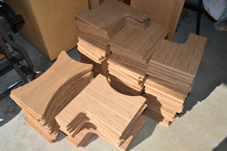

                                    Picked up the remaining parts today ......
                                    The super .....
                                    Stand Parts

                                      More stand parts .....

                                      Just for you Darrell ....... got all the drop outs. That's a major pile of wood in of itself. 8O

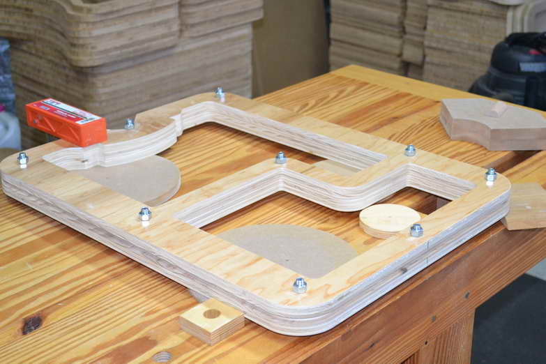

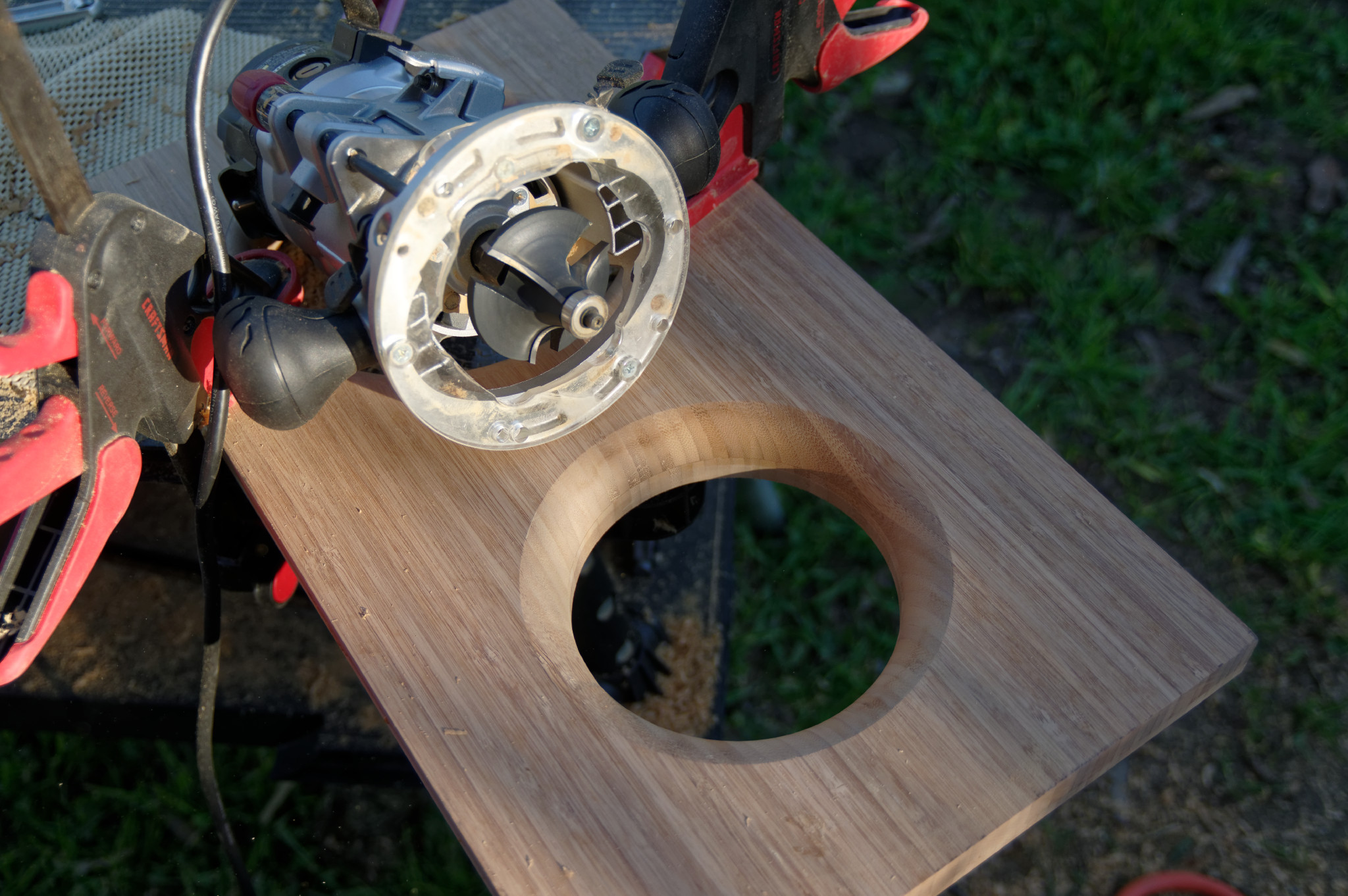

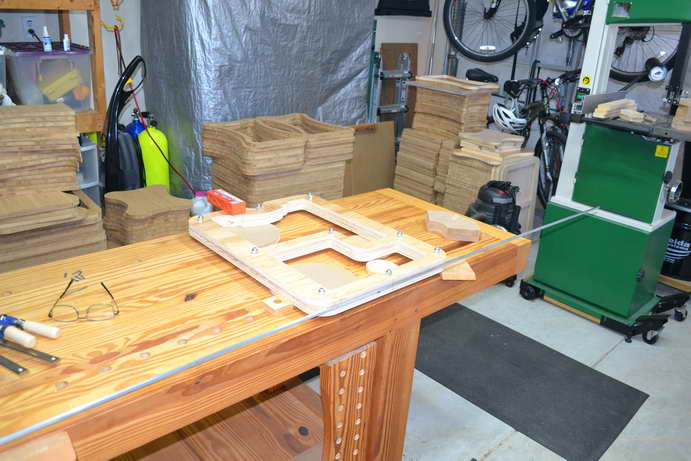

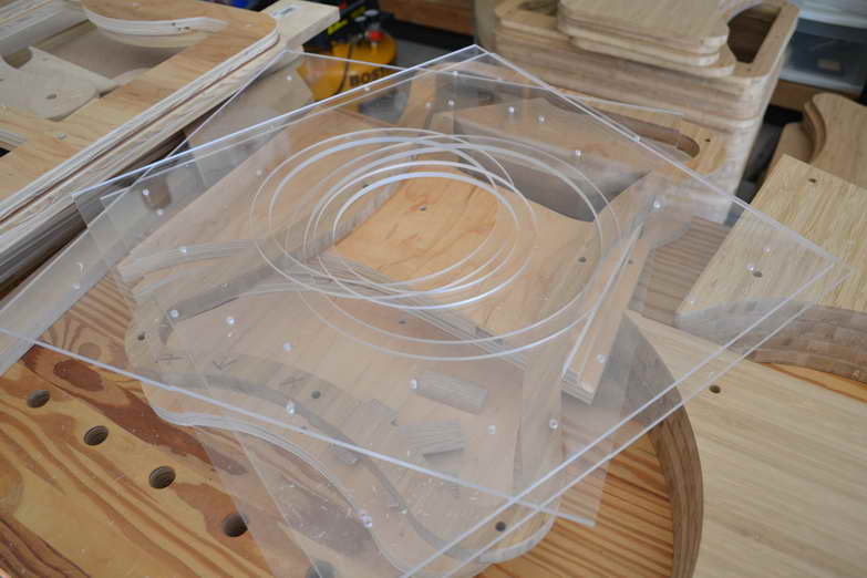

                                      Got some templates made for routing the driver cutouts.
                                        • 571
                                        #154
                                        Steve...good call on the templates...I would be mighty nervous with a circle jig :E
                                          • 2129
                                          #155
                                          With the front being 2 1/2" thick and the rear 2", I felt the Jasper jig was not the way to go. So guide bushing and template seemed to make sense.

                                                This is the part of a project where I sometimes have a love/fear relationship- I love the progress that's been made, I fear that I might slip up and incur unexpected yield loss! I have a lot of confidence in your steady hands and past successes, though! :T :B

                                                  Perhaps enough wood for some smaller (read more affordable) versions based on the Seas L12RE/XFC

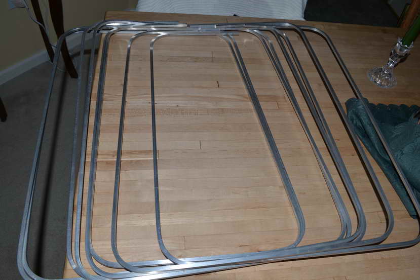

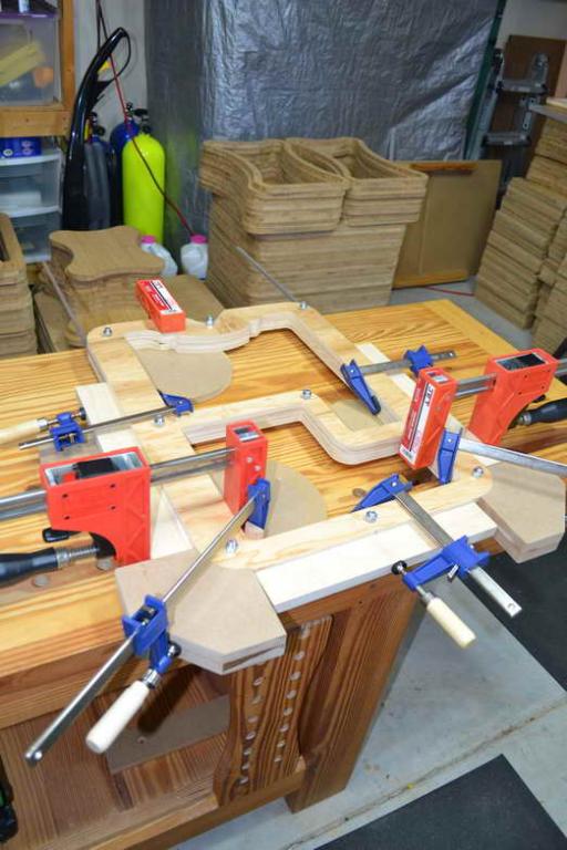

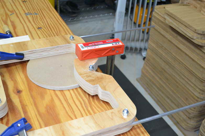

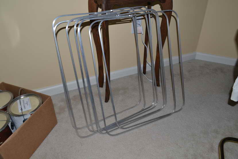

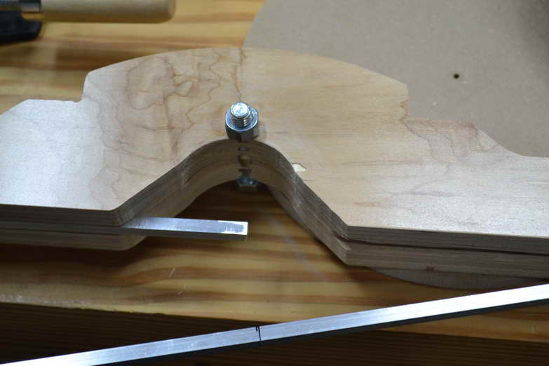

                                                          Some of you have noticed the aluminum that will be used as an accent trim on the cabinets and the stand. Since solid material, though easier to work with, was too cost prohibitive, in terms of material and machining to use. The alternative was to go with more or less and inlay. I worked on getting that bent into shape today, at least the process. The bending jig was made from some of the test pieces from the cnc tests.
                                                          1/4" X 1/4" X 8' aluminum stock setup for bending ......

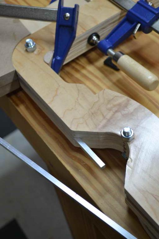

                                                          I made some cauls to keep aluminum in place around corners ....
                                                          Part way through the bending process .....

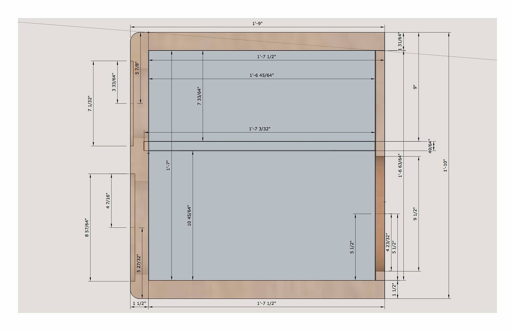

                                                            I’m doing some pathetically low tech stuff today out in Storage Shed AKA Wood shop, sanding the seams on the 12” LBL boards that I epoxied on edge to make 24” wide pieces for the second layer of the sides, and routing the panel rebate for the front to back baffle separating the woofer and mid chambers.

                                                              • 2129
                                                              #165
                                                              Getting close to the end of the bend process ....

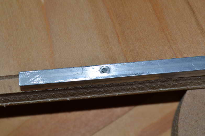

                                                              Trimmed to length ....... trim will be welded to finish things.
                                                              Since there is some spring back in the aluminum I might be using some brad nails to hold things in place in the rabbeted grooves. Drilling a 1/16" dia. hole in the aluminum and tacking a brad in place worked pretty well for that.
                                                                • 571
                                                                #166
                                                                That is too cool Steve...great innovation :T That ring is going to pop! (...look great )
                                                                  [ATTACH]n44147[/ATTACH]Click image for larger version  Name:	SideViewDimensions_zpsvicf3muv.jpg Views:	0 Size:	156.8 KB ID:	943498
                                                                  Hey Jon...there's nothing wrong with the low tech approach...it's all good...keep it coming :T
                                                                  Anyway, it's better then what I've been doing...reworking stuff, though nothing major. I hope to have updates tomorrow.
                                                                    Thanks Scott ....... I'm hoping that it turns out like I have it envisioned in my head, I think it will be a nice contrast with the bamboo.

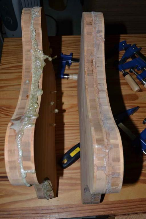

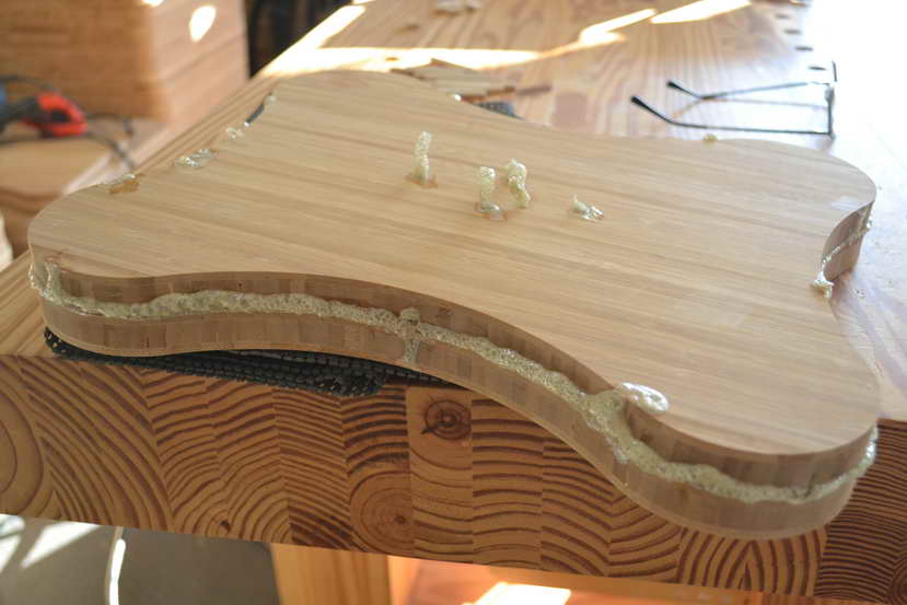

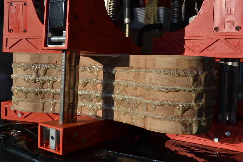

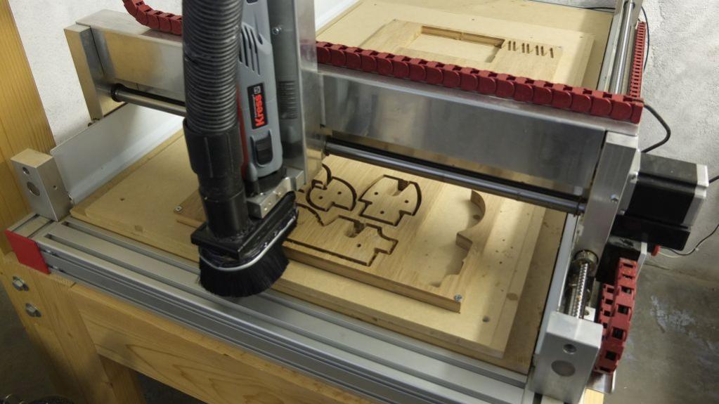

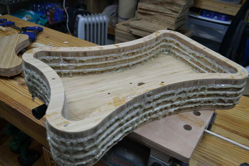

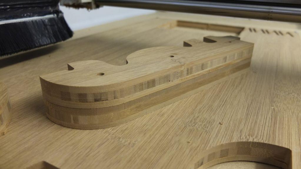

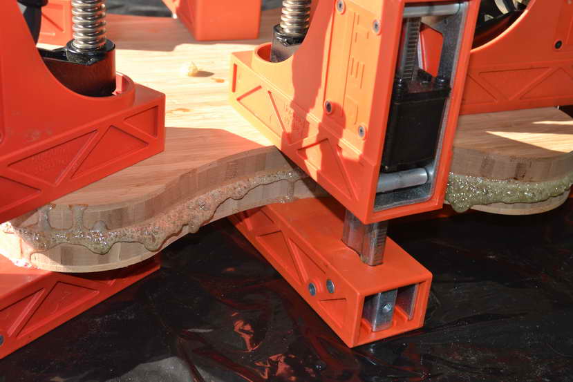

                                                                          I did some progress today too. Some useful learnings... like that the LBL I get here which is sold under German brand does not seem to be quite same high quality as what you guys got in US. There are more small cracks and holes in inner layers, so I probably have to sort all and use the best looking ones for front side and ones with small cracks on back side etc. Most likely I can patch those with epo and dust, but still.
                                                                          For bigger backside corner it's evident that the better results comes if the piece is cut so that longer cut matches the inner layer grain direction.
                                                                          Also I got a better cut quality if I cut the firts pass only 1mm deep versus 3mm that I tried at first. The intermediate cuts work well also with 3mm in each pass.
                                                                          Flickr/
                                                                            • 698
                                                                            #172
                                                                            Steve - great job on the alu bends. Now I see that you've really thought everything through and the bulge on bottom of the box was actually for making a better bending jig
                                                                              • 2129
                                                                              #173
                                                                              Looking good Ergo ..... I'm also seeing similar voids in the stuff we get as well. My understanding is that most of this stuff comes out of China, so we might all be in the same boat if that's the case. It's certainly not something I was expecting to see though.
                                                                              The bulge at the bottom is there for volume adjustment of the woofer section. With it not there there was too much volume so I played around a bit until it was correct. Also helps with keeping the sides non - parallel, which is supposed to be a good thing. Just happened to work out in my favor for added strength of the bending fixture.

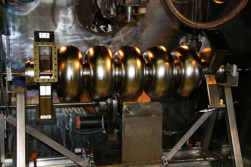

                                                                                Nope, I'm not a welder, unless your talking about using an Electron Beam Welder, then I'm your guy ...... I have a guy that I used to work with that is a master welder that is going to do these for us.
                                                                                One of my projects from my old job .....

                                                                                      Small update ..... got all the trim pieces for the cabinets bent to shape and ready for welding.
                                                                                      Trim work for stands will come a little later since they do not need any welding.

                                                                                          The gluing begins ......
                                                                                          Had some good weather the last couple of days, so I was able to open up the garage and got some rough sanding (80 grit) done and started on the gluing process.
                                                                                          First two pictures are of the top of the stand .....
                                                                                          Next two are of the stand bottom/crossover compartment. As Tom noted earlier, this stuff makes a big mess. 8O
                                                                                          The good part of this glue however, is the clean up. The part on the right was after ~90 seconds with a putty knife. Trade offs ......
