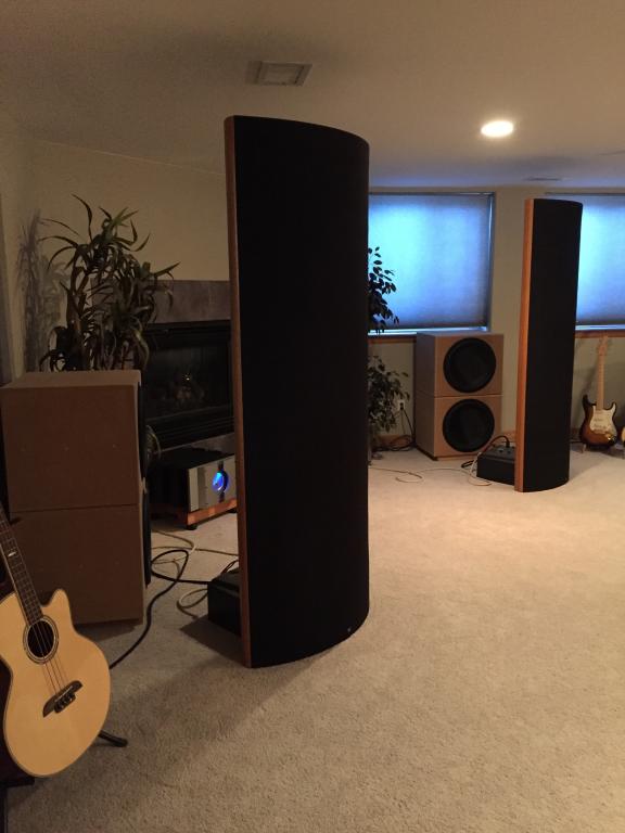

                        Plastic Resin Glue (urea formaldehyde) is great stuff and I'm pretty sure you'll like it... if I am doing any lamination work it's my first choice. I built a bed for my daughter using a large bent lamination for the support out of cherry that I ripped into thin pieces and laminated with Weldwood® Plastic Resin Glue and it's held up for nearly ten years under significant stress without any problems at all and the 20 glue lines in the laminated pieces are nearly invisible!
                        Speakers are Soundlab M-1 electrostatics with updated panels and transformers. http://www.soundlab-speakers.com/millenium-series.html
                        My DIY speakers are in the home theater keeping my 8 Aurasound subs happy!!

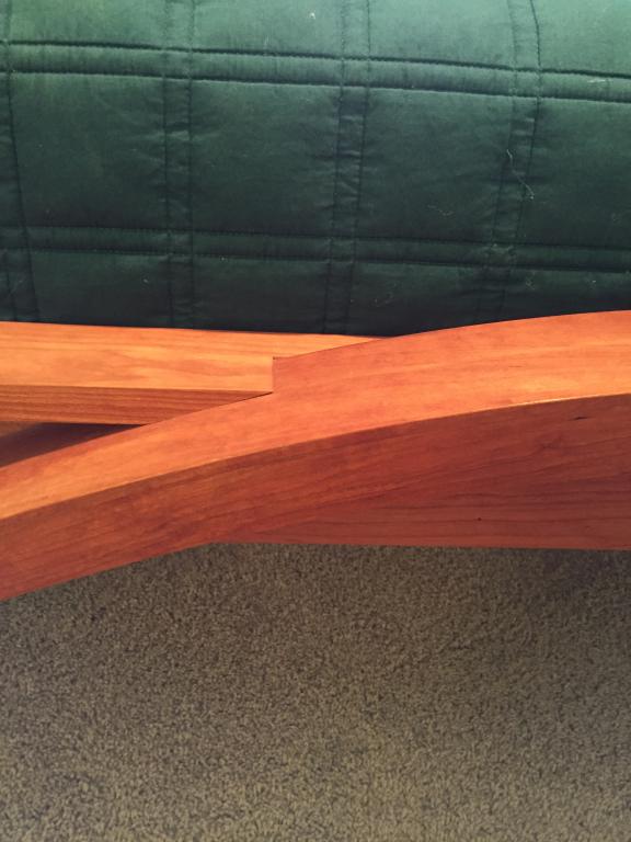

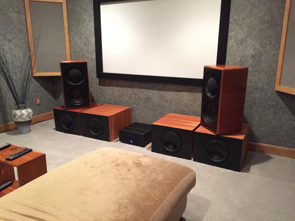

                                  Yhea, sure... as if any of that actually exists;-)

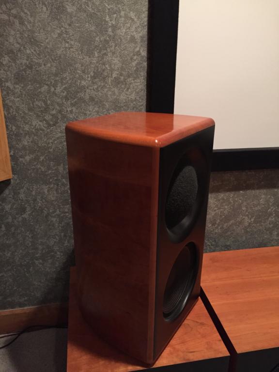

                                  Well.... since the gauntlet has been thrown down:
                                  Home theater with Geddes Abbey12 and four of the Aurasound subs:
                                  Close up of the Abbey 12 with curved laminated 1.5 inch thick sides (alternating 1/8 inch high density mdf, 1/8 inch plywood, and finally 1/8 inch re-sawed cherry):

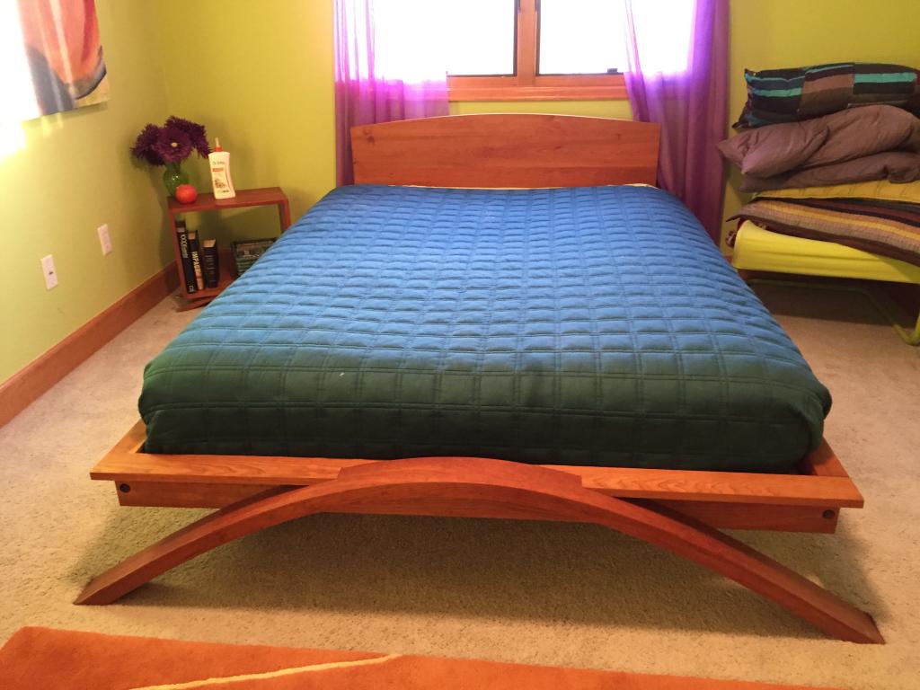

                                  My daughters bed:
                                  Close up of arch which is 2.5 x 5.5 inches consisting of 20 1/8 inch re-sawed cherry pieces:

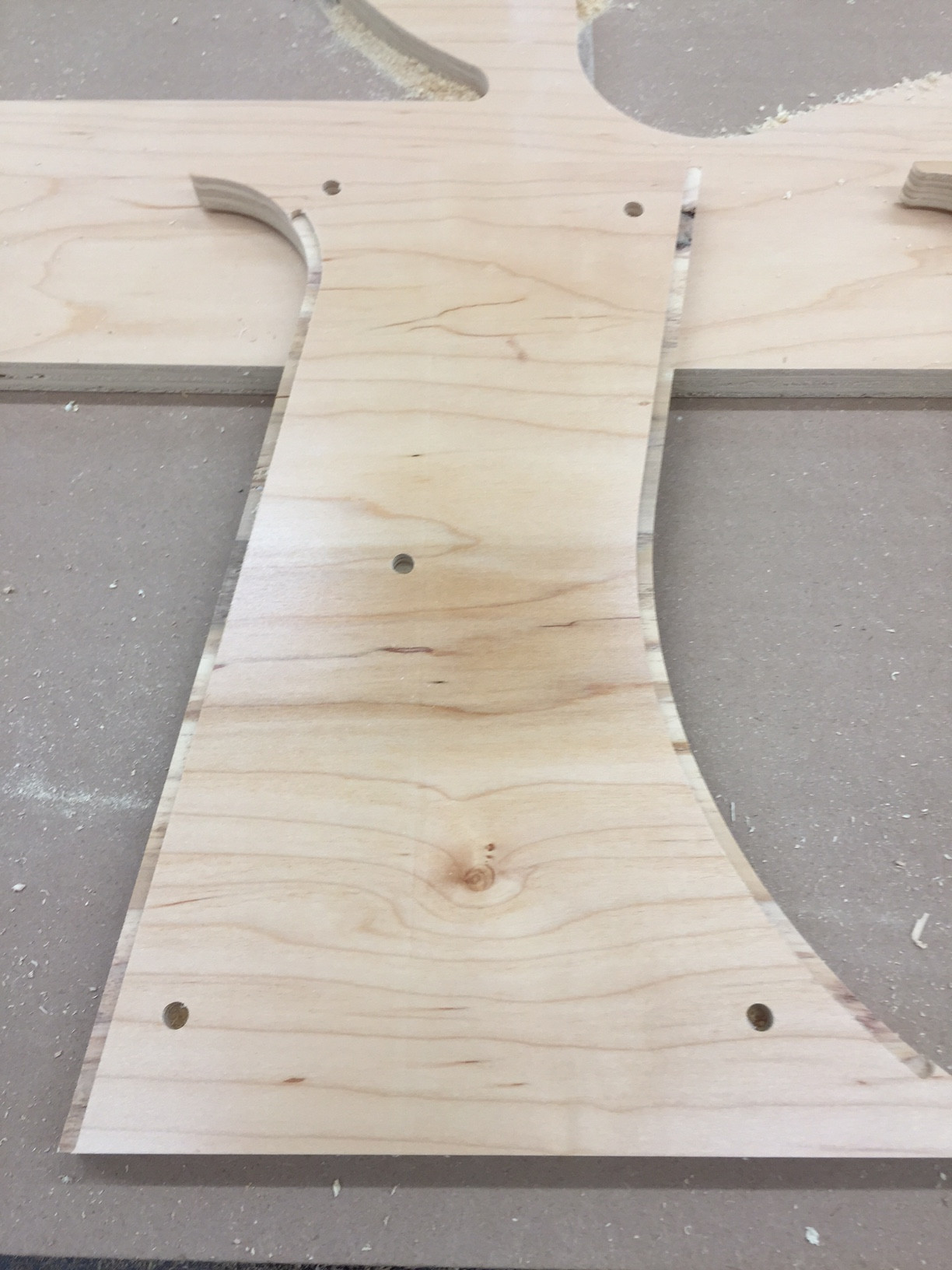

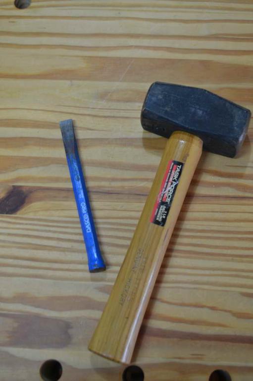

                                              Abuse Time
                                              Time to see how the glue holds up .......
                                              Implements of abuse ....... 3 lb hammer and cold chisel :twisted:

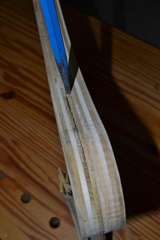

                                              Next I set the chisel on the glue joint and tried to separate the pieces. Wood cracked elsewhere and joint remained intact.

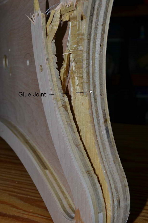

                                                Second part up ..... one has glue on one surface of the joint.
                                                Hammer up ...... Board did not like the hammer, glue joint held fine.
                                                Chisel on joint and the board split to the left, glue joint still happy.
                                                Conclusions? Is it the best choice of glue? Seems to hold up, at least in the short term, in this type of application, pretty well.

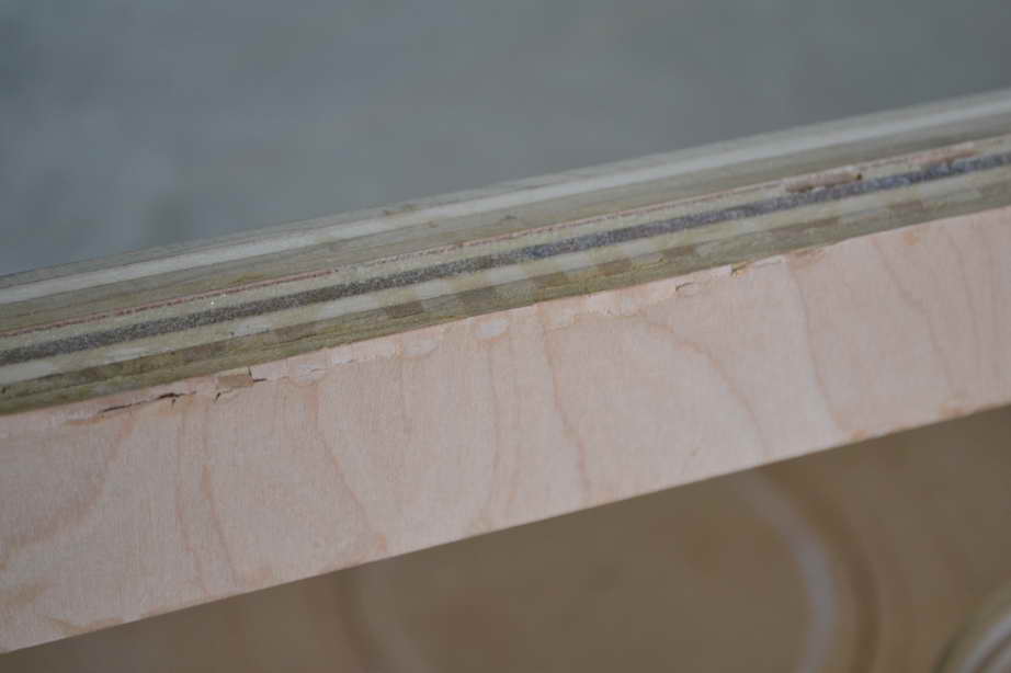

                                                                Great you guys are happy with your Glue. I just wanted to see how this stuff performed.
                                                                Well like the movie Iron man when Tony says " Your still taking me to school 30 years later" my old man loved Weldbond.
                                                                Made a cherry hammer to test Weldbond note this is a 15 year old bottle that says it's good for 5 years. The glue was added just at the end and only one clamp to simulate a poor glue joint. Glue on a dense wood doesn't absorb into the wood fibers like plywood so it's shearing strength is jut it's surface grab. Here is the cherry hammer.
                                                                Hammered it twice full swing on edge of my bottom 3 point tractor hitch lower arm to see if it would pop it. no go. Then tried to shear it with prying almost full weight (I didn't want to fall over into the hitch though.) no go. notice hammer and wedge marks.
                                                                Image not available​
                                                                I then turned 90 degrees and pushed which got the glue to start snapping apart. Was the wood going to tear not likely it would snap the wood first with my test. When separated you could see poor clamping which started the glue failure. I would have no problem trusting this stuff as it is as least as good as epoxy and better then Tight Bond 1, 2 or 3. Easy to apply no mess. The wonders of Plastic glue. Not sure you can see the glue failure but the lack of clamp aided in it's failure.

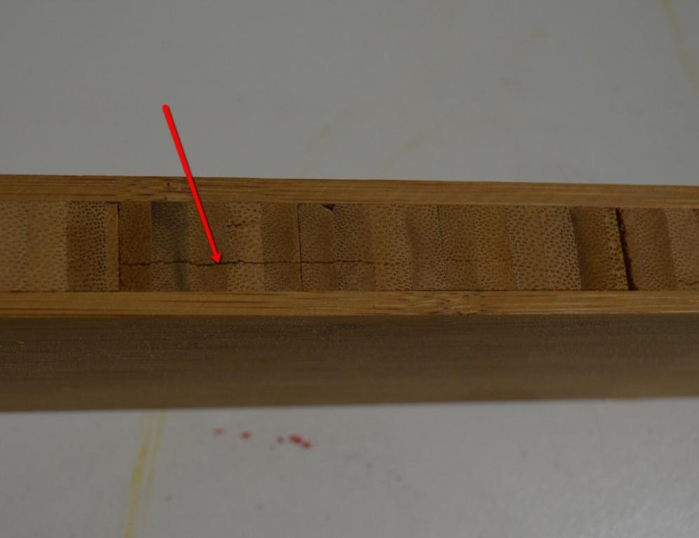

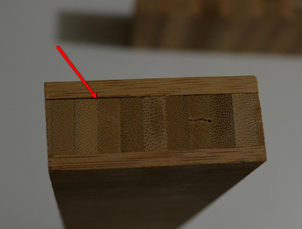

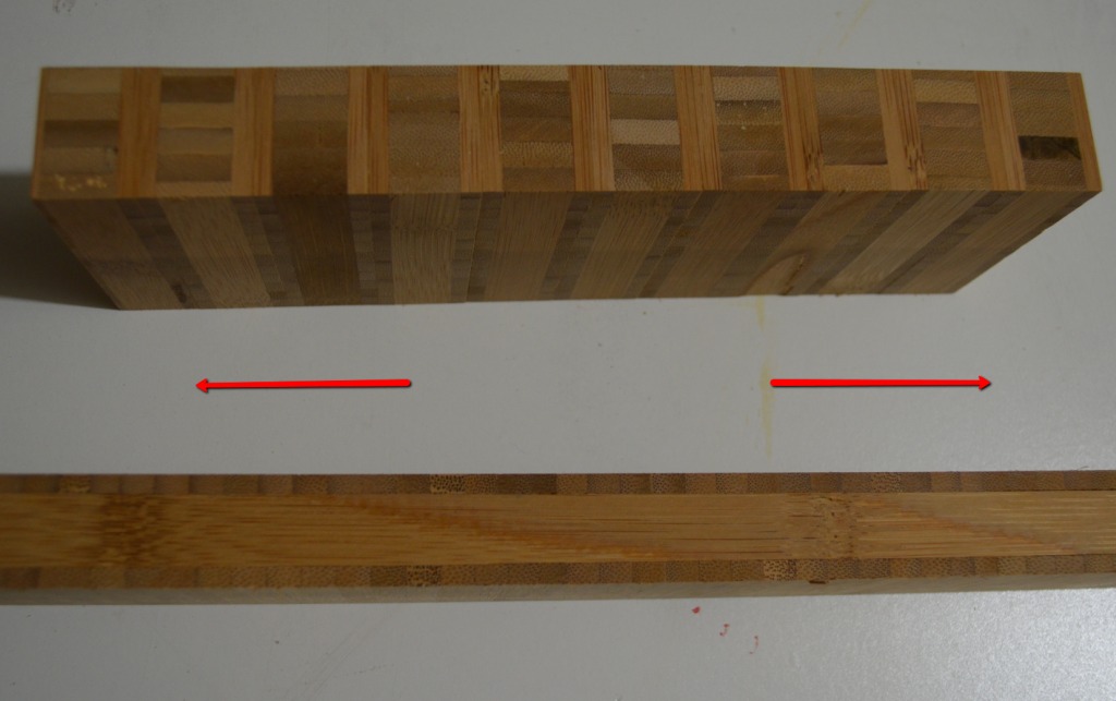

                                                                    Anyway below I show the LBL and and translam segment. Forces in the direction of the arrows or bending along the length would break the translam piece sooner as I showed earlier. Now with your build there shouldn't be forces in those directions. I think most glues discussed should work well....I just have a small concern for some of the internal irregularities I have seen. The next two photos show internal hairline cracks and where the outer layers are not glued too well. Now I don't see too much of this but it is something to watch out for.
                                                                    Hairline crack

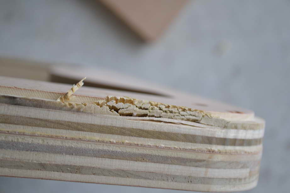

                                                                    Bad glue joint

                                                                      Thanks for your observations. Very rarely have I seen defects like you've pointed out, and I have been looking...
                                                                      My test this weekend should be more like DAR47's; I have both the TB Urethane glue and the Gorilla glue, now I'm looking to acquire some Weldbond, though that will likely have to be ordered online, too.

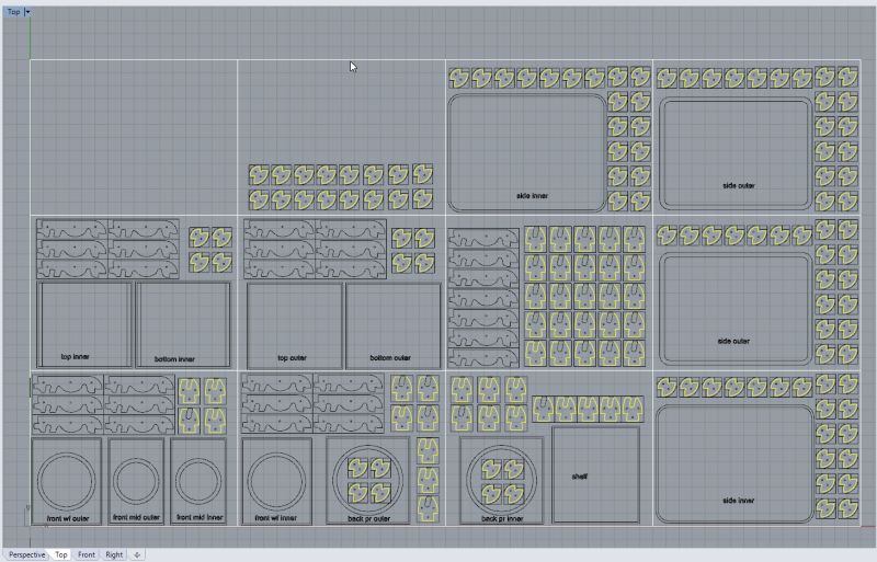

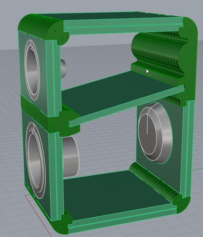

                                                                          #126
                                                                          Doing some progress also... getting there with my alternate CNC box style.
                                                                          I'll use more planar pieces all in all and will put a 2mm bitumen damping sheet between all planar outer walls. I've had this idea for a while and I think this is the time to try it.
                                                                          I did use a bitumen sandwich on my Modula MKII clones but only between double front panel.
                                                                          Also thinking about "decoupling the outer front panel planar pieces" by cutting those with some 3mm offset to inside. Then each of those panels would connect to rest of box only via bitumen. Filling the 3mm side gap is a bit of question then. Possibly filling with silicone type material would be ok as it will be elastic. Especially for the coax unit this would perhaps isolate it from woofer's mechanical action.
                                                                          With current go I'm getting by with bit more than 10x 600x800mm LBL sheets (but I do have 2 400x800 sheets already).

                                                                            Looking very nice, Ergo! :T

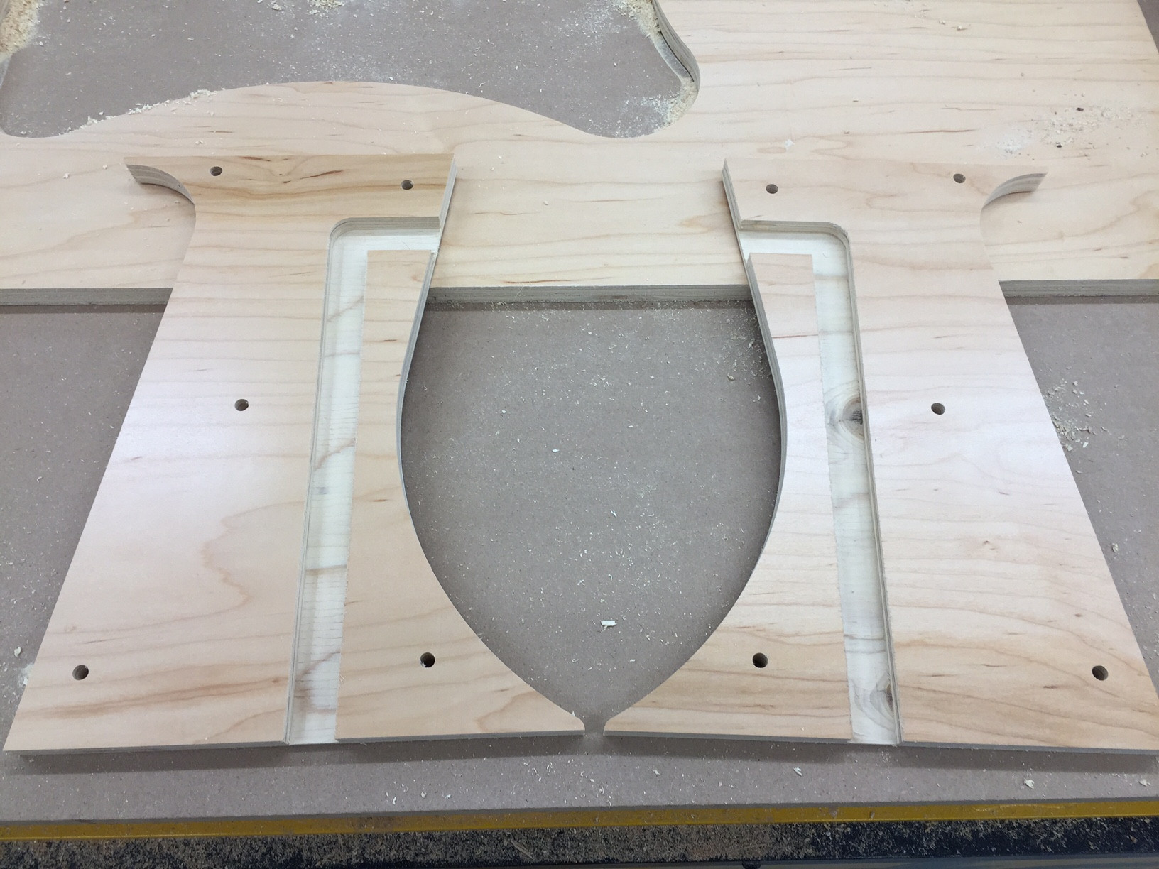

                                                                              Chiming in a little ....... just got back from the lumber yard with round two of test cuts (I'll get some pictures a little later), much better results than round one. As Jon noted I had to up the resolution for all the arc's in the drawings, considerably. With Sketchup, what looks good in a drawing does not always translate to good machining. In Sketchup circles are are a series of line segments, the higher the number of segments the smoother the arc. I upped the number of segments in a circle from 48, which looks reasonable in a drawing, but not when you machine it, to 360, which gave much better results.
                                                                              Ergo ... looks like your having fun. Jon's right, the guy I'm using would a small conniption seeing your drawing. We sat down for 2 1/2 hrs this week going through files to get everything laid out as needed just with what I designed.

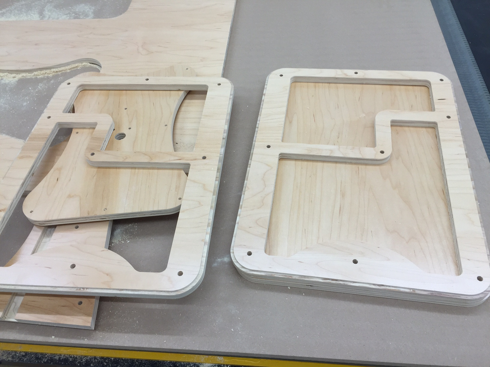

                                                                                Test cuts from our vendor- these are with the re-done drawings Steve prepared recently, and to his eye, it looks like they'll get the job done OK. (mine, too! :T )
                                                                                Main cabinet pieces...
                                                                                Outside piece on stand pillar...
                                                                                Stand pillar sandwich showing cable path...
                                                                                Needless to say, this is all fairly encouraging to me- looks like Steve has got things sorted out well with the vendor. At this juncture, it looks ready for the production cuts, after Steve inspects in person.

                                                                                  Lessons learned, we started with solid works, Industrial grade and the guy running the tool path made the drawing to adjust as we went along. I see now how this was well worth us doing the whole process. Keep plugging guys it's going to be great when you finally have parts in hand!

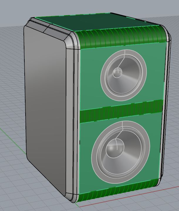

                                                                                    I can very well imagine the process from Sketchup to CAM. Been there done that too.
                                                                                    Sketchup is real good for concept drawings and architecture stuff, but not really for getting stuff machined later on.
                                                                                    This is largely the reason I got an educational version of Rhino 5 as that's really a full 2D/3D CAD that can do modelling. It is much easier to export from Rhino to CAM like Vectric ones as all arcs and circles are truly that etc.
                                                                                    This is what my wife can do for house modelling We are planning the terraces / outdoor kitchen area in back garden and this is the concept we have. With snow on ground now is a good time to plan ahead

                                                                                        #133
                                                                                        Steve / Jon
                                                                                        I see that on your plans you have a gap between side panel and main box frame. The 3D render has a shiny aluminium like look there. Do you have a plan to cut a layer of aluminium there?
                                                                                        If so, that would sure look very nice indeed.
                                                                                        I've tried to cut aluminium on my machine - that's even a bigger challenge than any of the woods. But I guess as anything it's down to experience and knowing bits/feeds/speeds again.
                                                                                          • 2142
                                                                                          #134
                                                                                          Yep, that's aluminum, though not a solid sheet. Even though that would be the easiest approach, the cost for solid 1/4" thick aluminum sheet, that size and quantity, even without machining costs being added, gets pricey in a hurry. So it will be 1/4" square material made into a ring.
