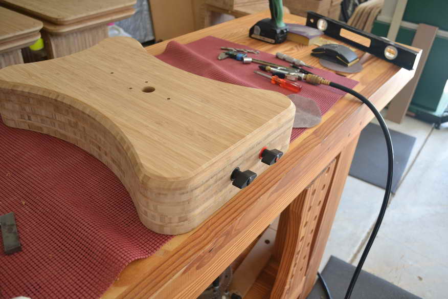

      Got the inserts in for the circuit boards so got those installed ....
      [ATTACH=CONFIG]25690[/ATTACH]
      [ATTACH=CONFIG]25691[/ATTACH]
      With wanting to make sure that I don't have an epoxy squeeze out problem and mess up the aluminum trim when the sides get attached, I've opted to go lite on the amount of epoxy and add some pocket hole screws to take up the slack .....

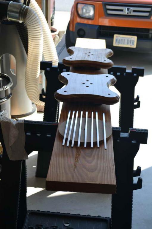

      First set of sides to get a coat of shellac .....
      [ATTACH=CONFIG]25693[/ATTACH]

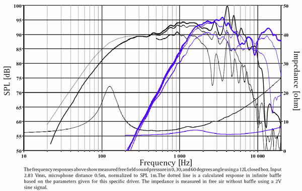

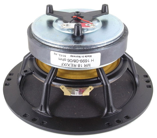

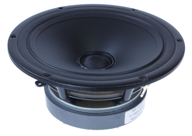

                        While doing a variety of online driver research yesterday evening I also came to the inescapable conclusion (supporting Ergo's earlier claim) that the C18EN001 has become a unicorn. That is, a mythical creature not available to mere mortals.
                        As I only have one pair of these, and have two pairs of cabinets in progress for this project, that does pose some unfortunate difficulties, but possibly not insurmountable ones- especially since I'd hoped this project could be of more use to others.
                        Enter stage left, another driver which I hadn't come across until yesterday evening... (Geez, I think I need to get out more; but actually I get out on the web a LOT!)
                        Seas MR18REX/H1669
                        One might say this is sort of a reed cone conventional basket and magnet version of the C18EN001- I've checked the mounting mechanicals, and they appear compatible to 2 decimal places (well, you know what I mean- to one mm anyway) and the tweeter response looks very similar, and the woofer appears to be even more sensitive, but longer throw? (Not really believeable, but who knows- still the surround is designed for midrange use) so I think we have a chance.
                        As a "bonus", it costs only about 40% of what the C18EN001 goes for....

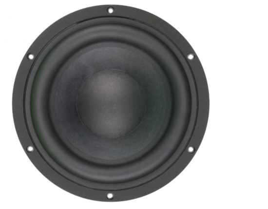

                        I'm also investigating an interesting lower cost alternative for the woofer... Still have some leg work to do on that.

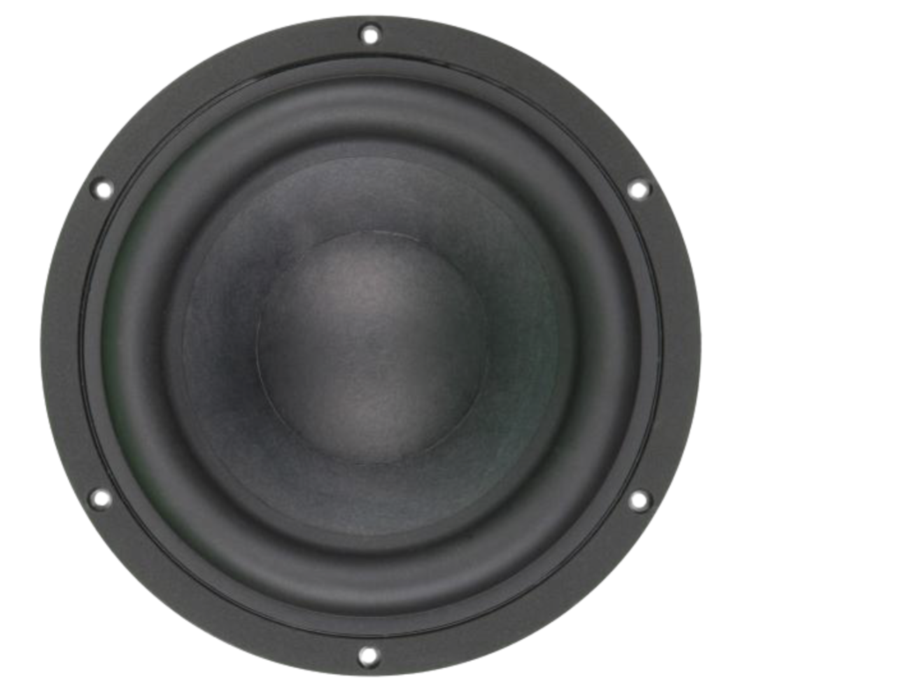

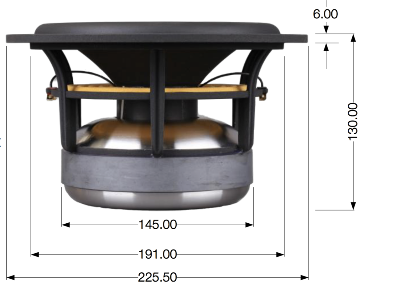

                              It's like the mid woofers I'm looking in to from Motus Audio- really neat designs, great pressed paper cones, underhung voice coils- but will they be around?
                              BTW, these are NOT less expensive than the Wavecors.... nice motor, though, and they have a very promising looking 6.2" and 7" model also - have some of the smaller ones on order already, should be here Friday.

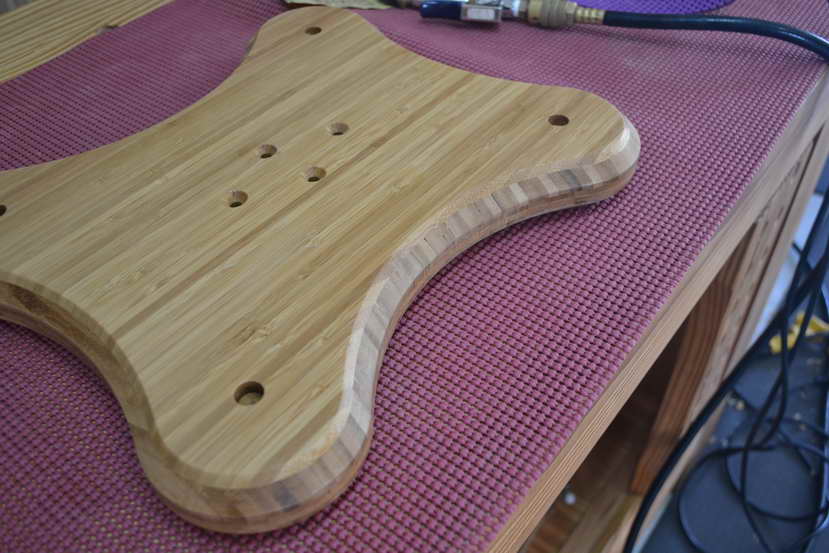

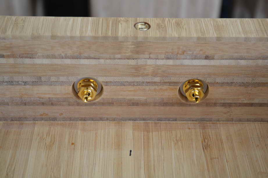

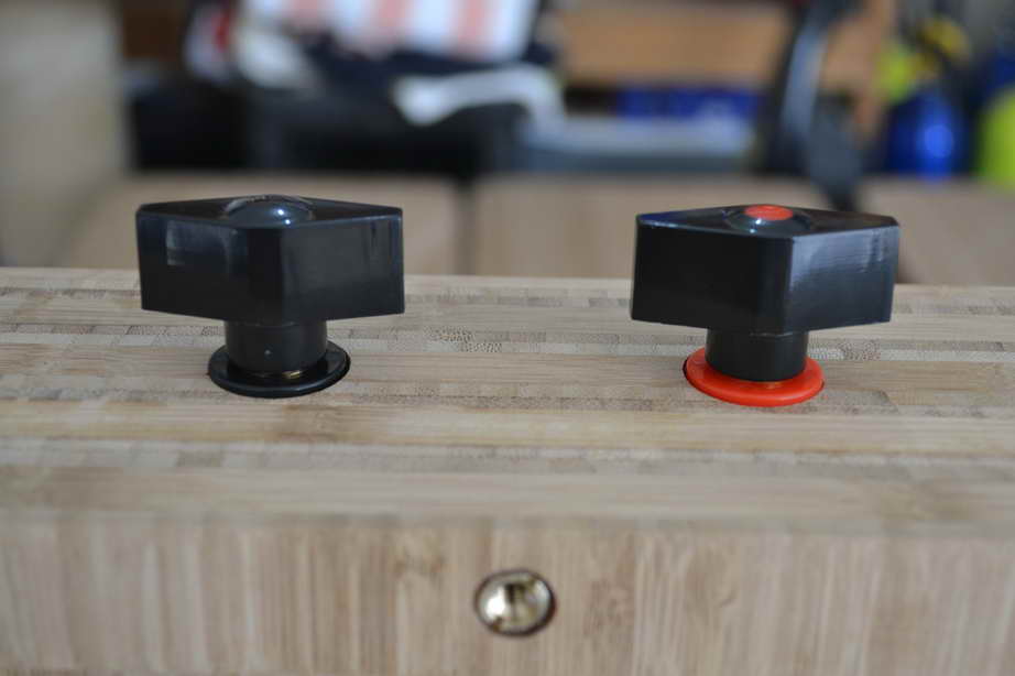

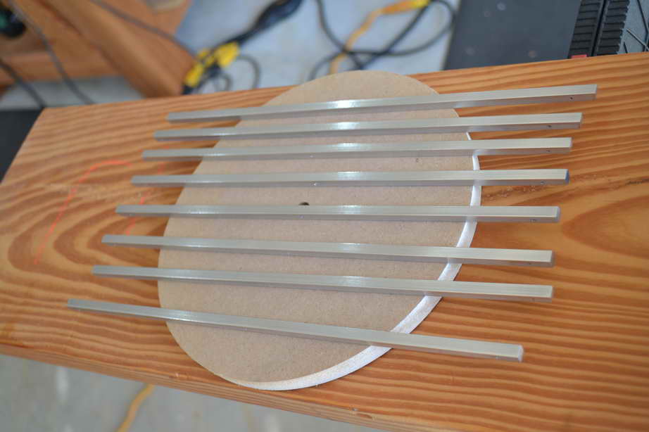

                                        Round one of the connectors ........ Got all of the holes drilled for the binding posts on the crossover section. The ones for the cabinet will be a different flavor, one for each of the drivers.

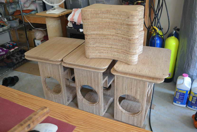

                                          Got the first batch of trim buffed and sprayed with clear coat ......

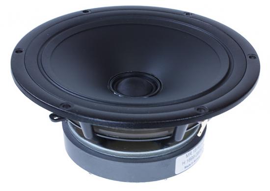

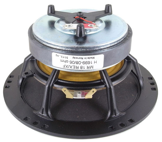

                                                                          Click image for larger version  Name:	s_seas_prestige_loudspeaker_coaxial_6.5_inch_18cm_H1699_MR18REX_XF.jpg Views:	0 Size:	42.2 KB ID:	943571
                                                                          Click image for larger version  Name:	h1699-3.jpg Views:	0 Size:	58.0 KB ID:	943572
                                                                          Seas MR18REX/H1669
                                                                          Click image for larger version  Name:	H1699-curve.jpg Views:	0 Size:	75.3 KB ID:	943573
                                                                          I believe we can all agree that the color of the MR18REX is far superior to that of the C18EN001... This alone may tip the scales.

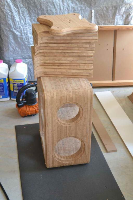

                                                                                A small update on the build .......

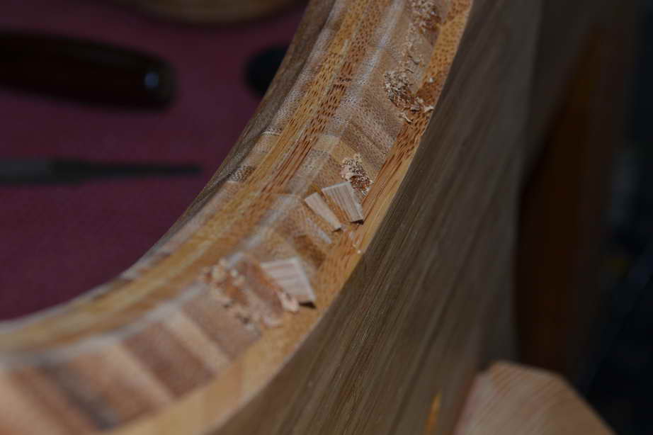

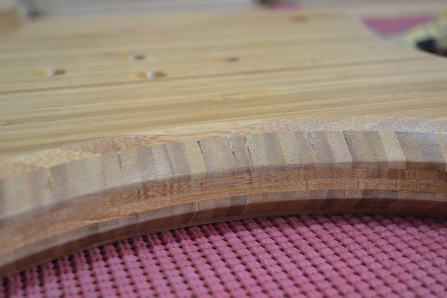

                                                                                A lot of void fixing has been on the menu of late. Not going to fix all of them that's for sure, or I'll never get done. Just addressing the worst of them, at least on the parts that will just have a clear finish on them.
                                                                                Before ....

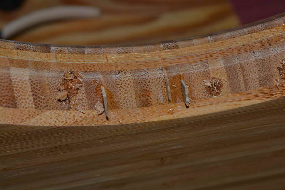

                                                                                After ..... not perfect, but better.

                                                                                      Fyi...I ran across a little review of the Seas MR18REX.
                                                                                      Interesting... most interesting...
                                                                                        • 2128
                                                                                        #628
                                                                                        Originally posted by sdl2112
                                                                                        Good job Steve...did you use epoxy?
                                                                                        Thanks Scott ..... nope, for this small stuff I'm using CA glue, this specifically, http://www.woodcraft.com/product/149...thick-4oz.aspx. A lot easier than having to mix up epoxy and less waste in the process. I'll be switching to epoxy for the bigger tear out areas on the cabinets though prior to shooting the finish.
                                                                                        • Beau
                                                                                          • 74
                                                                                          #629
                                                                                          Found these, wonder if they are legit?
                                                                                          Norway SEAS E0060-08 06 C18EN002 A mid-treble coaxial magnesium basin 6 5-inch speaker on sale,buy cheap Norway SEAS E0060-08 06 C18EN002 A mid-treble coaxial magnesium basin 6 5-inch speaker from the best shopping agent yoycart.com
                                                                                            • 16069
                                                                                            #630
                                                                                            He's selling from China, a lot of different items, and prices are high if in US dollars. I couldn't find seller ratings or any transaction history.
