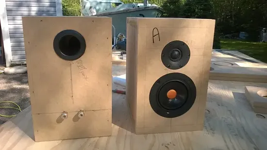

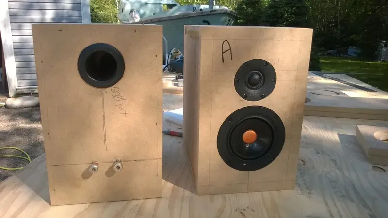

    V1 (complete)

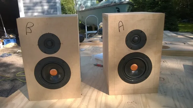

    Panel cuts:

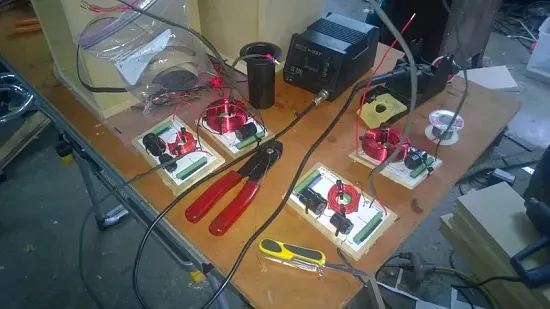

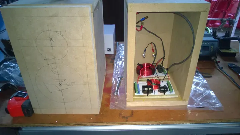

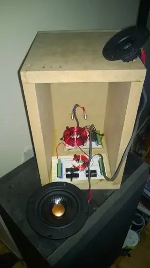

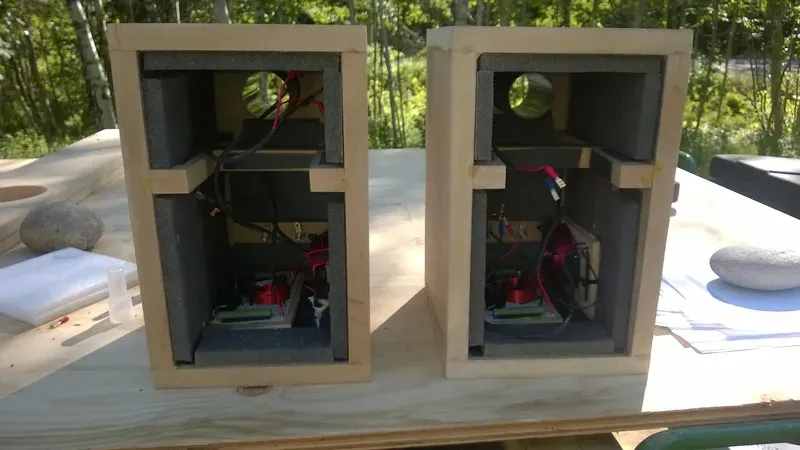

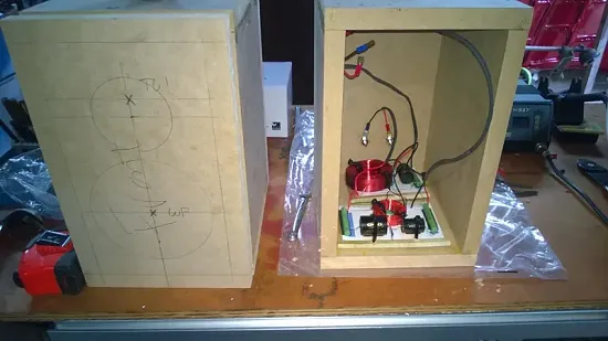

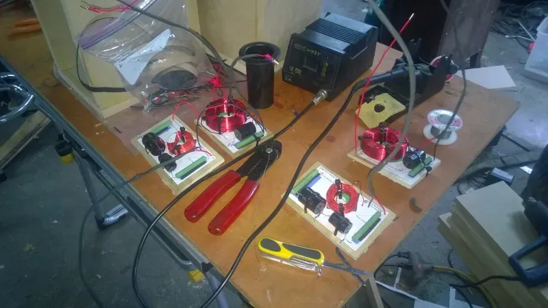

    Crossover building:

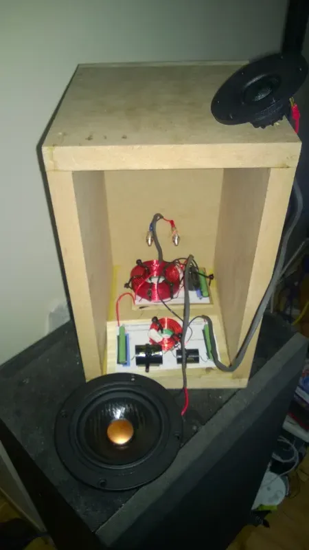

    Enclosure partly assembled:

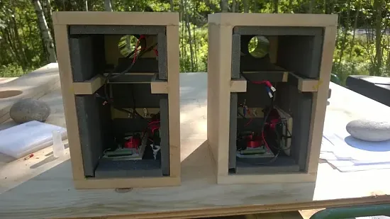

    Testing crossover:
    All work inside done:
    Ready for finishing:

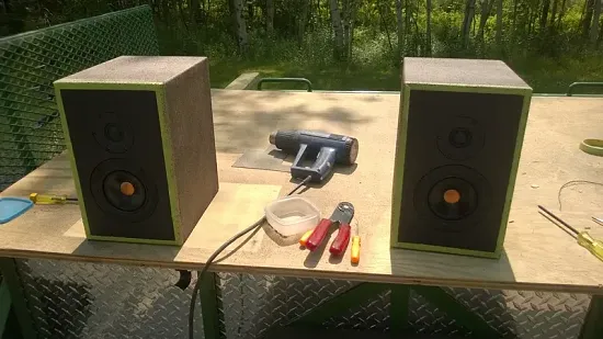

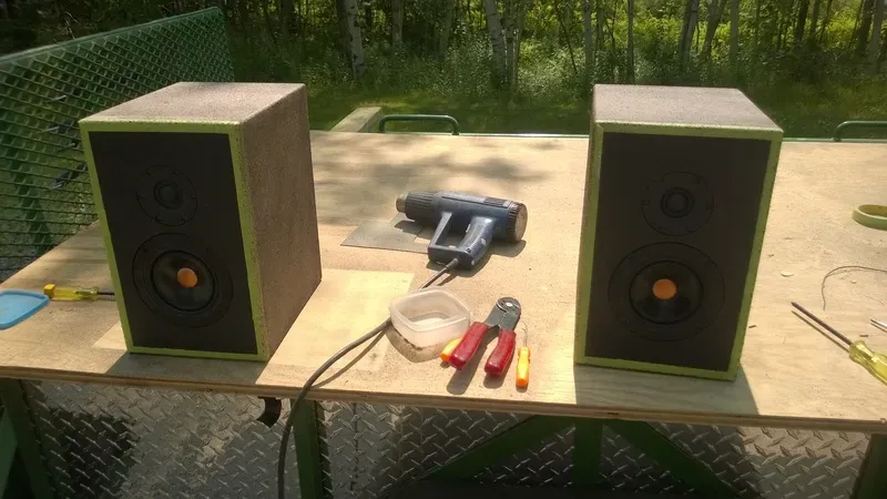

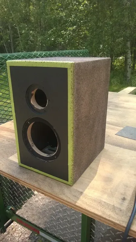

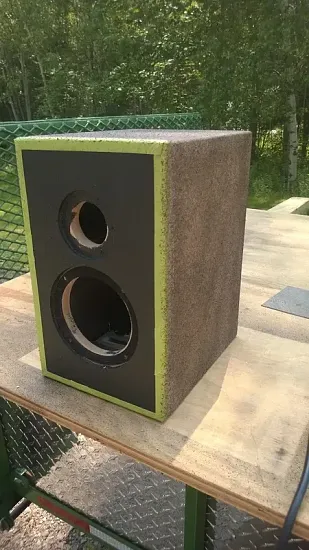

    Painting:

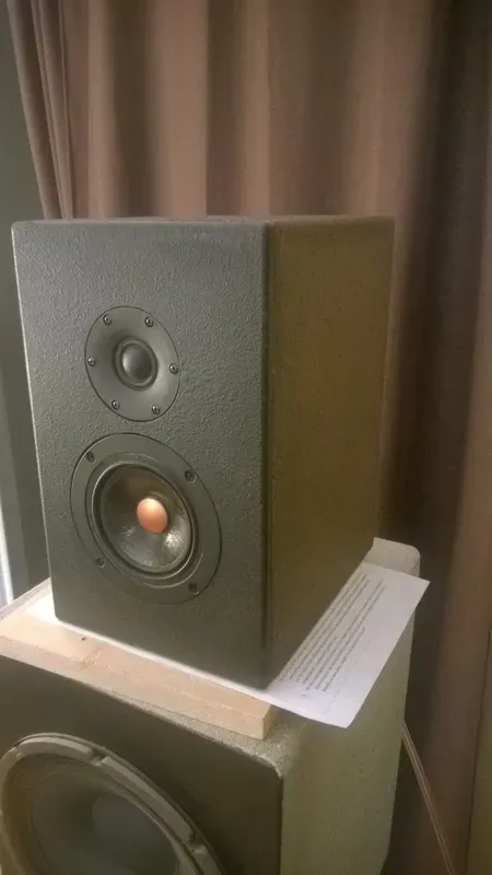

    Done:

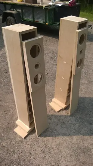

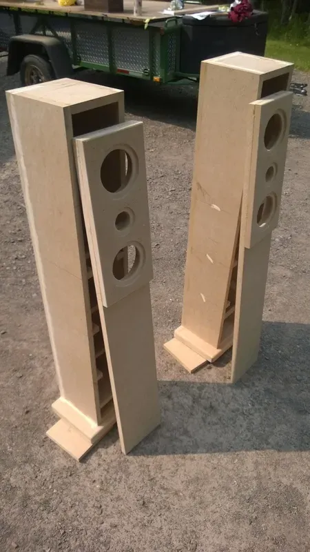

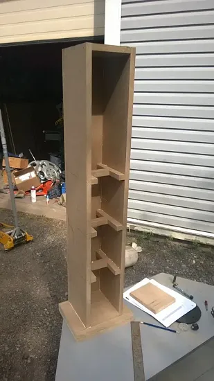

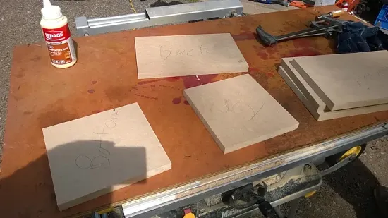

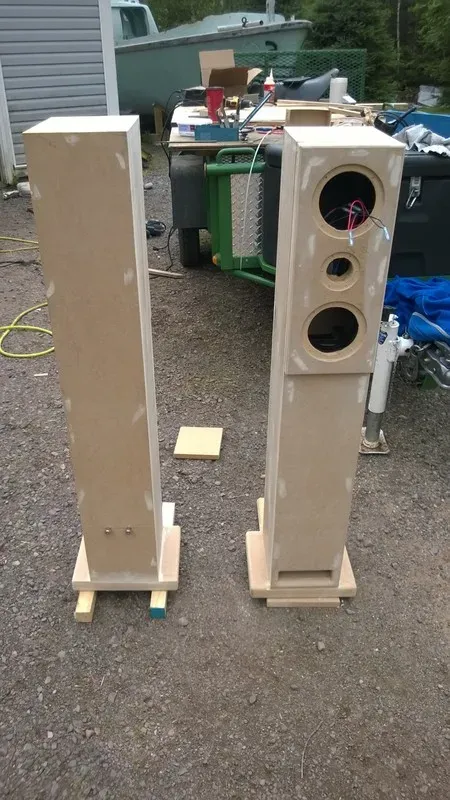

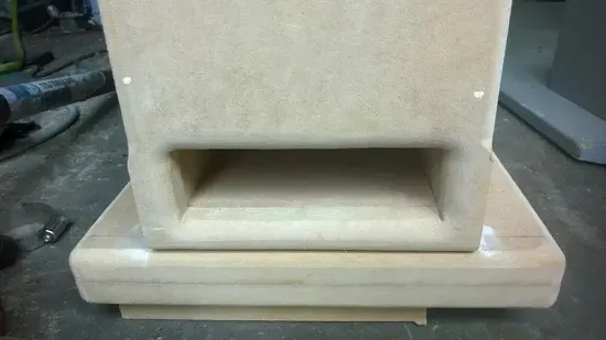

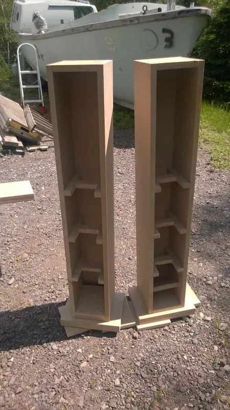

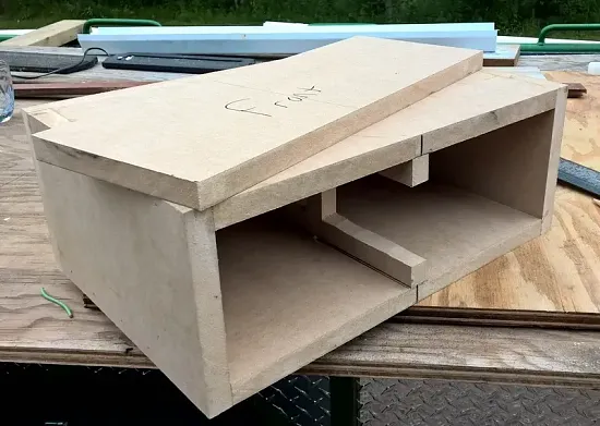

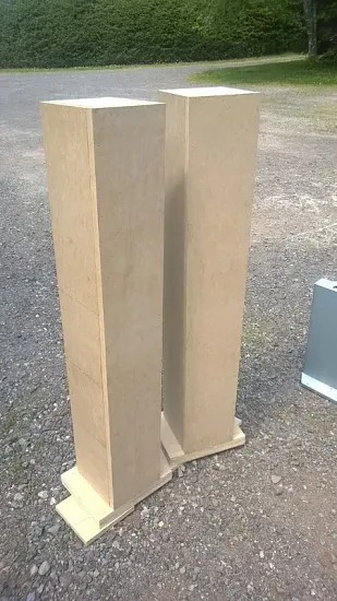

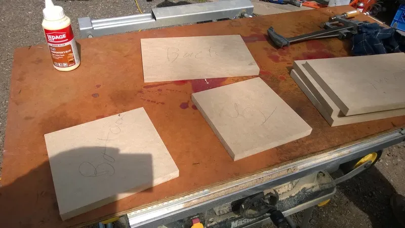

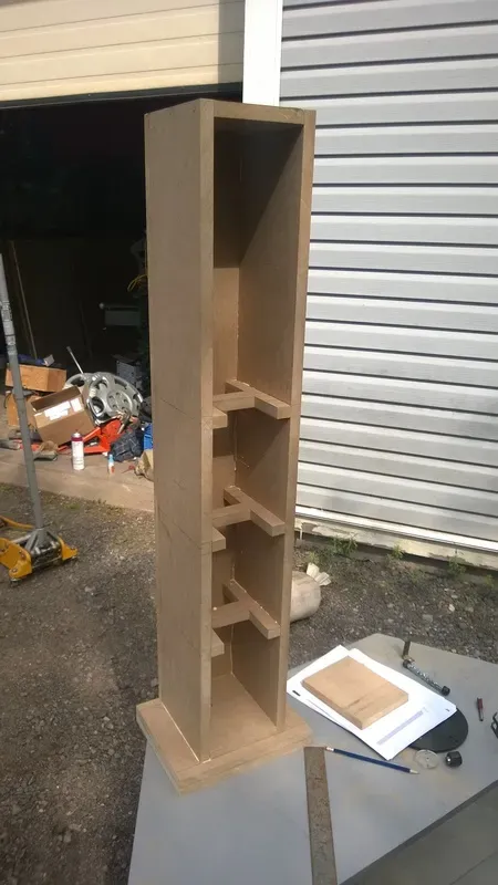

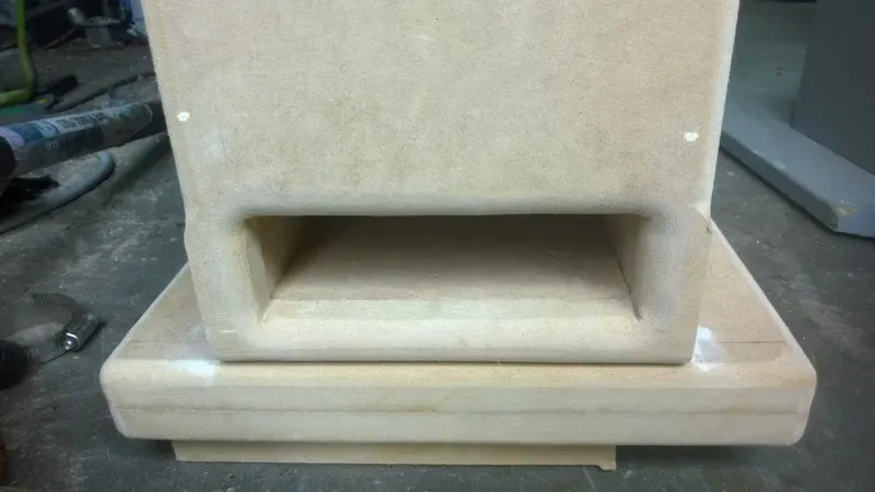

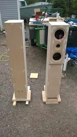

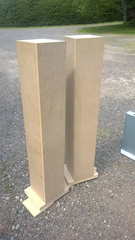

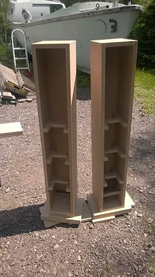

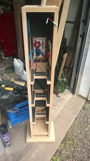

    V2 ML-TL:
    Cabinet in progress:

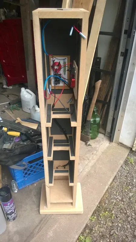

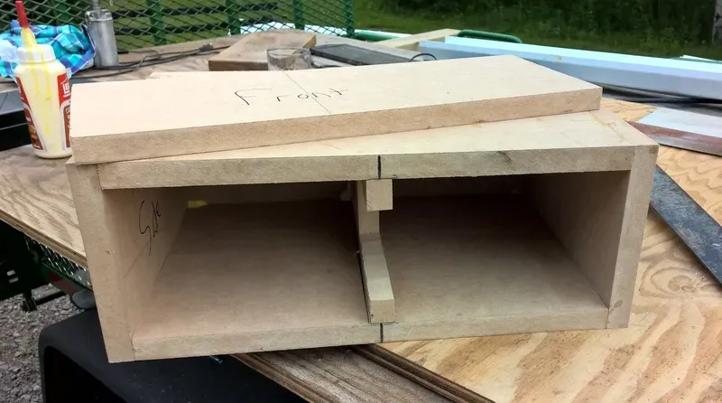

    V2 Center Channel

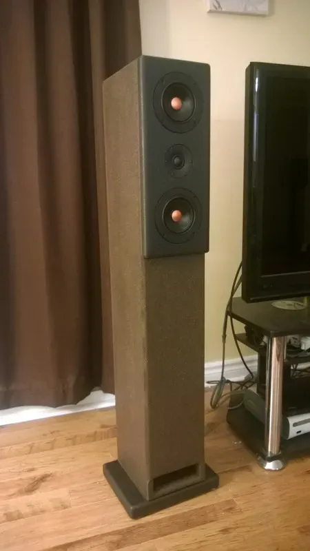

    Very nice!
    Could you explain how you got the rough finish shown on the baffel on the "done" picture?
    I'm looking for something like that for the stands of my Ardents.
    • Wiggle
      • Jul 2015
      • 10
      Originally posted by TEK
      Very nice!
      Thanks for the feedback . The paint is a product called Gravel Guard. It is a black, textured paint. I'm a big fan of it.

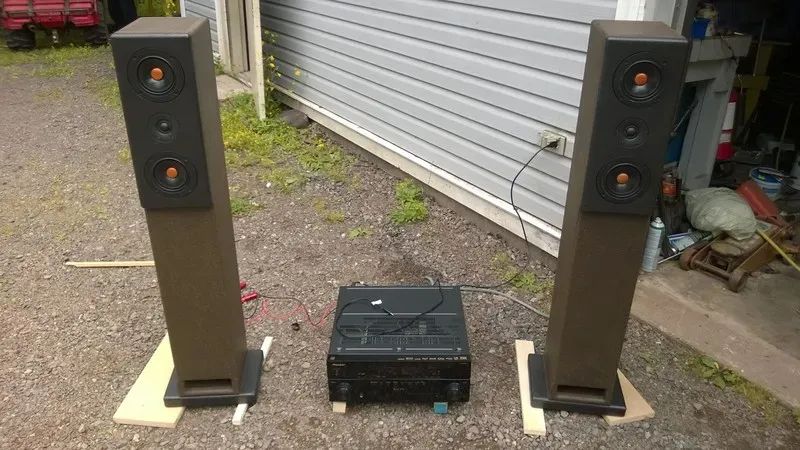

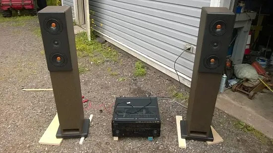

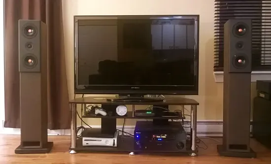

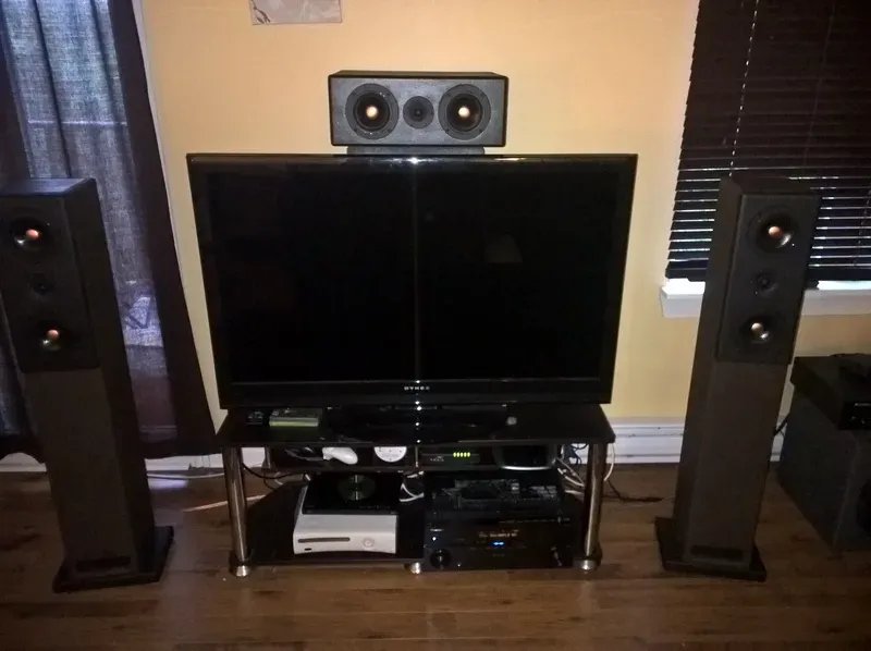

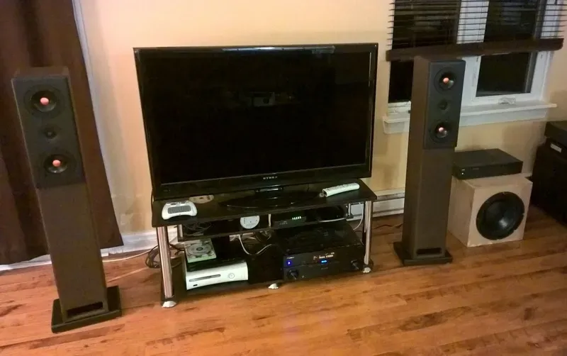

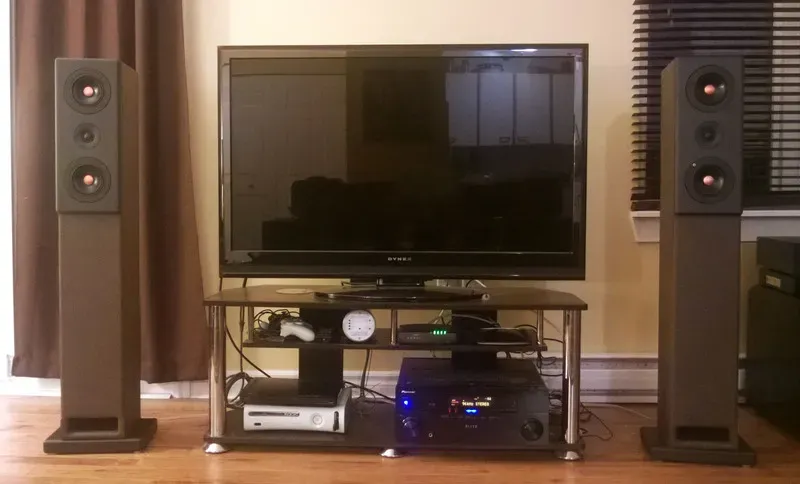

                Completed the V2 ML TL Added more intermediate pics to OP. Here's the final result:
                Click image for larger version  Name:	WP_20150726_003_zpsvxarhs2f.webp Views:	1 Size:	69.5 KB ID:	938352
                • bostonmurf
                  • Jul 2014
                  • 170

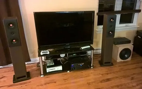

                  really nice work! how do they sound
                  • Wiggle
                    • Jul 2015
                    • 10
                    Thanks. They are great. I've been out of the hifi game a while and these have reignited my interest. Lots of great detail and depth and a surprisingly potent bottom end.
                    • Wiggle
                      • Jul 2015
                      • 10

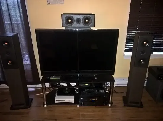

                      More pics in my listening position:
                      And their little brothers, ported V1s, for the surround

                        Update:
                        Started my V2 center channel cabinet. Hope to get some time in next couple weekends to wrap it up
                        Click image for larger version  Name:	WP_20150815_18_30_40_Pro_zpsh3oodeul.webp Views:	3 Size:	41.7 KB ID:	938353

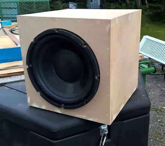

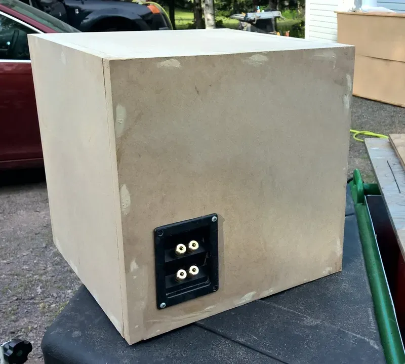

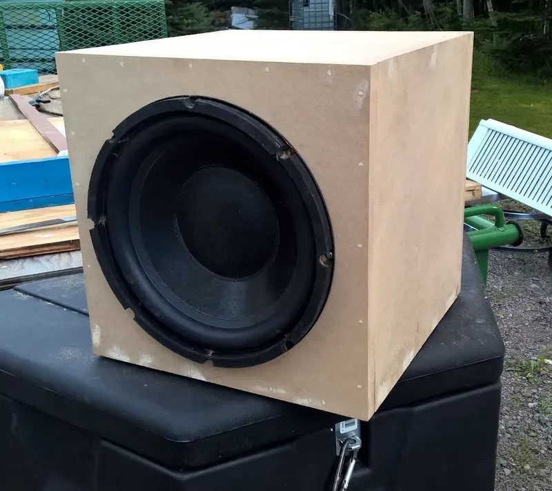

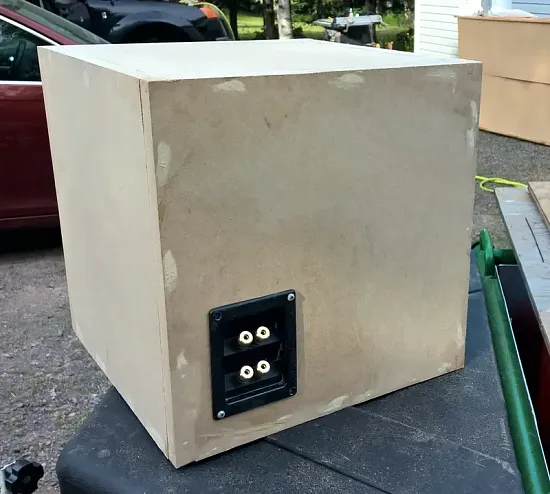

                        Also built a small 15" sealed sub. Using an old Shiva in it for now but plan to upgrade to an SDX 12 when money allows This enclosure size is not as ideal for the Shiva but it already sounds surprisingly decent.
                          Nice work - congrats!
                            Indeed, I bet you are very pleased with them. The sub no doubt helps to add in an extra dimension to the sound of course.
                            Instead of replacing the sub with the SDX12 consider keeping the current one and building a second sub instead. Multiple subs is deffo the way to go with regards to bass quality.
                            • Wiggle
                              • Jul 2015
                              • 10
                              Thanks for the input. The 15" cube is more well suited to the SDX 12, the Shiva is a little high in Q in that box (probably nearly 0.8) so it is a "bouncy" for my liking in the mid bass for pure music. The SDX 12 will be better behaved but you are right, perhaps I will build a somewhat larger and more damped box for the Shiva and see if I can find a way to integrate it into the system. I also have an old 200 liter ported Tempest which can be used as home theater brute subwoofer.

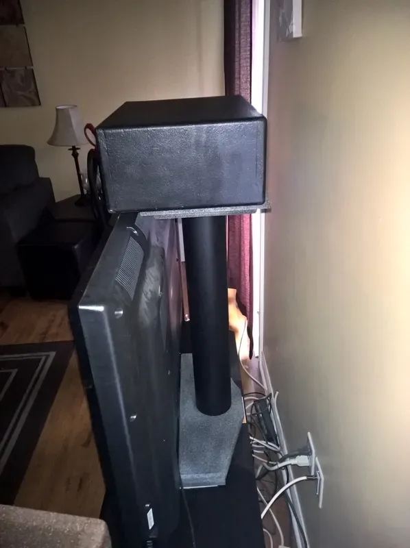

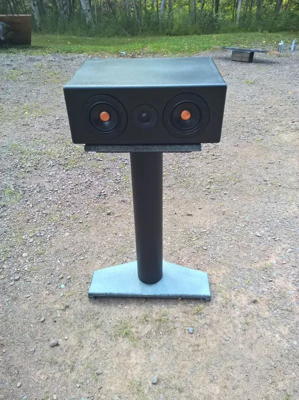

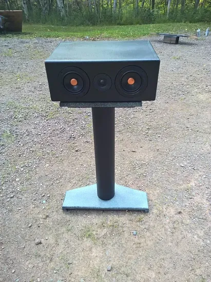

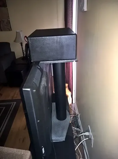

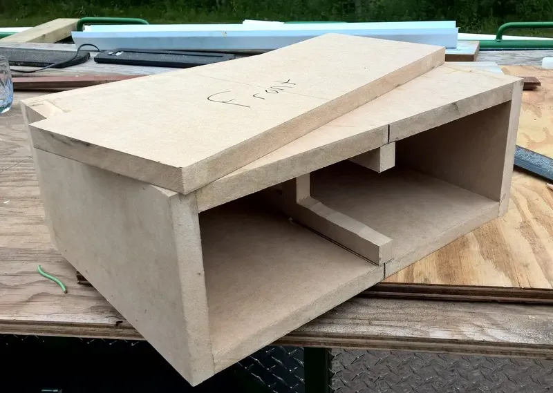

                                All finished now
                                Got the center channel completed and built a stand too. The stand is designed to sit behind my television and raise the center channel just above the screen though it would also be floor mounted if I change around my configuration. Center channel fills out the sound and improves the anchoring to the screen for dialogue significantly. It also sounds excellent for podcasts in Pro Logic II mode. The horizontal MTM design seems to perform just fine in regards to off axis performance as well.
