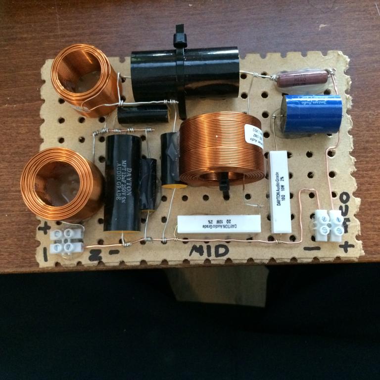

                        Long time without any progress now. I suddently realized that I had to move some components from the basement and into the livingroom before I could start using these - so my priority was shiftet.
                        During the christimas holliday I got myself a Marantz AV8801 pre-pro that now have replaced my older Marantz SR7005 receover. The Marantz will go up into the livingroom and will be powering the In-Khan-Neatos there.
                        However, I have a 7 channel setup in my basement. With the SR7005 I used my Thule PA350B in balanced two channel mode to drive my mains and the receiver drove the center and surround channels.
                        The PA350B can operate in 2 channel mode or in 5 channel mode. So with the AV8801 I'm using the PA350B to drive the center and surround channels.
                        But - as all of you that have a sharp look for math have already seen - that levels me with two speakers without power. And I do not think that the PA350B in 5 channel mode is worthy driving the Ardents.
                        At the same time I have been happy enought to be accepted as a OEM for Hypex - wich gives me access to their OEM modules. We'll see if I will get a small production line going and start selling some - for now I'm doing some prototyping to see what is possible, getting some input and help from a couple of other members on the forum.
                        Anyway - due to this, and the fact that I was missing amplifier for two channels in my listening room/home theater, I have build two NC500 based prototypes (simples possible) that is now in-place.
                        So now I have the AV8801 as pre/pro, two Hypex NC500 monoblock prototypes to drive the mains and my Thule PA350B in 5 channel mode to drive the rest of the sorround channels.
                        And of course I still have my 3 sub's...
                        Having that out of the way I could finally start doing some more work on the In-Khan-Neatos, so - after some hecktical weeks at works, a bit time used to get my drive back after the monoblock builds and so on - I have finally had some progress.

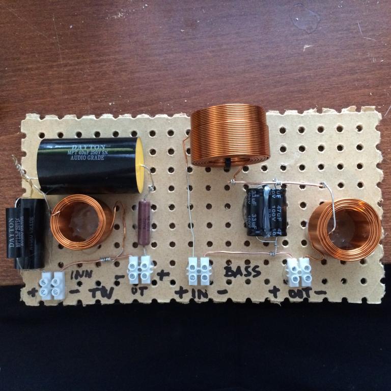

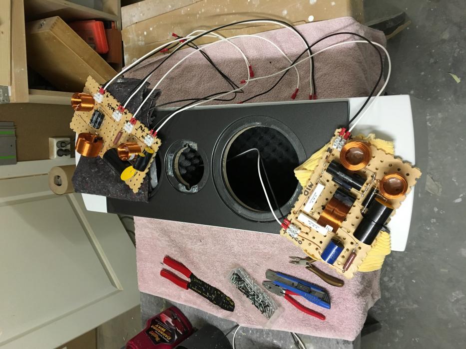

                        Below is the crossover for the tweeter, mid and woofer. I have mounted everything and connected all wires - but not yet soldered anything. I have also just done one side.
                        If someone could take a look at it and see if I have got this right I would be really happy for that. Still very novice at reading crossover layouts - so I'm quite unsure if I have got it right.
                        Compared to the crossover on cjd's site - my looks quite different, but I think (or hope) it's just the layout that is differnet.
                        For the woofer (marked bass on the board) I have set the + and - sign as it should be connected to the woofer element.

                        Mid
Name:	crossover - mid.jpg
                        Tweeter and woofer
Name:	crossover - tweeter and bass.jpg
                          #102
                          All looks right to me! Who made this design, the crossover is too complicated! :rf
                            #103
                            My crossover layouts shouldn't be considered the best way, just a way. I think yours are laid out nicely.
                            Consider removing some of the glue on the 6 ohm resistor in the mid. It is inline with the mid. I remember CJD kept feeling mine to see if we were heating it up. We didn't have issues, but you never know. A small part like that doesn't need much glue, if any. I've seen people recommend putting a wire space underneath so air can circulate all around.
                              #104
                              Thanks a lot, both of you.
                              I have removed the glue from the resistor. I have it hanging in free air now.
                              Both crossovers are now assembled and soldered. On speaker are done and are now laying on it's back in the theater playing some music for some initial testing.
                              As mentioned, it is laying on the back on my tv-bench, and there are only one. However - from what I can here so far it sounds very promising. Looking forward to get them up on the wall and do some more decent listening tests.

                                    #107
                                    Tek,
                                    In the photo of the Mid XO, one of the two inductors should be turned on it's side. Not bad , but a little close to each other IMO. May not make a difference in the "real" world thou.
                                    Ron
                                    Ardent TS
                                      #108
                                      Hi Ron
                                      I agree with you, but I have already soldered both and installed one, so I think I will let this one slide (these are just for my wife anyway ;-))

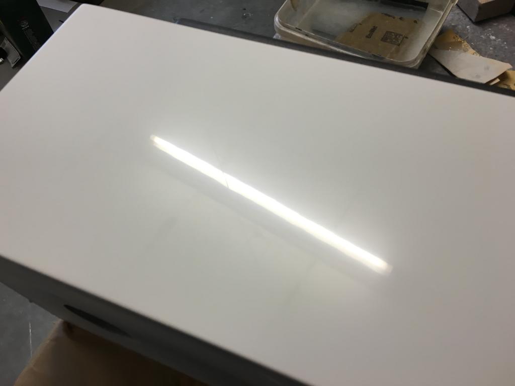

                                                        Finally some progress...

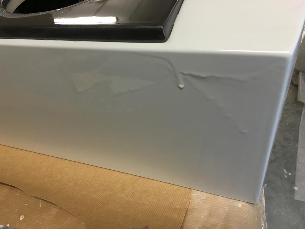

                                                        As I mentioned before, I had to repaint one of the speakers.
                                                        I sanded a bit to much and went trough the paint.
                                                        However, the second layer did not go as it should. On the top it was very good, but I got runs AND orange peel on the side of the speaker.
                                                        However, to all newbees out there, all is not lost even if you get some runs and orange peel.
                                                        This was the how it looked. I let it dry over the night (at 25-35 degree C using a cheep heat fan).

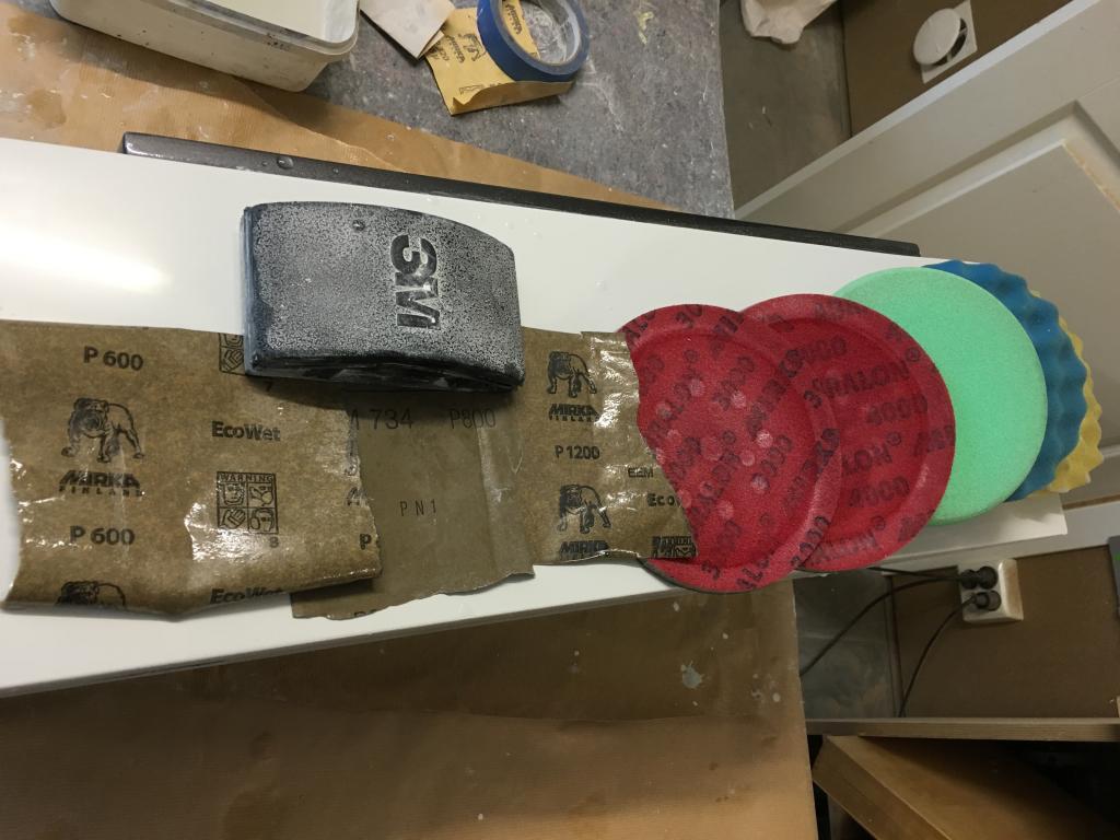

                                                        Then I started out with 600 paper and used wet sanding/color sanding to remove the runs as well as the orange peel.
                                                        What I saw, but that is not showing on tje picture, is that there are a lot of small scratched that causes there to be little shine in the paint
                                                        Continued with 800 and 1200 paper and wet sanding (by hand).
                                                        The point is to sand away the sanding marks.
                                                        Then orbital sander with 3000 and 4000 grid.
                                                        And then over to a 3 step polishing process - still using the orbital sander.

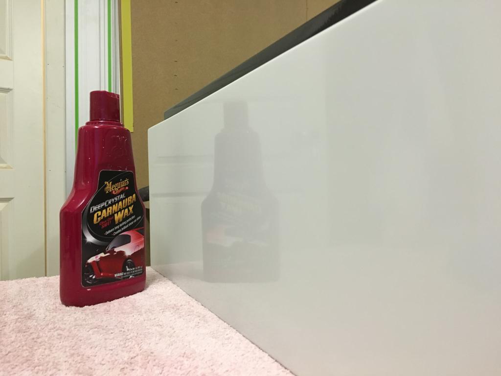

                                                        And the final result...

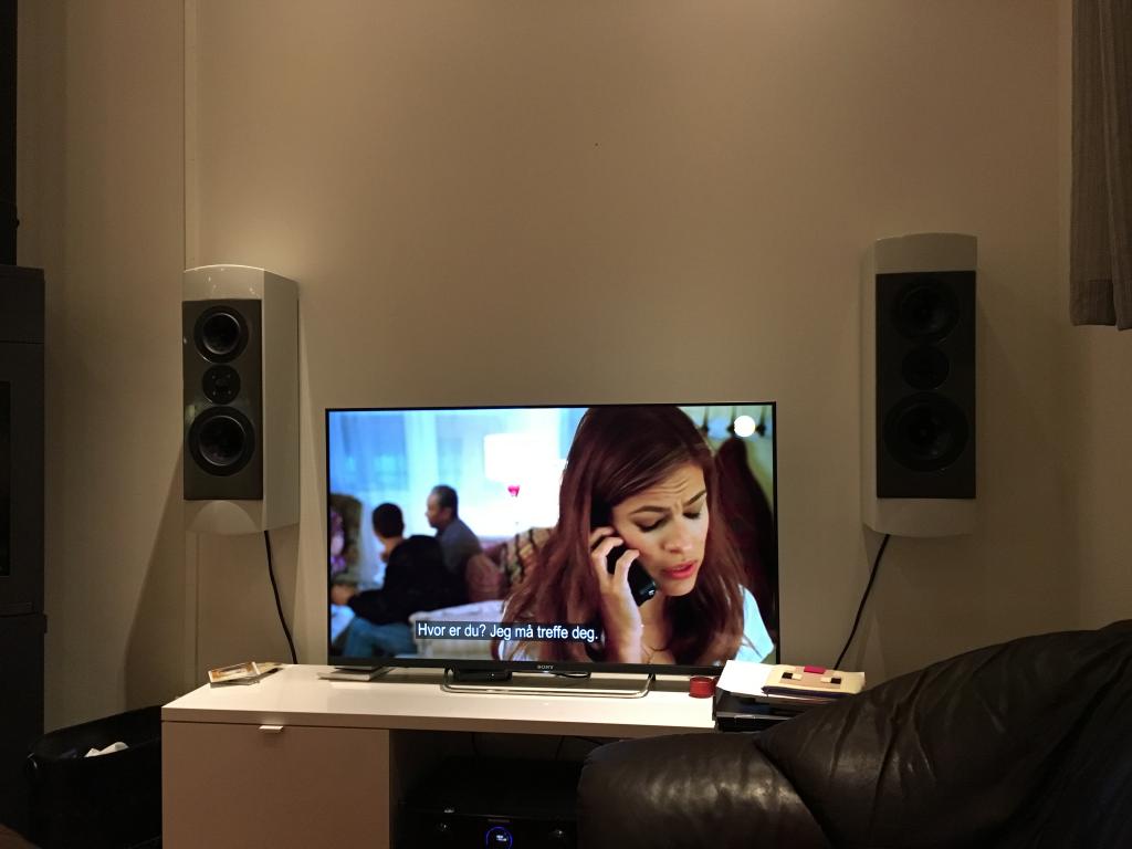

                                                            #119
                                                            Looks great. So how do they sound? Better than the Adrents.
                                                              #120
                                                              It's a bit early to give you any serious inout on listening impression.
                                                              What I'm noticing so far (after very briefe listening) is that it seens to make a very nice sound stage and a even and nice respons. Voices sounds clear and are easy to understand. The bass level in the listening position is supricingly good when looking at the size of the speakers. All-in-all I'm very pleased with what I hear.
                                                              But no, they are no match for the 10x moren costly Ardents supported by 1 18" and 2 15" sub, feeded with each 500w ncore mono amps in a dedicated home theater room :W
                                                              And if they were I would never admit it 8O
                                                              There is one thing I do notice very well - and that I think I need to do something about.
                                                              As mentioned, in the listening position, the bass level is very good - better than excepted.
                                                              However, if I walk over to the other side of the room or into the kichen the sound becomed very "thin".
                                                              Note: we're not talking about 'a little to the side of the listening position', but the other side of the room 5-10m away.
                                                              But I'm not sure if what I hear is caused by lack of bass (and may be solved with a subwoofer) or if it is more about room reflection/eccos causing a bright/noisy sound stage when listening to indirect sound (and may better be solved with sound arbsorbant panels).
                                                              Any ideas and input to check that out is velcome!
                                                                #121
                                                                Well, I'm glad you like them. I always worry about people's response to my/cjd designs. No worries about the Ardents sounding better, I hope so.
                                                                I'm glad to hear you're getting "surprisingly good" bass. With the sealed cabinet, it could be underwhelming to some. I forget the f3, but I want to say it is in the low 60hz or upper 50 hz range. A sub is definitely needed to get a full response.
                                                                5 - 10 meters away is pretty far. Likely just the normal sound loss with distance. Bass always seems to fall off faster.
                                                                I do wonder what mounting them on wall is doing for you. I'm sure you've seen the Toole graphs. You should be getting a null due to the back wall reflection around 104 hz if you built them 10.5" deep. The power response will somewhat fill in with the wall reflections, but maybe moving way off axis you're not getting that. You could try putting on some repetitive bass track and slowly wall backwards. Does the bass just fade away or does it just snap disappear like a null?
                                                                I also wouldn't be afraid to experiment with your bass tone control if you got them. The RS180 can take a lot.
                                                                  #122
                                                                  Thanks for your input Ryan.
                                                                  As mentioned, it's quite early to say mutch - more listening time is needed.
                                                                  I was also curious about the on-wall compared to the in-wall it is designed for - at first easy listening it does not seens to be a big problem. For more acurate evaluation I should probably get out the measuring equipment.
                                                                  For now I will probably do a auto setup on the Marantz and leve it with that. I have another, non-audio, project to attend to now. Need a gate for the stairway to keep the dog where we wont it (With our previous dog I could just tell her to not step over a imagionary line, and she would stay there - but with 3 children we're not able to be consistent enough to get that level of training and consistent feedback - so we're forfitting and going for physical stuff instead).
                                                                  After that I might do some measuring to check out what's going on in the rest of the room. However I'm quite sure that the bass is sucked out as there are quite a large room (probably close to 70m2), and with high roof as well as an open stairway down to the basement. However the In-Khan-Neatos are located in one of the corners of the room so I guess there are some room-gain. To get a decent bass over a larger are might be a challenge.
                                                                  I will have to see a bit. It would have been nice to have decent sound in the whole living-room, but at the same time I will not fill it up with speakers and boxes - and it will not be for chritical listening anyway. For that I have the Ardents ;-)
                                                                  Edit:
                                                                  I will not fill it up with speakers and boxes does of course mean "my wife won't let me fill it up with..."

                                                                      The bass roll-off sure sounds like the results of cancellation. These should be able to provide a respectable listening experience in your room, though the bass won't knock your socks off.
                                                                      Try just one in-khan, then the other. That will help isolate the issue to distance to surface or distance between, or the design (though if it's wall bounce the issue would remain too)
                                                                      Glad they generally meet expectations.
                                                                        #125
                                                                            [ATTACH=CONFIG]25150[/ATTACH]
                                                                            [ATTACH=CONFIG]25151[/ATTACH]
                                                                            [ATTACH=CONFIG]25152[/ATTACH]
                                                                            [ATTACH=CONFIG]25153[/ATTACH]
                                                                            The finished product looks great TEK, well done :T
                                                                            I am impressed how you blasted right through the paint run...that would have had me all kinds of upset. I didn't realize you could fix it the very next day. What type paint did you use?
                                                                              #128
                                                                              After doing some tests before I have figured out that it's actually quite easy to fix runs, as long as there is enough paint so that you don't sand trough it.
                                                                              The point is to go to finer and finer sandpaper, so that you get away any scratch markers from the courser sand paper, but when looking closely you could clearly see how the scratches caused the shine to dissapare, and the the shine improved as I went to the process with the finer sandpaper.
                                                                              Bit I still don't know why I got so mutch orange peel on the side of the speaker - probably not the correct amount of thinner. However, that was also fixed in the sanding process, and the final result have a nice shine and no orange peel at all.
                                                                              I'm using auto paint for cars. Professional type of quite high quality. The paint is Glasurit.
                                                                              The white is their 22-series, a 2-k oil based paint. No clear requiered.
                                                                              The baffel is metallic, thats the Glasurit 90-series and is water based. After the metallic there are one layer of 2-k oil based clear coat that gives shine and strenght.
                                                                              It dries very fast and you can apply several layers in one go, typically with just minutes between layers.
                                                                              Drying time depends on heat. If you have infared it dries totally in just minutes. If hou have 60 degrees C it dries in 1 hour, at 20
                                                                              degrees C in 8 hours. I was wondering if it would be dry enough - but it was and there were no trouble sanding it.
