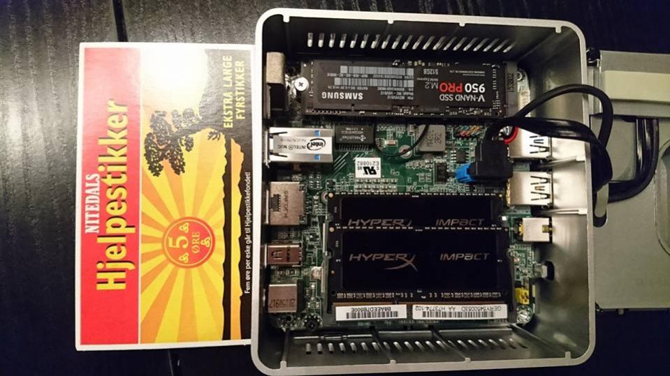

                Have been occupied with assembling and setting up a Intel NUC pc that my wife just got for the livingroom. Impressiv little thing.
                (it's a big matchbox - but still, this thing has a lot of performance for it size.
                Full HD out (x 3 I think, 3.2ghz cpu, 16Gb ram running at 2033hz and a kick ass 512gb superfast ssd disk.

                Also, my wife birthday is on 23. of desember - so that kindof take up some time. Present, familiparty and so on.
                But I was able to sneek away and also update my ild htpc computer.
                I installed a semi fanfree psu (the fans will only run at high loads), upgrade it from 3 to 8gb og memory as well as exchange the graphic card to a newer one.
                I also upgraded the fans to more silent fans (it's running a quad core q6600 cpu so I must have some fan - but I have several and all is running on slow fanspeeds.
                Of course there were some problems. Also, switching the psu require all cables to be swapped - abd it all takes some time

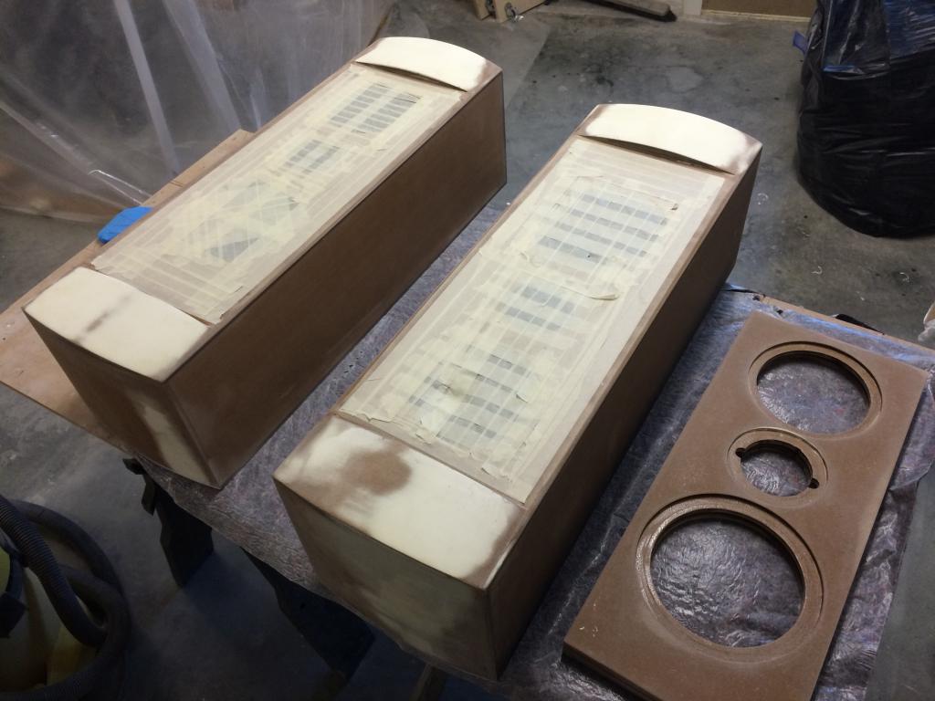

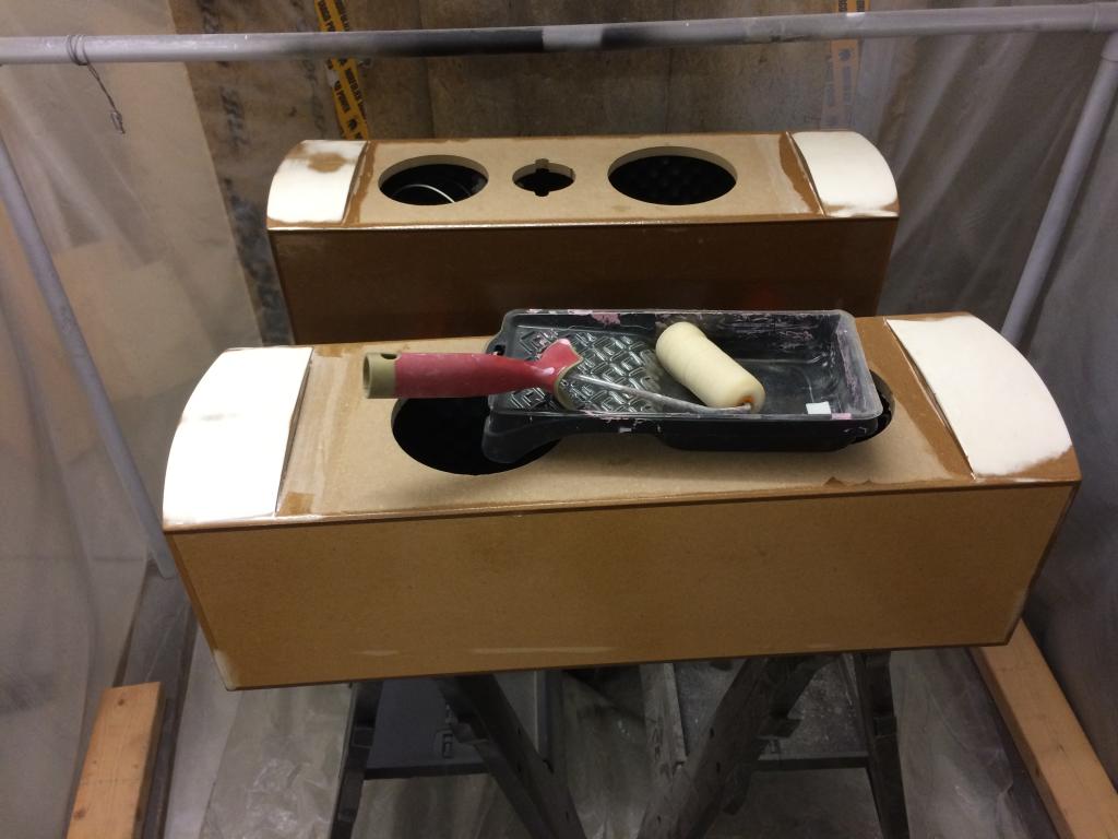

                          OK, no some progress.

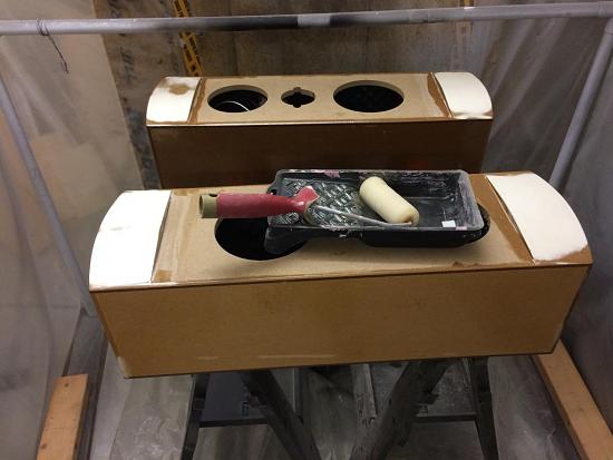

                          I have sanded down the rounded areas and added boundo to get it even.
                          Then I have just applied one coat of epoxy.
                          Very easy to work with and very little smell. Used 5 pumps pr. speaker.
                          Click image for larger versionName:	image.jpgViews:	1Size:	101.4 KBID:	860418
                          Click image for larger versionName:	image.jpgViews:	1Size:	70.1 KBID:	860419
                          I do not know any way to clean the foam roller - so I consider it a one time usage.
                          Anyone know if it migth be cleaned.
                          Last edited by theSven; 02 August 2023, 19:17 Wednesday. Reason: Update image size
                            Rollers and brushes are single use. At least you can use cheap ones. Not sure what solvent to use if you want to try but it's bound to be nasty. I cleaned up polyester resin with acetone as a kid. Practically bathed in the stuff. Guess I'm lucky to be healthy. :roll: ops:

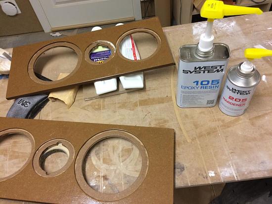

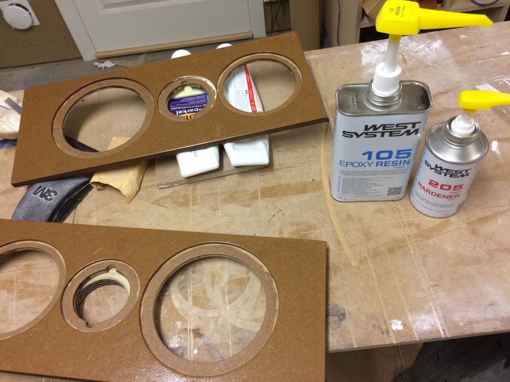

                              I just sanded down first round of epoxy and applied another. I did not notice any kind of blush layer, so sanding was quite OK with little clogging of the paper. I'm still impressed about how little smell there is from the West System Epoxy.
                              Second round of sanding tonight or tomorrow (probably tomorrow)

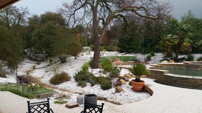

                                  Backyard photo, notice the ice on the pool, I'm glad I shut it down earlier last month. The Solar heater is not going to help. :rofl:
                                  This last photo is a Tornado which went by on the day before Christmas, about 150 yards away..........too close for comfort, damaged a few houses nearby.

                                    Where do you live? There seems to be a strange combination of plants, some of them I would not to see together with snow...
                                    Good thing that you have those sun-chairs out and ready, looks like they will be used a lot ;-)

                                      So you must live in Miss., Alabama or Georgia based on the weather. I am in the Columbia SC area and we had a tornado warning in our area later that same day. Also, weather was in high 70s to low 80s. I wanted to go sailing on Xmas but the family still says no. One day though.
                                        WOW, daughter left NY with 22 deg. C and said as soon as the she got off the plane here the cold at her feet was all to familiar, haha
                                        This is a warmer winter!

                                          I live in California, near Lake Tahoe ~2,000 ft Elevation. We get snow almost every year, thou it doesn't last long. Yes, it is a weird mix of plants.
                                          Trying to grow fruit trees is a challenge, Plum tree produces so much fruit that even after the birds eat their fill and we give lots away, there is more than we can eat. (blessed)
                                          I think I just killed my Avocado tree, the wind blew the cover off it last night..........bummer......

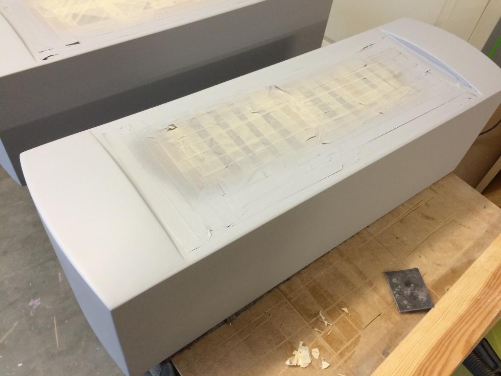

                                              So, it's a nice day to get some base coat on those speakers :-)

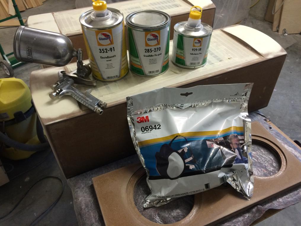

                                              Glasurit car paint. First some filler. Nasty stuff, so protection gear is needed.

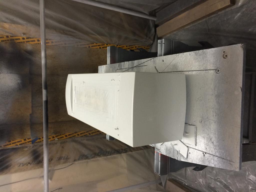

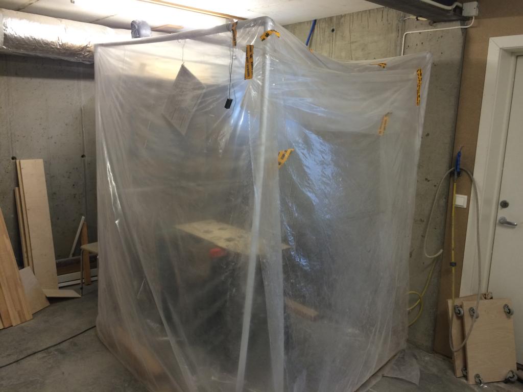

                                              My DIY "paint booth"

                                                Base coat on - looking pritty good.
                                                Sanded the epoxy with 120 and 180 paper.
                                                Now I will sand final round with 320 or 400 I think.
                                                During readup I see many using like 500+ paper quite early in the process. I think that is waste of time. The filler will handle the sandpaper marks from 180 without any issues. To fine paper to early takes extra time and might also cause the paint to not stick propely...
                                                  I really like that smooth feeling of the base coat when it's ready for the top coat. To think that this just a while back was a dull square piece of MDF, and now it's this soft rounded pice that is just sooo smooth to the touch :spin:

                                                      I like the spray booth! Does it work well enough? I'll be wanting something like this, I'm afraid. Thinking I just need to install proper extraction in my workshop though...

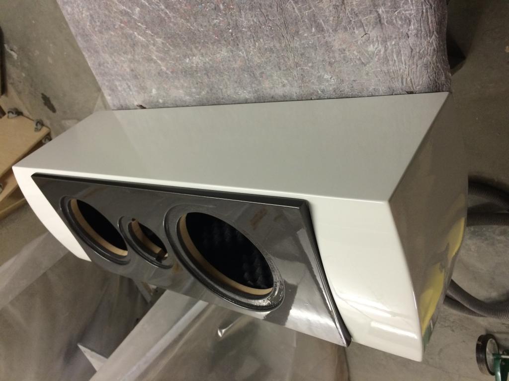

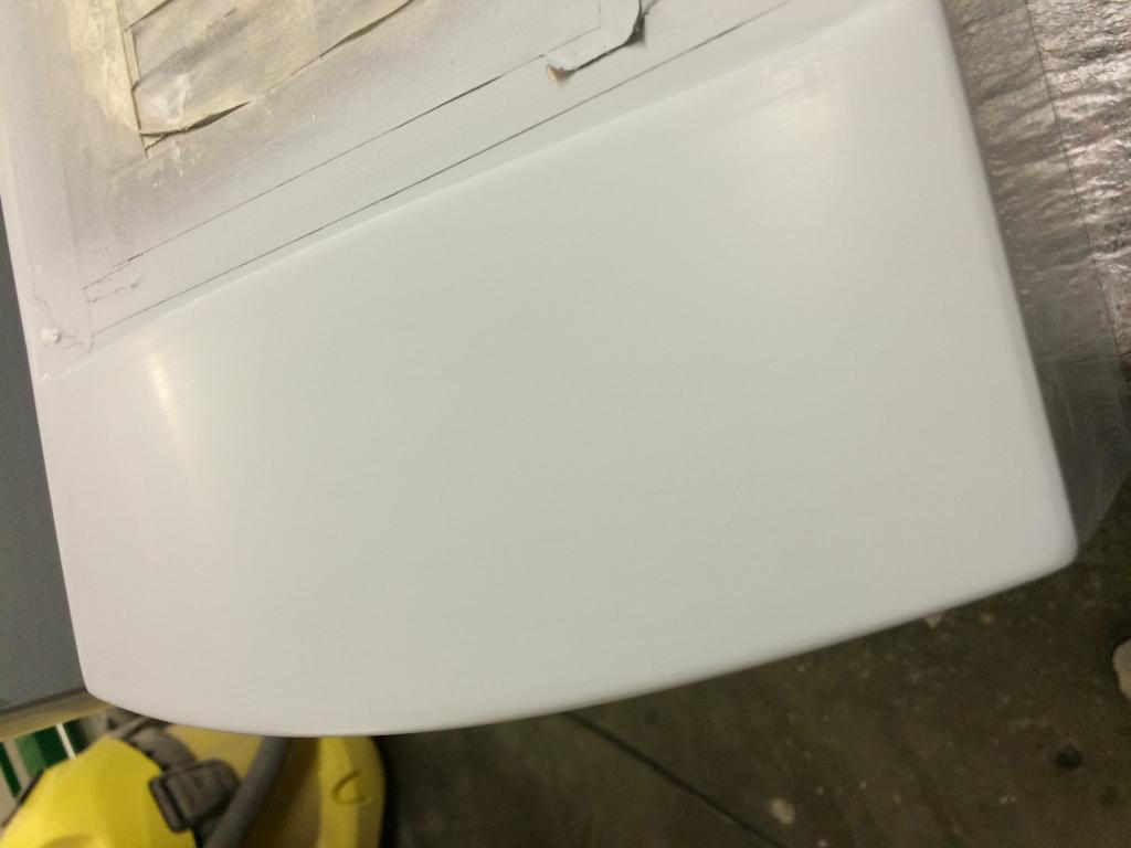

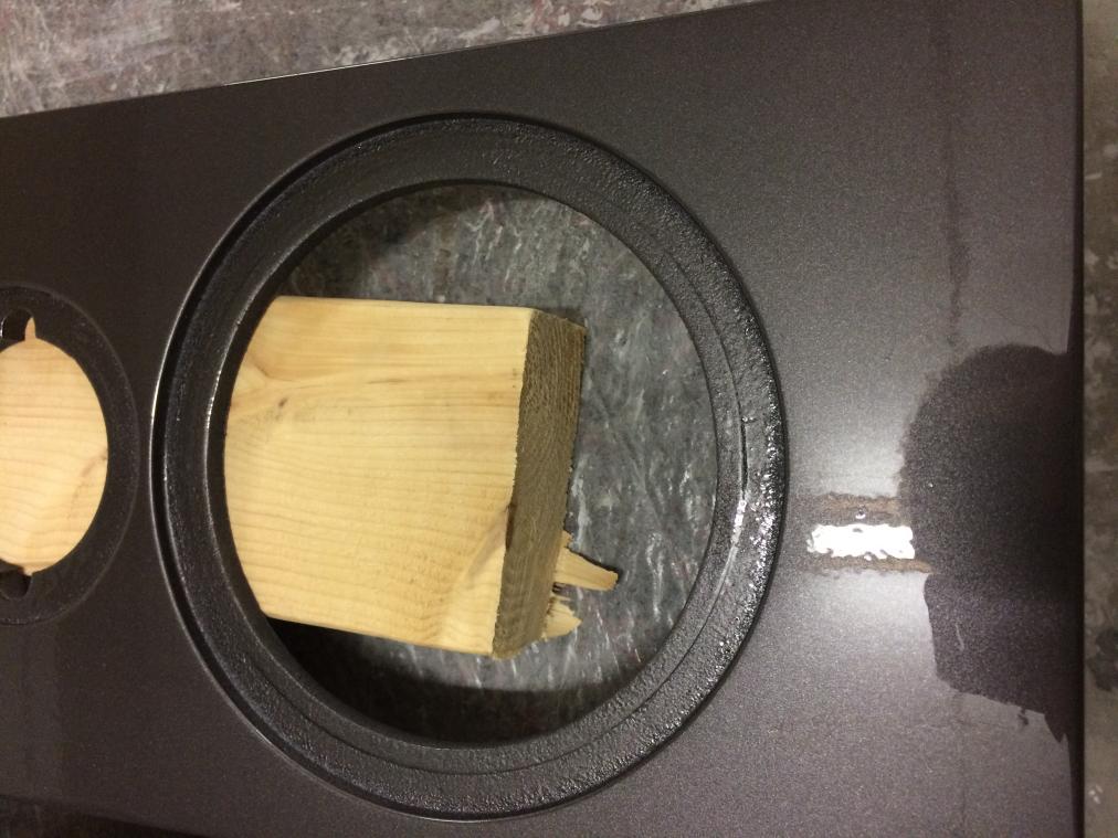

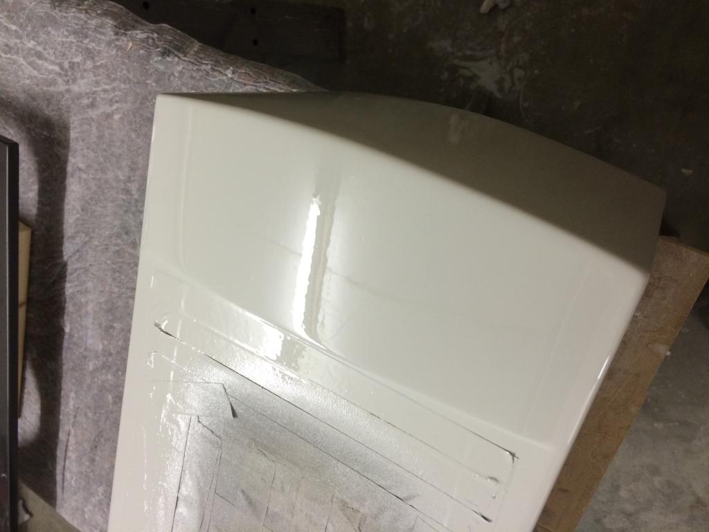

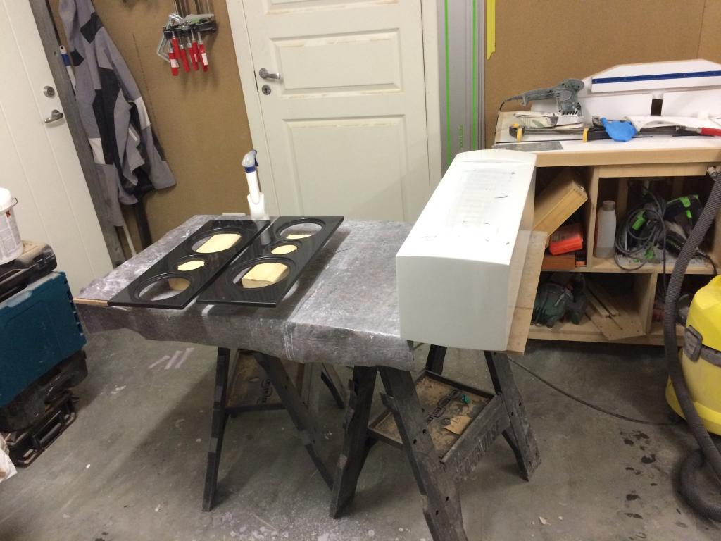

                                                        Yup, it's moving forward. Got some paint on today.
                                                        The baffel has got one layer of waterbased metallic gray, followed by two layers of clear coat.
                                                        The speakers has got two layers of a white color from BMW (saw a BMW with a white color that I liked and got them to mix that for me).
                                                        And this is the result straight off the gun. Laying to dray now. I will await rubbing and polishing to after new years eve, as we are going away to some friends tomorrow.

                                                        What is not showing on these pictures is that I have a mistanke in the metallic on one of the baffels. I got some dirt in it and try to sand over it before adding the clear (the guy in the shop told me that should be ok to do). Guess what, it was not OK. So, instead of having a tiny dust pice in the metallic I now have a area on the size of a large coin that is different.
                                                        Wife says that she will be nagging me more on getting the front covers done if I just leve it as that than if I fix it.
                                                        I have more of the metallic, but not clear - so I will have to get that to fix it.
                                                        Not that sure if wife nagging me to go down and do stuff in the woodshop is a good or bad thing :W
                                                        You do know, it's not like she nessesarly know what I'm doing down there ... arty:
                                                        Think I will have to evaluate how to play this one out :stupid:
                                                          Looking really good though.
                                                          Yes, it's working pritty well as long as I ensure that I do not use to mutch pressure (get extremly mutch overspray).
                                                          As long as I take a bit care of that, and don't do to large stuff it's working really well. There are a bit of fumes outside the booth (but that is also from me mixing paint and cleaning stuff), but no paint outside the boot at all.
                                                          I use two kitchen fan. One that draws are into the booth (on top at the front of the booth) and one that draws are out of the booth and outside. I got the fans for free from electrical trash on the dump - everyone getting a new kitchen switches out their fan and just throw away old ones. By using two fan I can deside if I want positive or negative pressure in the both.
                                                          In front of the fans, both intake and excaust, I have paint filters of the same type used in actual paint boxes. Both a full role when I first planned this. That is quite important as it both stops dust from entering the booth, and - more important - it keeps paint inside the booth so that paint wont be spread around at the outside when it exits the booth.
                                                          The booth itself is made from pvc pipes that holds the plastic, except from the front wall that is made from wood.
                                                          I have a old heat fan that I put on top of the air intake if I need to race the temperature. Using that on full power and I can bake the painted stuff at a whopping 40 degrees ;-)
                                                          The excaust fans stands on a day or so after painting to get fumes out of the room as the paint gives off fumes for some time while it dries.
                                                          Equal setup with more powerful/larger excaust fan, and maybe just positioned before the door out would probably be even better.

                                                                      I was a bit concerned about the cold wether, have been warned against that before. However with my regular heater fan either blowing directly into the air intake of the booth (if I want mutch heat) or blowing into the room (if I want more even heat) it has been no problem at all.
                                                                      I should note that my basement wood shop has 10cm isolation on the outside of the cement wall. And the half wood wall is 25cm and filled with isolation, and the houses technical room that also generates some heat is in a corner room of the same room also generate some heat.
                                                                      This means that I have hood control of the heat as well as how much outside air I let into the room.
                                                                      But I have to agree, I think that the white (a bit offwhite) and the dark gray metallic seems to work wery well together.
                                                                        Happy new years day from norway :-)

                                                                          Are you using the same speed thinner as with your Ardents? Meaning the reducer, slow (hot weather) , medium (warm / average weather) , fast for (cold weather) , slowing it down by mixing a slower speed reducer might help with the minor orange peel. It would take longer to dry though, and you would get more runs / sags in the finish.
                                                                          They sure are beautiful, very good looking speakers Tek!
                                                                          Ron
                                                                          Last edited by Renron; 02 January 2016, 11:33 Saturday. Reason: corrected reducer temp / speed
                                                                          Ardent TS
                                                                            I used fast hardener this time, mostly because I had some left.
                                                                            Have some normal as well - but I have good temperature control so I can get the temperature inside the booth that I need. Targeting a temperature of approximate 21 degrees C.
                                                                            But isn't fast for cold and slow for hot wheater?
                                                                            Had no problems neither with orange peel or runs this time around :-)
                                                                            But I have decided to redo one of the baffels as the marks after me trying to sand off some dust before doing the clear coat is showing much to well. But it will be quite quick. First a light rub-down, a thin coat with waterbased metallic and finally two coats of clear. The whole process should be doable in a hour or so...
                                                                            • Renron
                                                                              • 751
                                                                              Thanks for catching that Tek,
                                                                              Yep, I was thinking cure time and writing reducer temp times............I got them mixed up. Good catch. I have corrected my post so anyone who reads this in the future will have the correct speed / temps.
                                                                              Your work is excellent, I wouldn't even think of spraying in the snow weather. No offense meant with the minor orange peel comment above. I know when it's off the gun it takes time to flow out.
                                                                              You are correct, you cannot sand a metallic base coat and not have it show. Flakes have been disturbed and it will always show.
                                                                              Ron
                                                                              P.S. you can mix reducer temperatures / speeds, if they are the same brand
                                                                              Ardent TS
                                                                                Ron, I have to say that first I did not quite catch up. I did think that I had very little orange peel.
                                                                                But, you are (as always) right. There are some orange peel. But not mutch and I'm feeling very confident that it will be easly handled when I start buffing them. But you do have a point. I might have done even better - maybe using a tiny bit more thinner - or, slower hardner, or laid it on a bit thicker.
                                                                                The smaller gun delivers quite little material - and at the same time I'm a bit worried about laing it down to thick so that I get runs. No runs at least, and I think I laid it on pritty thick. Also, the larger gun (the Iwata w-400) does give a mutch better result off the gun - but for these small speakers it delivers to mutch to fast and I would have got a lot of overspray and at the same time it would have been a bit challanging to get the edges good - I think.
                                                                                I little buffing and polishing and I think these should turn out darn close to perfect ;-)
