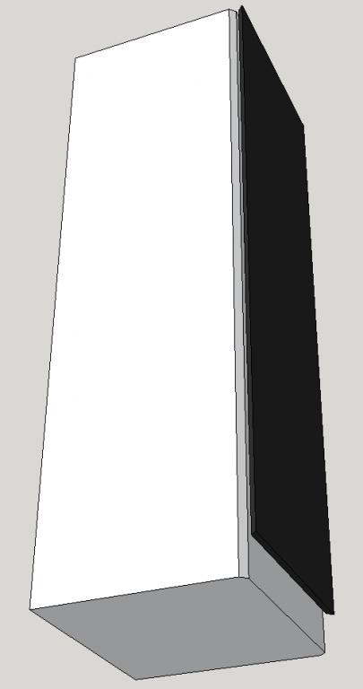

    To get a more decent sound for the TV in the living room we have decided that we want a pair of real speakers.
    After some research I have found that the In-Khan-Neatos is looking like a good option.

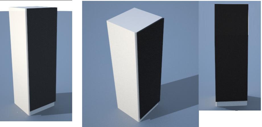

    The speakers will be placed on each side of the TV, quite close to the TV. The height of the front grill will be exactly the same as the height of the TV, so that the speakers should look like they are a part of the TV.

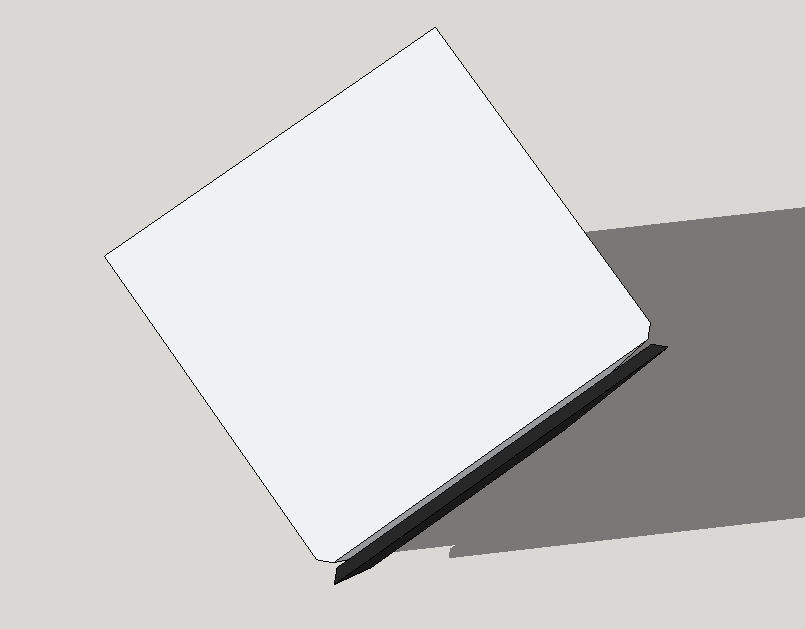

    To make this look resonable good I'm thinking about a design like this:
    Click image for larger versionName:	in-khan-neatos.jpgViews:	1Size:	24.7 KBID:	871425
    After looking at the TV-set, checking some other threads and done some calculation I think that 27" * 8 1/2" * 8" (h/w/d) is good dimensions for the box (outside).

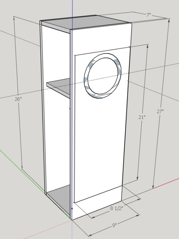

    The baffel is a bit smaller than the original drawings, but as the crossover that I'm planning to use is in-wall, and these will be close to the TV - I can't see that it should do much difference.
    I plan to make the box out of 1/2" MDF, meaning that the internal volume of the box will be approximate 22-23 liters.
    Click image for larger versionName:	in-khan-draft-top.pngViews:	1Size:	14.7 KBID:	871426
    Click image for larger versionName:	in-khan-draft-below.jpgViews:	1Size:	15.6 KBID:	871427

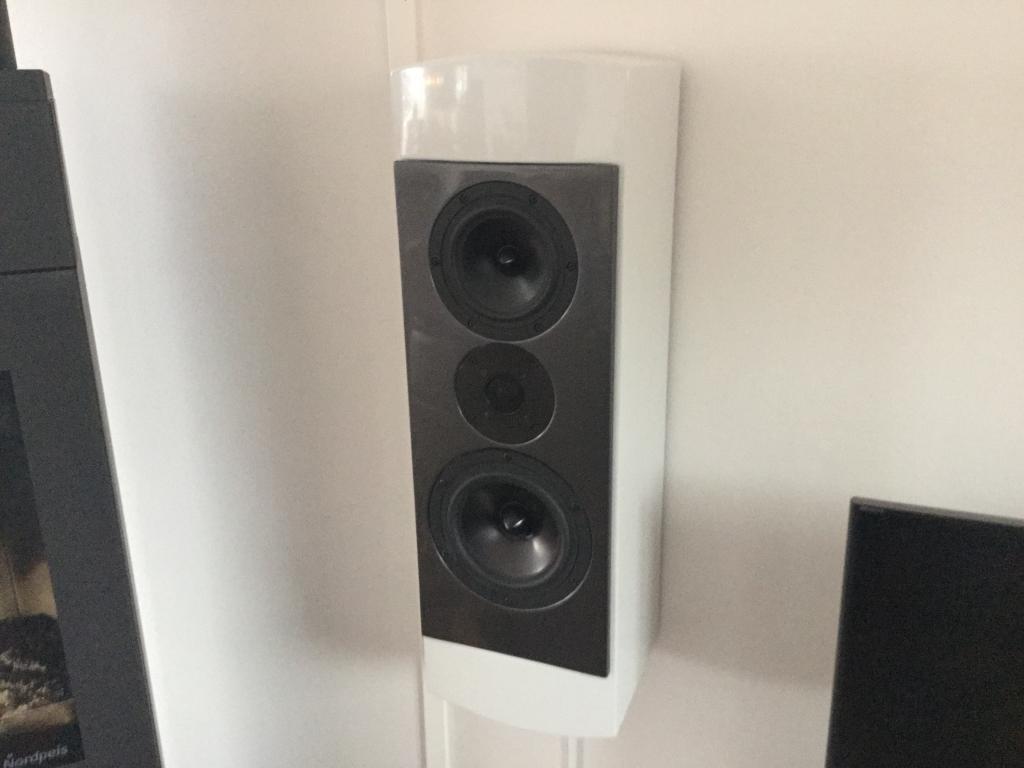

    This was is the result:
    Click image for larger versionName:	image.jpgViews:	1Size:	50.8 KBID:	872022

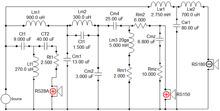

    I wonder if I could get some help with the crossover parts.
    This is the crossover for the In-Khan-Neatos:
Name:	in-khan-neatos crossover.png

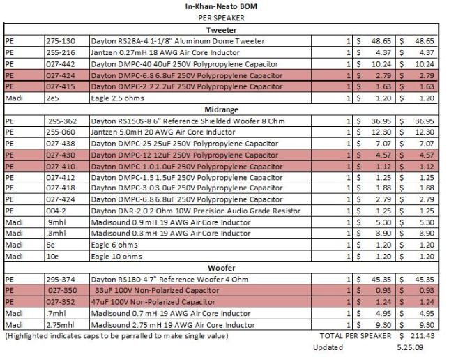

    And this is the original BOM:
    CJD/---k----: You might like to know that the crossover is missing from http://www.divine-audio.com/in-khan-neatos/ (just a icon is showing).
    As you can see from the boom there are parts from Parts-Express and from Madisound.
    As I will have to order these parts abroad there will be custom and fees to get them into the country.
    If I'm to replace the parts from Madisound with parts from Parts-Express or hifisound.de.
    Is there anything in perticular I have to be aware of? I mean, what should I look for when replacing the parts?
    (this will be my first crossover build - so sorry for the novice question)
      I bought parts at both due to cost and maybe some availability. Let me see what I can come up with.
      2.5 ohm resistor, tweeter: Mills 2.5 Ohm 12W Non-Inductive Resistor
      (CJD would probably prefer this one)
      .9mhl inductor Jantzen Audio 0.90mH 18 AWG Air Core Inductor Crossover
      .3 mhl Jantzen Audio 0.30mH 20 AWG Air Core Inductor Crossover Coil
      (I selected 1 18 ga and 1 20 ga inductor. The DCR is pretty darn close on both to the original. I think the two average to darn near perfect the specified.)
      6 ohm resistor: http://www.parts-express.com/mills-6...esistor--005-6
      10 ohm resistor: http://www.parts-express.com/dayton-...sistor--004-10
      the 33+47 woofer caps with 1 80uf cap: http://www.parts-express.com/80uf-10...citor--027-358
      or more expensive upgrade:
      http://www.parts-express.com/dayton-...citor--027-441 + http://www.parts-express.com/dayton-...citor--027-448
      There are lots of options. Basically, I looked for Mills resistors to swap in for the Eagle where they were in line with the driver. Where they were parrallel, to save a few bucks, I swapped in the generic Dayton resistor.
      For Inductors, you want the same value and the same DCR.
      Caps, same same. The upgrade is to the basic Dayton poly cap. You can get fancier if you want, but do the tweeter and mid first.
      It should be possible to get the crossover parts from an EU supplier and just order the drivers from here. That may or may not cost less.
      Hope that helps. I did it quickly, so double check my results to make sure I got all the links correct.
        Crossover image fixed (though of course you can always find it at the end via the gallery....)
        I think the general approach is "source parts from wherever makes the most sense - be it price or availability - as long as they're within tolerance." In this design, my only real paranoia is ensuring the mid padding has adequate power handling. Does it run hot? I don't know. I think the only thing we damaged was the receiver, letting live speaker wires bump HVAC duct (steel...) and that just required a reset (thank goodness for a functioning protection circuit!)

          Thanks a lot cjd!
          A little follow up question. From what I can see you have replaced parts form parts-express with other parts from parts-express on the list of items.
          I assume that you ment to replace the with other items.
          After searching a bit on parts-express, based on the input you gave me - I think that the following should be possible to use to replace those last two madison parts:
          Does these look OK?
            My bad. My highlighting confused me for a second. The .7 mh inductor is a darn near perfect replacement. The 2.7 for the 2.75 is close enough.

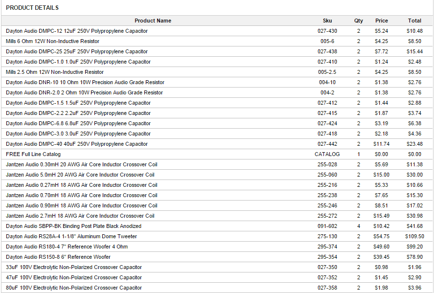

              Thanks Ryan
              This is the resulting BOM. It should contain all parts needed for the element and crossover design for 2 in-khans.
              (in addition it contains a catalogue and an binding post set for the in-khans and another speaker set)
Name:	in-khan-neatos boom-tek.png

                  • 1670
                  Thanks, but I'm not expecting that. This is based on the existing bom and the input in the previous post.
                  I think I have it pretty clear, and doing a double check against the original BOM and the previous input is something I can do myself.
                  In a build where I had figured out the part myself that would have been very welcome - but as this is just getting the part already defined I think you better get some sleep instead of using time double checking my work :-)
                  Added it here for my and others future reference if someone would like to build this and not have to order from several sources.
                  (will find out when building it if I missed on something ;-)

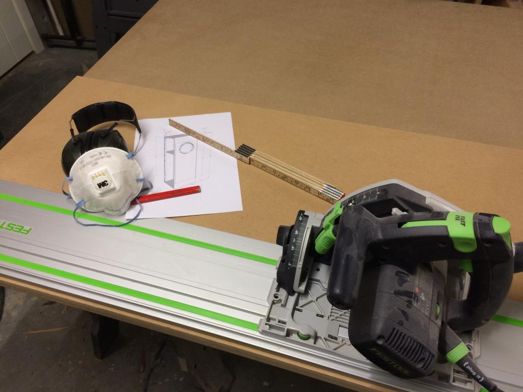

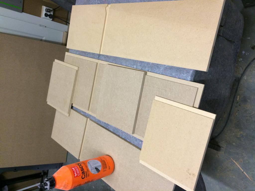

                                        OK, I think it's time to get this build started. Elements and crossover parts are already "on site".
                                        The final design will be a bit different from the one in the initial post. I will start according to the drawing below, and then add some design feature as the build comes along.
                                        So, what you know for now is not the final result - stay tuned for more...
                                        Will try to shoot some photoes of the process...
                                          • 1670
                                          Here we go again
                                          Will do rabbit joints between the side walls and the front and back, so the side walls needs to be 7" 1/2 insted of just 7".
                                          Hope I'm able to build the revised cut plan in my head as I go along:W

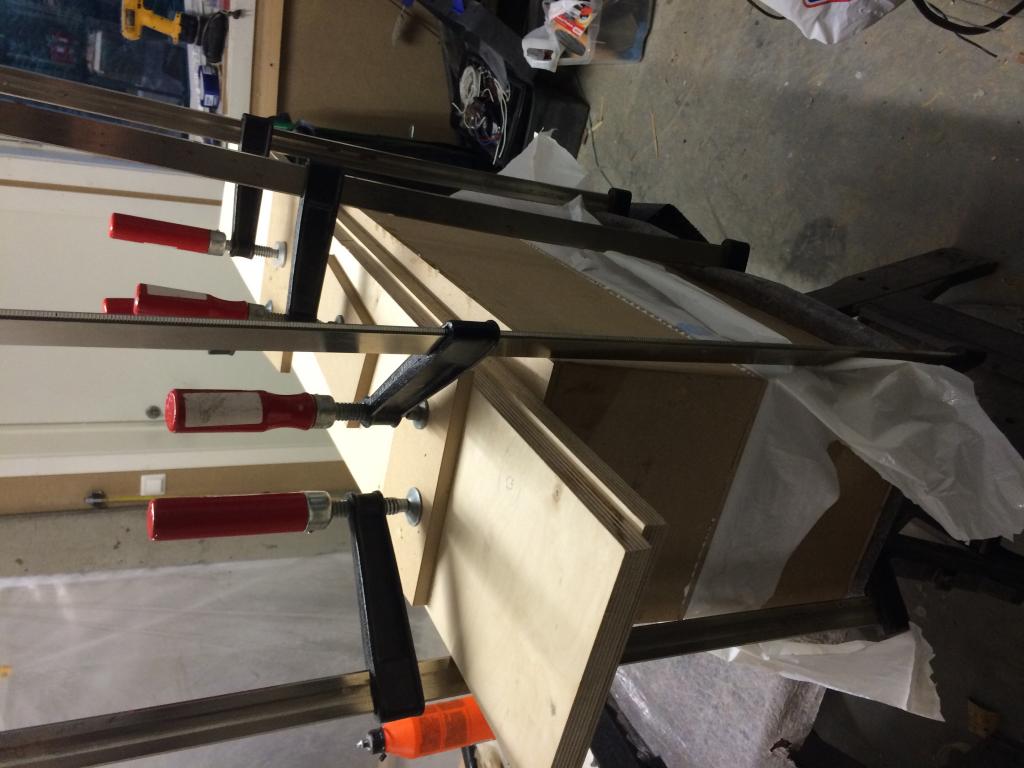

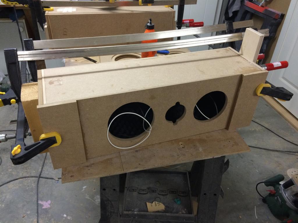

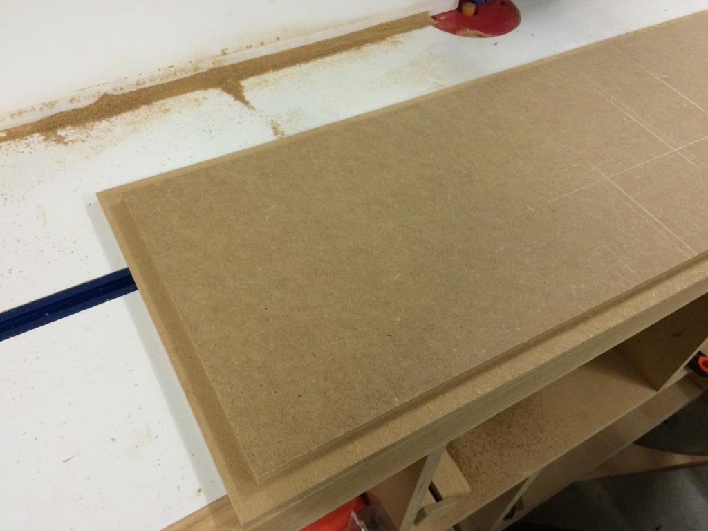

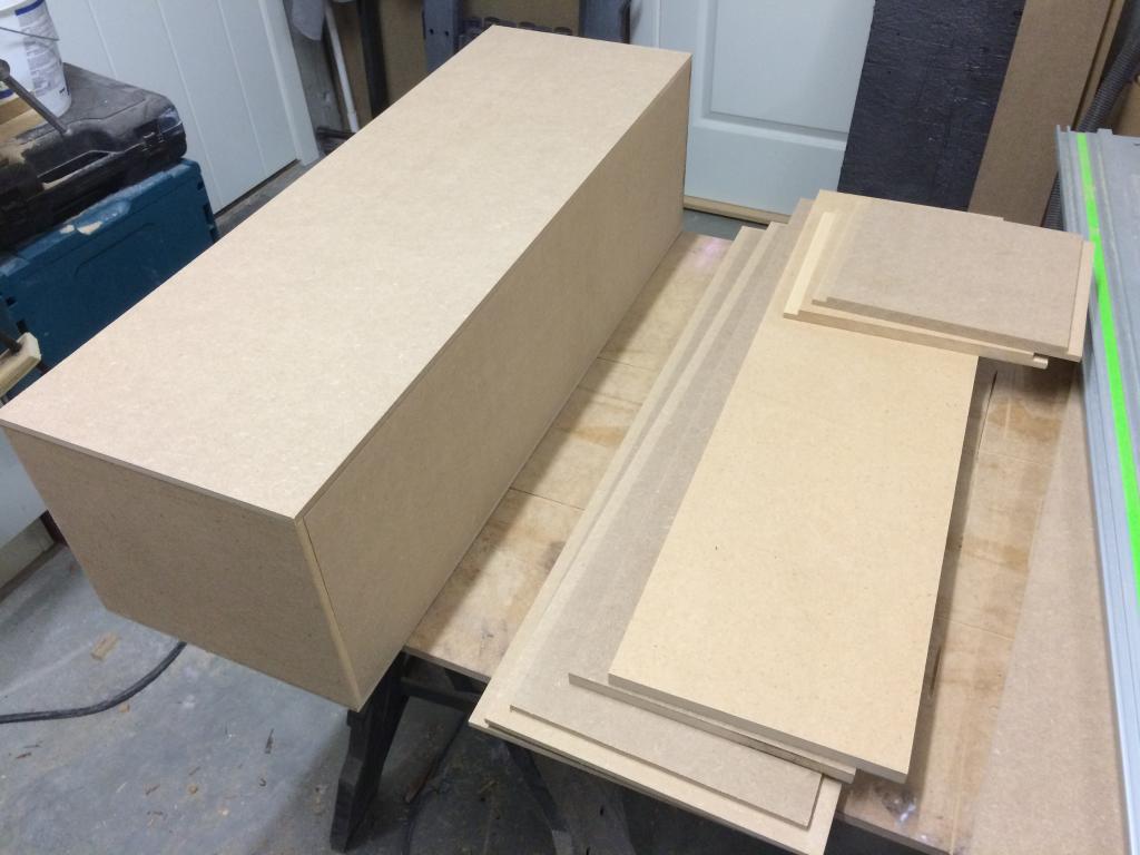

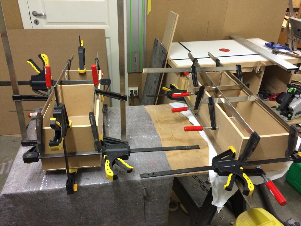

                                            I'm done cutting and adjusting the outer box for both speakers.
                                            Used my DIY router table to route the joints - worked out really good.
                                            This is the result from the routing:
                                            As you can see I'm using rabbit joints (is that the correct name of this joint?)
                                            And then it's time to do a dry test for the outer box:
                                            Seems to fit nicely togheter so far:T
                                              Rabbit is on the end of a board with perpendicular surface joins, Dodo is in the middle of a board. Half lap is on the end or middle with the surface in the same plain.:T People tend to interchange them though.
                                              For speaker building if your only using say 18mm or 22mm board on the side and top, it's a vary small addition surface area for gluing compared to a butt joint. If your laminating boards say 2 sides and 1 or 2 tops it provides much more surface area for glue and helps keep things square, that's when I would use a Rabbit. Dado's are always good and give more surface area for glue.

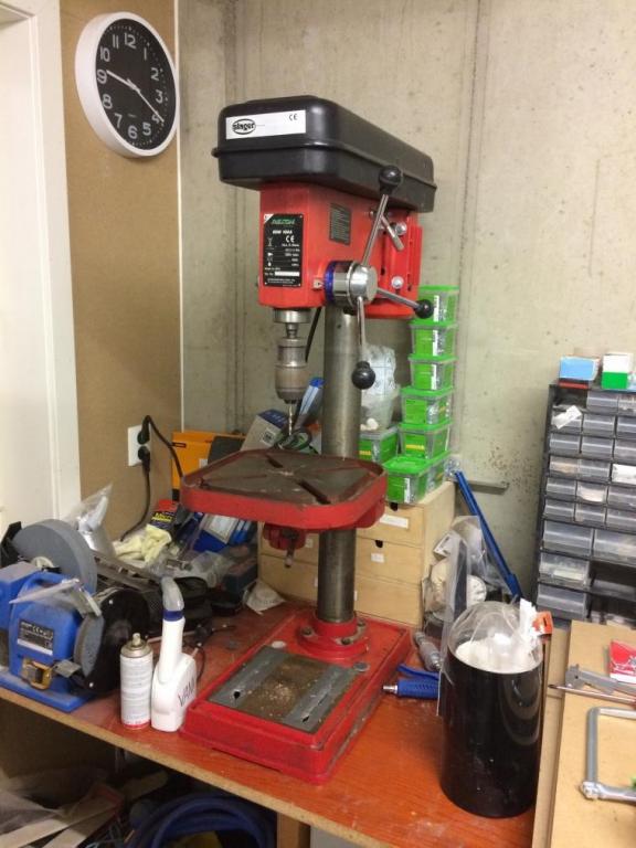

                                                  A new tool :-)
                                                  Have been looking for one of these for a loong time. Finally got one for a nice price...

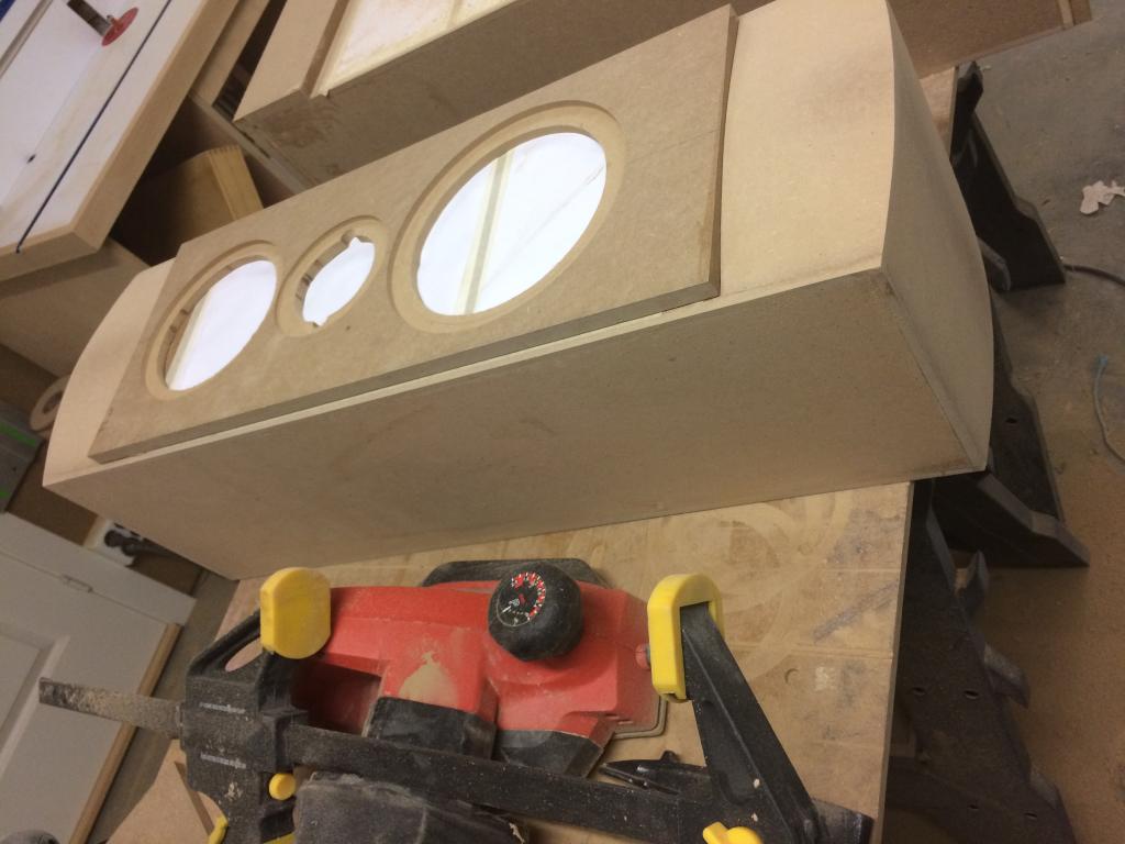

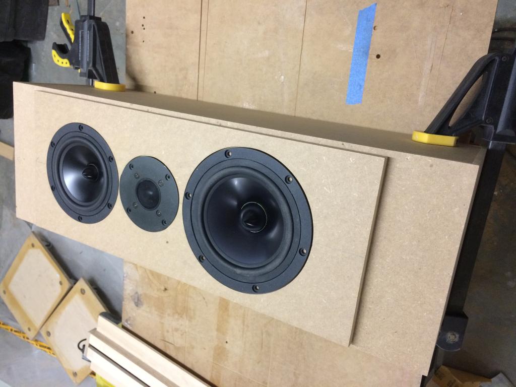

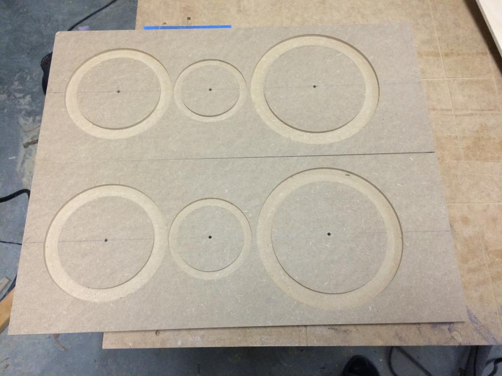

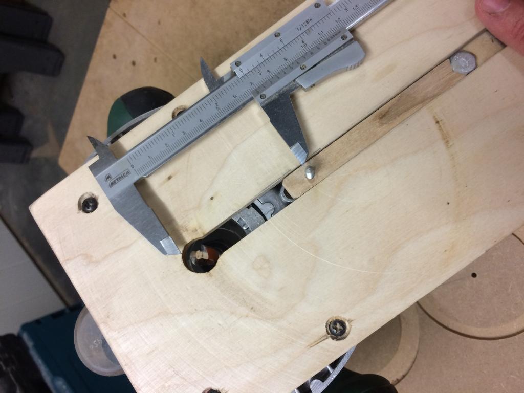

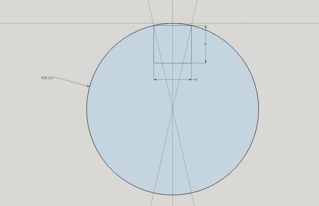

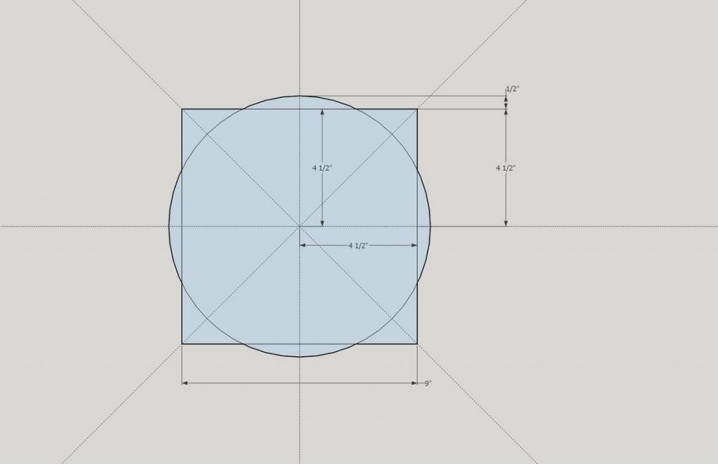

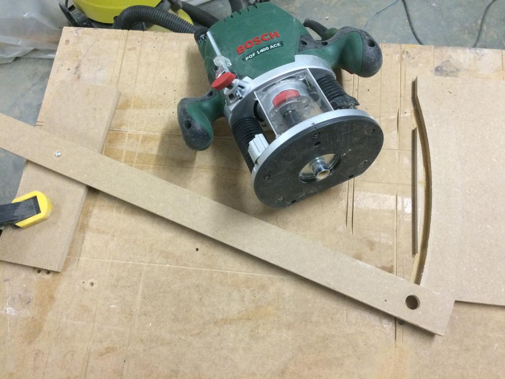

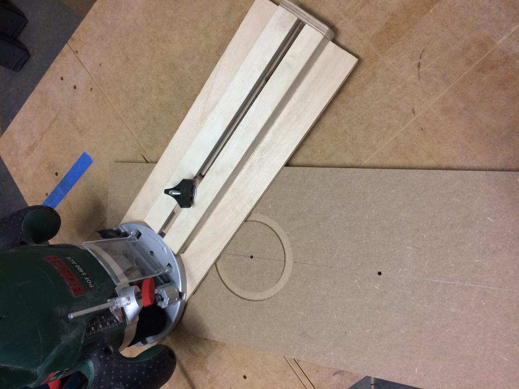

                                                    OK, made a little progress today.
                                                    During the Wavecor Ardent build I made a DIY circle jig. Now it's time to get that out again.
                                                    Click image for larger versionName:	image.jpgViews:	1Size:	80.1 KBID:	860342
                                                    After figuring out the radius of all the driver cutouts I can adjust the jig to the correct radious using the method shown below. This method is very accurate and I get quite precise cutouts every time. But this time I did make the cutouts a bit larger than the drivers. Quite fed-up with drivers that get's stuck in the speaker because the cutout is to small.
                                                    Click image for larger versionName:	image.jpgViews:	1Size:	73.5 KBID:	860343
                                                    Cutting all the cutouts in one go.
                                                    Click image for larger versionName:	image.jpgViews:	1Size:	79.7 KBID:	860344
                                                    Test assembling the box with the drivers in. Everything seems to fit quite nicely together.
                                                    Click image for larger versionName:	image.jpgViews:	1Size:	86.0 KBID:	860345

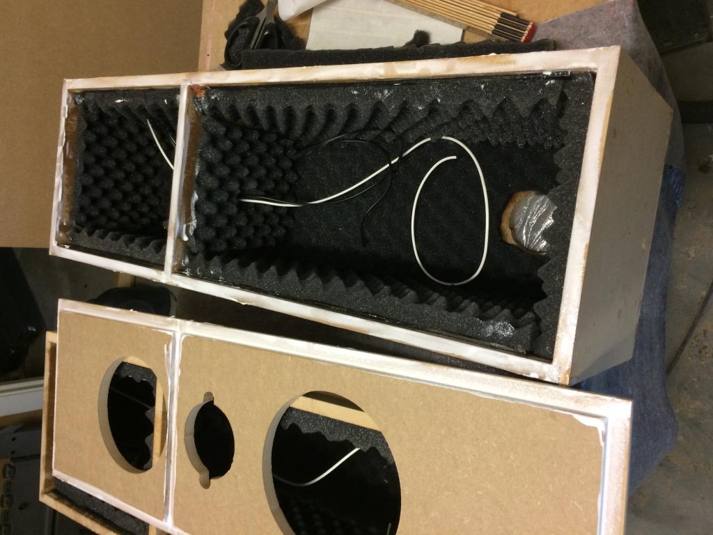

                                                    The next step will be to add internal bracing and cutouts for the speaker terminals. But before that I have to go get the speaker terminals.
                                                    As the speaker will be wall mounted the speaker terminals cannot stand out from the speaker. Due to that I'm planning on using these that is available close to me.
                                                    Images not available
                                                    Cost almost nothing, and I think they will do ok on this build.

                                                      Hey, those are starting to look familiar to me! Nice progress.
                                                      I've used those terminal cups on project before. I think they work well. No judgement from me. I've also just cut a 3" diameter hole in the back, routed the edge, glued behind the hole one of my driver cutouts, then installed terminals through that, essentially making my own terminal cup.
                                                      Also jealous of the drill press. That would be a handy tool to have.

                                                        Some more progress today.
                                                        Does not look like mutch, but took some time to get it done.
                                                        I have cut the divider between the mid and bass section. I decided to route dadoes for it in both the back, side and front.
                                                        Also cut the hole for the speaker terminals.
                                                        And then it was glue time... Looking good so far I think.

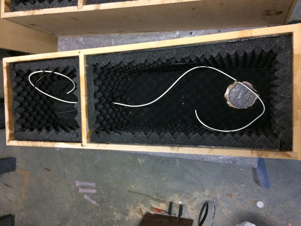

                                                        I was wondering about add some more bracing to the box - but I think that it will be OK when the front baffel is added.
                                                        Also, the front baffel is double so it will be quite stiff. To avoid any "boom" from the box I have decided that I will line the side walls with this stuff.
                                                        Selvklebende bitumenplater (asfaltgummi) for vibrasjonsdempende lydisolering. Tar effektiv bort resonans- og vibrasjonslyd på bilens hjulhus, bunnplater m.m. Formes etter underlaget med varmepistol. Kan også legges i remser. For god effekt bør minst 1/3 av underlaget dekkes. Overmalbar.
                                                        This is bitumen. It's heavy asphalt/plastic that has very good vibration damping attributes. It's stick-and-peel, so it's quite easy to apply. I used the same stuff - but quite a bit thicker - for the midt-tone chamber in the Wavecor Ardent.
                                                        At least knocking on the cabinet gives a lot less sound after lining the sidewalls with this stuff.
                                                        I also assume that when I get the front baffel mounted it will stiffen the box a lot more. The box is quite shallow, so even if the bass chamber is a bit long compared to the wall thickness, the area that is not braced is quite small.
                                                          • 1670

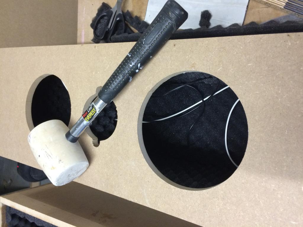

                                                          Some small progress today as well.
                                                          Lined the inside walls with bitumen (see previous post for details about that stuff) and with damping mats. The damping mats is glued on with with spray glue.
                                                          Also drilled holes and inserted the cables for the mid-tone so that I can get sound into that as well
                                                          Detail shoot of the wall lined with bitumen and damping mat.
                                                          Then it was time to glue up the front baffel. As you see I'm adding glue to both sides as the MDF edges sucks up a lot of glue.
                                                          The front baffel was a near perfect fit to the cabinet. And as I had made dado's and rabbit joints it was like putting on a exactly fitted lid.
                                                          Using the furniture hammer to ensure that it get into place (that furniture hammer is a recommended tool when working with stuff that is supposed (or not supposed but just do it) fit tightly together.
                                                          And the usual clamp photo :T
                                                          As you can see I put the two cabinets upside down on top of each other and clamped it all together. Notice the plastic between the boxes. That's so that glue spill or drips shall not glue the front baffles together.
                                                            Looking good! Except that one wire is upside down...

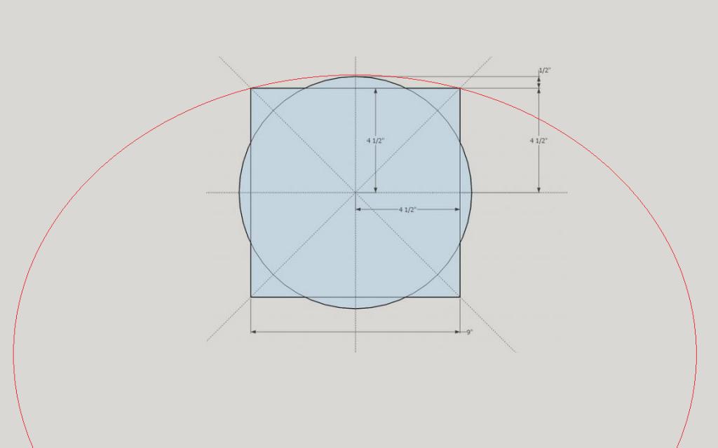

                                                                  I need help with a math question. Can anyone help me out here?
                                                                  In this figure, what is the radius (r)?
Name:	hva er radiusen.png
                                                                    • 2129
                                                                    Looks to me like 5" TEK
                                                                      • 2129
                                                                      Drawing would more like this in actuality .....
                                                                        • 1670
                                                                        Thanks a lot Steve, that looks great!
                                                                        I will not have time to utilize this information today - but will be used in one of the first upcoming day... Then the usage will be revealed as well - even tough I guess someone might have guessed it by now
                                                                          • 1670
                                                                          Ohh... sorry Steve, but now when I look closer it's not right.
                                                                          I'm looking for the radius of the circle that will touch both top edges of that 9" side, and where the center of the circle will be 1/2" away from the 9" side.
                                                                          Like the read circle shown in your figure.
Name:	hva er radiusen2.jpg
                                                                            • 2129
                                                                            Yep, that will change things, so let's try this then ......
Name:	TEK 2_resize.jpg
                                                                              • 1670
                                                                              Thanks a lot Steve, your numbers was spot on at has come to good use :-)

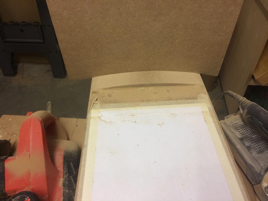

                                                                              First, as this circle was very big - I had to make a temporarly tool to cut out the template I needed.
                                                                              Using the template to check the arch
                                                                              And one speaker is starting to look as it should

                                                                                  Hey tek,
                                                                                  Probably being dense - but would you mind sharing what you did? It looks like you shaved off the top/bottom of the cabinet to make it curved?
                                                                                    • 1670
                                                                                    Originally posted by kevinm
                                                                                    Hey tek,
                                                                                    Sure - and you are spot on.
                                                                                    I first added 1/2" MDF to the top, bottom and the area above and below the baffel with the element cutouts.
                                                                                    The I made all those curved (yes, both top and bottom as these will hang on the wall).
                                                                                    I used the radius from Steve to make a template that I can use just to check if I have get the curve correct. The curve itself was done with a electrical planer as well as a orbital sander and finally for hand.
                                                                                    I will do this on both speakers. The "outer baffel", that's the pice that the drivers will sit on, is loose and will not be fastned yet.
                                                                                    The speakers itself will be spray-painted white, while the "outer baffel" will be spray-painted in dark metallic gray.
                                                                                    I'm a bit unsure about the process to follow from here and until I start painting.
                                                                                    I will need to use bondo to get the radius "perfect", but I'm not sure when I will do that.
